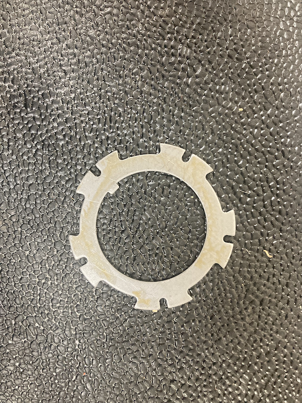

I am under the impression you have Dana 60 axle assemblies in your Tucker... but the exploded view diagram in post 320 is from a Dana 44.
All of our Tuckers have Dana 60 axle assemblies and we use these.
They are Spicer part number 30637, and are frequently sold in a box of ten.
If you elect to use those and you can't get them at a reasonable price, shoot me a PM. I've got some spares and I'll send you a set.
i thought it was a Dana 60 as well. But the axles are 6 stud and these washers come up as Dana 44.
The Eaton Locker I ordered for the front diff was for a Dana 60 and it fits. So I don’t know now.

Yes that would be them. Would anyone have an International or Spicer part number for these washers? I’m hoping one of our local dealers can order the parts if I can get them a good part number.

I found your IH cross searching another forum. IF you can find it, the part number is 65678r1. After you see the price, you'll end up back at the Torque King website. Holy cow. The info I found was from 10 years ago:

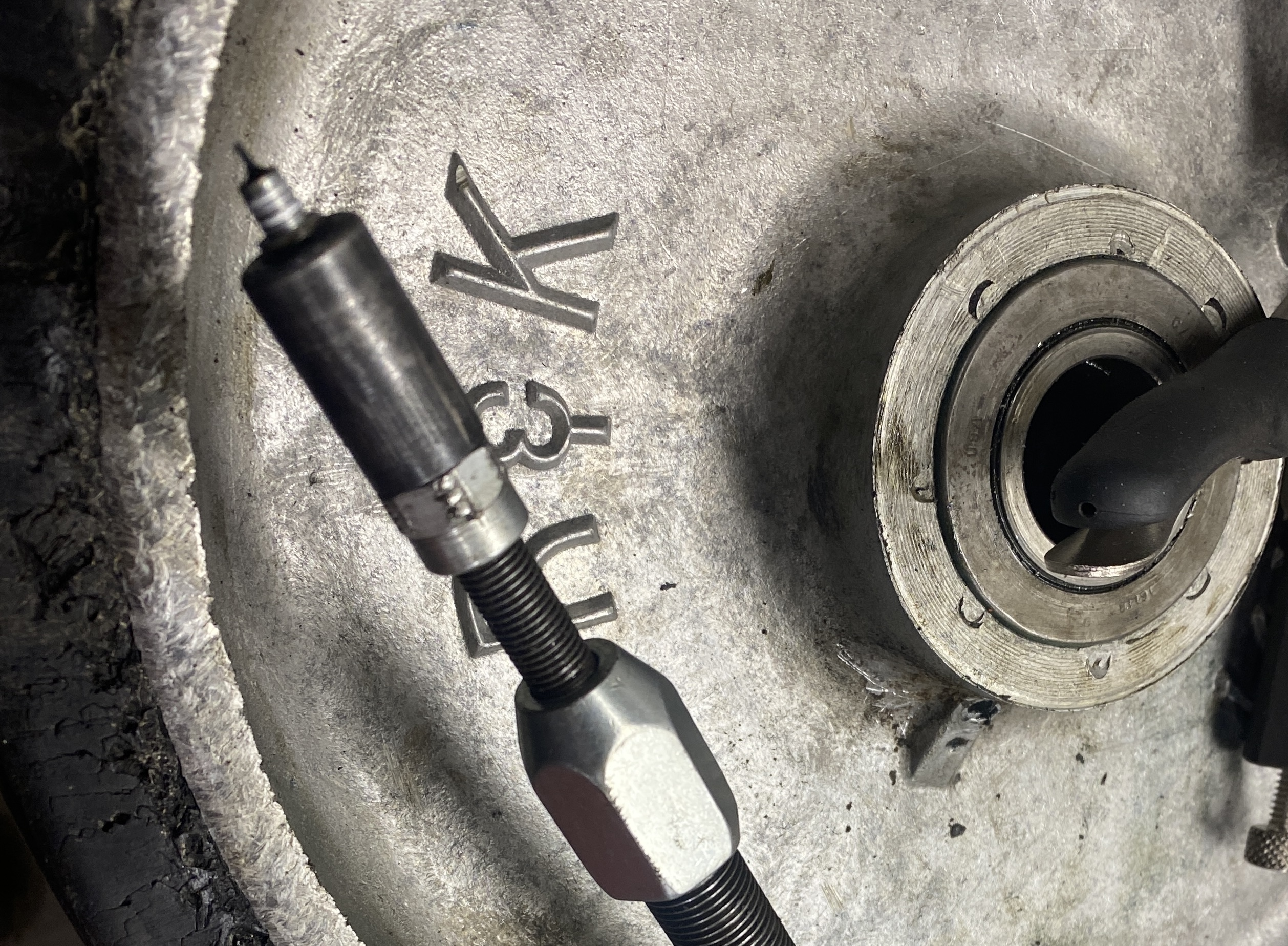

Found a good solution online for removing those nasty push in grease nipples. Take apart an old grease gun coupler and stick washers in so that the coupler can not release. Hook up the coupler to a slide hammer and out comes the grease nipple.
Takes a bit of messing around but I managed to pull 4 out.
Then I drill and tap to take a new nipple.

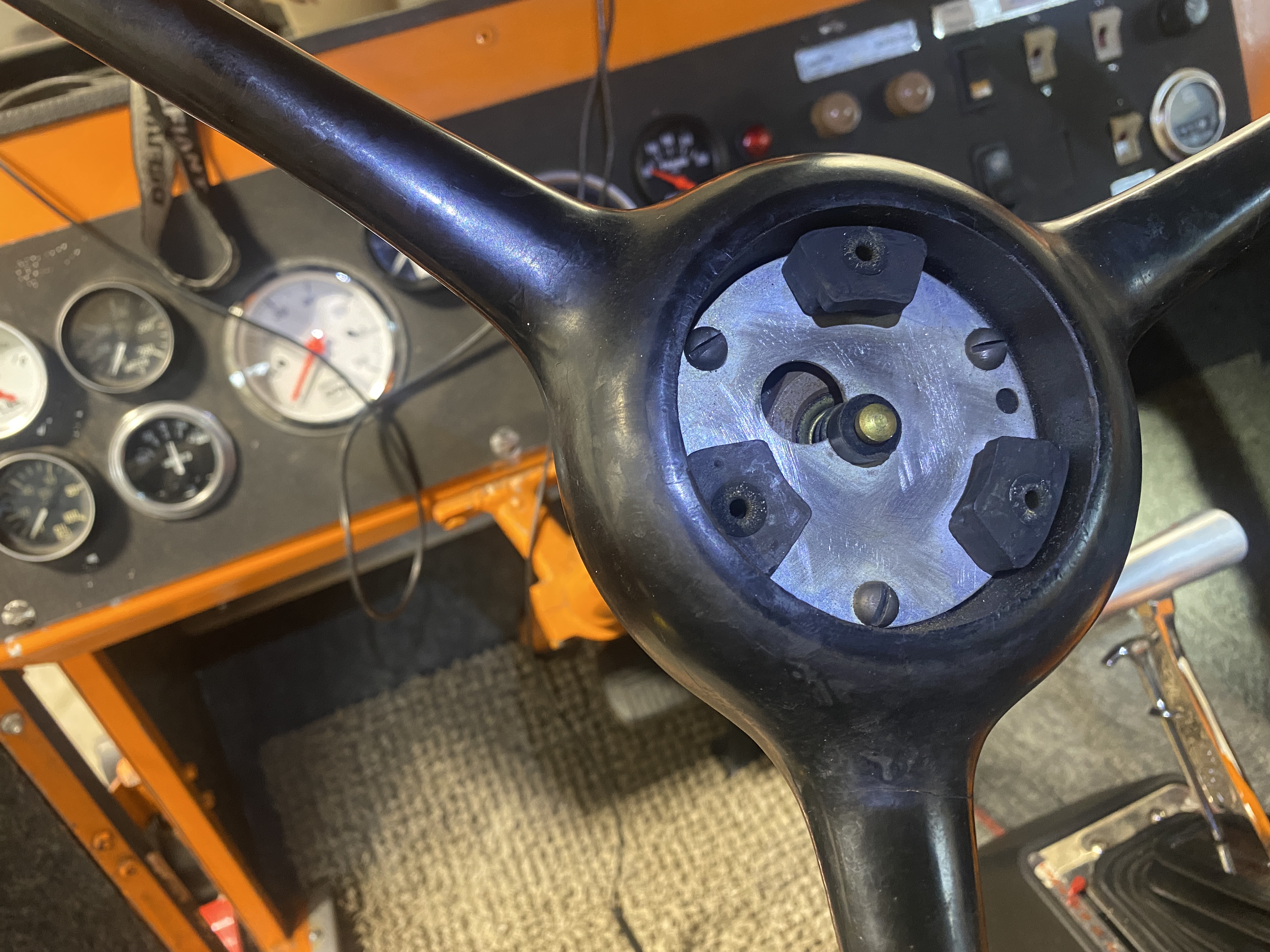

Getting the horn button off the steering wheel was a little more technical that I thought. I had to remove the cover rubber then insert two small screwdrivers in two of the 4 slots, and used them for purchase for a third screwdriver to rotate the Bacalite horn button. Then it came off.
The wiring down through the steering column was fine, but the corrosion under the metal parts in the horn was the problem. Cleaned up reassembled and changed relay out to the the standard 4 prong and everything works properly.

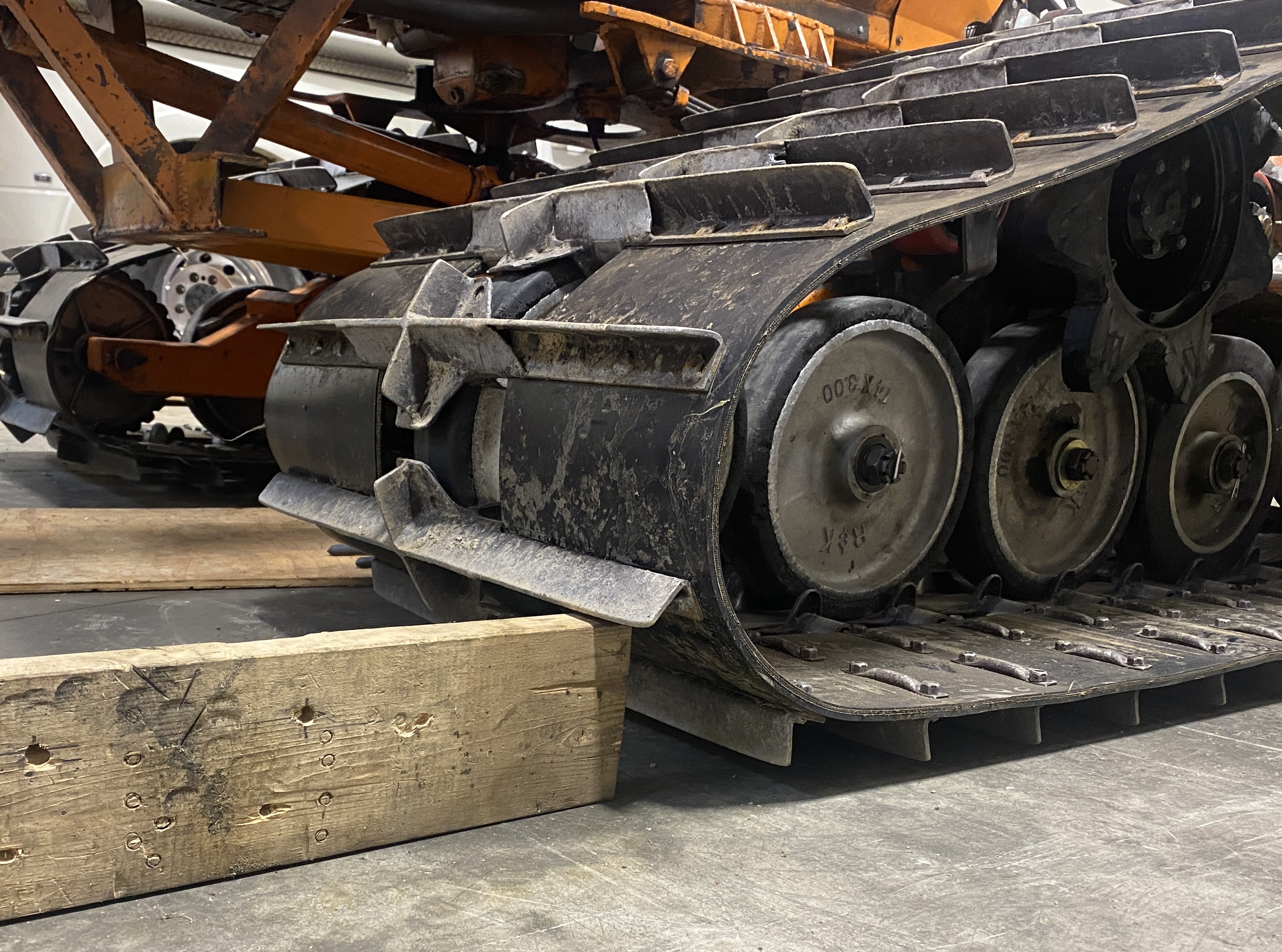

I think these two pictures illustrate what I hope to achieve.
The tip toe has less work to do in traveling through a 6” crust for example. This also applies as the snow gets deeper. Less work than trying to push the track straight into the snow face. Let the track climb a bit.
This what it looks like with the track weight on the shop floor.

Does the front damper wheel still support the track on the tip tac toe mod when tightened per Tucker specs?
That front adjuster takes extreme forces into the box tube which now has a leveraged wheel mount instead of close to workable linear.
Most Tucker mods result in failure elsewhere. They made the best worst solution on the pow.
The front wheel and its adjusting slide still support the track under tension.
However, when thinking of the track frame as it was normally, as the track approaches an obstacle to climb over, normally the weight of the Tucker would be immediately supported by the rear wheel and the front wheel. That is quite a bit of leverage force.
With the TipToe the weight would be slid back under the front wheel towards the second wheel somewhat, making less stress on the front wheel and its slider mechanism. It would be even better for me to tip up the fixed rear wheel on the frame as well. But, one is enough for now.
Tucker has also adopted this idea in their new small cat with the V6.

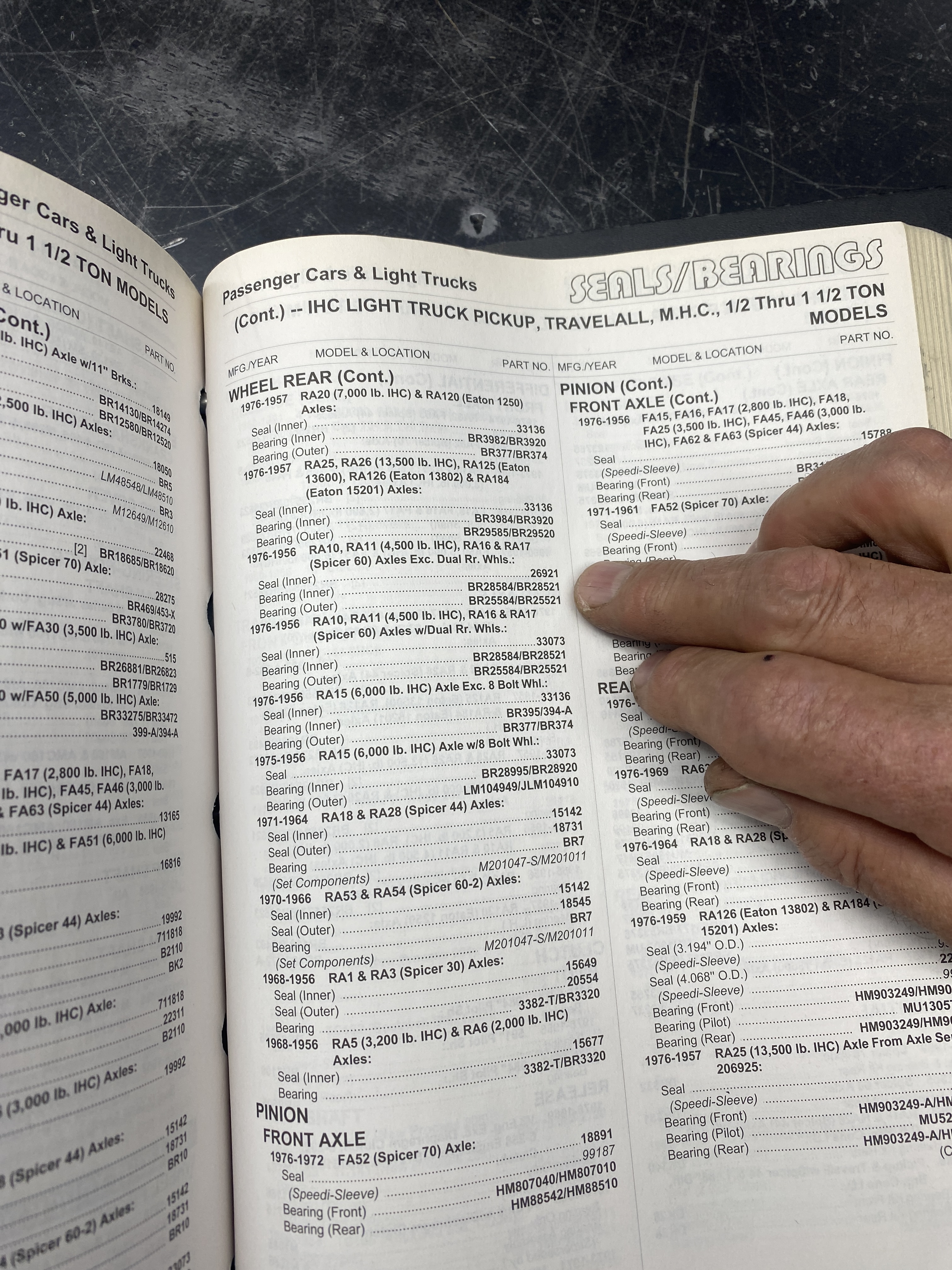

I have been wondering where Tucker sourced the 6 bolt axle and hub on my Tucker Dana 60 differentials.
I was able to do a search in a parts book at the local auto parts store to figure out who used the CR26921 inner hub seal.
The only place that seal number showed up was for an International Truck on the 1/2 ton (with dual wheels?) using the Spicer 60 from 1957 to 1975.
It is not even the Dana 60.
I was hoping finding the seal would help me locate where the Dana 60 axle with the 6 bolt flange was used. But struck out.
Anyone know who used the Dana 6 bolt 30 slime axles?

I was reviewing the information I found yesterday and noticed that not only does the seal number I found match, but so does the inner and outer bearing numbers match.
Now I’m looking for axle and bolt patterns for the hub.
Maybe …..

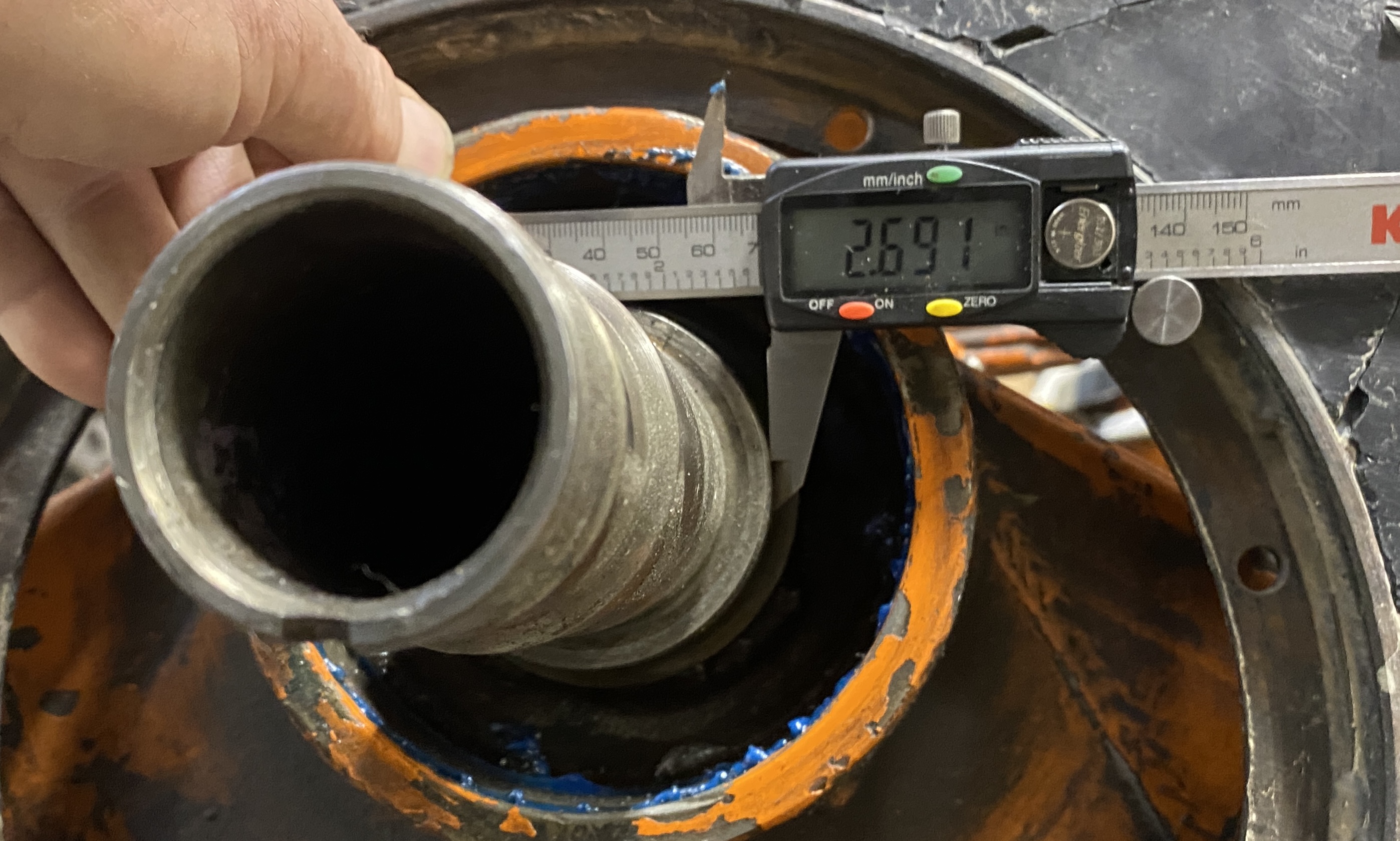

I'm chewing on the 6 bolt versus 8 bolt hubs on the Dana 60's.
I've seen pictures of 6 and 8 bolt axle heads on various old International trucks, but can not find any interchange info.
So an easy place to start is if anyone happens to have hub off and can take some measurements? If the housing stub is the same that would nice. The housing measures ...
The inner bearing surface is 2.07"
The outer is 1.78"
The seal is 2.69"
The outer bearing number for the 6 bolt is BR 25584
The inner bearing is BR 28584
So if anyone has any numbers kicking around for the 8 bolt hub bearings and housing measurements, chime in please.

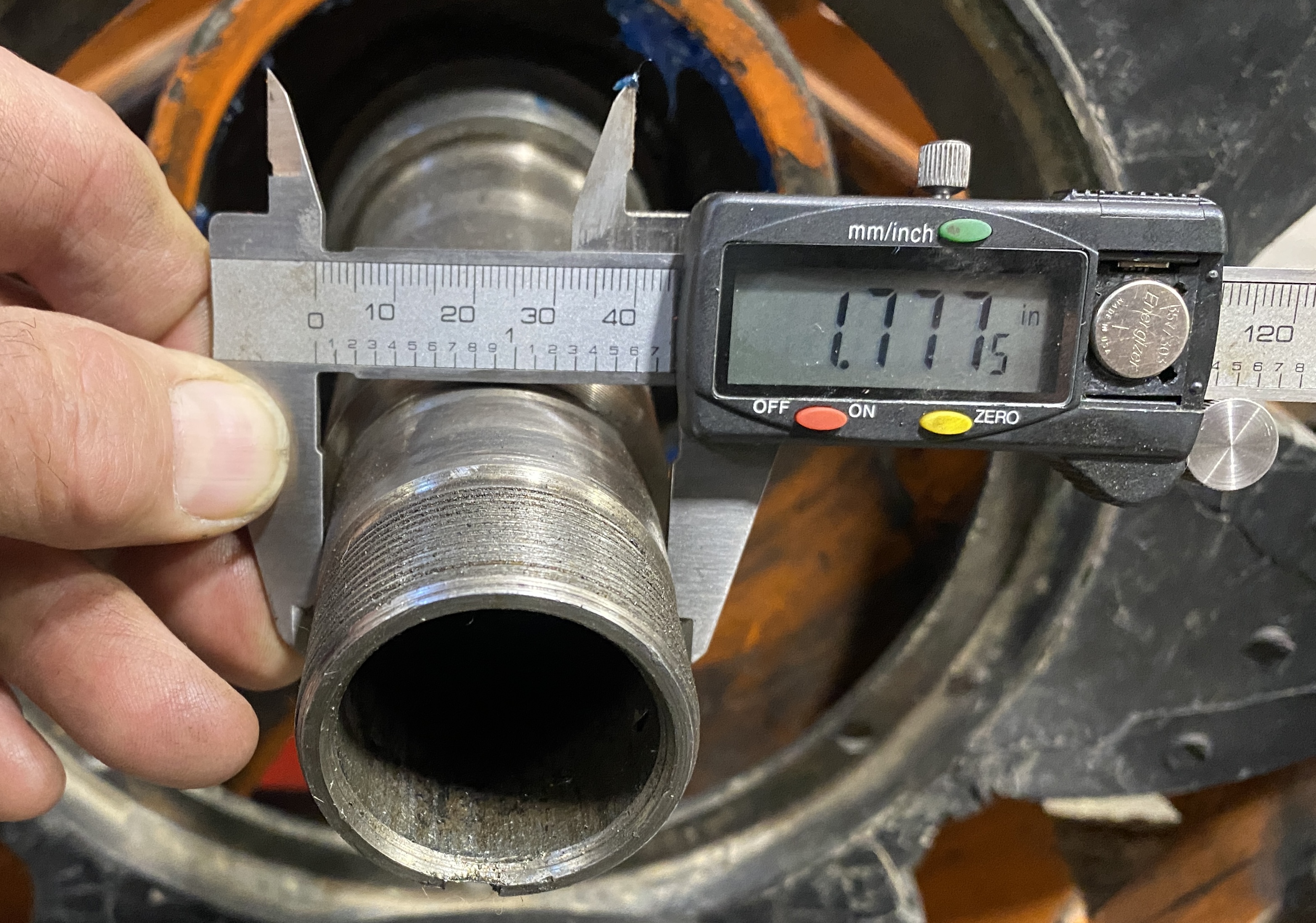

Was wondering if you could take an internal measurement of those washers. That would tell me right away if there are different Dana 60 housings. The lock washers I have are 1 3/4” internal measurement.
I measured two different ones, and two measurements on each. The ID varied between 1.812-1.828.
