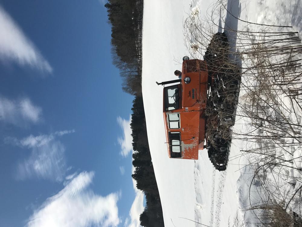

Strong weekend. 160 smile snowmobiling Friday. There has to be 7 plus feet up in some parts of NH. Ride fresh groomed trails Friday courtesy of the 6 groomers we saw. Seems to be lots of Tucker Terras these days and they move. Passed three of those 2 PB edge and a couple BR 180s all dragging big mogul masters. Numerous others on the trek we never saw. Rode twin mountain up to Errol and back. I know you westerns have snow but this year they are doing well in the north!
Hit the slopes with the kids Saturday and came home to embrace the last day of sno for now 50 degrees and sun shining! Warm up so we hit the reset button while in McCall.
Trailered over to a friends farm other part of Haverhill few hundred privat acres. Lots of friends and family loving the Tucker and took a few on a tour to see parts of their farm they have not seen in many many years. Of course had to bring along the 120 class race team. Night tour was a big hit.
Tucker made many more memories today across all ages!

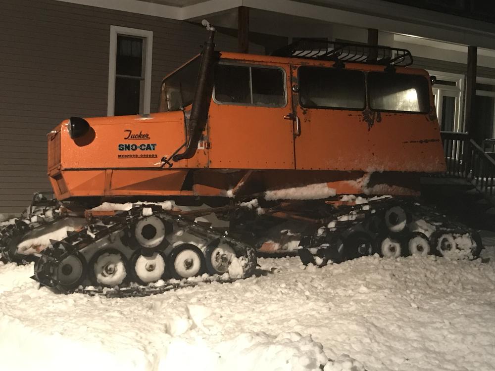

Scored a great deal on a nice used Yakima roof basket with extension. Think it compliments the cat proportionally. Of course it will be sitting up a bit once mounted on the cross bars and the location needs to be fine tuned. Has some accessories that can be mounted to it that may be useful in the future.

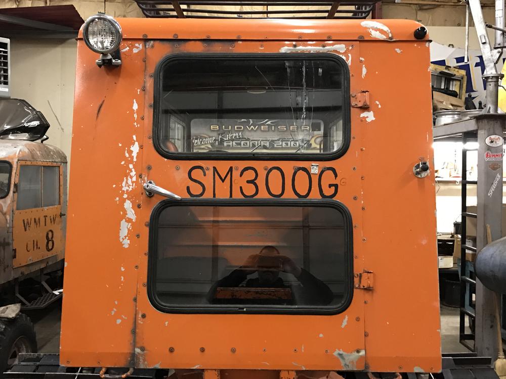

Got the rear cross bar on tonight. The rivets that hold the roof on are in the top of then 3-4 square stock so the thru bolt option was abandoned because won't line up. Had to mill and file a recess for the rivet gun to get low enough to line up with existing rivets.
Used rivets like factory instead of thru bolts and made new holes. Between the rivets and existing flange support plenty sturdy. System works well and clamps secure to the new brackets and under the factory roof flange. Little black touch up paint and should like good racks on or off.
Thule low raingutter mount hug the roof nice!

Rack mounted up nice easy to reach from back or side tracks.
On to the track reversal.

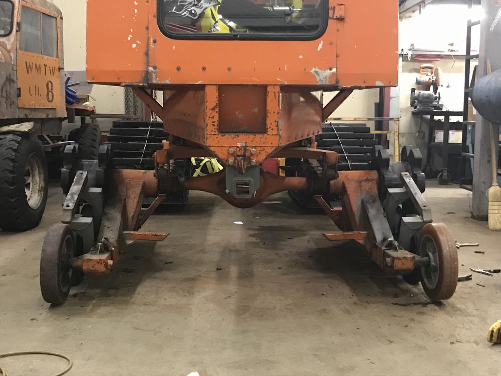

Got the rear tracks off. Good news is there are 5 ice breakers not the three I thought must be color blind. One extra ice breaker is on the front. Will take off and replace with the spare rubber one.
Tightened all the spindle/ bearing nuts and greased new cotter pins. Number of turns on each. Greased the carrier fitting and adjusters. Have to replace one fitting.
The sliders although real new looking have cheap full thread carriage bolts and some were loose and ovaled the steel. One repair was to add a thin plate instead of just fixing it right. I plan to address this by weld filling and re drilling and instead of carriage bolts Allen head with washers.
Few other questions I will ask in another thread about carrier bushing wear, bearing caps, washers,etc.
Pretty easy compared to the steel track! Miss it though.
Completed half of the trackeotomy procedure got rear tracks reversed and the sliders re attached securely. Nothing too surprising. Have some work to do in the off season. Rear leaf spring shackles need to be re bushed and I think the shackle to rear table will need bushing work also.

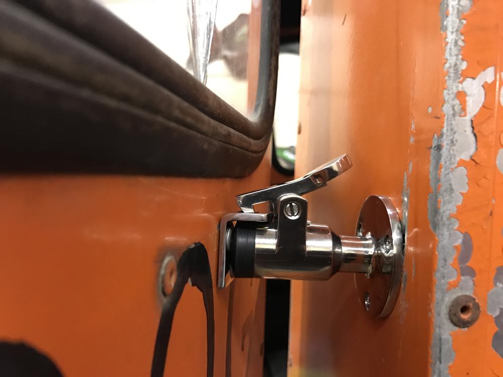

Rear door open holder check. Works as a bumper and locks with a little tap.
Great for warm weather touring !

Got the tracks all reversed . Changed out the slider bolts. Greased the wheels. Adjusted the tension.
Just in time for the blizzard we are getting today !
Thanks Mother Nature for a little end of season boost.
Put a few smiles on and the tracks seem to ride a little smoother this way.

Question on the front carriers? The adjusters are both on in the front of the tracks. I believe these are on backwards .
Doesn't make sense to have that adjuster take all the impact being the front wheel.
On my Tucker the back adjusters are bolted solid and the tracks are adjusted in the front. The manual says that's the way Tucker intended.
Think about it. You want the strongest, least amount of wobble when going forward on the carrier. The tension on the belts is highest behind the drive sprocket and less on the forward side when going forward. Tatman and manual correct.
