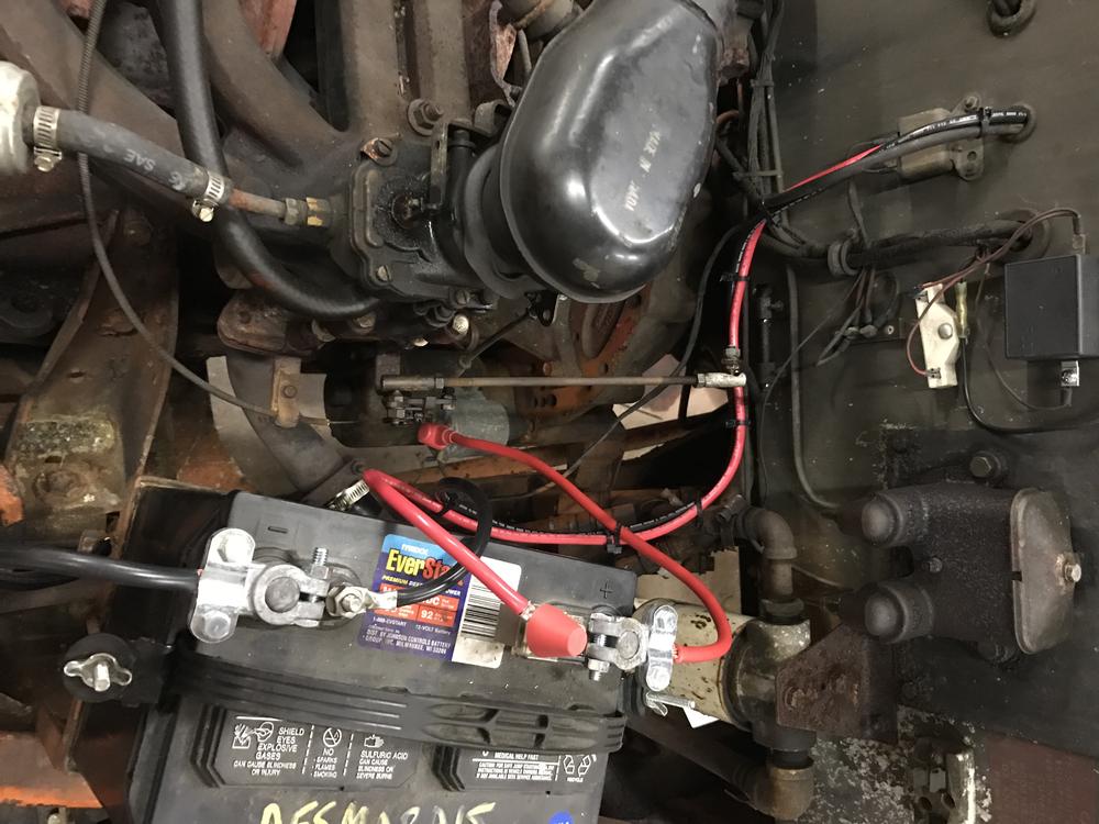

Made up new 4 gauge battery cables. Vacuumed a little more.

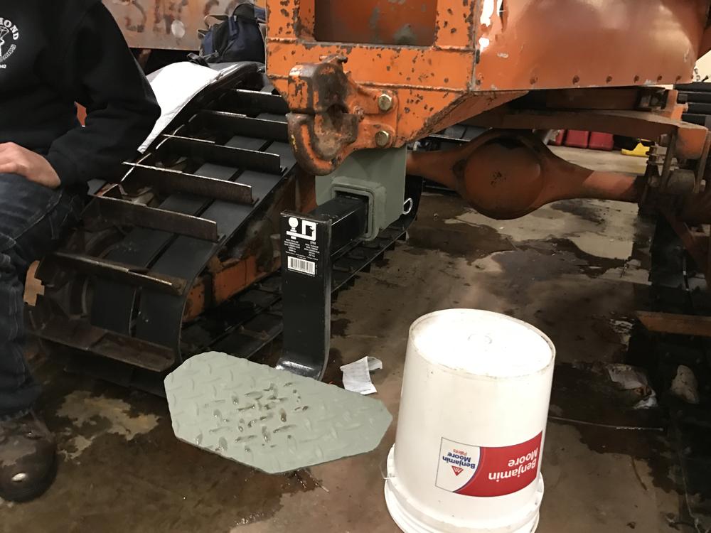

Here is what I mocked up for a receiver. The design is not for towing but for a step solution or rear cargo basket.
Little fine tuning grinding welding and some gussets ready to go!

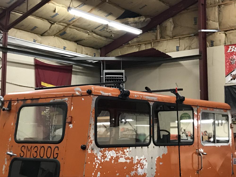

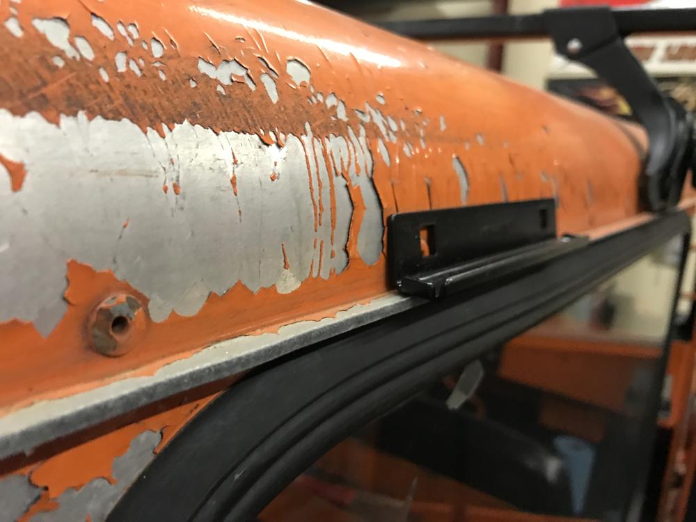

Got a mixture of rack parts to complete my design. The thule low raingutter brackets keep the bars low eBay used. Found my Thule square bars last in service on 1989 gmc jimmy 1996.
New Yakima side mount brackets line right up factory rivets into the square stock frame with some modification. Will modify the backers to match the width of the square tube and thru bolt with acorn nuts.
Just resting up there now. Need to figure a basket out then line everything up based on that and mount. No rush no sno!

Step prototype ready for testing.

Brian, Are you going to put another plate on the top of the hitch tube,under the pintle hook? I could see myself with snowy feet slipping and doing the top frame tube on the bycicle thing when the chain comes of !!!!!!!:doh::doh::biggrin:
Just wonderin ????:clap::clap:
Not sure yet. Now that I can use the cat we will find out quickly. The enter and exit is awkward. Also want a safer bottom step without the sharp edge for the kids.
Think there will be another design coming...

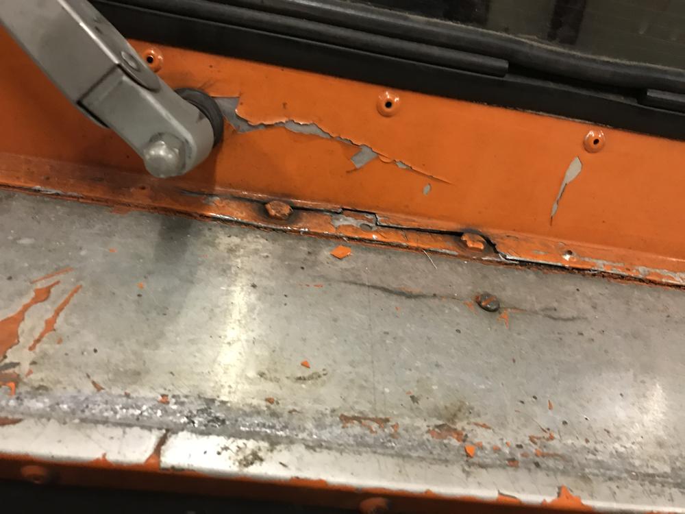

Ok finally got these wipers figured out. From what I can tell they linkage where it hooks to the wiper was in the wrong hole. There are three locations for the pin higher up more sweep lower less. These have been in full sweep for quite some time . It would jump if the edge of the drivers side and swipe down below the bottom on he passenger side. This setup would let it the arm get to the point it is too far and the motor would lock .
I find it hard to believe it came factory set like this but I see no marks in the other holes. One fix someone did was to bend/bow the linkage like a track link. Bad fix. Eventually the motor flexed the aluminum body where it thru bolts and broke the aluminum.
I made up a 1/8 backer and re-riveted it to the dash and bolted motor thru that. Put the arms in the middle hole and there is much less vibration and flex and good wipe on the glass.
Going to test so hope that is it for now. Motor needs to be replaced and I will re assess the situation then.
