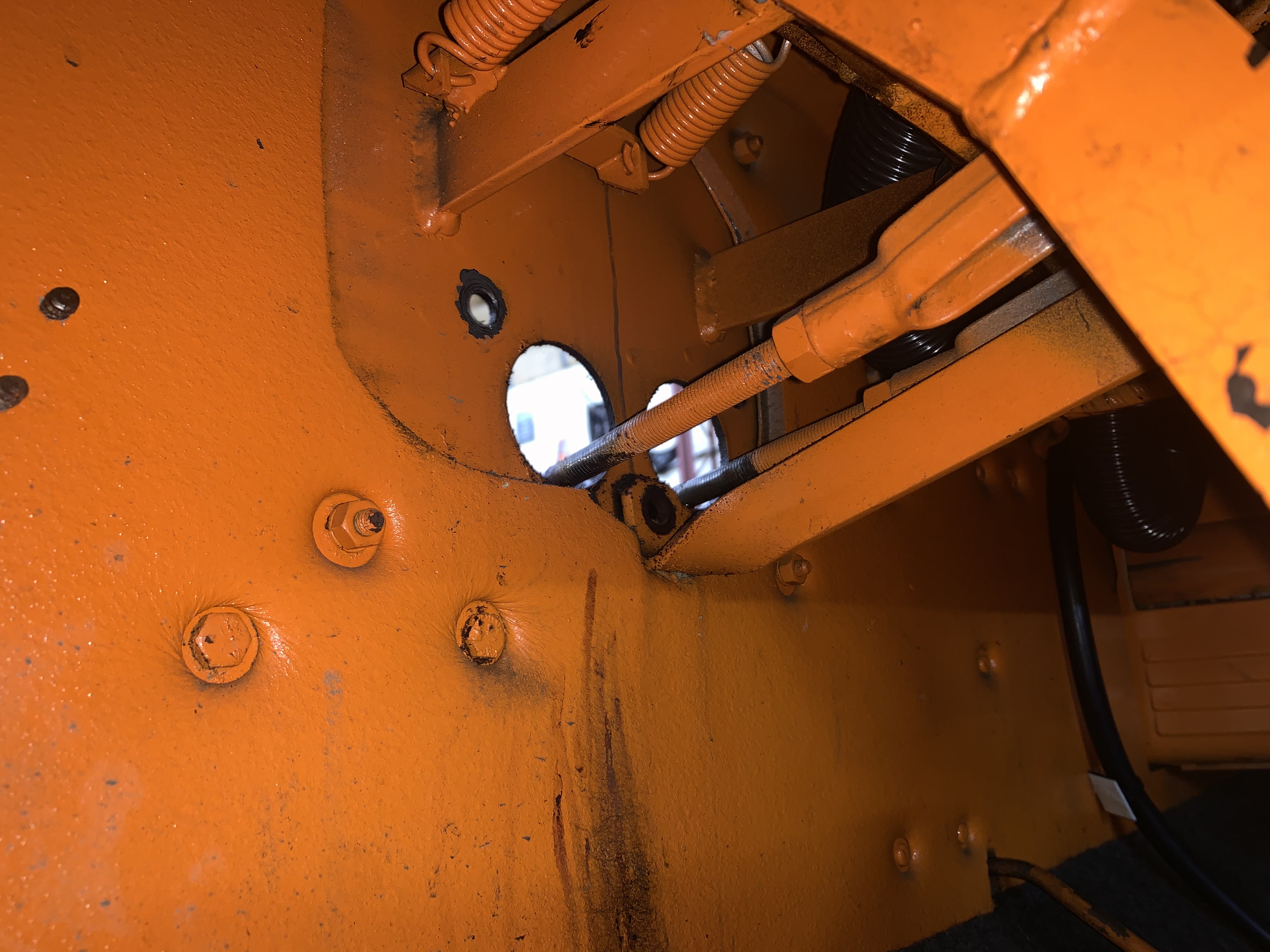

Track grouser nuts need to be torqued and some attention to the rear seat backs.

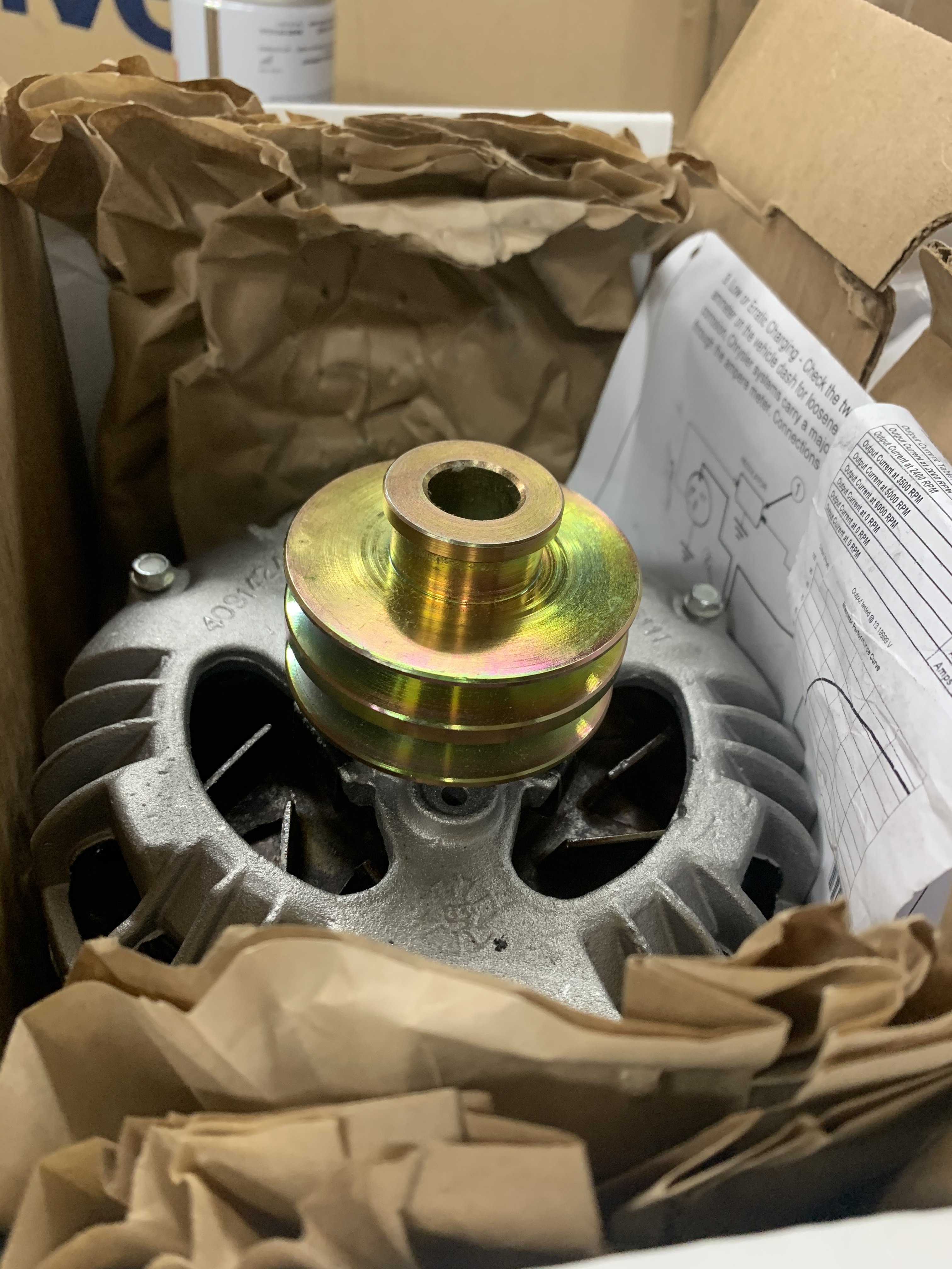

Put in some time last night. Wrong alternator was send with dual pulley so we are on pause there.

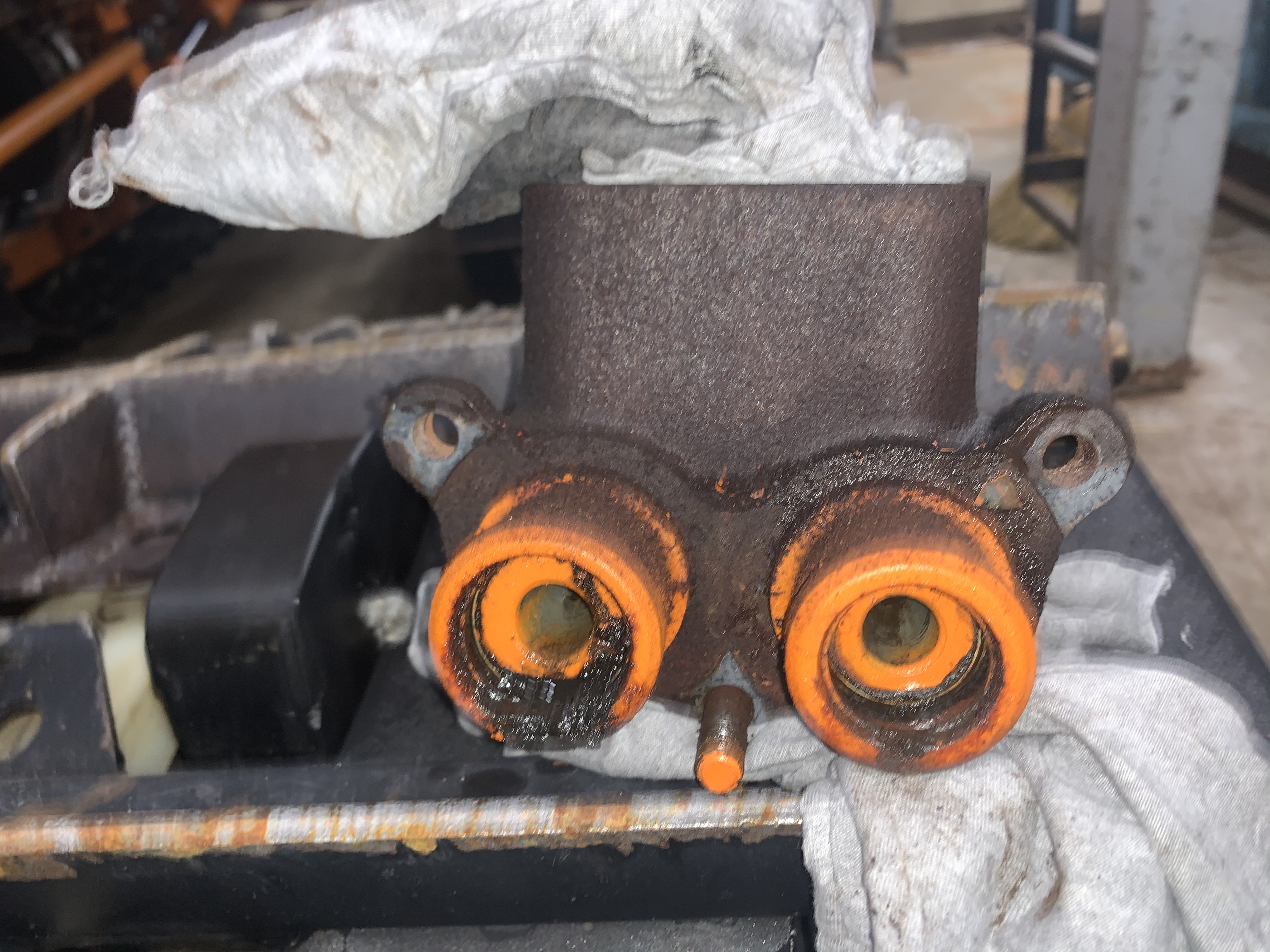

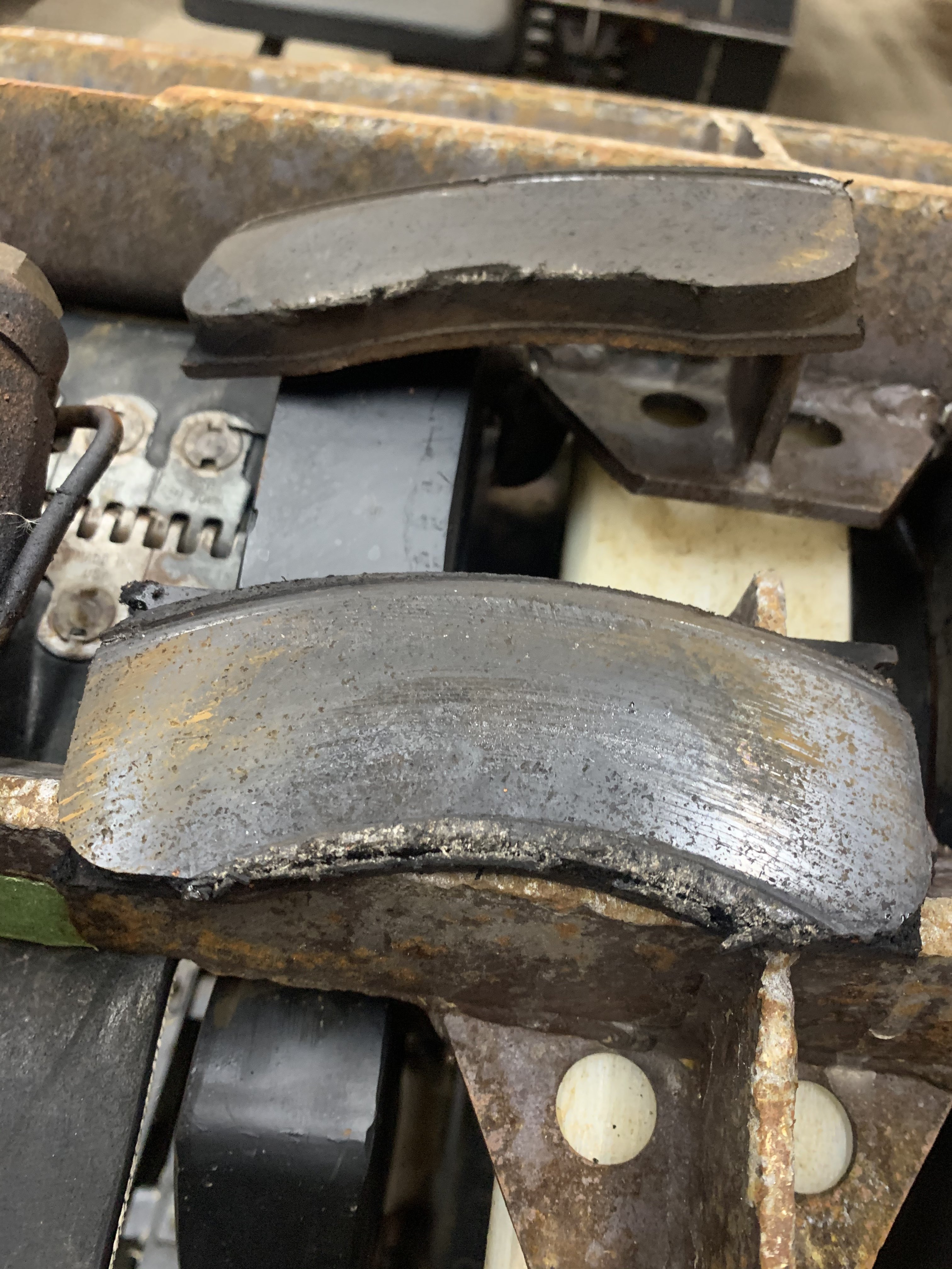

Brake caliber and pads have seen better days. Some melting, heat, and rust. Caliper and pads ready for install.
I and going to test the smaller master on the brake and see what happens. Easy swap if it doesn't work and Sno-Drifter will have a spare.

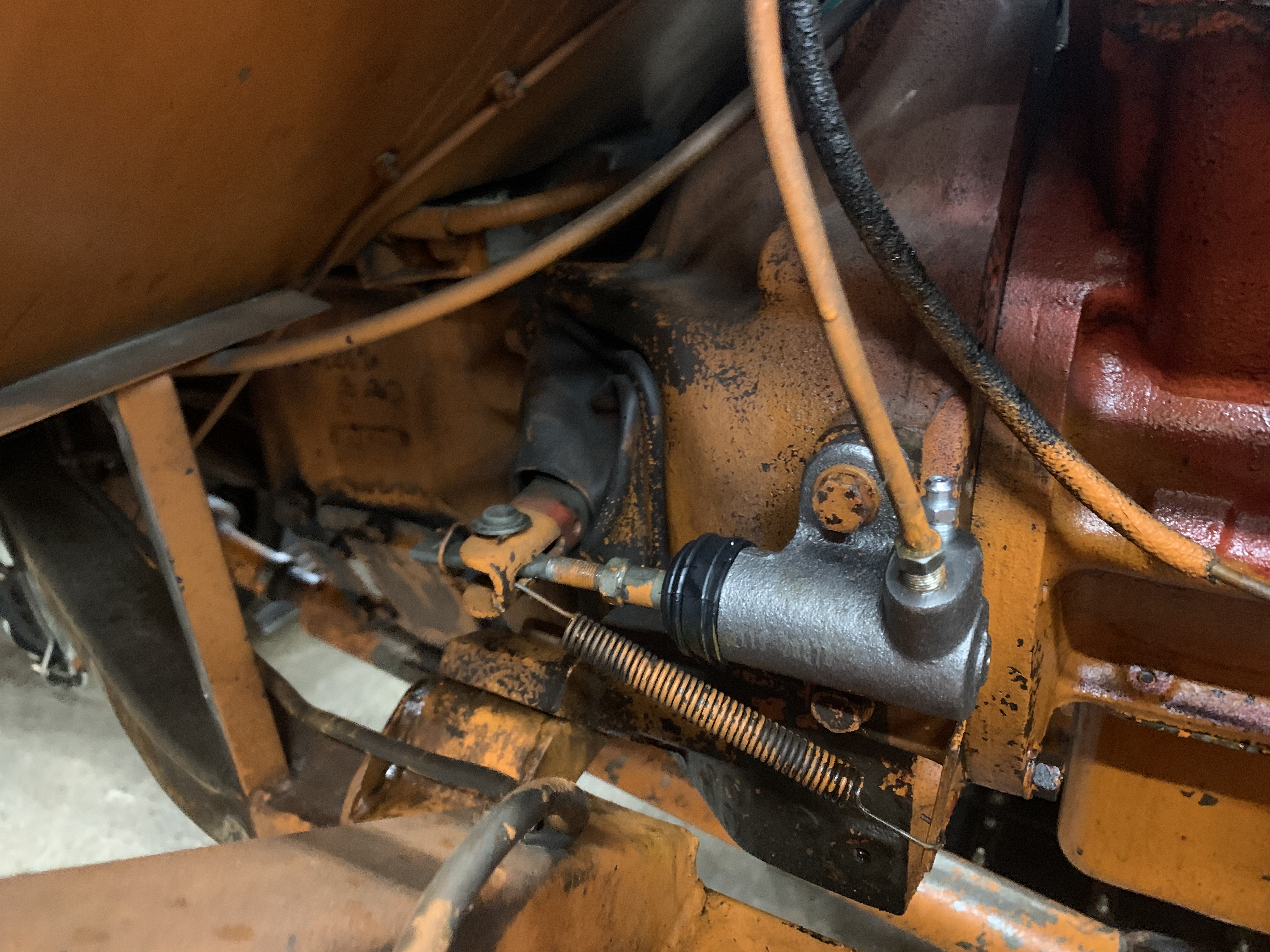

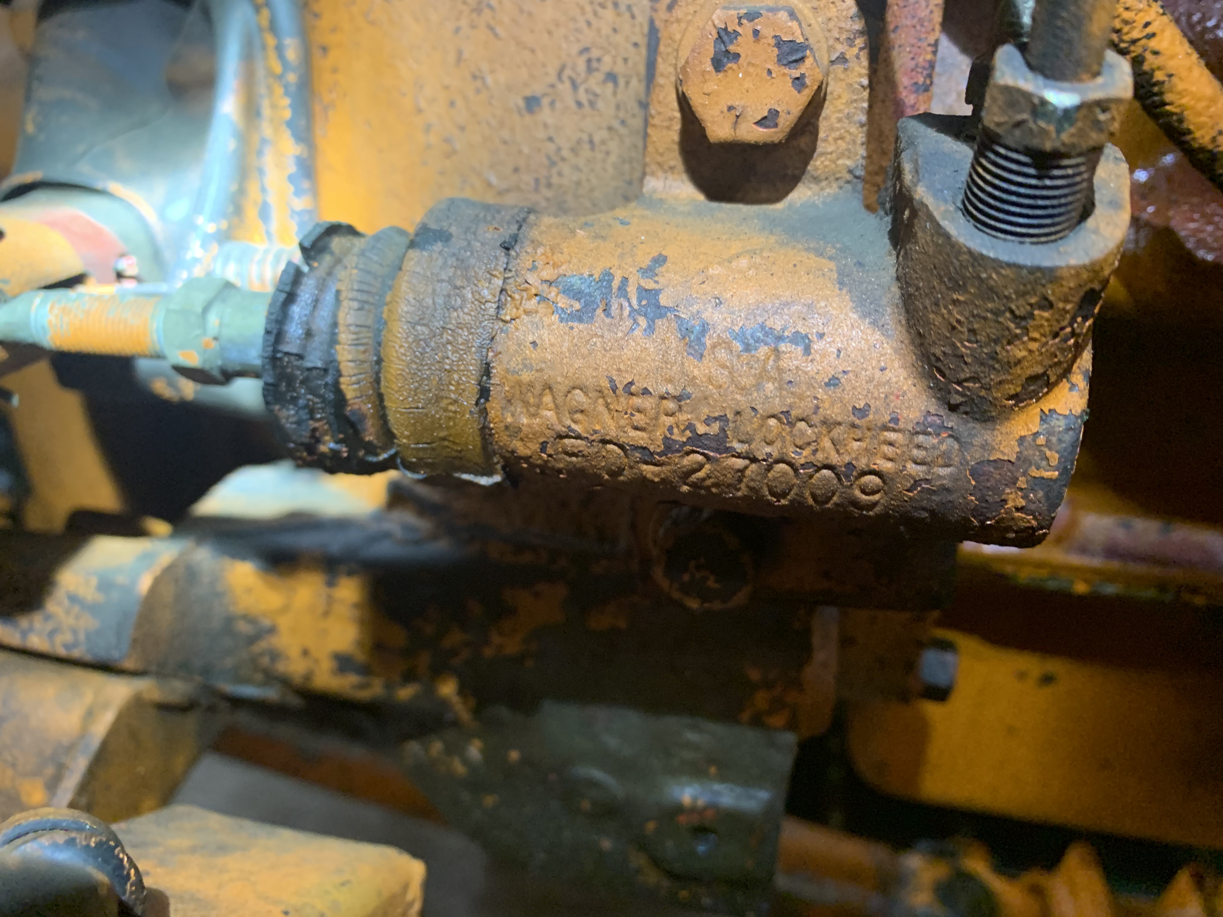

Clutch Slave looks like it's ready also. Walker Lockheed FD-27009 crosses to a Walker SC43307 or a Doorman CS33723.
Found all the parts will be here this afternoon for weekend install.

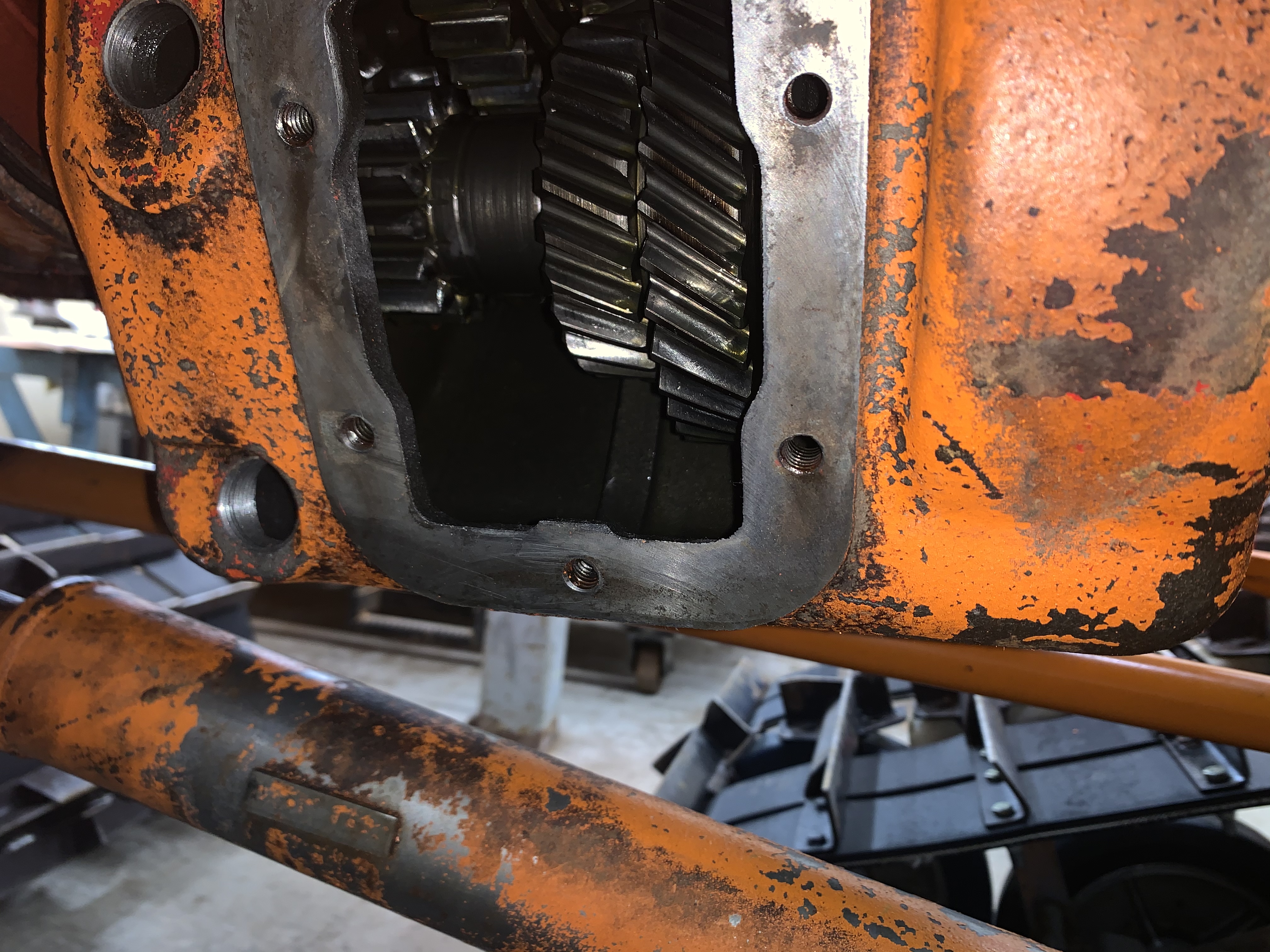

Yeah what was I thinking. Tucker QC is like the aerospace industry. Part is off by .0001 chuck it in the bin. No bending, pounding or prying to make it fit.
Optical illusion. Bolting you in a bit.

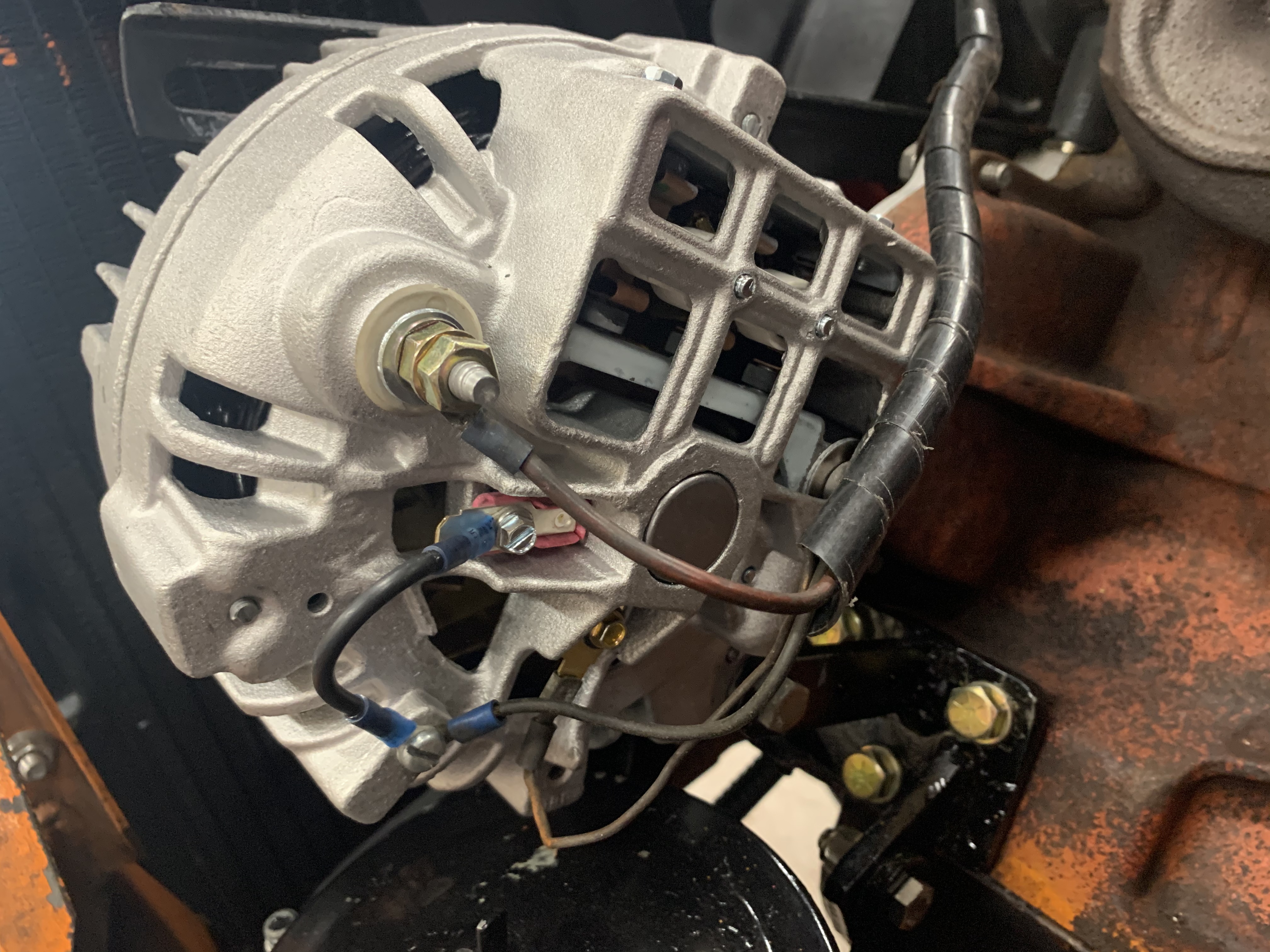

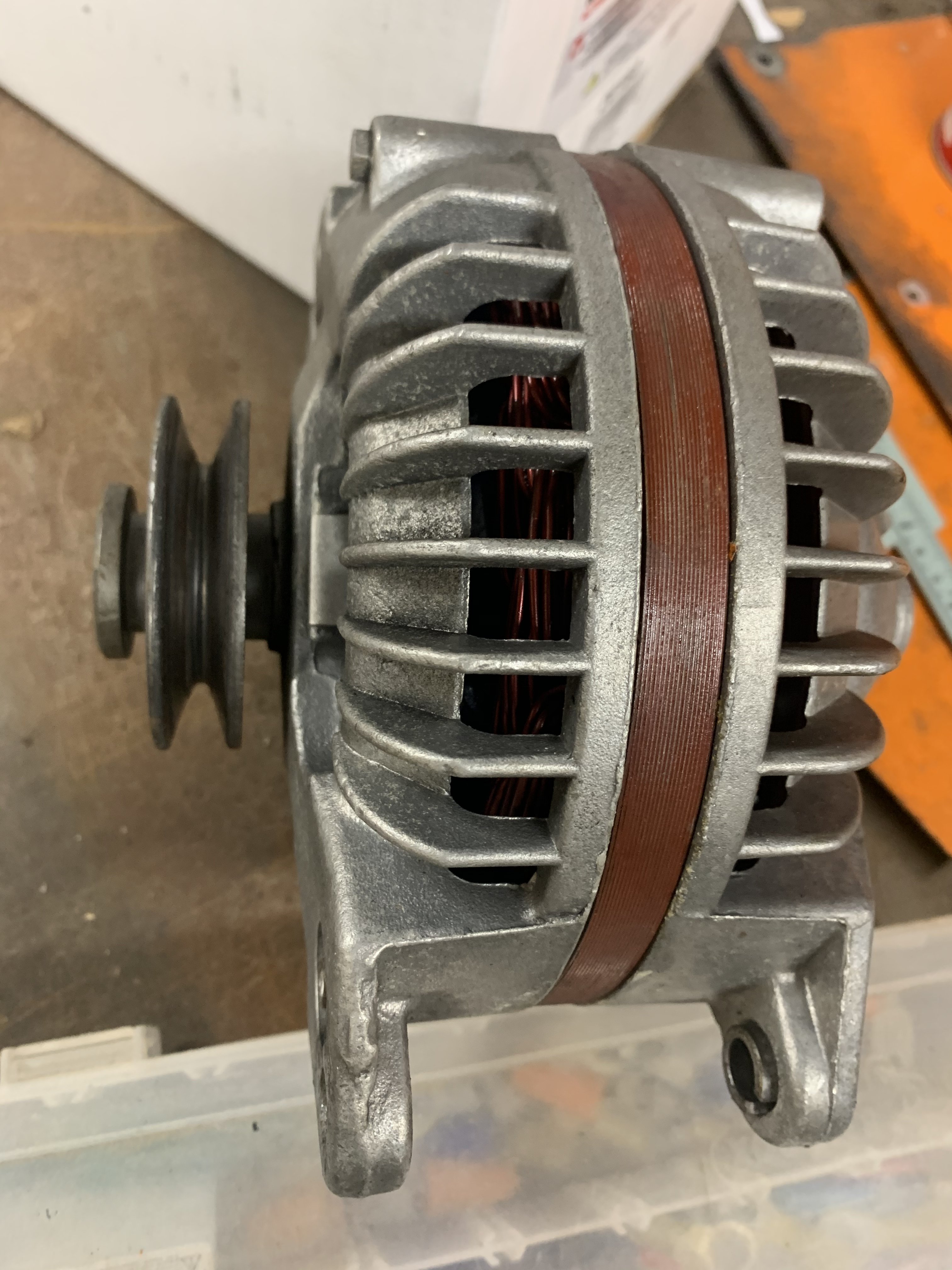

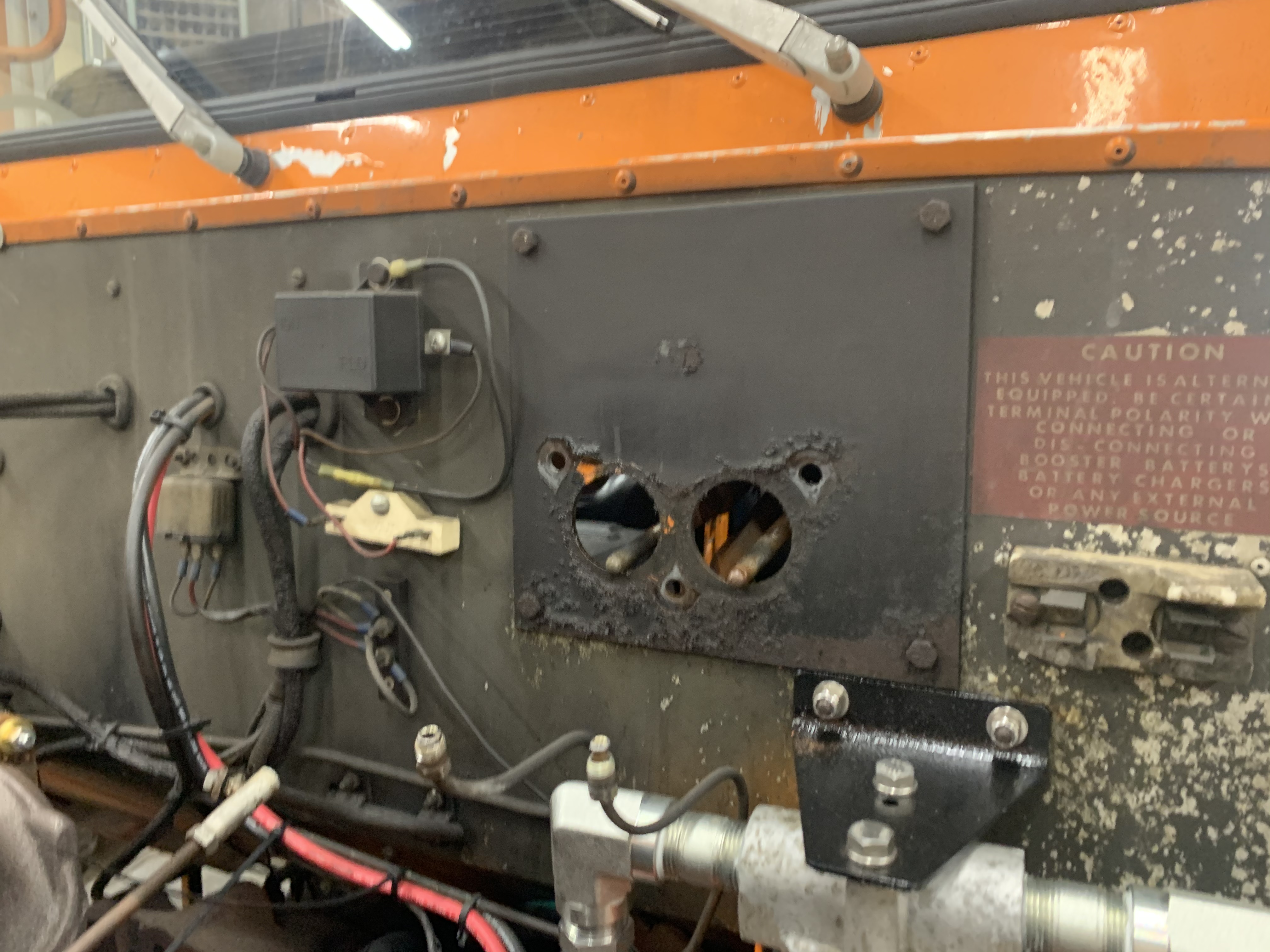

Sourced a replacement alternator. Original was a Round Back single field 37 amp. In 1970 Chrysler switched to a dual field square back which sent two field leads to the voltage regulator. The 70 forward version also charges at a lower
rpm which is helpful.
To make it work on the stock setup you send one field to ground as pictured.
A rewrire under the hood is due to occur at some point. I will update the voltage regulator and second wire then.
Strong Day. New master, clutch slave, brake pads caliper.
Had to swap the hard brake line on the new caliper for the older on. The stock one stated tighter to the caliper and allowed the clearance. The one one the new caliper would have needed some rebending.
The smaller 1 1/8" brake piston works great. Gives the extra throw it needs.

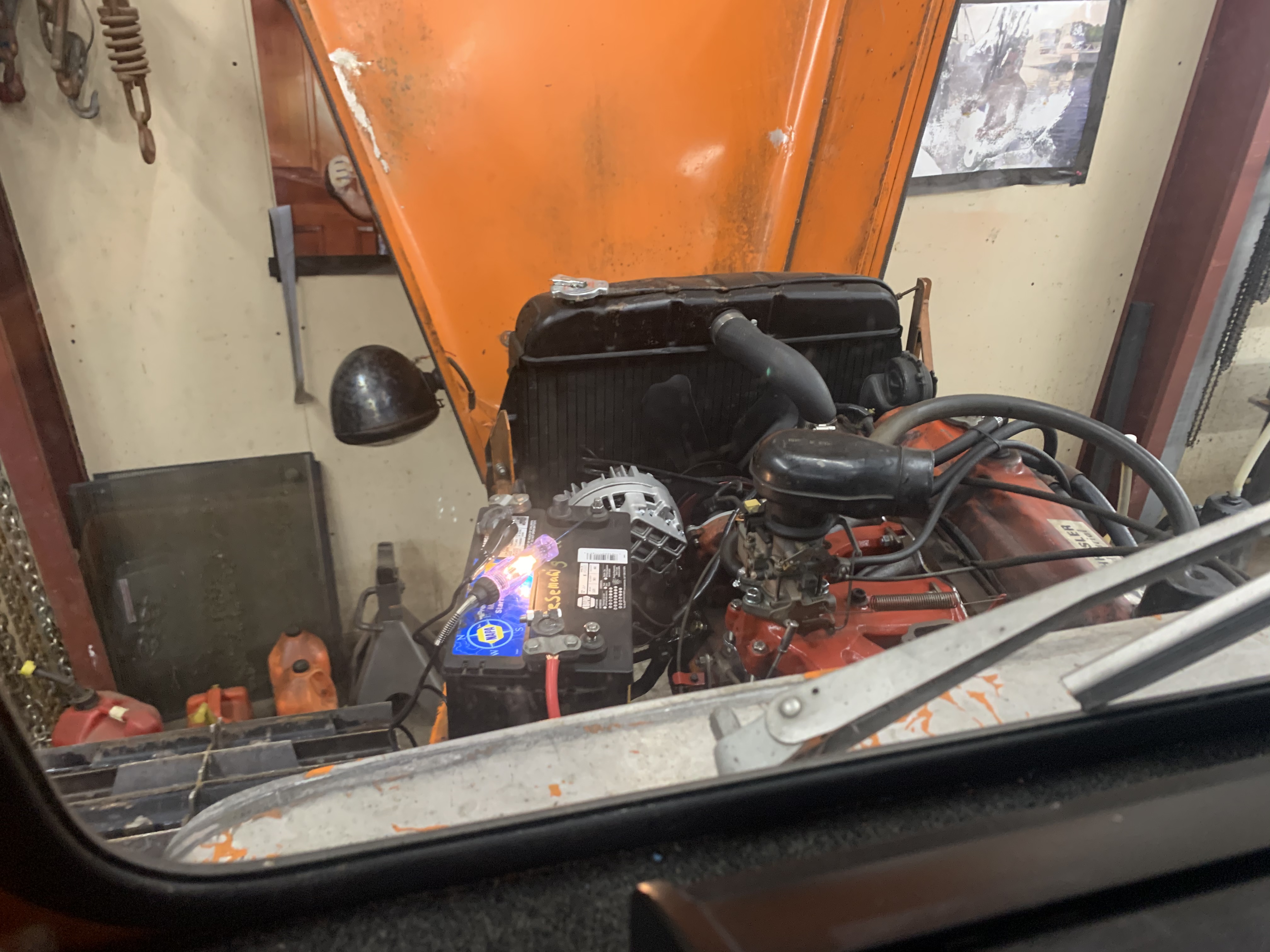

Battery drain continues. Tucker wants me to rewire under hood I guess and some attention.

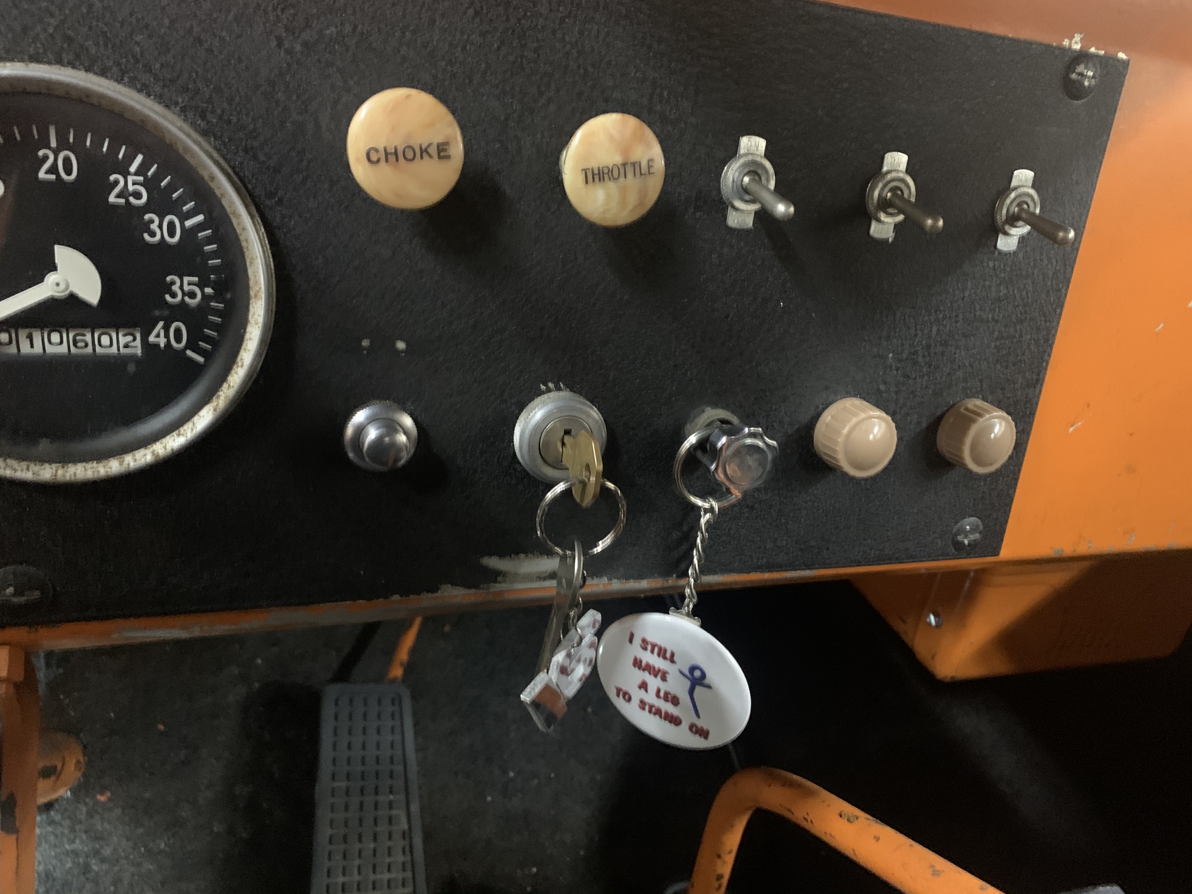

Found the draw! Windshield wiper switch is worn out. Thanks for the test light trick!
