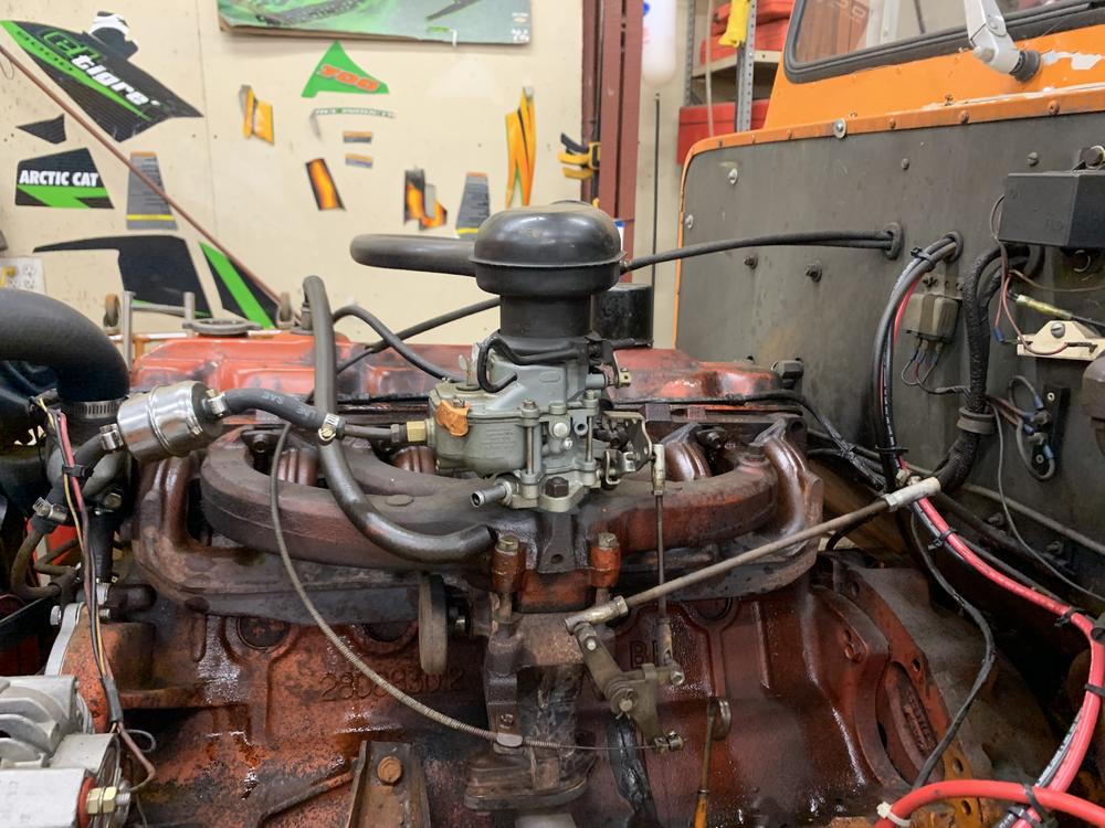

The mighty slant six.
First fall task is to address the exhaust leaks. Gasket blown out and the firewall side stud is broken off. Triage looks like a new manifold which I will probably ceramic coat. Might as well do the intake while at it.

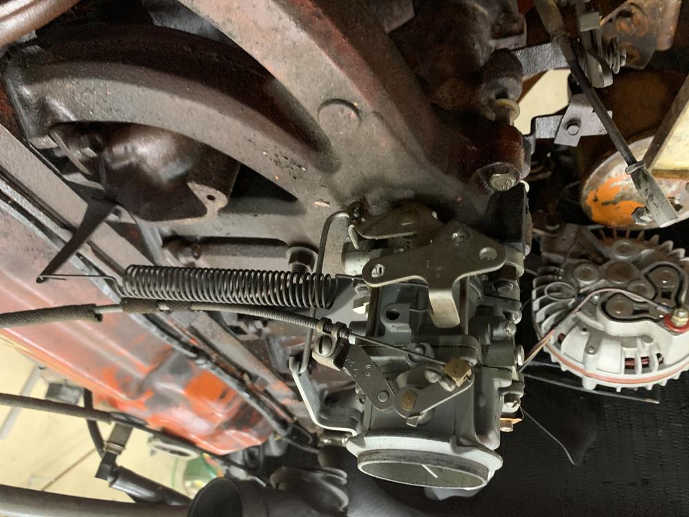

Linkage pics so I can get it back together.

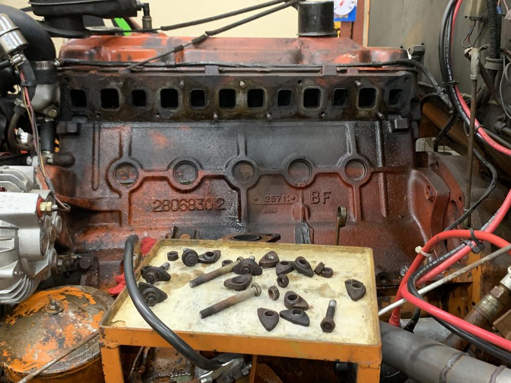

Exhaust manifold is warped so will be replacing with a doorman repop, arp studs, and gasket TBD. #13 rear stud has been broken off below the block surface since who knows. The front exhaust port was leaking due to the gasket disintegration. Manifold came off easy and the intake is in great shape for reuse.
Got 12/13 of the studs out and and threads cleaned. Going to use a mechanics drill guide with left hand bits to remove. Should be able to reuse the stock threads when done if it goes like it hope. That tucker tool tray was a rare option and is very useful. Good example of how nice the tilt forward hold is for access.
Found #13 manifold keep down resting on the motor.

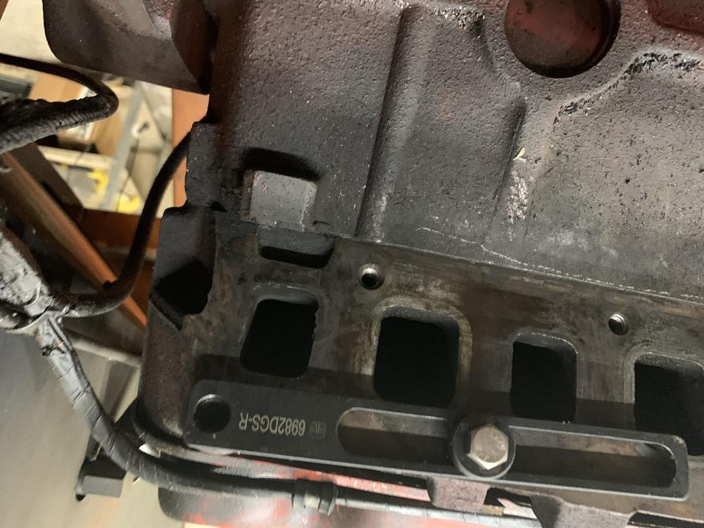

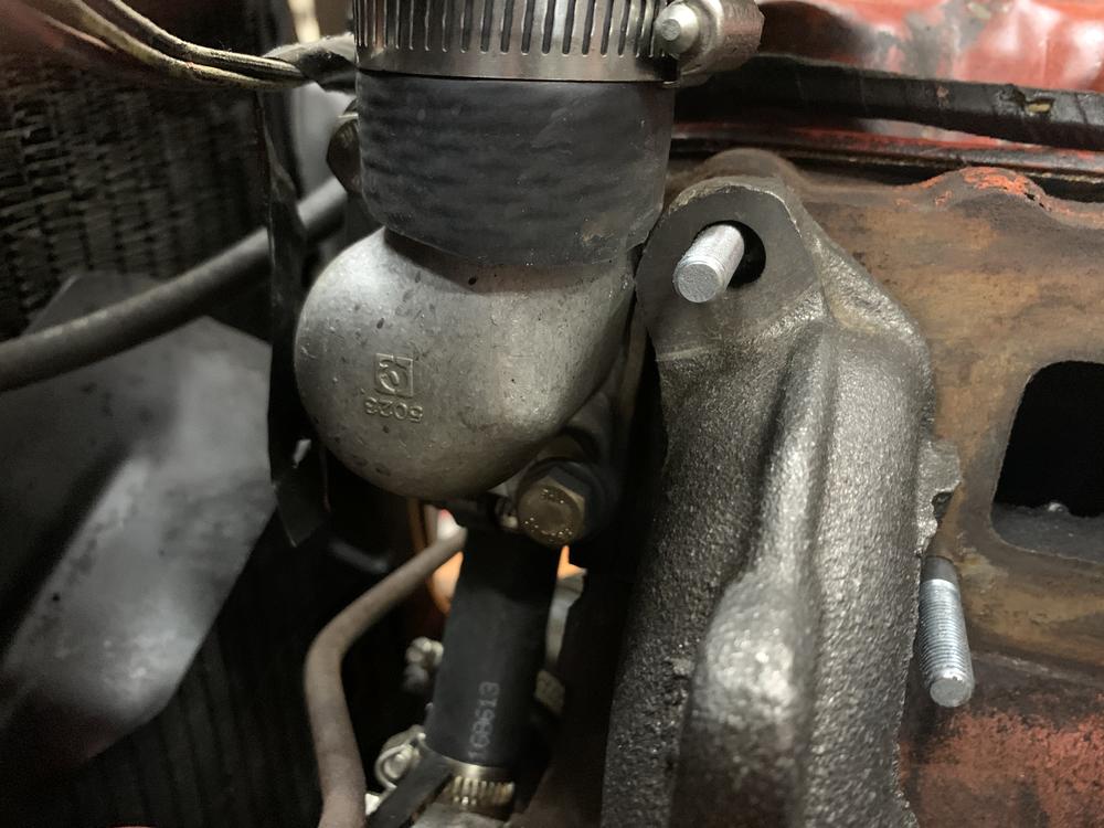

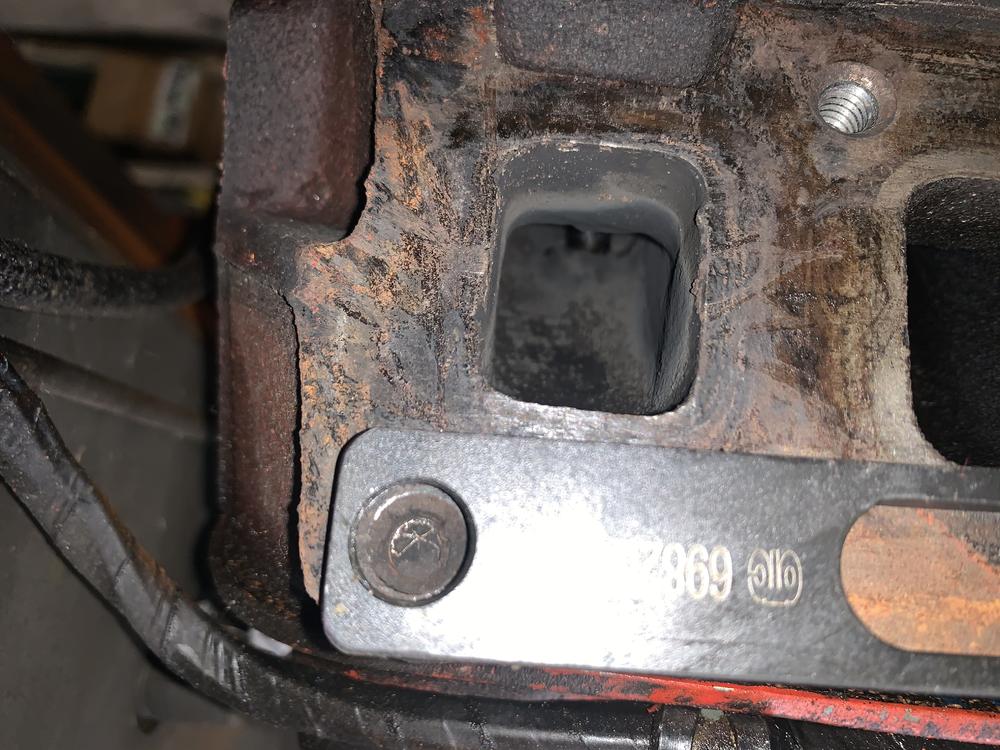

Getting ready to drill and try to extract the stud. This tool by OTC is an asset. Need some final adjusting but here is how it works.
Been soaking the stud and will clean the hole prior to drilling. Going to drill out up to 5/32 in 4 steps up and try to extract. If not will switch to left hand bits after with Tucker Sr guiding me. The surgical assistant will apply copious amounts of suction as that stud is in the water jacket.

I was skeptical about the stud coming out with the extractor. Had to give it a go tonight. Drilled as planned then tried a couple extractors. They all got to the point I said to myself “this is going to break off if I keep it up.” I took my own advice and went to plan B.
With a nice 5/32 hole centered from the drill guide I was able to step it up by hand from there with the oversight of Tucker SR. At 1/4” I was able to chase and clean out the treads with a tap keeping the oem 5/16 hole and thread. Most of the old stud came out like a helicoil. Slow and lots of removals and cleaning is key.

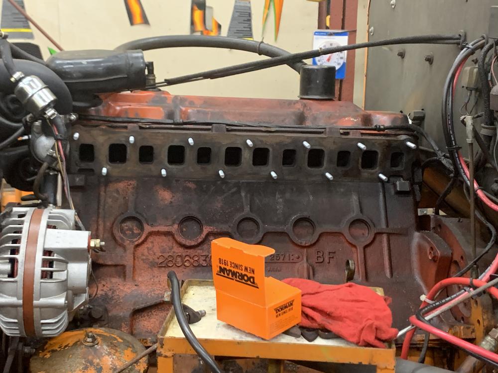

Have a new doorman exhaust manifold on the way. Test fit for the studs and have a new remflex gasket which has great reviews. Working on ceramic coating the manifolds. Maybe Chrysler red on the intake and black on the exhaust.
Looking for input on the best sealant for the studs as they enter the water jacket?

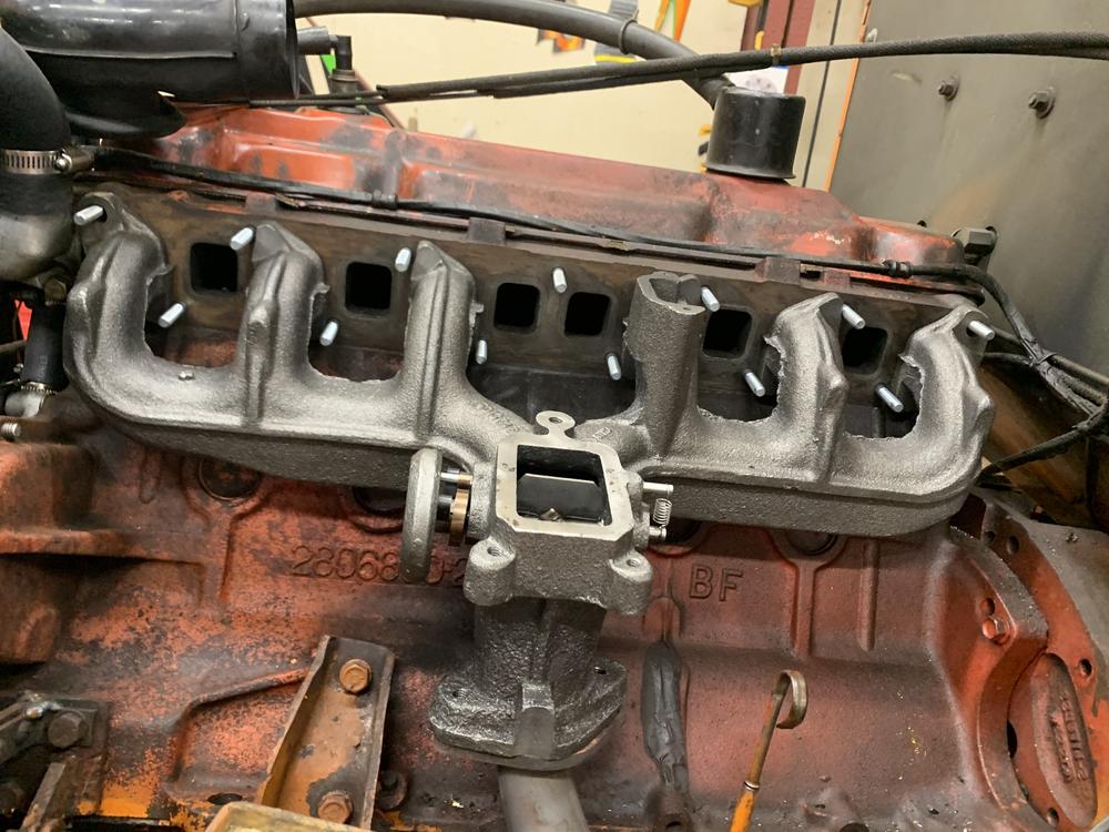

Got the new manifold from doorman via great deal Rock Auto Fits well but needs grinding by the thermostat housing.
Shying away from the ceramic coating or any paint. Don’t want to take the mechanism apart to do correctly. Been unpainted 45 years what’s another 45?
Ordered some new hardware. Next step is to mock up both manifolds for fit and go from there.

Nice work getting that broken stud out. I like that tool you used.
Totally agree!
My so-called "success rate" with E-Z Outs in removing a broken bolt/stud is probably about 5%. But being able to center the drilled hole, and then carefully upsize the hole and use a tap should improve that significantly as the E-Z Out won't be needed, and that's not a good thing, it's a GREAT thing! Thank you for the nice write-up and information!
(I ordered the OTC tool.)

Nice work Mr. T&A. I will get one of those extractors. The only EZout I have had limited success with are the ones with the four straight tapered sides. The spiral ones only expand to make the stud/bolt tighter in the threads.

Mocked up the intake and the new exhaust manifold. Little more grinding down the casting seam. Fits well.
Went with loctite water jacket and head bolt sealant for final assembly.
