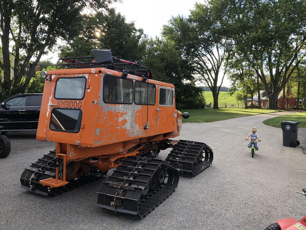

Tucker woke up from hibernation and has been moved into work position.
Worklist before sno:
Front carrier bushings
Front table pivot bushing
Table and spring bolt bushings
See how trunion looks unsure what’s needed yet.
Oil pan gasket

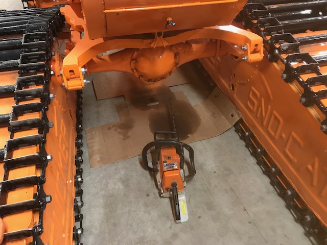

Boys and I put the hammer down tonight. Clearly we need to work on some right tool for the right job ediquete.
J.Tucker recovering from high speed wobble crash on balance bike. Endo no hands face plant. Amazing he has sprockets in his mouth. He decided full time helmet best for all!
Smooth disasssembly up until drivers side axle. Metal flaked off like the 442 except this one doesn’t have the dual key way salvation on other side. Have another axle but not ready to propose yet. So going to axle glue the fragments back in swap sides so keyway pushes forward on the meaty side. Taper with most key and a good snug will work. Both hubs were loose and nuts.
Few make shift shims behind sprockets to take up the tilt wear on the carrier. That will be fixed.
Tie rod off, drive shaft off. Smooth disassembled night 1.

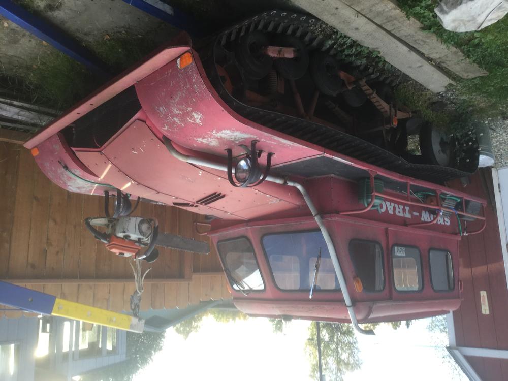

Mr Addict,
I like your idea for chain saw bar oiling. But will pass on the broken axle, leg, and kid.
Looks like a brittle axle to me,or one really hard key!! you changing it out ? or just building it back up with weld? welding would probably make it more brittle and also bow the end a bit.:unsure:
Going to swap sides so the key pushes on other side of ever got loose. Going to use some adhesive/retainer to hold the flakes back on and suck it up real tight with the nut.
Have another axle but saving it for now.
Scott, Your going to get that flying goose all oiley!!:smile: I need a lot more cats if im going to oil my saws like that !! Don
Saws are getting older, cats are getting rougher. Don knows what is coming next.

My saws are currently getting a spa treatment with the GL-4 from the transaxle. :(

Guilty as charged. The Stihl is in the cat. Which doesn't leak. Much...
