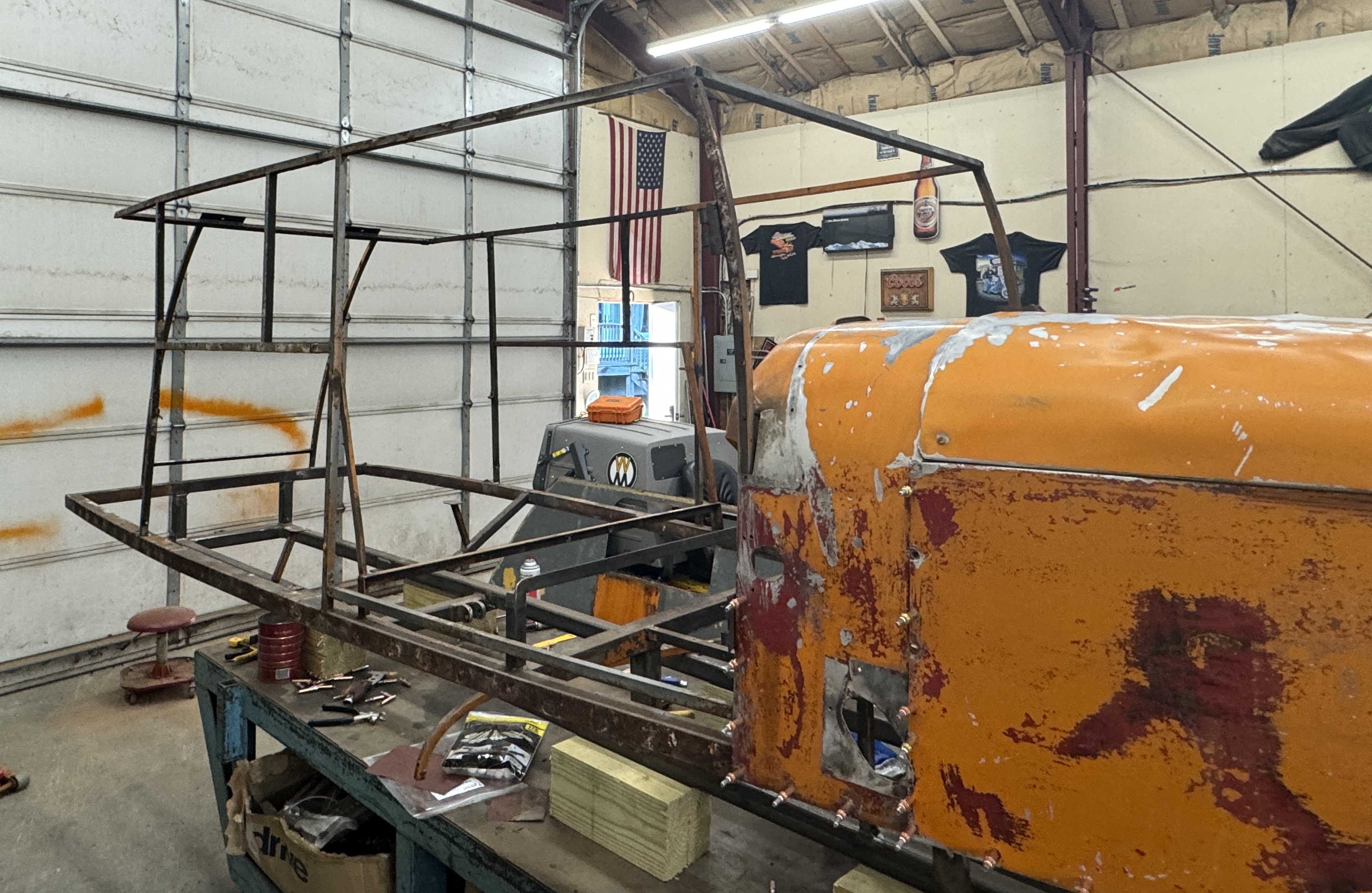

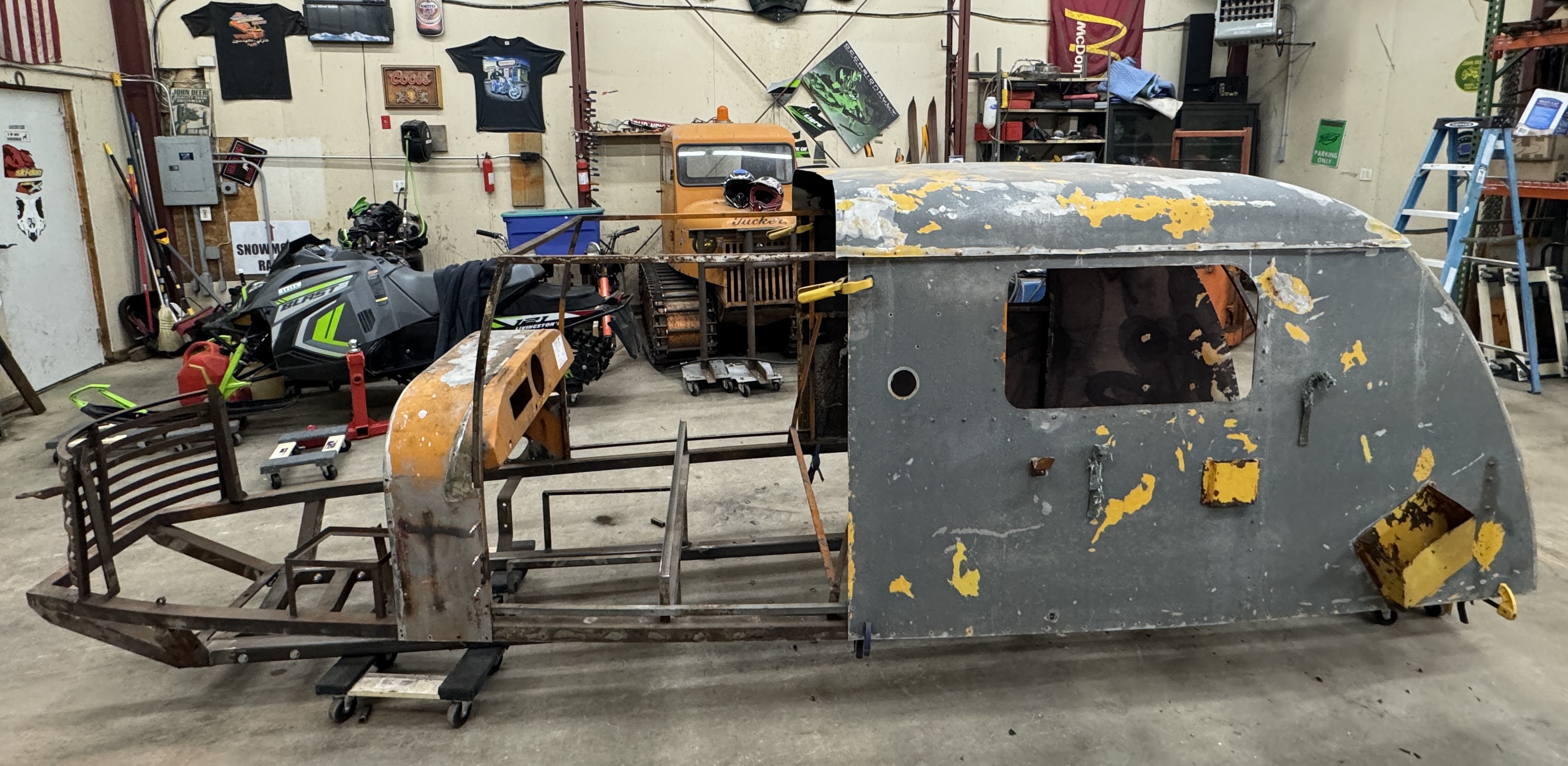

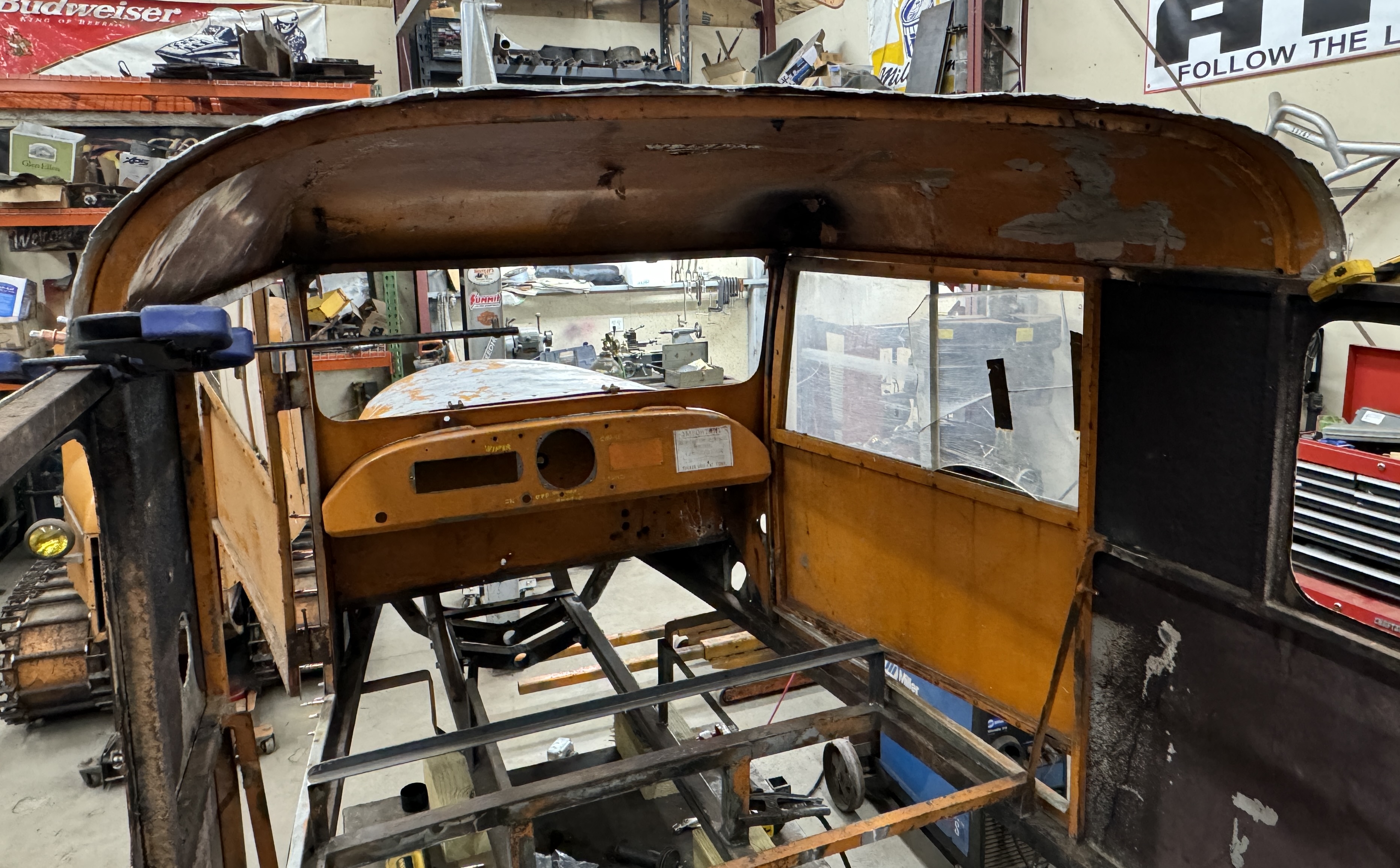

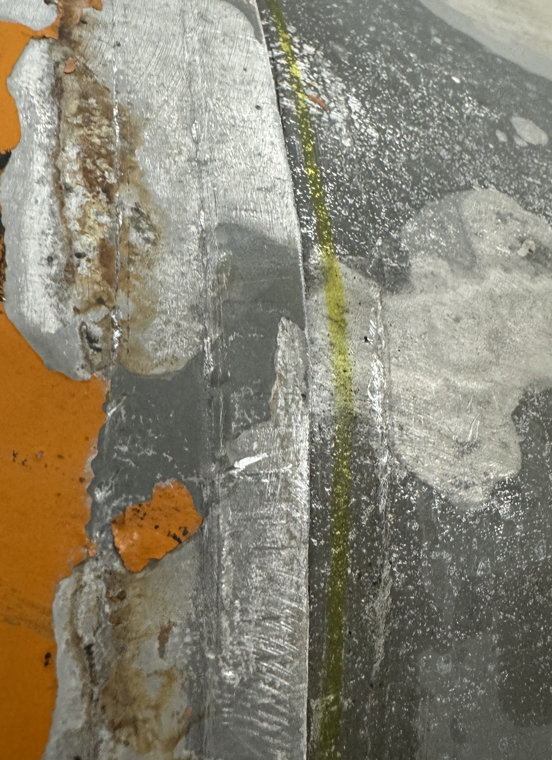

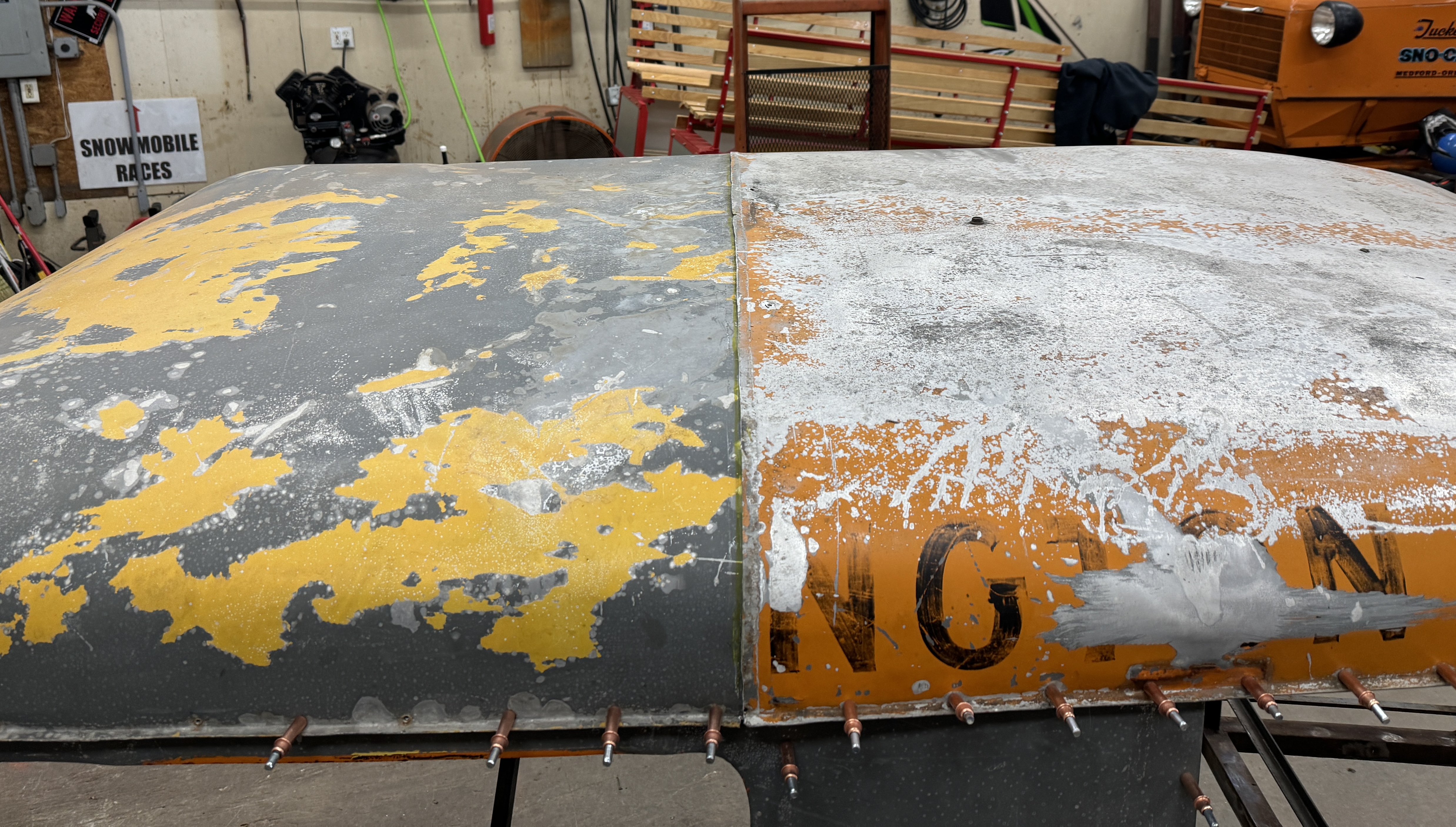

It’s starting to speak to me. Few different ideas and locations to blend the roof seam. The donor has more material and is nicer but want keep as much of the OE roof and lettering as possible. How nice we can get the front will dictate the direction.
Orig and donor parts playing nicely so far….

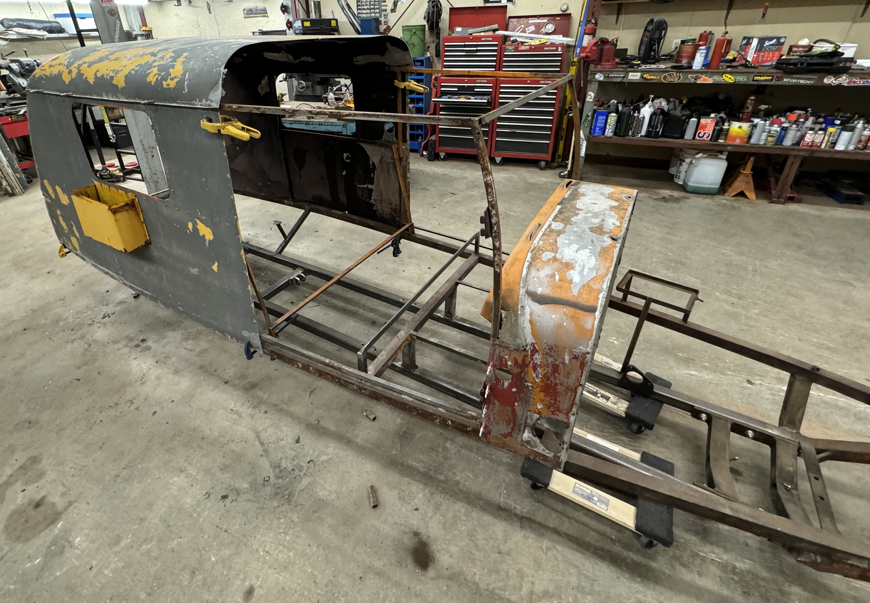

Marty has started to reveal the external finish. With the body mocked up I was curious as to how the finish the exterior.

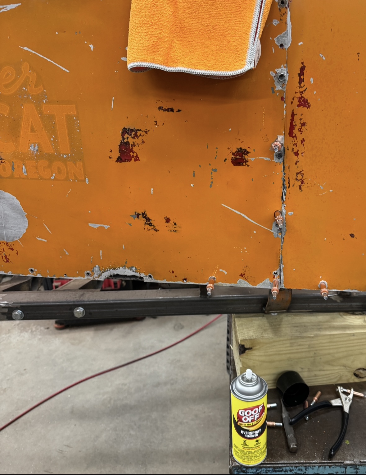

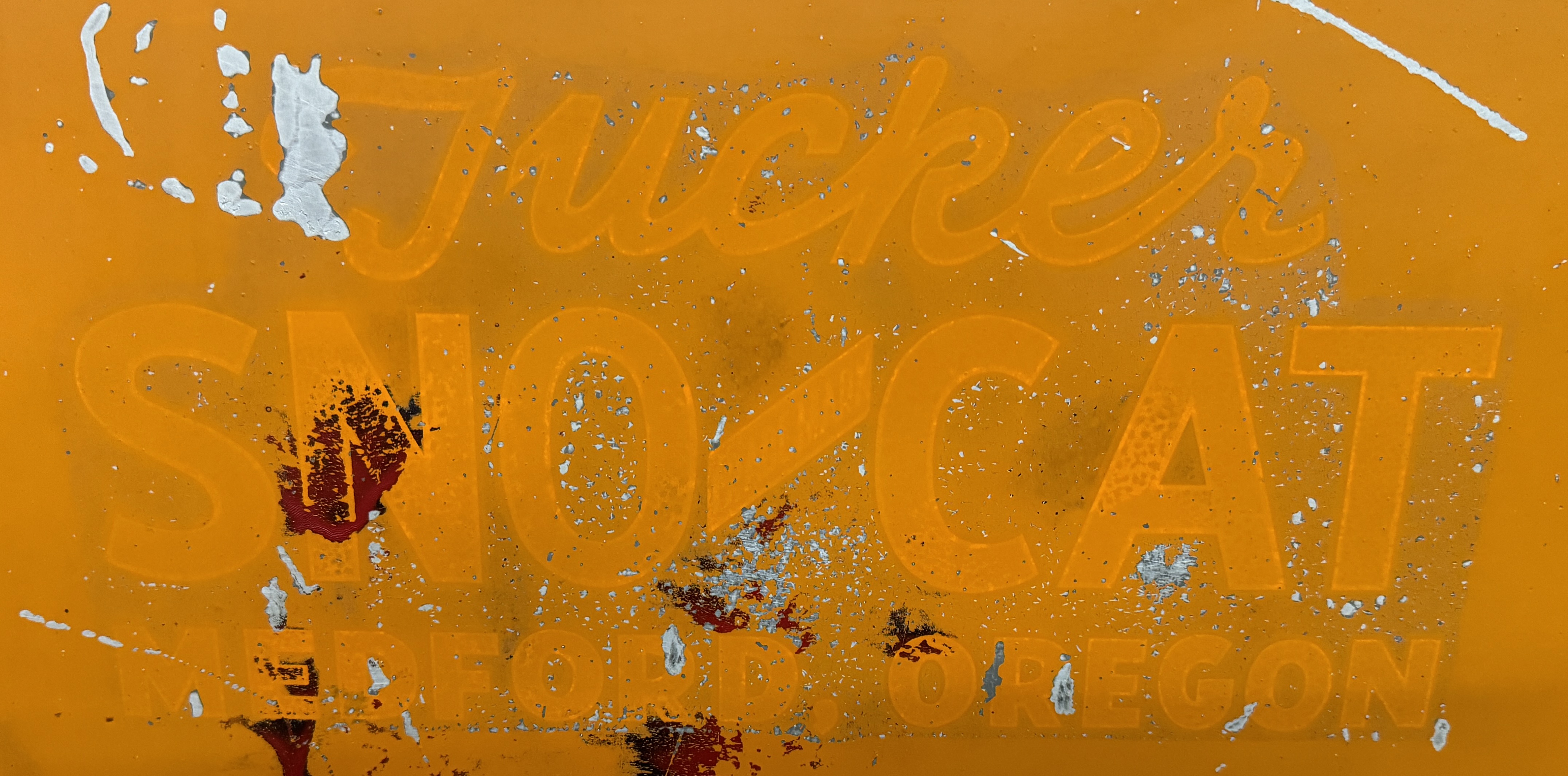

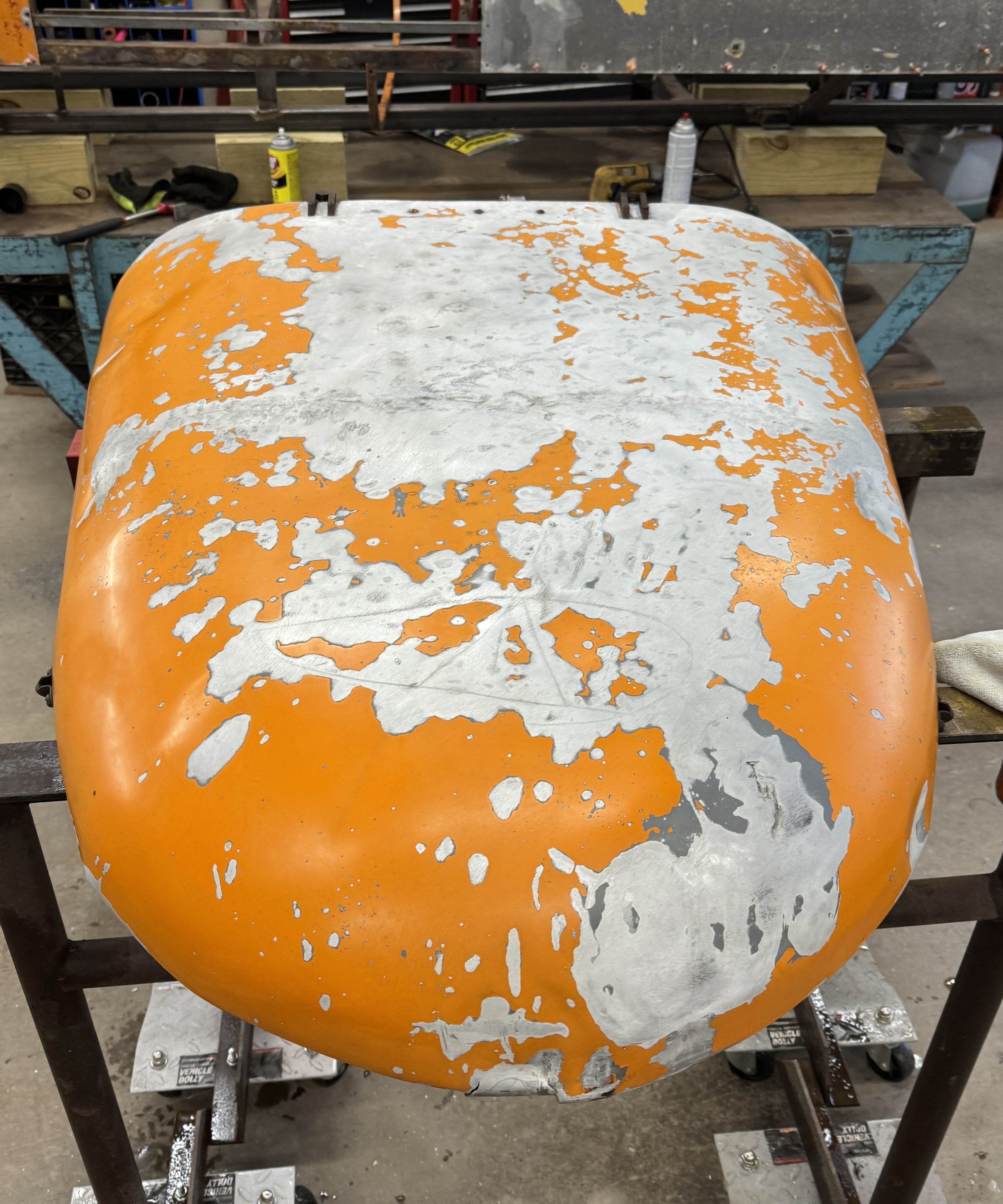

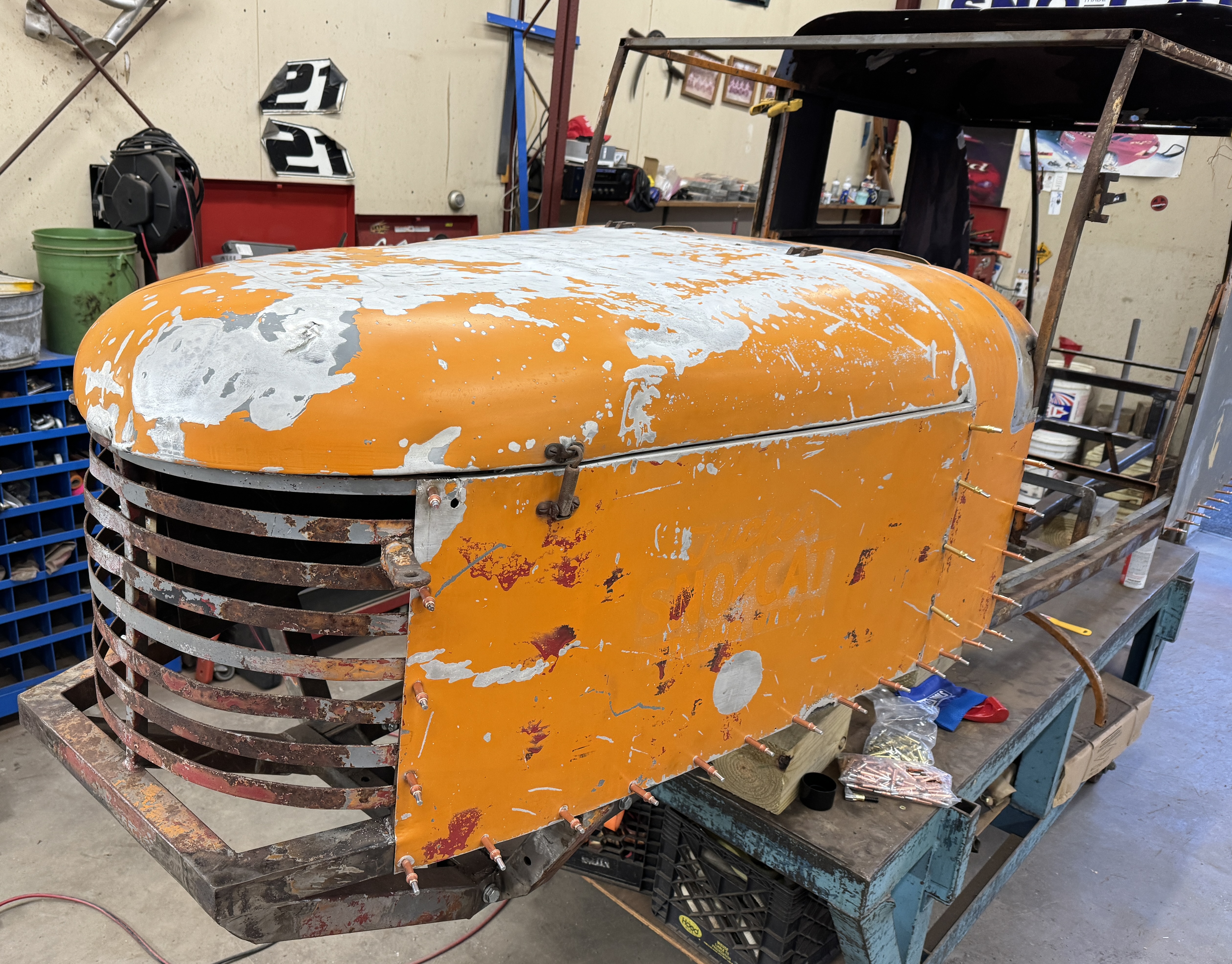

Wanted to get the graffiti off the bare aluminum or what appeared to be bare…..
Before:
Love ❤️, orange 🍊🧡 microfiber towels, goof off overspray remover, acetone, and pure carbuna wax was the trick for first pass.

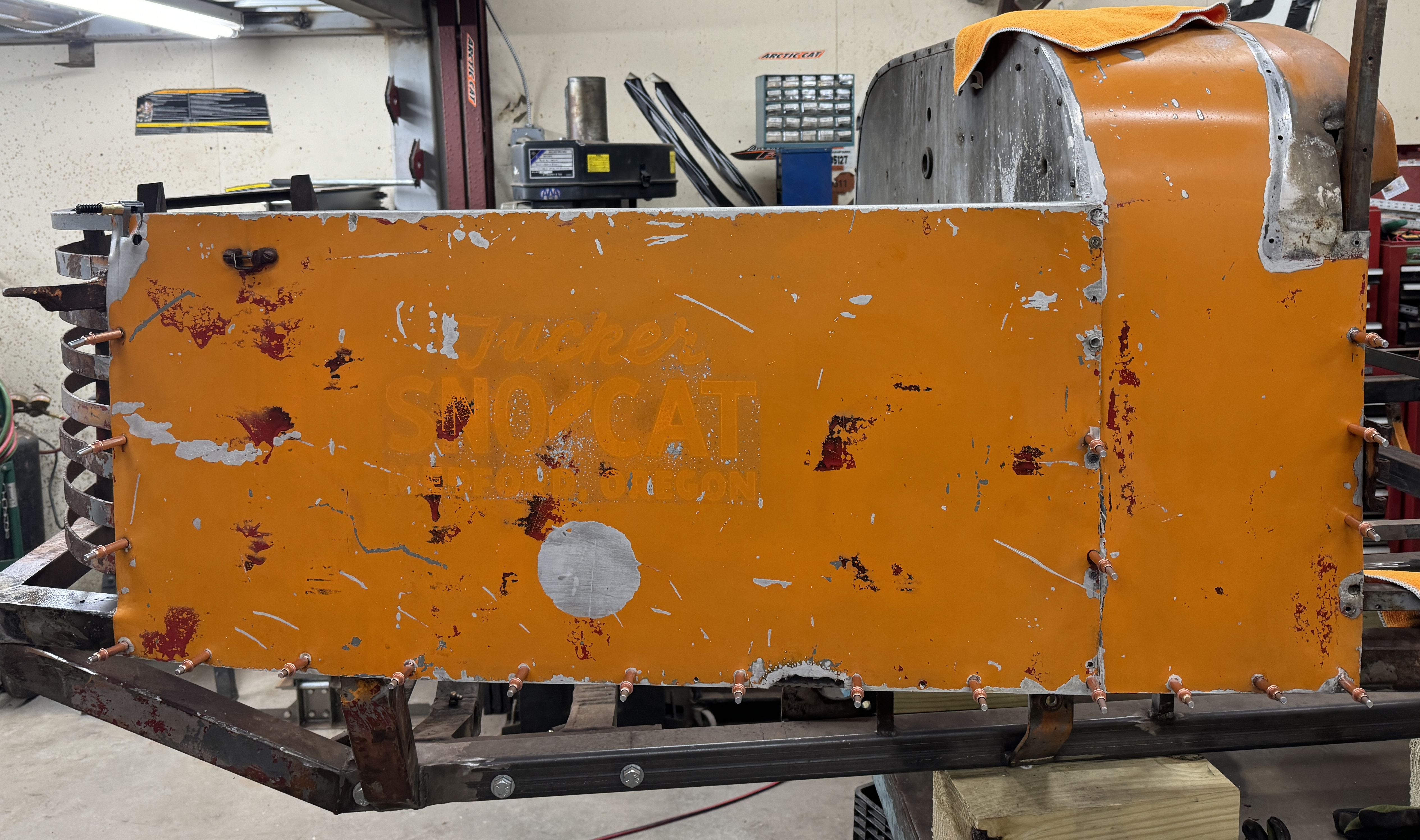

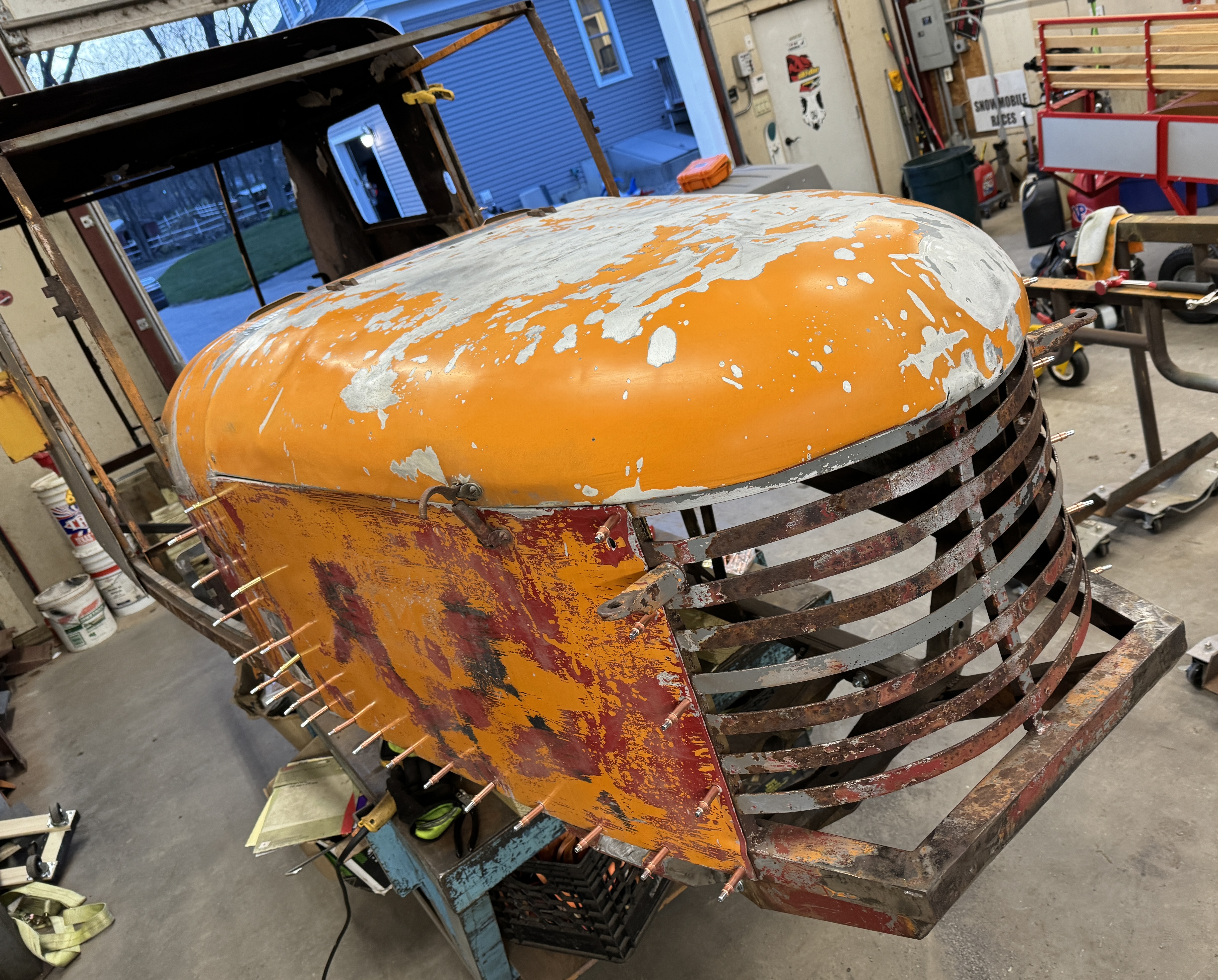

From what I can tell it left MT Washington orange. At some point the side panel Tucker Sno Cat logo was masked off and it was painted silver or maybe primer? There is clearly red which has more on the other side yet to reveal itself. Seems like the silver was on for a bit before it became red because it appears the red on bare metal stuck but the rest baked off in the sun. I think the passenger side was the shade side so stay tuned…

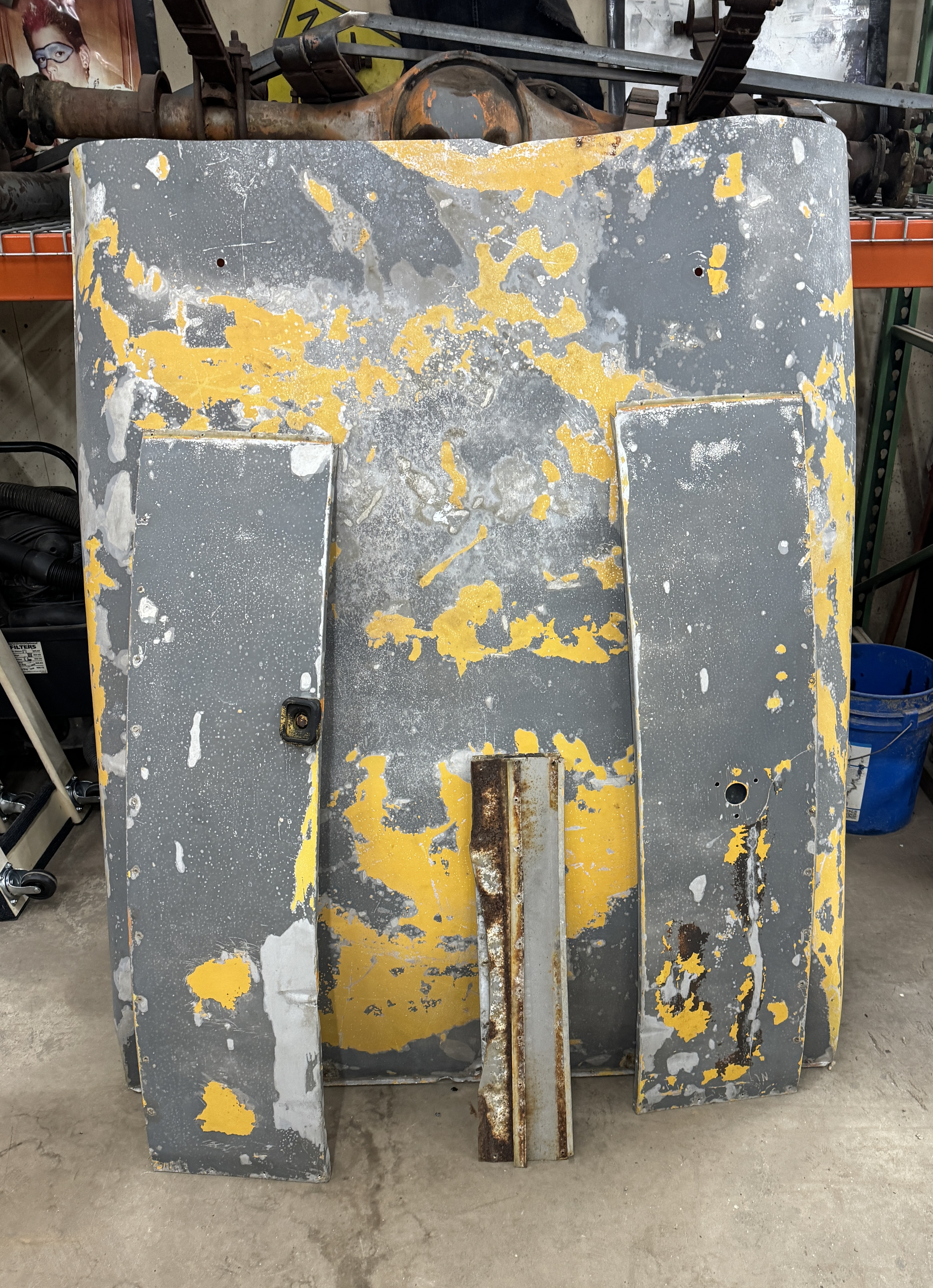

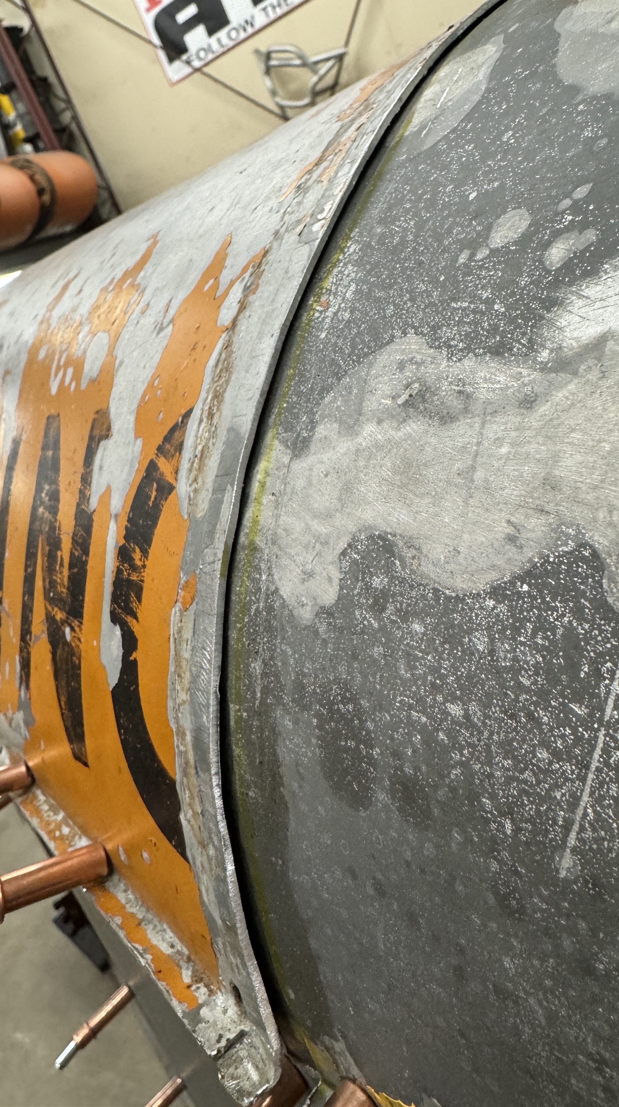

Now that I can see the finish, I tested striping the donor body which went smooth.
The vision is coming together and the finishes will be a living storyboard of it’s rich history from Oregon, to Sno Cat Corp of NH, to MT Washington, to WMTW, to Wildcat Mountain?, to logging operation in Bethel, Maine ??, to Ayotte’s Junkyard Oxford, ME, to East Coast Preserve Haverhill, MA, to be shared for the future!
Marty on the Mountain and beyond! Great tribute finish for his legacy as the Summit of the project 202?

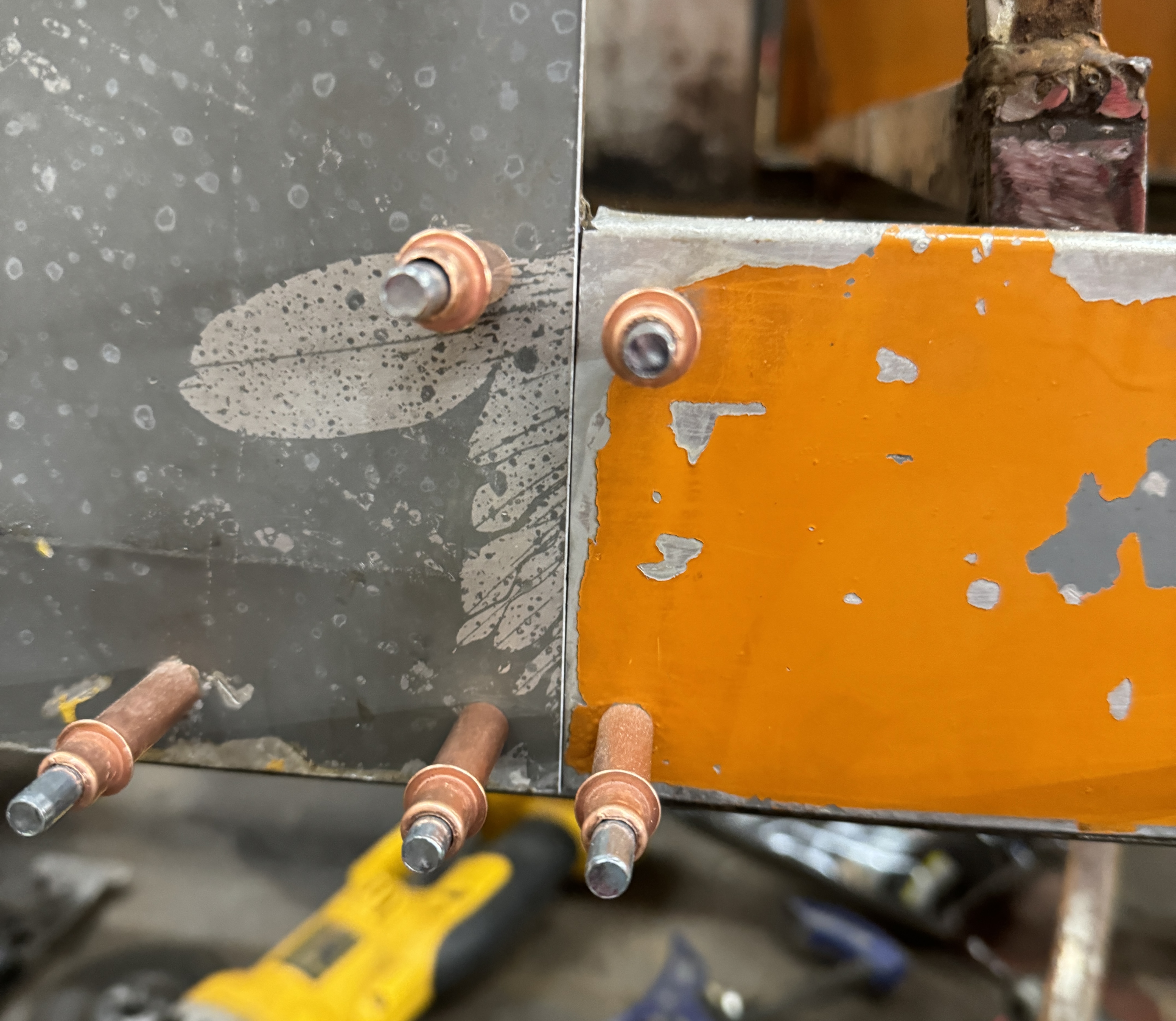

Welded all the frame holes and redrilled 1/8” on these panels. Going to need to get creative with the body to body holes for aesthetics but all workable.
It’s looking like something.
They look to all be born orange before they become something else.

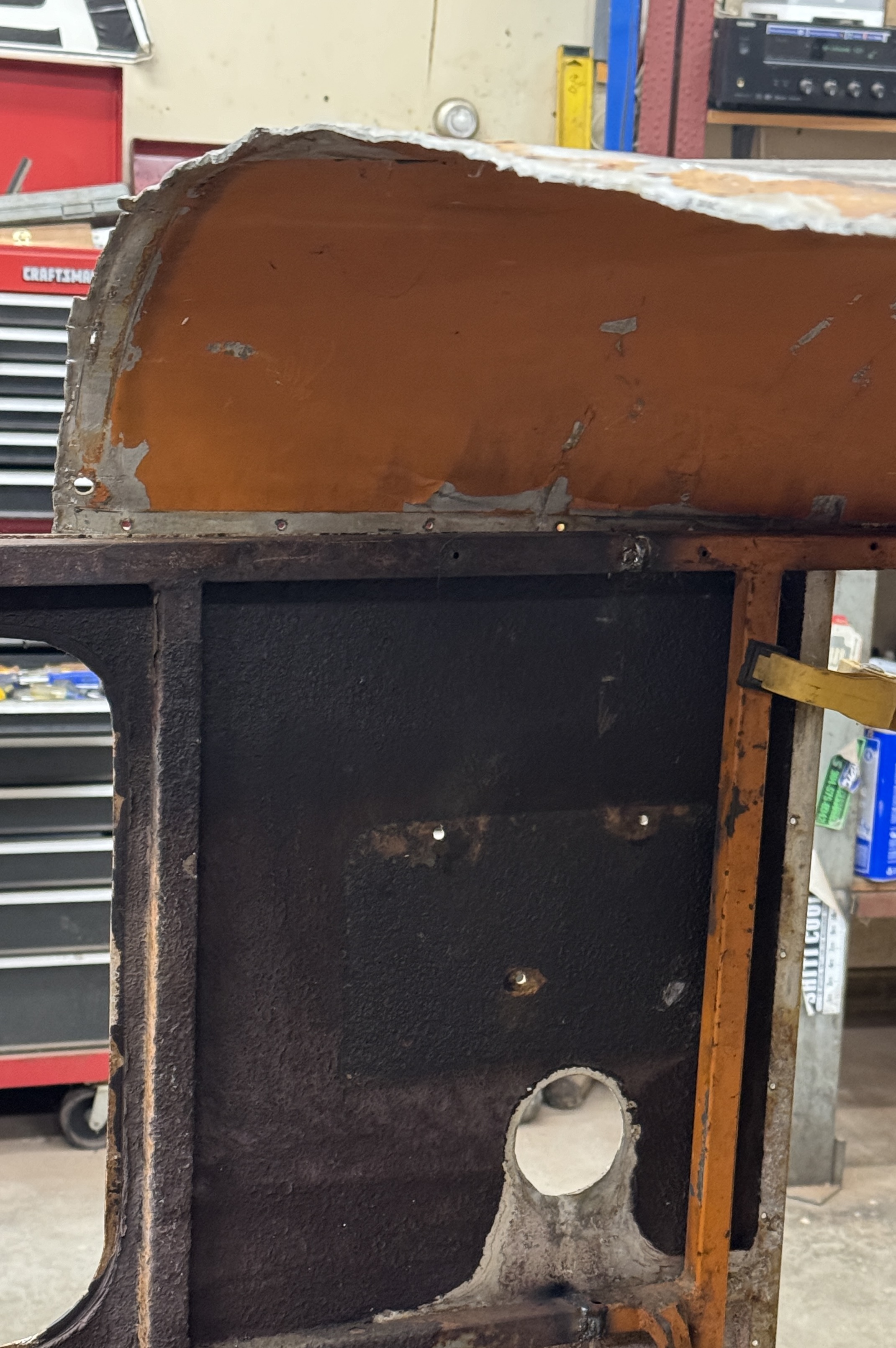

Removed the shovel holder, axe holder, storage box, interior oil holder and fire extinguisher. Marty wouldn’t have the axe or shovel holder or the storage box. Fire extinguisher is in seating space so TBD.
We will use these items on another project or display possibly.

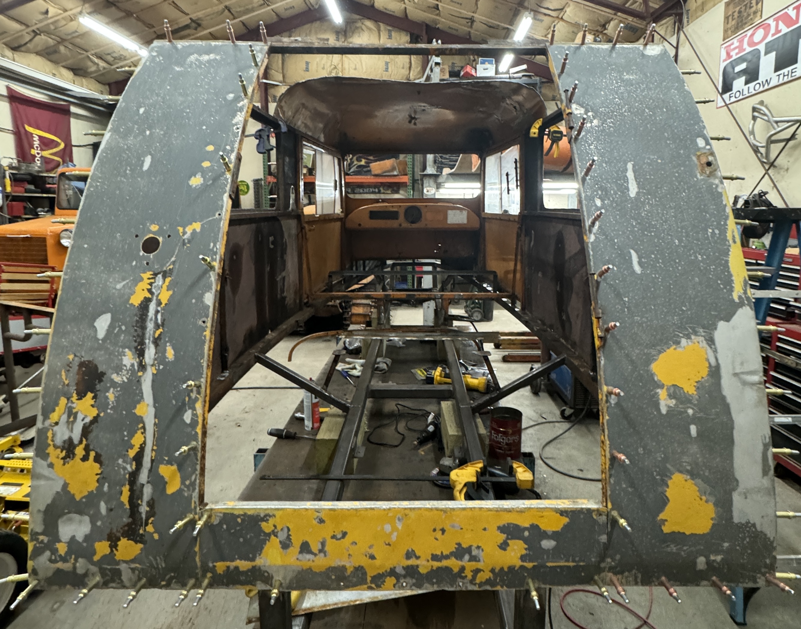

Side panels scribed and ready to be sheared to size.
Worked on some frame blending.

Just a side line bench warmer comment. If you fit this up in an avg spring time temp's. Consider riveting it in same temps.
I fit up all the skins on *the thing* cat in spring. Then riveted in summer and yes i was chasing incrementally small amounts of slack here and there. I chatted with some vintage plane restorers and its a thing in their world.
Maybe your shop is AC'd
$.02

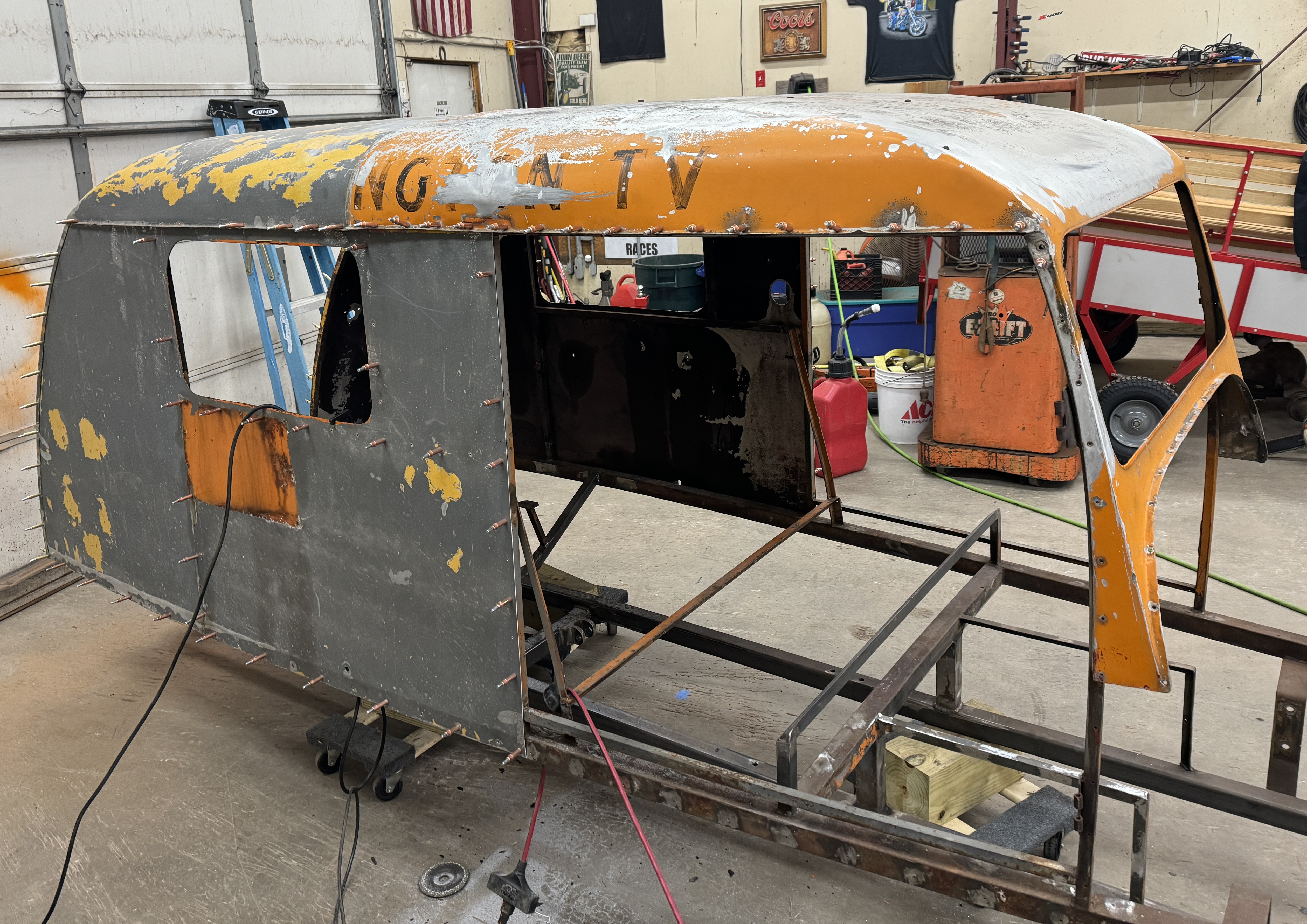

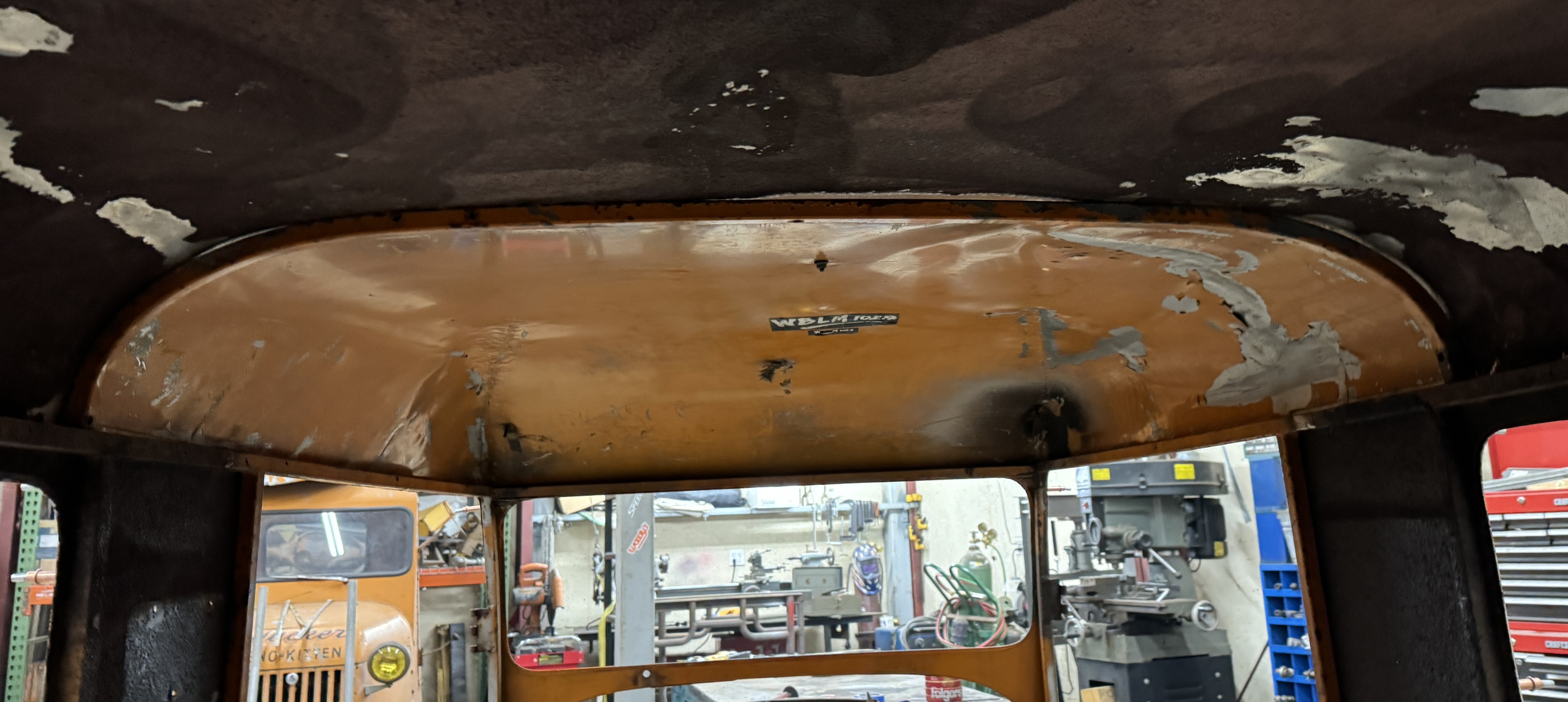

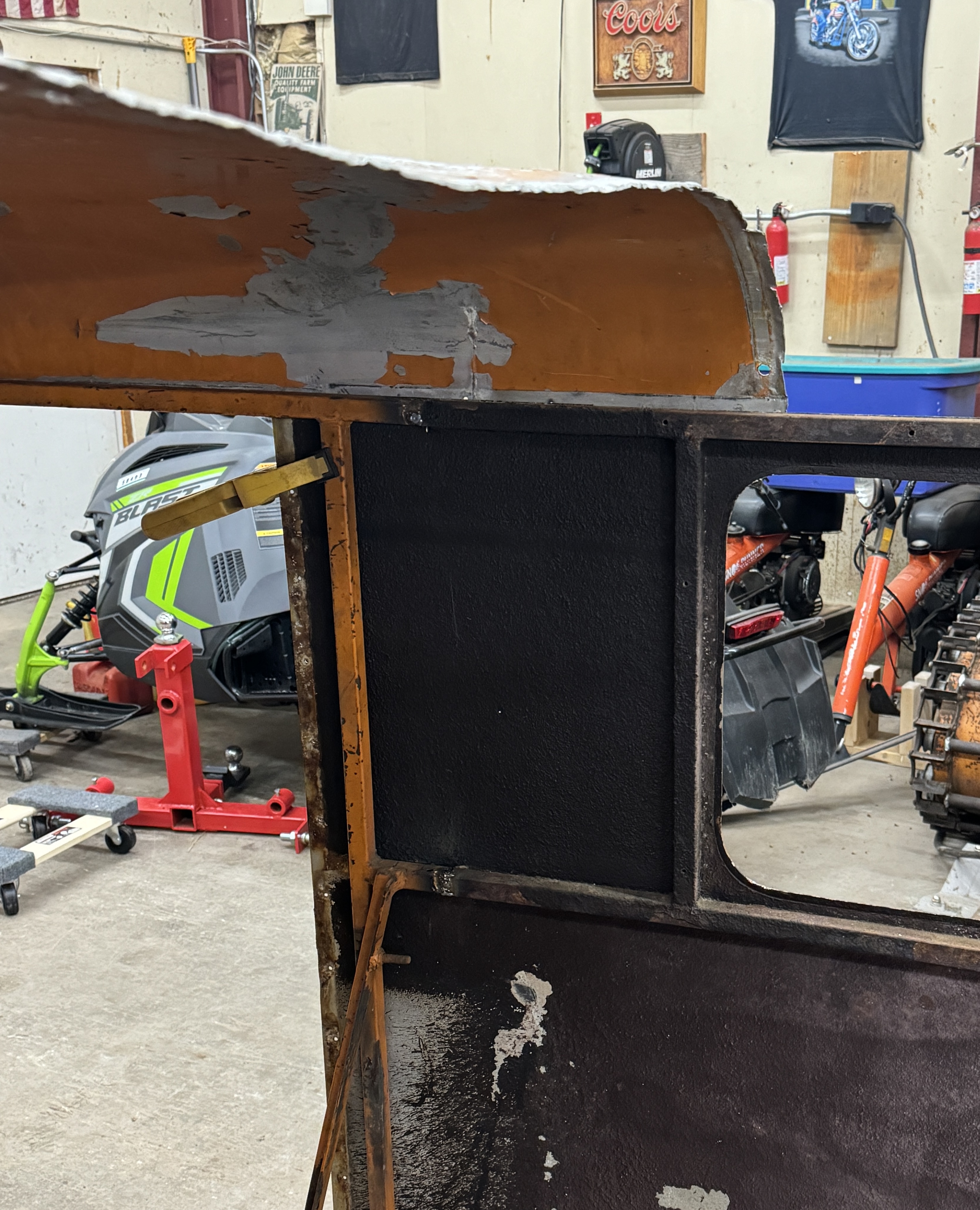

Got the original roof tied in. Little hassle but pleased with the outcome.
Tucker used little filler trim pieces of aluminum above the door and under the roof. Getting lined up was a challenge but it worked out.
Got the hoop set in place and took more of the roof dents out. Donor panel will tie in rear of here somehow. The hoop helped straighten it all out.

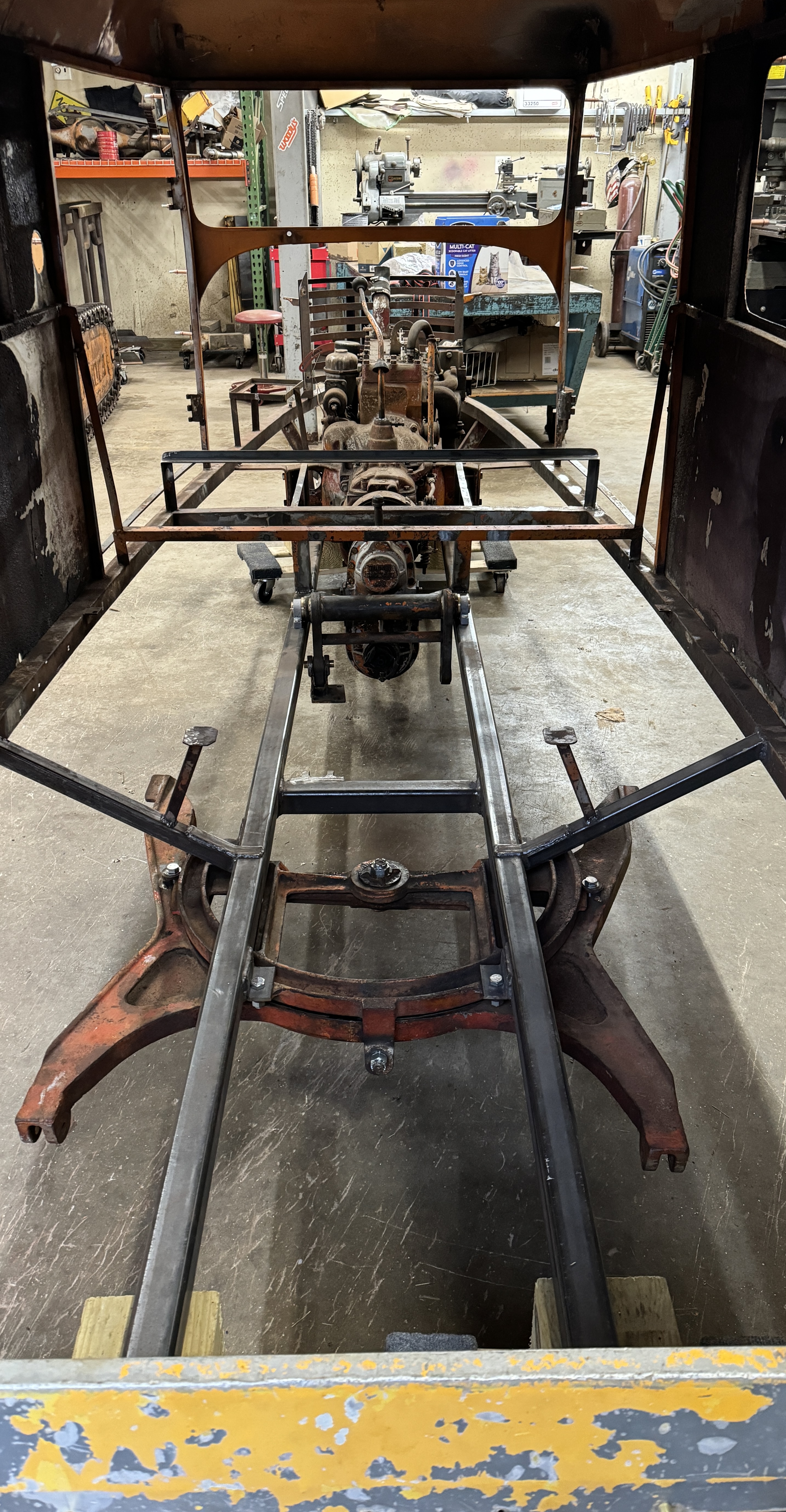

The side of the table with the spring hangers uses a 5/8-18 x 4 1/2 grade 5 bolt to get the shank right. They then get cut down.
What’s interesting is depending on manufacturer, the thread length of bolts can vary by up to 1/2”. These bolts I sourced vary in my favor.
The other side needs 3 1/8 of shank. So these 4 1/2 aren’t enough. Will have to try a few 4 3/4 and 5” see if I can get closer….
Checking spring inventory. My 53 has one extra leaf compared to the later donor and it’s a duplicate size. One corner on Marty was missing a leaf and has some different u bolts and a strap hold the cross brackets….
Remarkable nothing needs machining here just new hardware :)

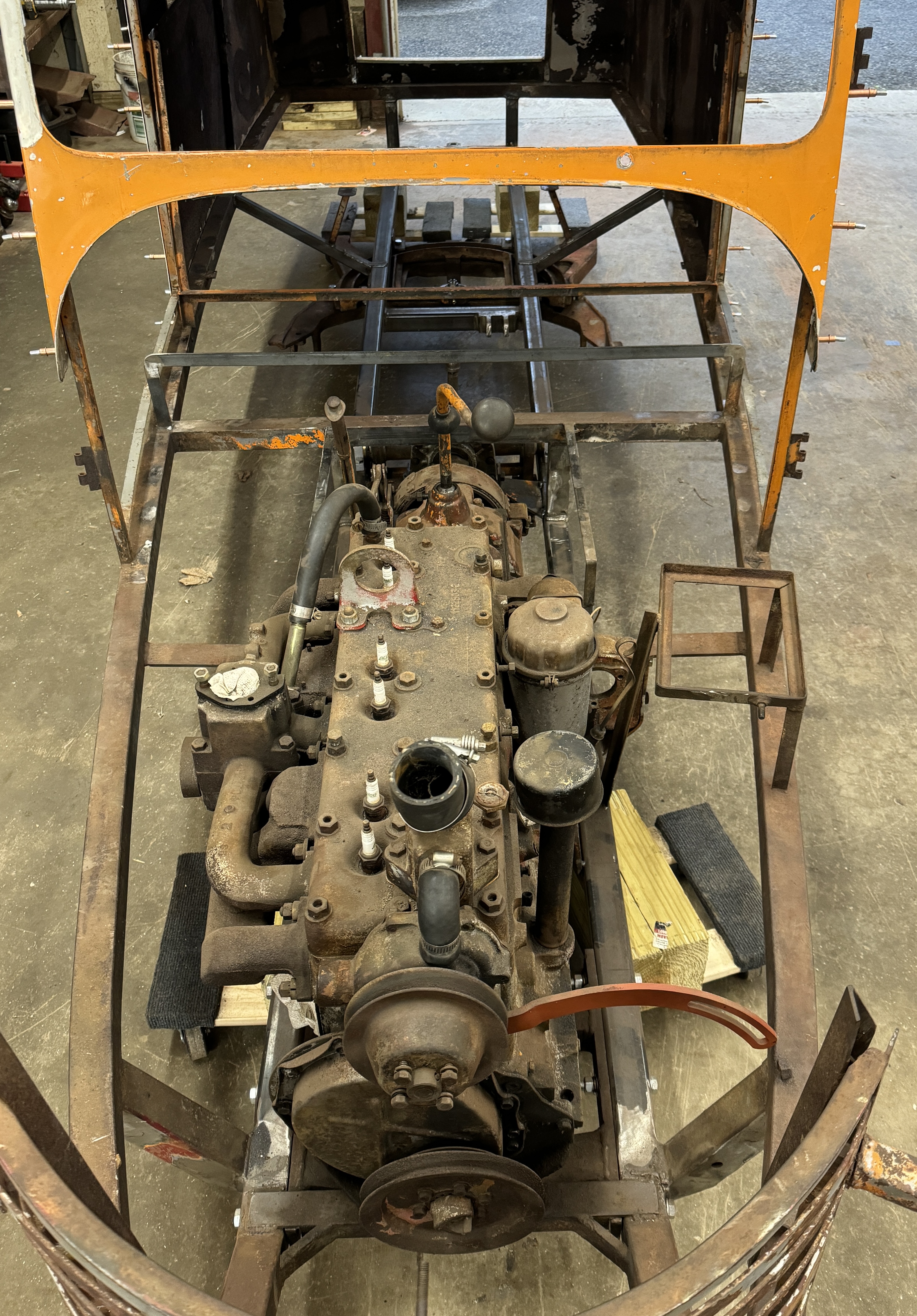

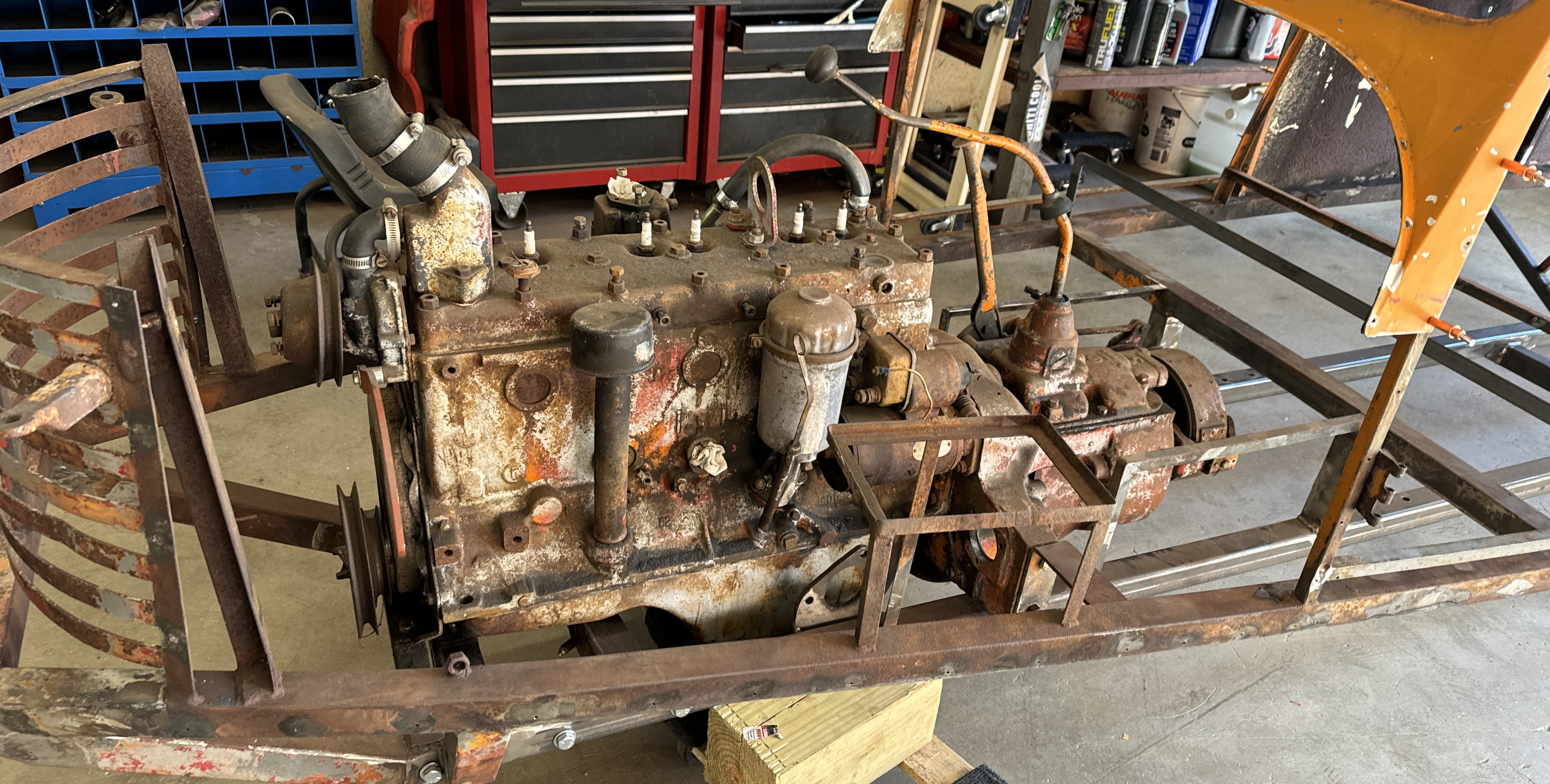

New engine hardware temped in. Everything is coming apart again for finishing. Front mounts bolts are a tight fit. These 9/16 nuts are 13/16 wrench don’t clear under the frame mount. The 9/16 bolt is 13/16 which just fits but no socket. Bolt down would have been better. SAE washers just clear one side needed a little flat spot.
Rear mounts is another place that shank length is important. Tucker got close here but we were able to improve with the new hardware. Finish will have lock washers on final install.
