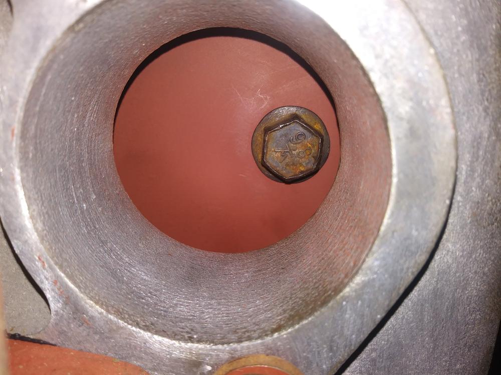

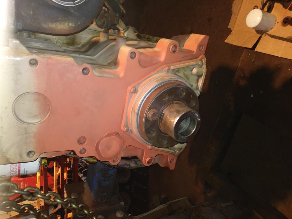

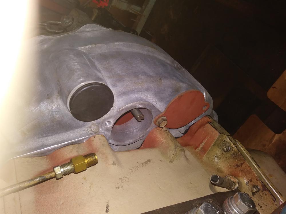

alittle prep work on t/c components... the adapter drive ring is ….3916222.... just a few pics to show the orientation to each other...

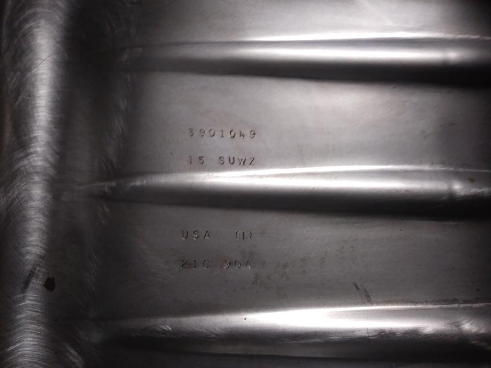

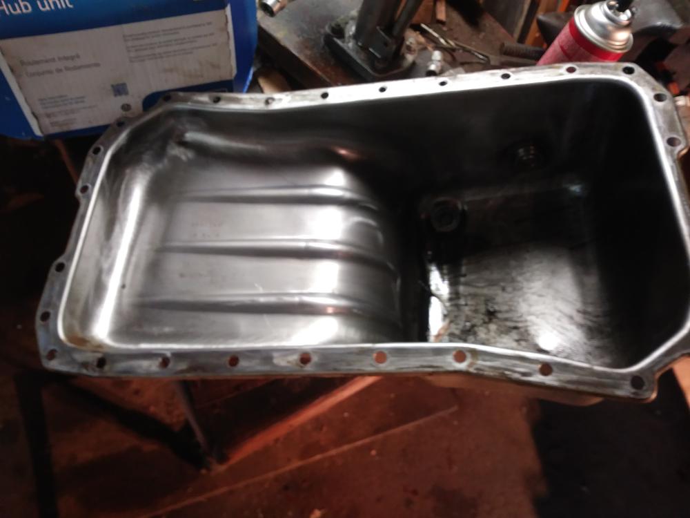

brg. roll-in, inspect journals, mic, plasti-gage, rods & mains,(std.) torque, ck. free-roll, end play, etc...….

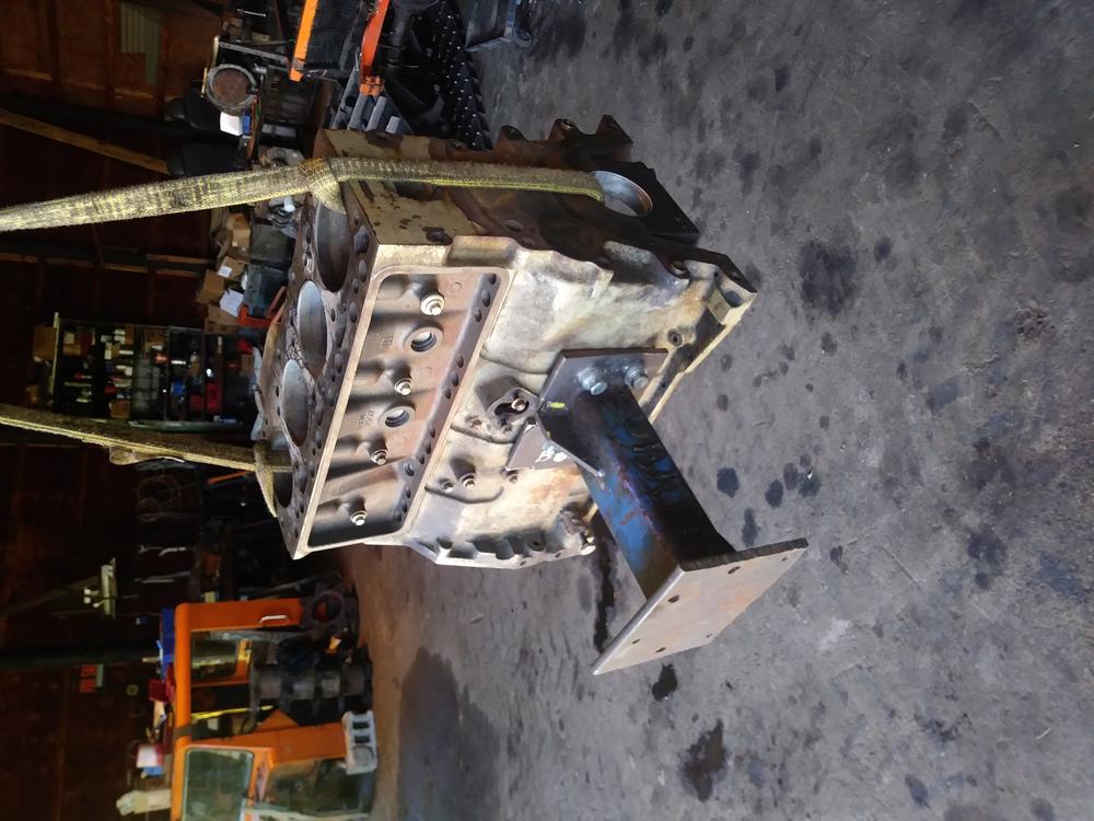

alittle fabrication today...

oh the fabrication for that hasn't begun yet. just meant I used some materials , laying around the shop ….. to be continued.... taking guesses on apparatus....

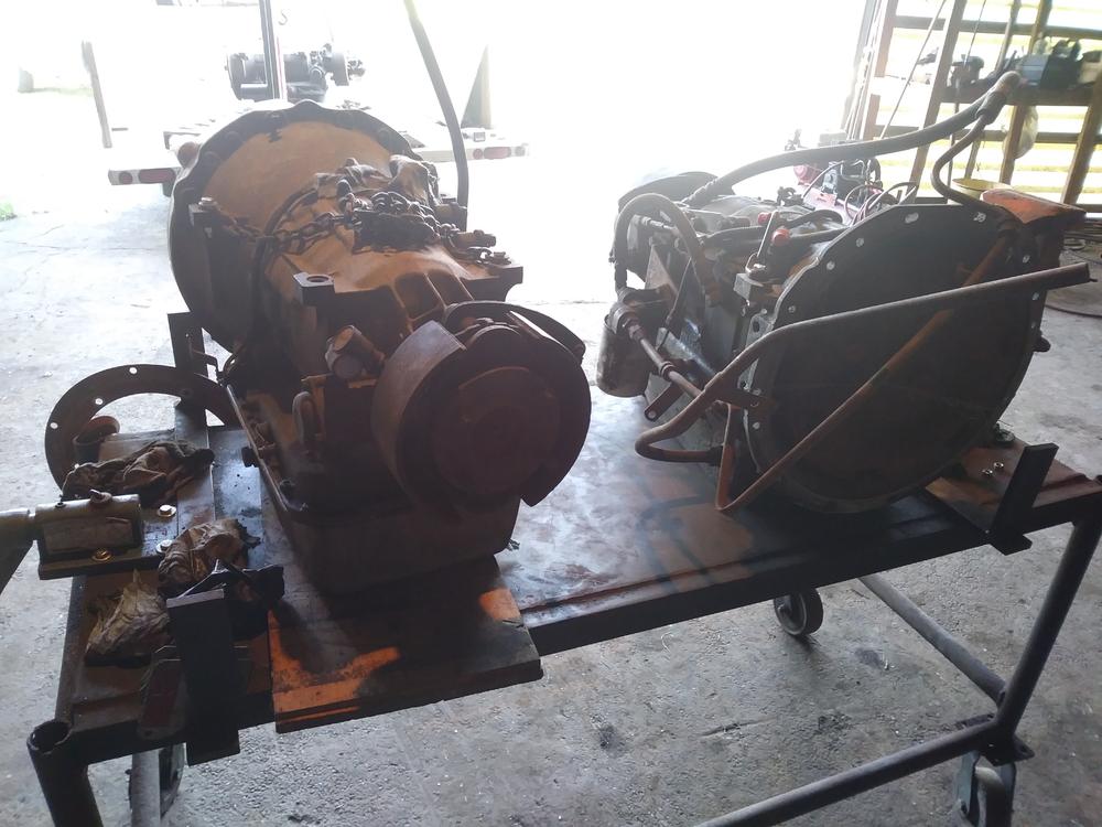

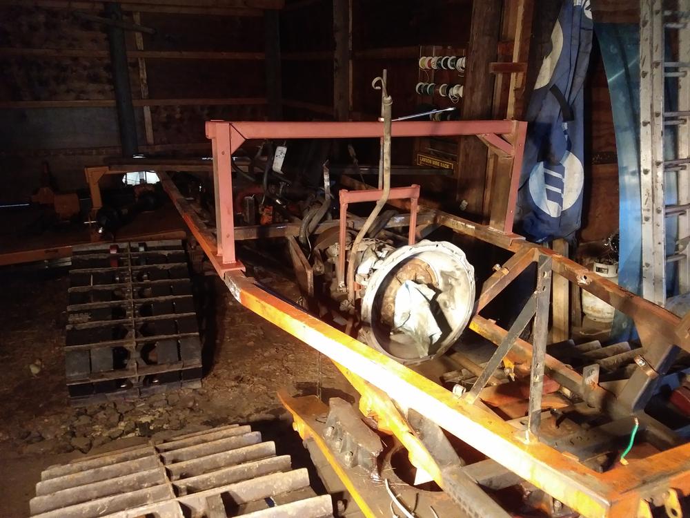

……. Allison AT545 first mock up....

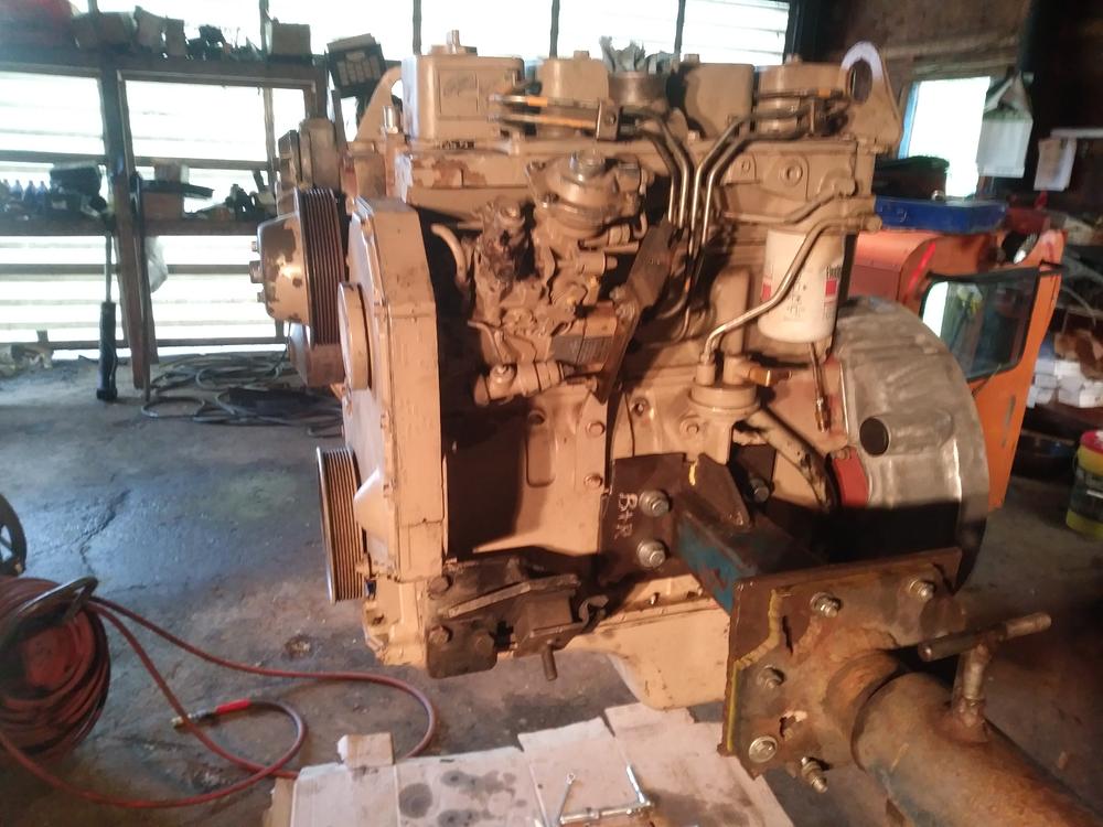

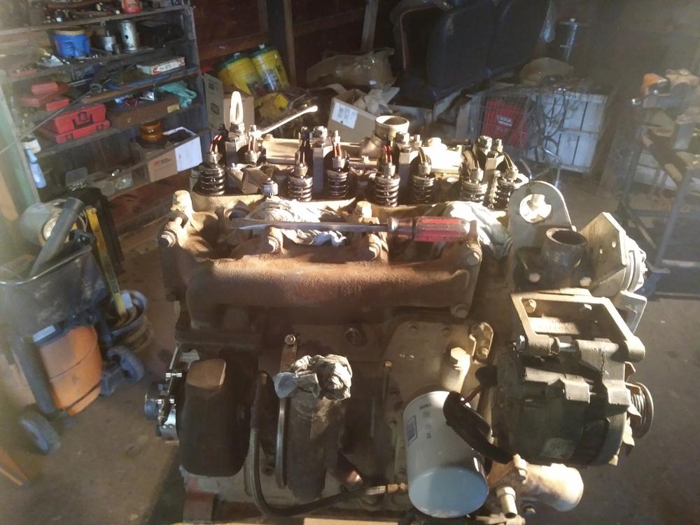

buttoning up the 3.9L... pre-lubed the cyls…. test the injs…. install fuel system... adjust valve lashes... install the covers... flywheel housing...crank adapter (3906806)...flexplate….

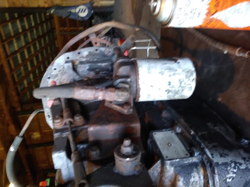

……. removal of the old ''manual'' transmission mounts on the frame. due to the tight area of the ''intermediate'' driveshaft.... the pressed in studs on the transmission output drive flange are too long , to permit easy/quick removal of shaft. the input ''slip-yolk'' of the transfercase, only has a few inches of clearance , for this procedure...… the mounting bolts for the p/b anchor plate will need to be replaced , with the ''thin'' headed type bolts... so will adapt over to bolts , instead of studs...
I recently had to change the clutch and throw out bearing on a 318 in a 542CF. To disconnect the upper driveline, I drop both front and back drive lines, remove the transfer case mounting bolt except the lower back two and tilt the case back. Not so difficult. Maybe an option if your fix makes putting a wrench on both ends of the bolts a problem.
Good idea... I 'll fab it so I 'll only need one wrench. Up on the mountain....we would pull the engine to do a clutch...and leave the tranny in place.... Thx ?

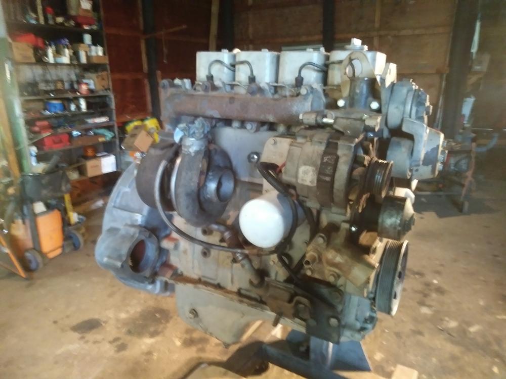

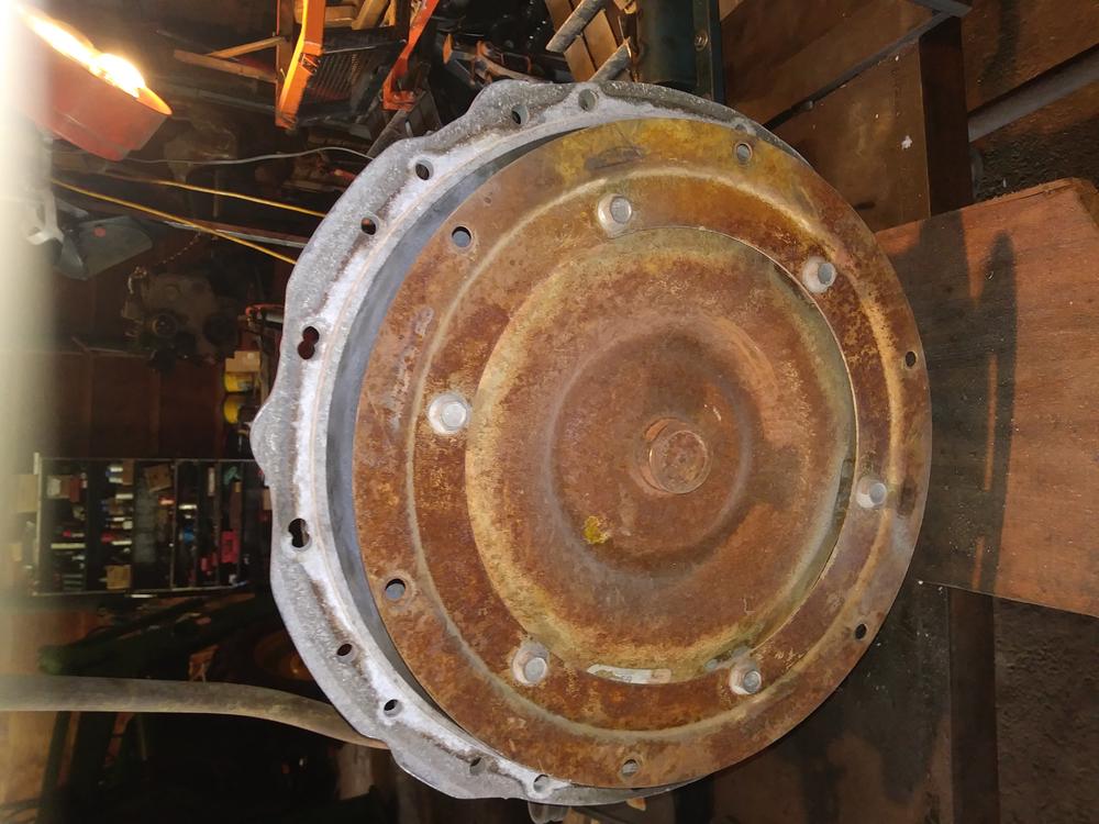

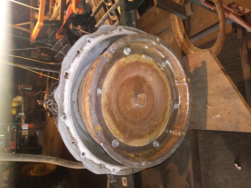

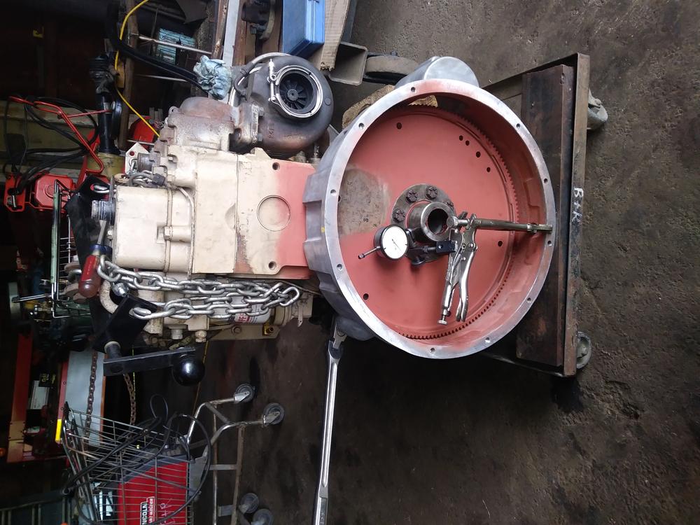

………. mocking up alignment of 4BT/AT545... a helpful trick ; to align t/c adapter ring mounting threads & flexplate holes for hardware, is to use a long stud , to line-up the first hole...

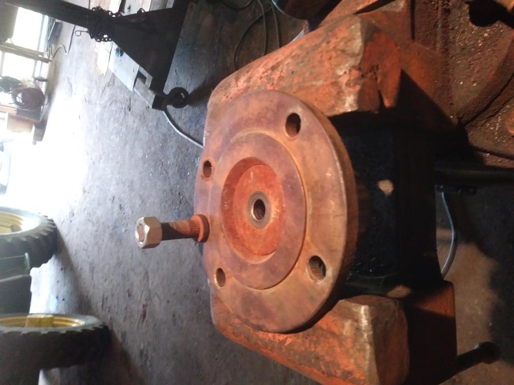

…….... tapped threads in output drive flange of AT545 … which secures the parking brake drum & intermediate driveshaft. drilled & tapped a ''locator'' bolt for p.b. drum to flange. reinstalled trans....removed 4BT from rotator stand. went for a F/D's ride …. found a few drags... notice rear tires removed for the season...

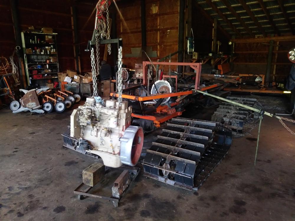

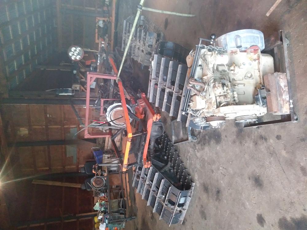

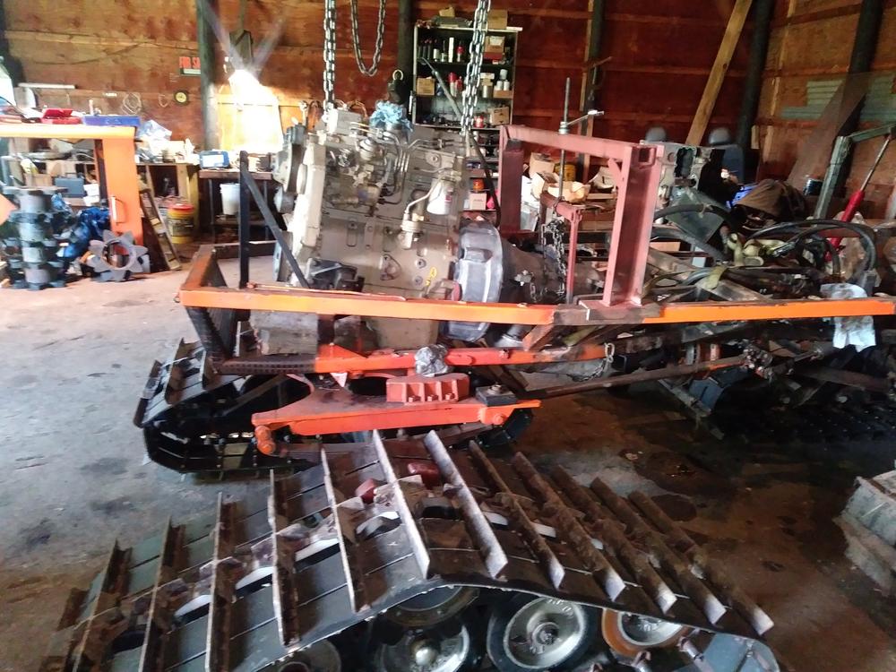

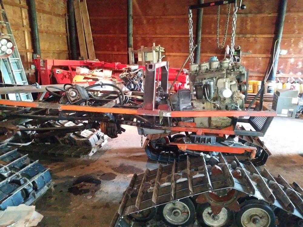

…… squeezed in sixty minutes today..... first mock fit of 4BT...
