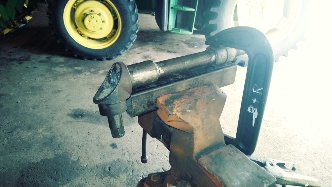

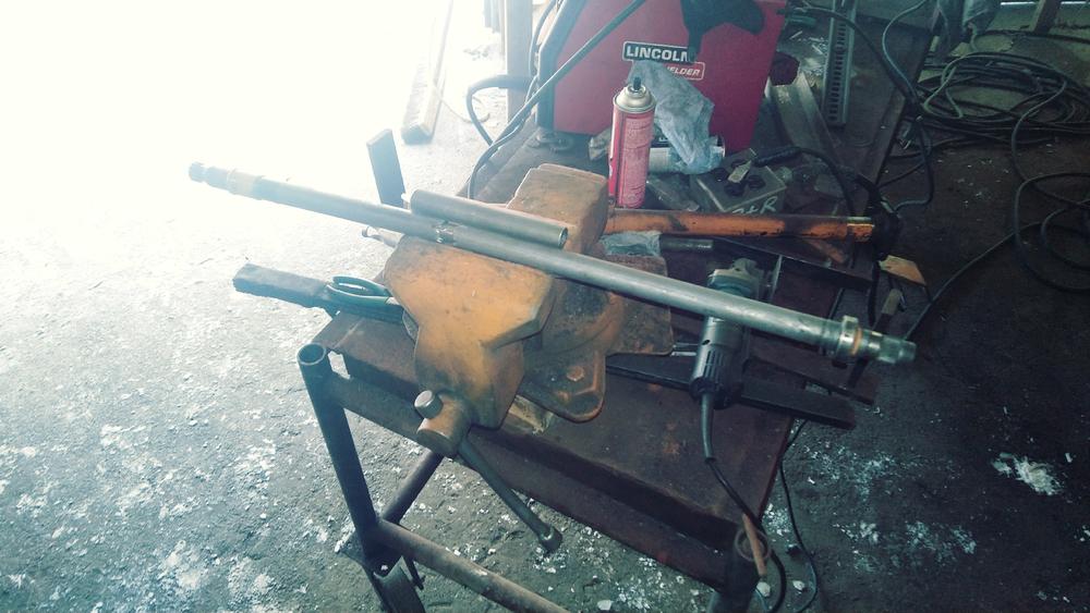

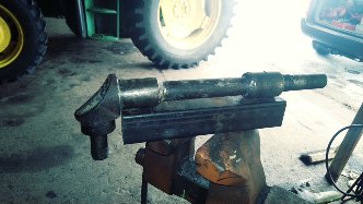

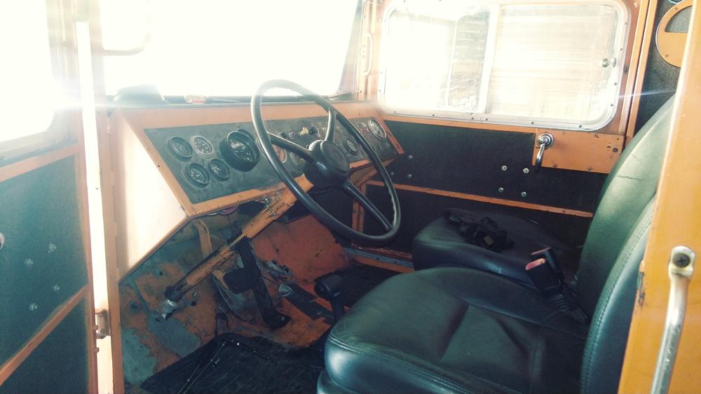

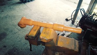

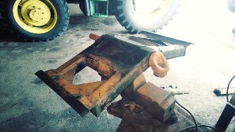

so ,... one of the first operational issues I had inside the cab, was the steering wheel was too high, stuck in the 'ol gut. plus made it harder to get in & out , as it was. so after taking some measurements, I decided to shorten the steering column & str. shaft. pretty simple procedure. I cut out 6 inches from each component. now this will differ from person to person. but being 6'5'' and 4ft. long arms...lol.... this decision made life ...good. so here's a few pics of conversion...
steering column mod. note; the orig. mounting clamp area ( unpainted) of where the column was attached before...

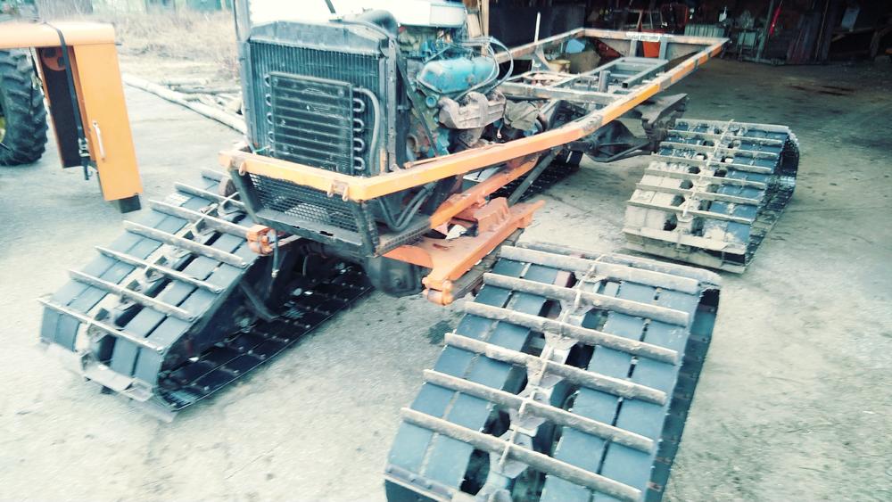

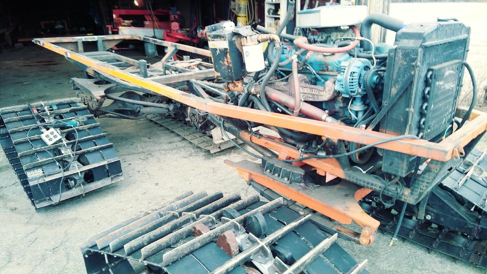

Yours is one of the first tuckers I saw with the tracks spliced in the improved manner.... then noticed not all of them.
did you do them or did they come to your staggered.
Love the column upgrade.

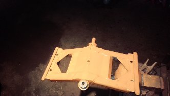

rear trunnion and pivot shaft......

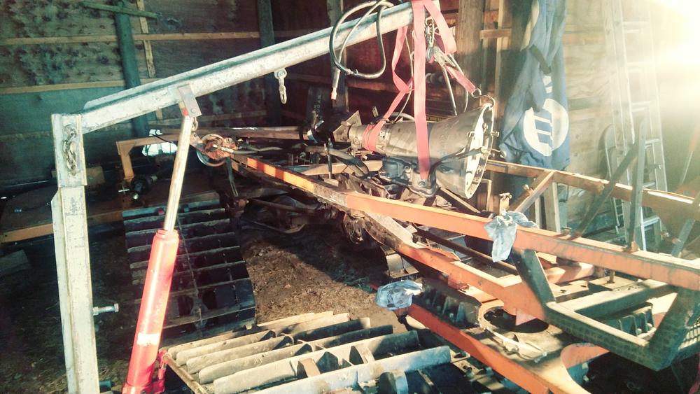

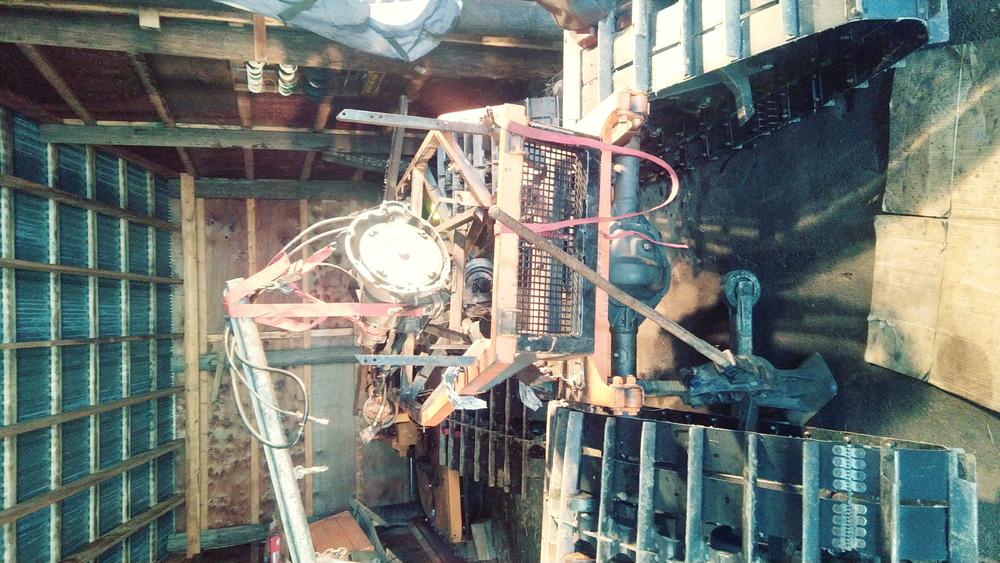

CAB removed....

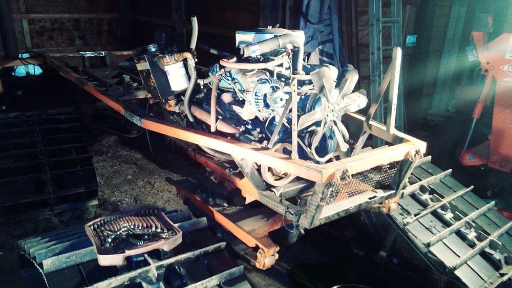

engine removal...

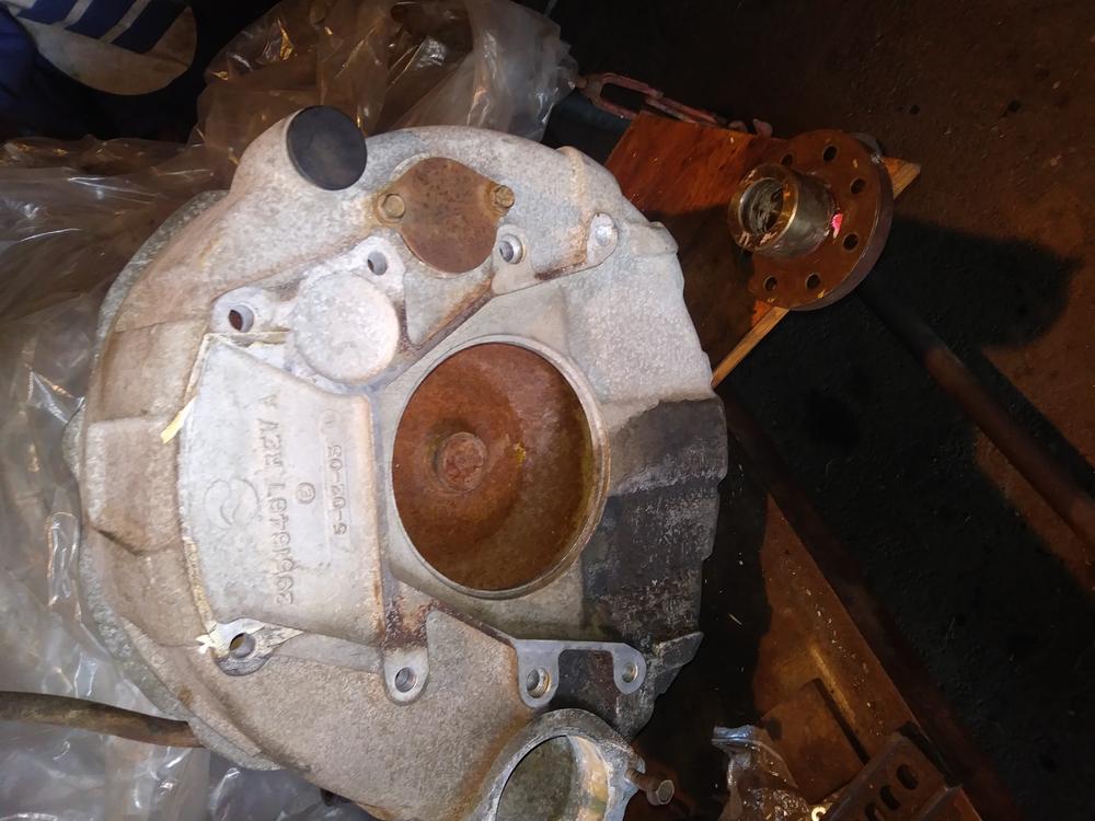

back onto the project ….trans. removal.... of the 727....
this unit originally had a manual trans...converted over to an auto... due to the lack of flywheel/bellhousing mounting ears/tabs...they fabricated a piece of square stock into a rear trans. mount. as in a vehicular application. instead of the tranny being suspended off the rear of engine...due to lack of mounts. they also made a custom intermediate driveshaft to connect tranny to the transfer case.

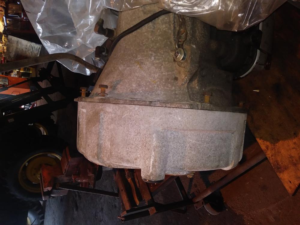

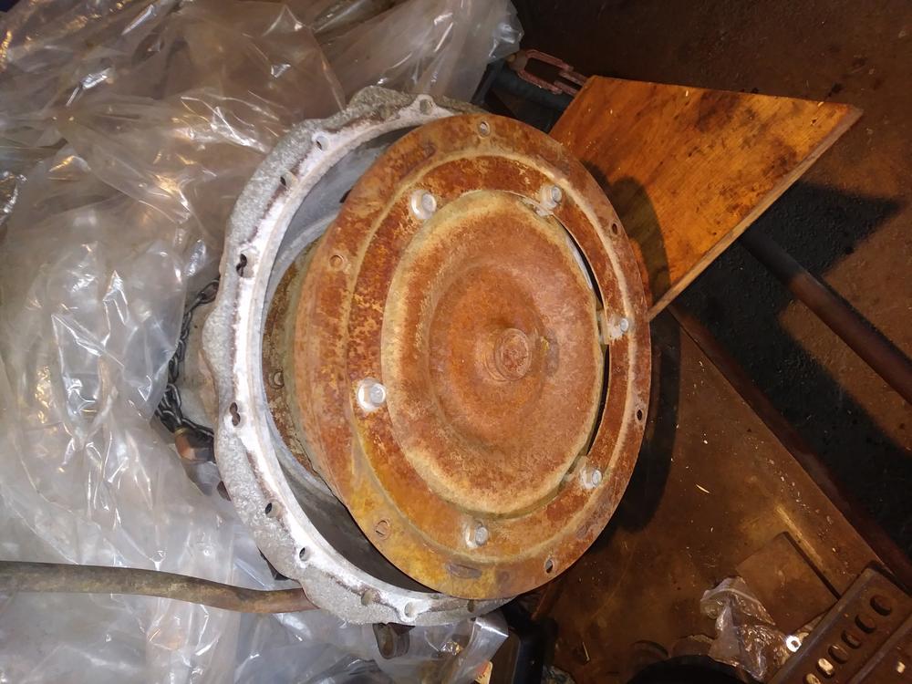

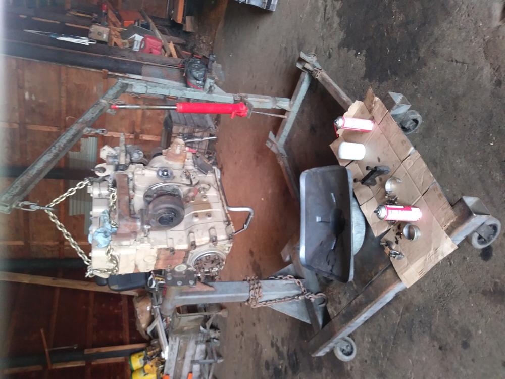

so...with the 727 removed...next was to dig into the archives ….and pull out an AT545... check the road map in the bottom of the trans. pan... and clean …
Not sure if your 545 came from a diesel before, but if it came from a gas engine it requires a different governor. Easy to get at under side cover.
Question one:
is the PTO live all the time, or live when in gear?
perhaps one of ea?
Question Two:
Is the governor the only difference?
shift modulator (drivers side) some are electric some are vacumn? I was told they are interchangable, just screw out the electric, screw in the vacumn, setting requires some jam nut adjusting.....
if the governor makes the shift points that most likely would be all that needs to be changed....
correct … I haven't run the tag number yet ...it was one of many pieces that came with the purchase of unit... it appears that it did have a p.t.o. mounted to it …. the pan & filter were clean , upon removal, but the mock test run will be the test.....
Question one:
perhaps one of ea?
Question Two:
good questions.... q1 ; this one appears to be live in gear....the pto gear free wheels in its current condition. most allisons you have to apply a direction clutch, to stop the pto drive gear from spinning, in order to engage the pto driven gear, to prevent grinding when engaging. q2; this one is an older model, it has a manual kickdown cable (tv) , yes on the drivers side, and adjustable. the only wiring on this unit is the neutral safety switch & b/u switch, also... easy peezy. im old school, like the old mechanical components... I try to stay away from all the electrical units, I do enough of that stuff during the work week...lol....thx
Question one:
perhaps one of ea?
Question Two:
Question one:
perhaps one of ea?
Question Two:
The pto drive gear was a option on the Allison 540. Normally only used in neutral
The pto either needs a clutch pack or if manual engagement the its best to shut the engine off and engage. Shimming is done by varying the gasket thickness
The governor number IIRC is 461 for the Diesels and 460 for the gas they should be marked under 4 bolt plate on side real easy to change
hope this sheds alittle more lite on the components , arrangement, alignment, orientation , ...and a few part numbers... clear as mud as they say. ok , so.... these p/n;s ...pertain to the Allison components... the flexplate is 3960058,... another p/n- off the actual flexplate is ...3918959. and a couple of the cummins numbers are … the crankshaft pilot hub assy. to the t/c button is ...5521188 . last time I checked these were n/a. the flywheel housing assy. has a cast # of ...29516467 , … REV A... NOTE ; the ''black'' plug ..is for the engine rotating tool,... and the tin plate is for access to the flexplate hardware. so the one I don't have recorded is the adapter ''ring'' .. which connects the t/c to the flexplate ...so if someone has that in their library ...plz chime in ..much appreciated. just a friendly reminder... this pertains to the cummins 3.9L … and an Allison AT 545 , mating … :smile:

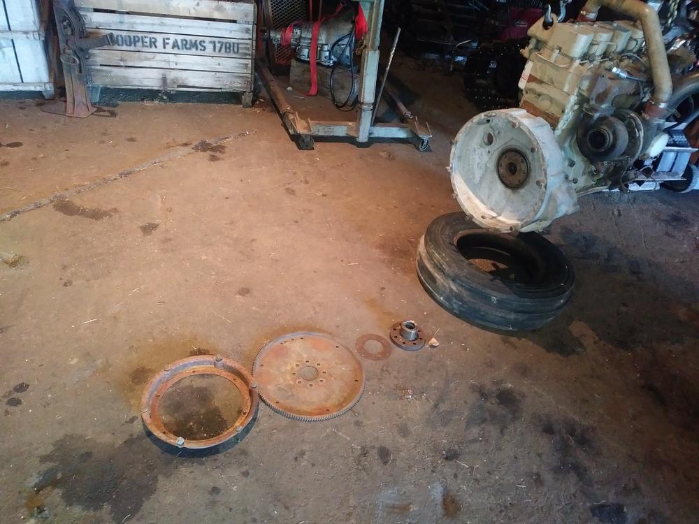

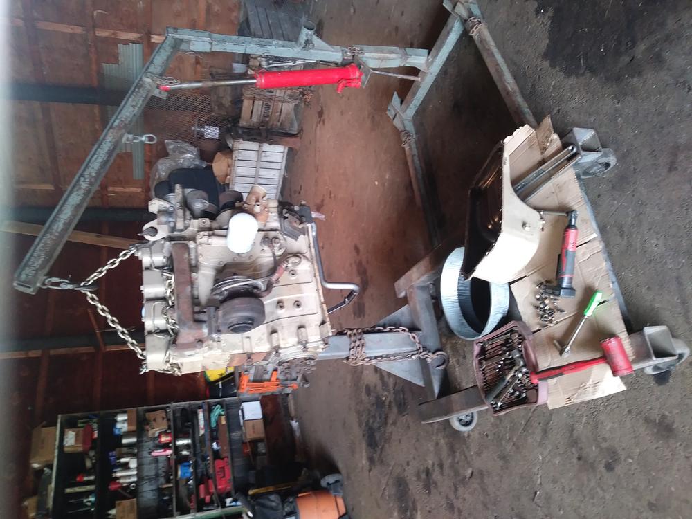

Is it true that cummins engines 4B and 6B ISB and QSB all share the same block bolt pattern.?
AHHHH... roger that. yes, seems odd that some are posed correctly , and some hang a ''left'',... even though they are all upright on the pc folder. gotta love TECH. so as far as; 4B & 6B ,.. THEY have the same block configuration ; basically , same block design ; lacking 2 cyls. as far as the ISB & QSB , im not 100% sure . but I would say its a pretty good chance. I doubt either would interchange with the old ''orig'' predecessor. mfg. year determines range of interchange , between all models.
just a quick note; qsb was designed engines for the agriculture /industrial application,...where as the ISB ...were designed for the highway applications...:thumbup:
I have a qsb from a fed express truck that was T-Boned by a train. ( slow speed in a yard while it was parked for a delivery)
the Gear train for the accessories is on the rear of the engine and I find it quite desirable for the snow cat application i secured it for. the lift pump Power steering pump are tucked in nice and tight. the alternator is inboard as well.
I was not going to run the allison 1000/1100 series transmission that is hanging off it. but now I am thinking to dig in a little to see if there is any merit to it.
it is surprisingly short and has a brake on it.
I have an update on parts... I confused two p/n's ...the first flexplate & the crankshaft hub/pilot adapter . so ...the first flexplate p/n is still good , but no avail. currently. and the hub/pilot assy. is still avail. I had reported in reverse . so that's good news today, talking to my cummins/Allison parts guy. the second flexplate p/n is still avail. prices per each range between 300/400. dollars. pardon my ...C.R.S. & sometimers….

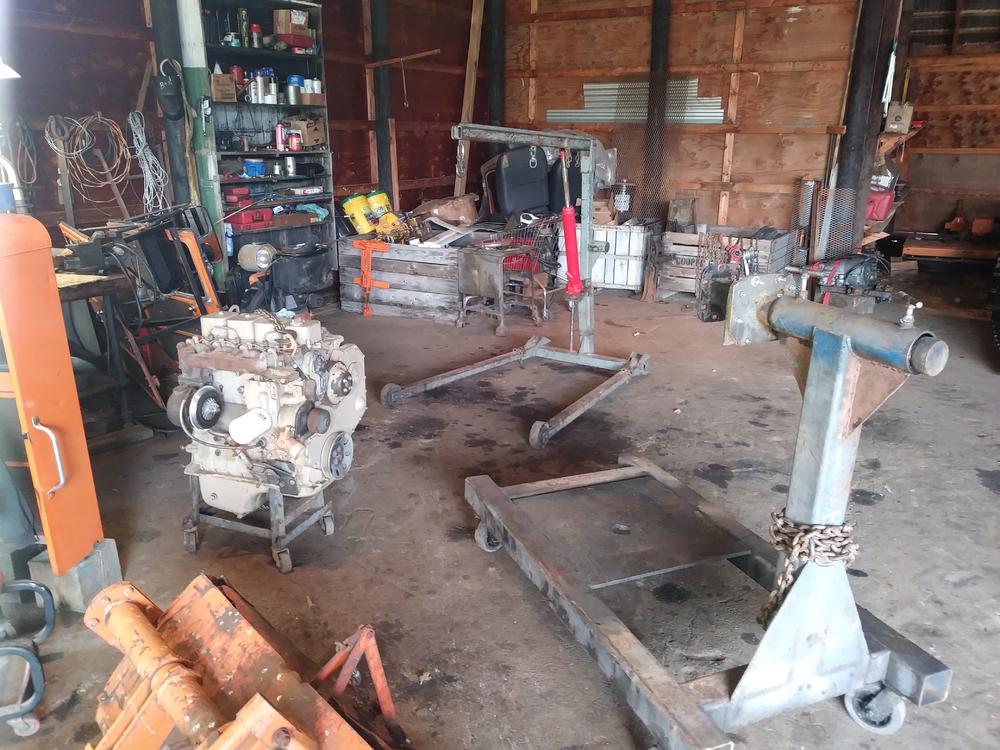

mounting of the ''B'' series to the engine ''revolver/rotator'' …. here's a good example of why it's a good idea to inspect an engine before putting into service ...especially if uncertain of it's prior history, hours, pm service, etc....a set of brg. inserts is much cheaper than a crankshaft/rods/block, etc...
