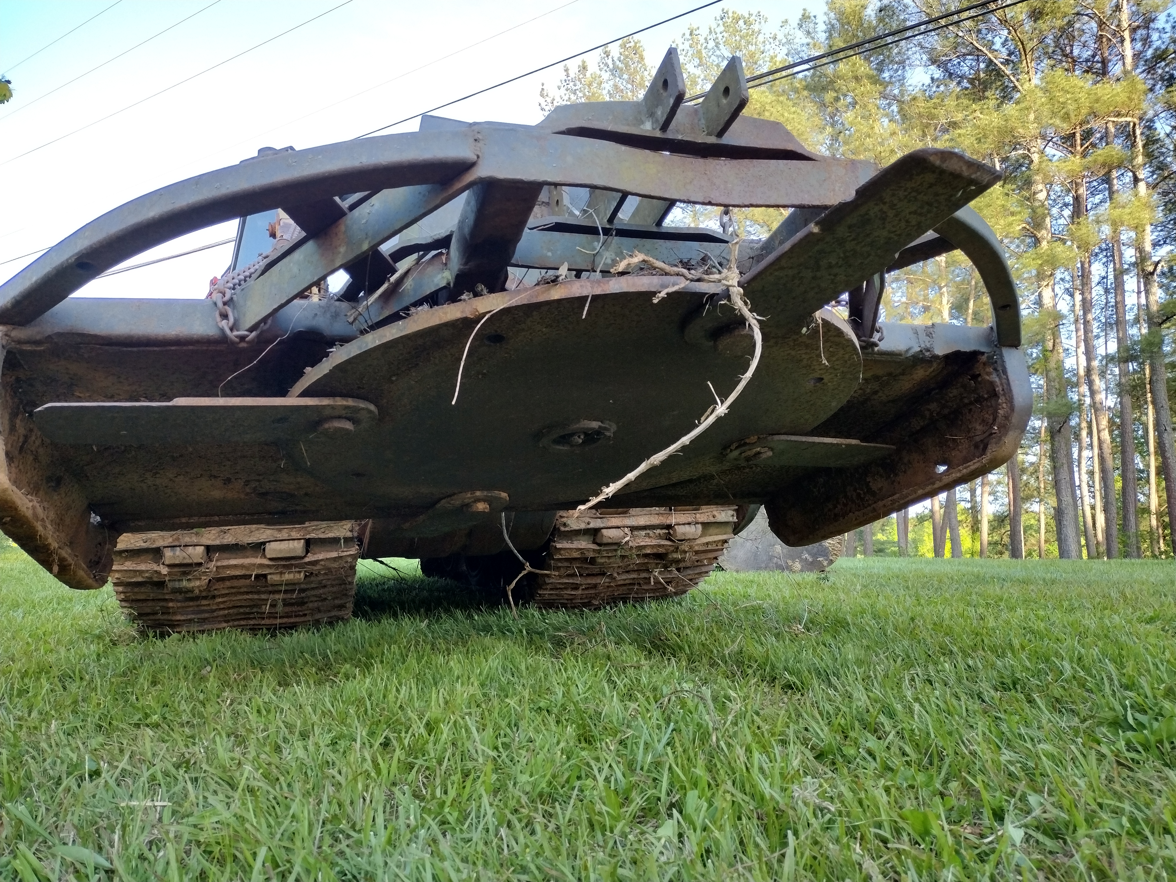

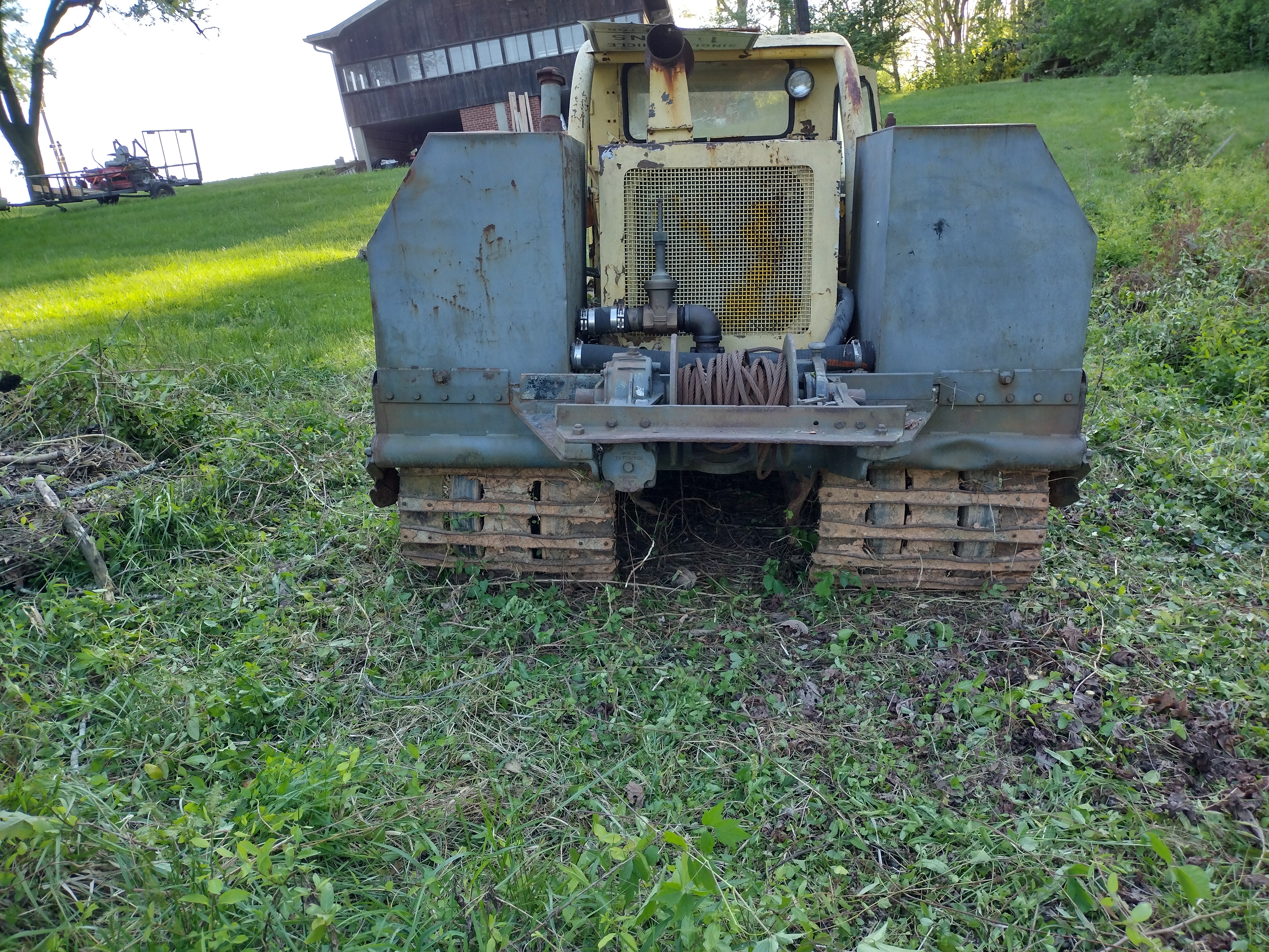

It's right at 8' in total width. 11'6" in length, add 2' for the winch, add approximately another 3'6" for the cutter. My absolute wild guess is between 10k-12k in weight, topped off and ready to work. It has a long date with a hot water pressure washer. If you guys see anything you can tell me about or have questions I'll answer as best I can.

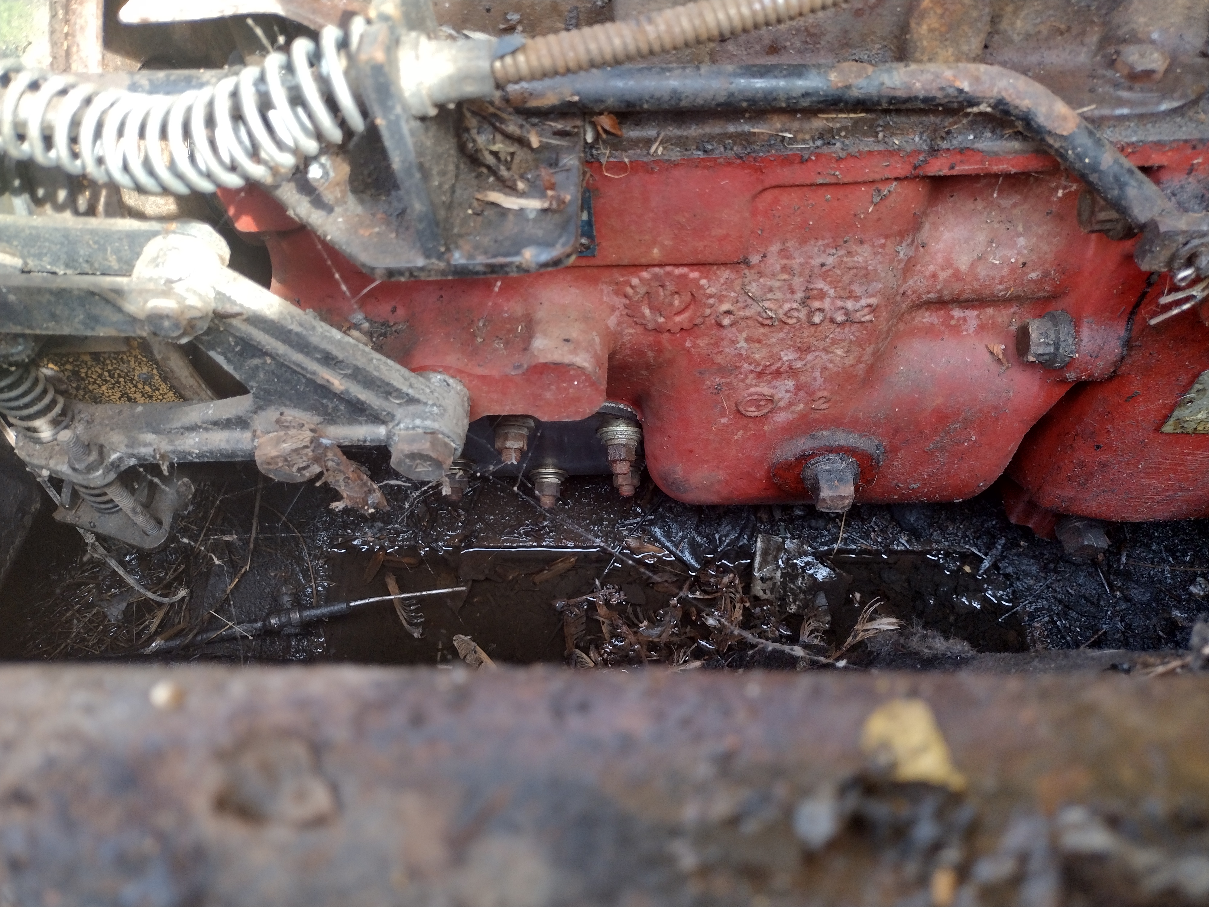

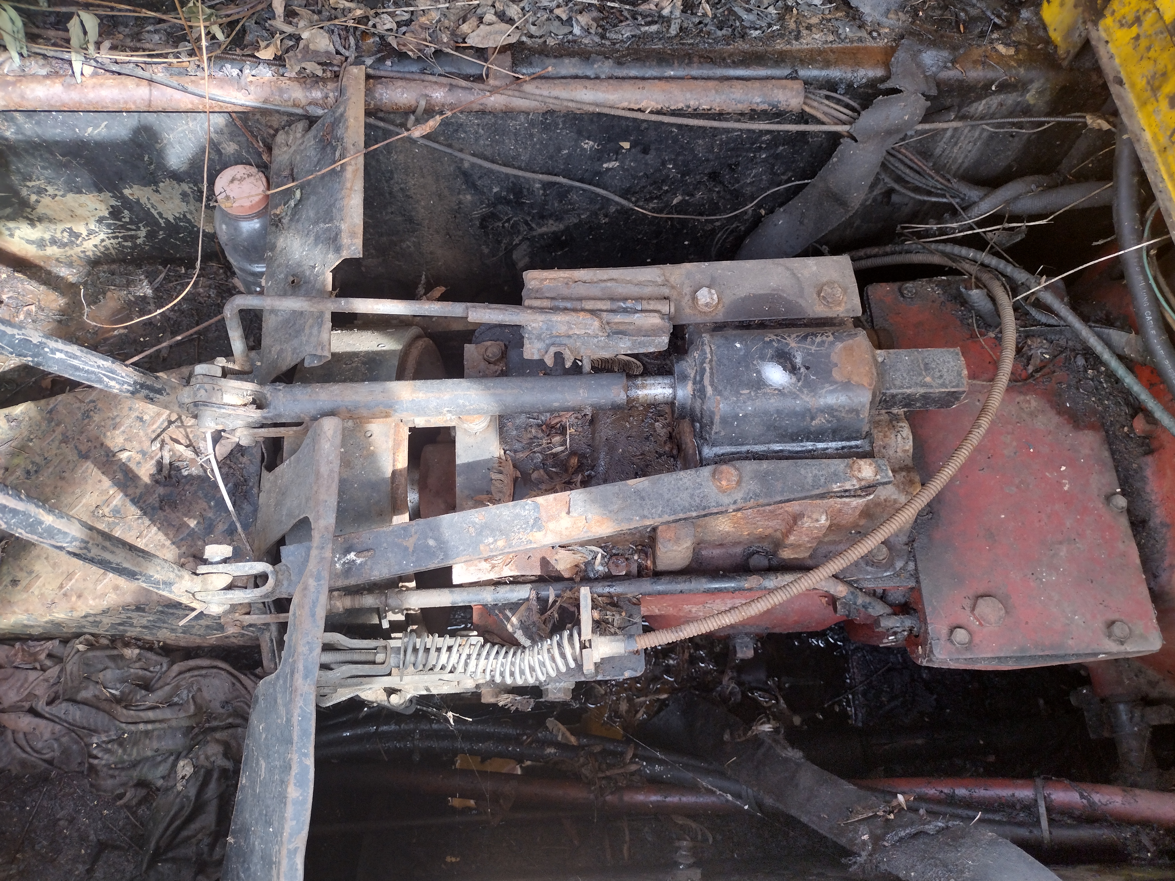

Got this pic after some more cleaning. I'll post more pics after work when I drop by to get them. Was looking to see the access we would have when I removed the seat plate. It appears that the first gear ratio of 7.24 to 1 might have been one of the best available with this transmission. My biggest surprise was how much crap was in the belly of the machine. I'll find out how to remove what appears to be the access plate and get it all cleaned out once the rains have moved on.
Shea
It appears when the transmission was replaced the PTO wasn't. I'll have to figure something out for that. The shaft is actually down there, just can't see it. What is that would be under the left side of you were sitting in it. It's a cable that goes over the transmission and down to nothing it appears. If it had a handle then it's gone too. There is a spring at the base of it. PTO engagement? Thanks guys

PTO for the rear winch , something to look at later on . The pto has to be able to reverse direction for the winch , that cable probably was miserable to use for that . A lever with linkage usually works better. J5 Bombardier
I'm eat up with work and rain all week so I don't know that I can look at it until this weekend. Until then I would like to do some internet sleuthing. Do you know where I could start looking for the PTO parts? Were they all set up with a cable or could some mechanical linkage be fabed up after seeing a factory set-up?
Shea
Also not sure there was a power reverse. It appears to be a free spool possibly. I found a pic of the pto online and it's simple with no other gearing for a reverse option.

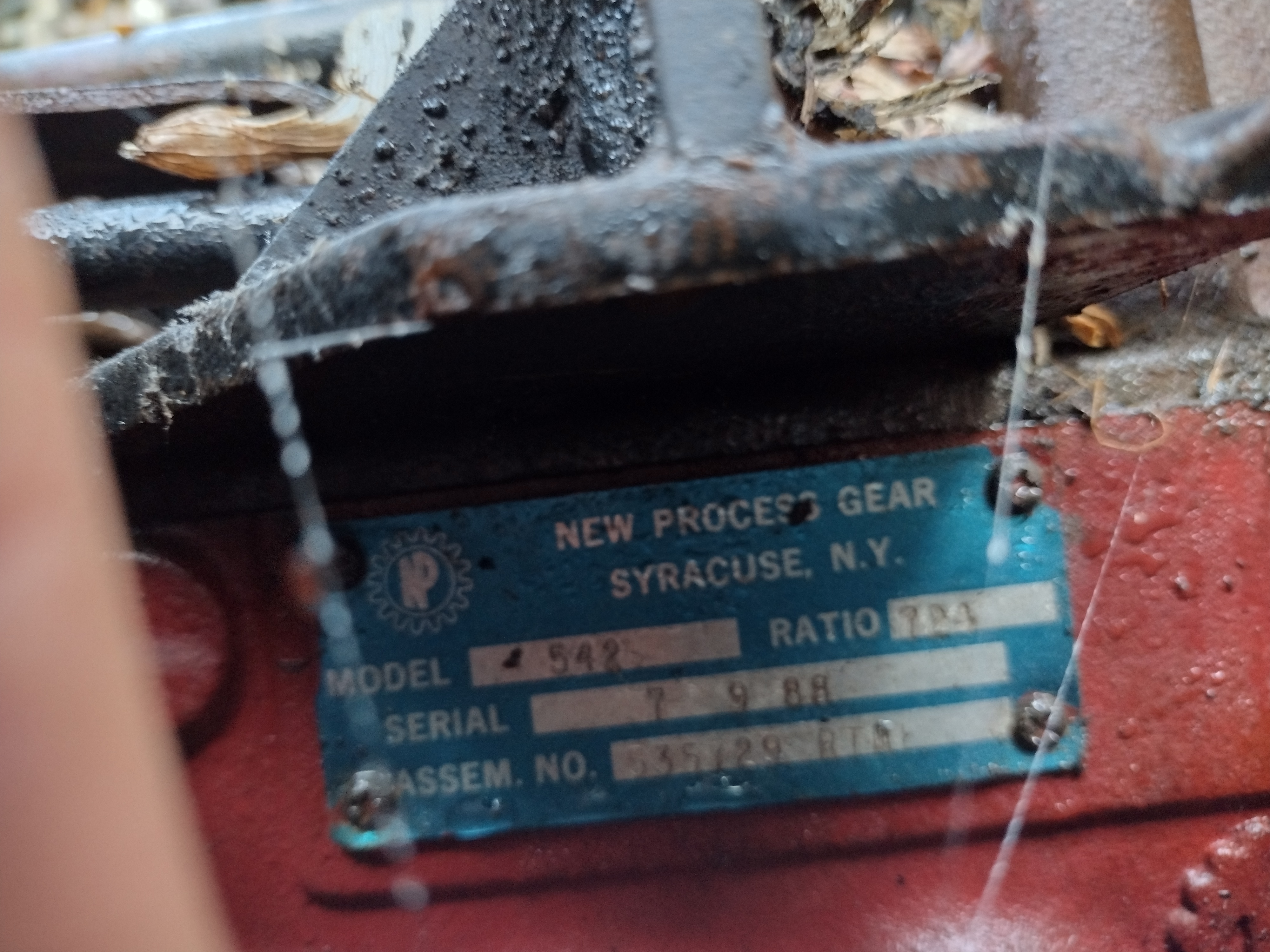

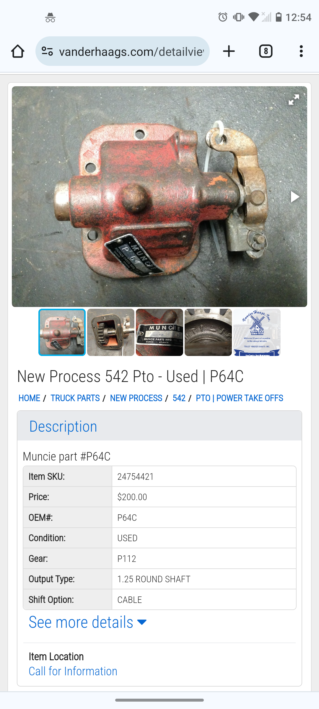

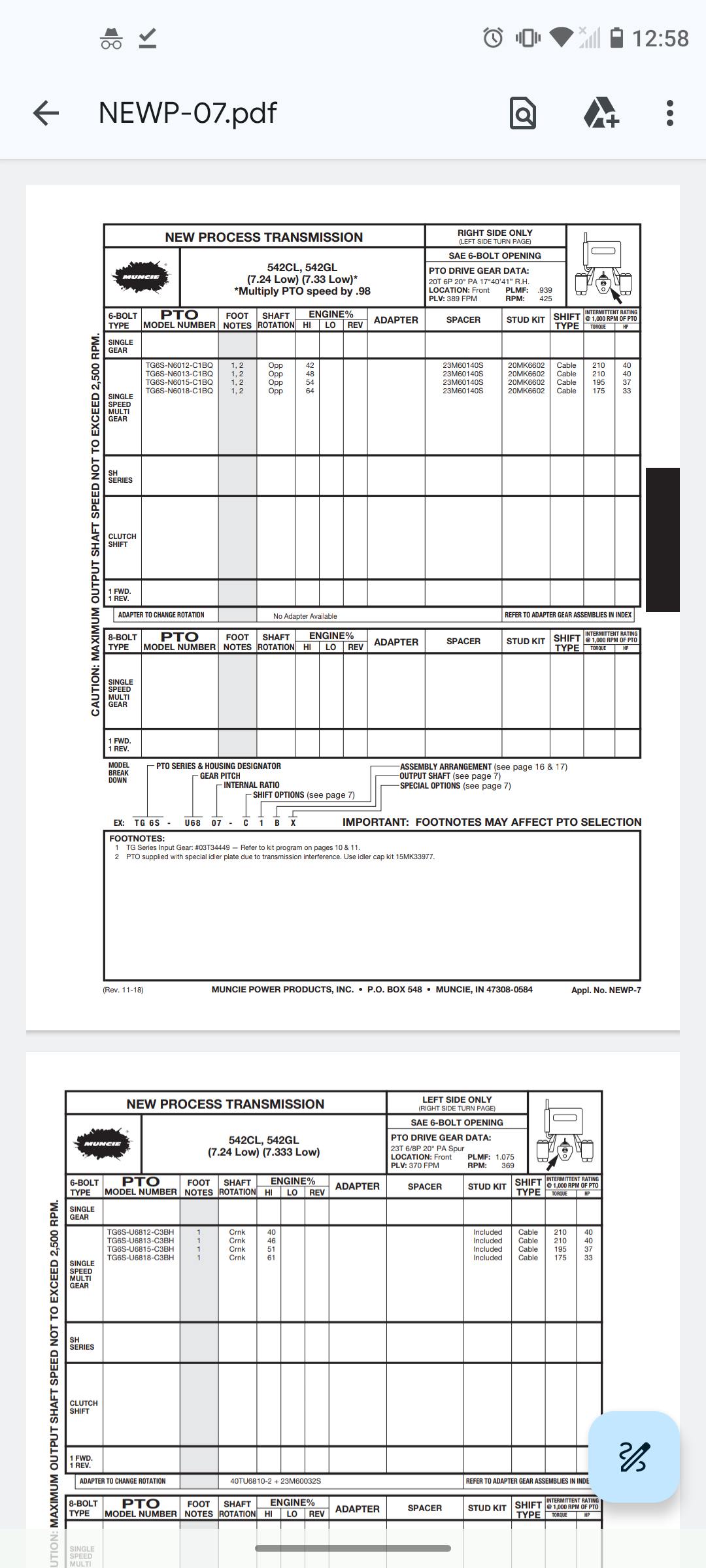

What I've got to go on so far. A take off part and a Muncie PDF that doesn't match the part. That doesn't bother me, but at least I've got a starting point. Any ideas will be accepted.
Shea
The trans pic I posted is a New Process # 435 , I believe , it's been a while since I worked on it and no tag. Either way the tag on the PTO may be of some help , the mating gear on the trans should be helical , but the block off plate would need to come off to verify . If you do find one down the road I would pull the trans to install the PTO , shimming it while standing on your head in the hull would be no fun. You can use the old cable or make up a lever, the winch is not something you use often , unless your operating in a swamp.

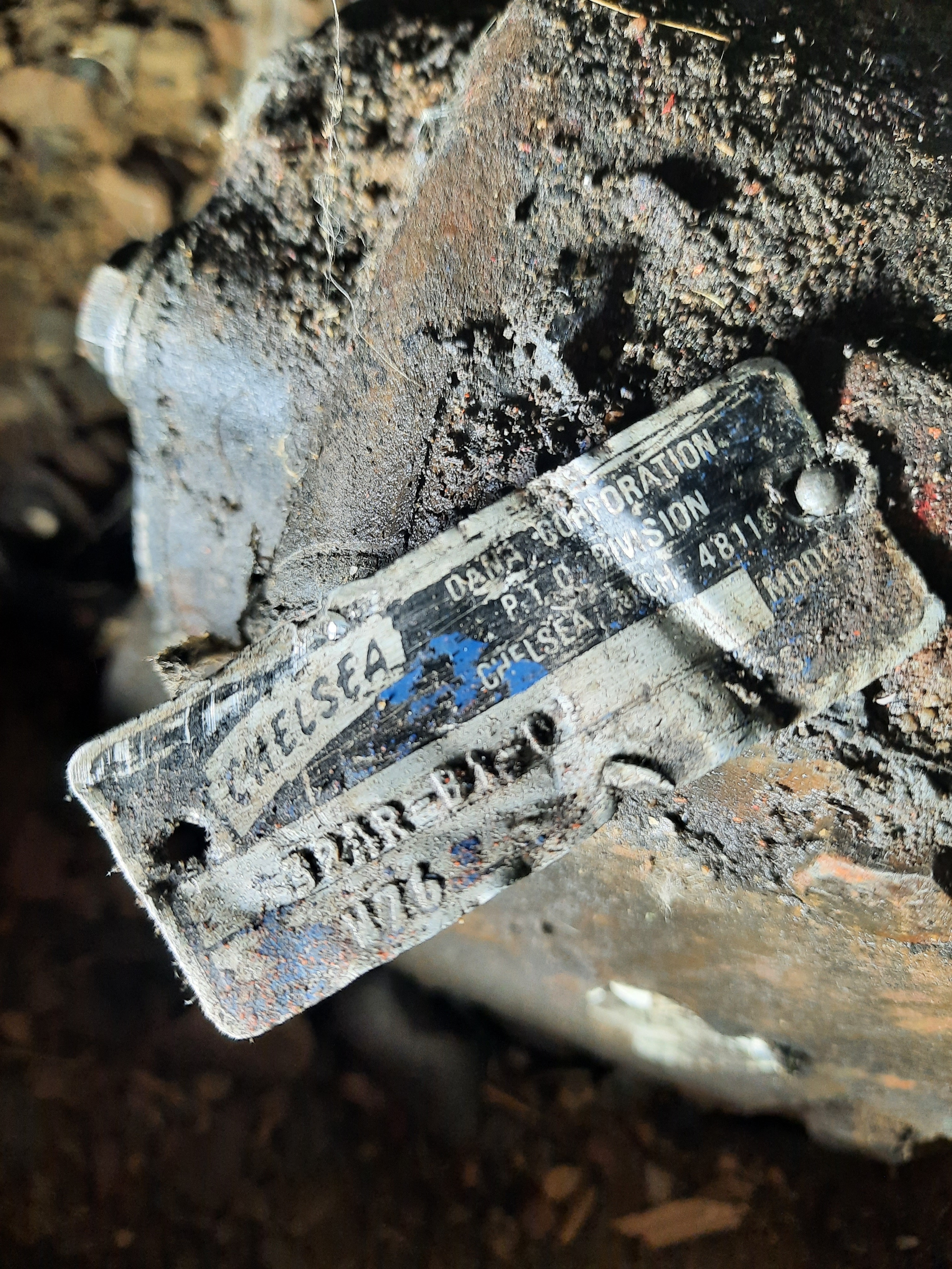

Thanks for the pics. I was able to get my dad down to look at it yesterday and noticed a PTO handle on the dash labeled Chelsea......so that works with the information you showed. I'll have to check more on that. My reason for making it a sooner rather than later priority is my work is all on slopes, some very steep. Having the winch working would make it easier to recover equipment if necessary. The cutter is coming off to be refurbished/rebuilt and is a secondary concern. The machine up and moving is first. Fix all the main hydraulic systems and electrical before the cutter becomes a priority. Thanks guys.
