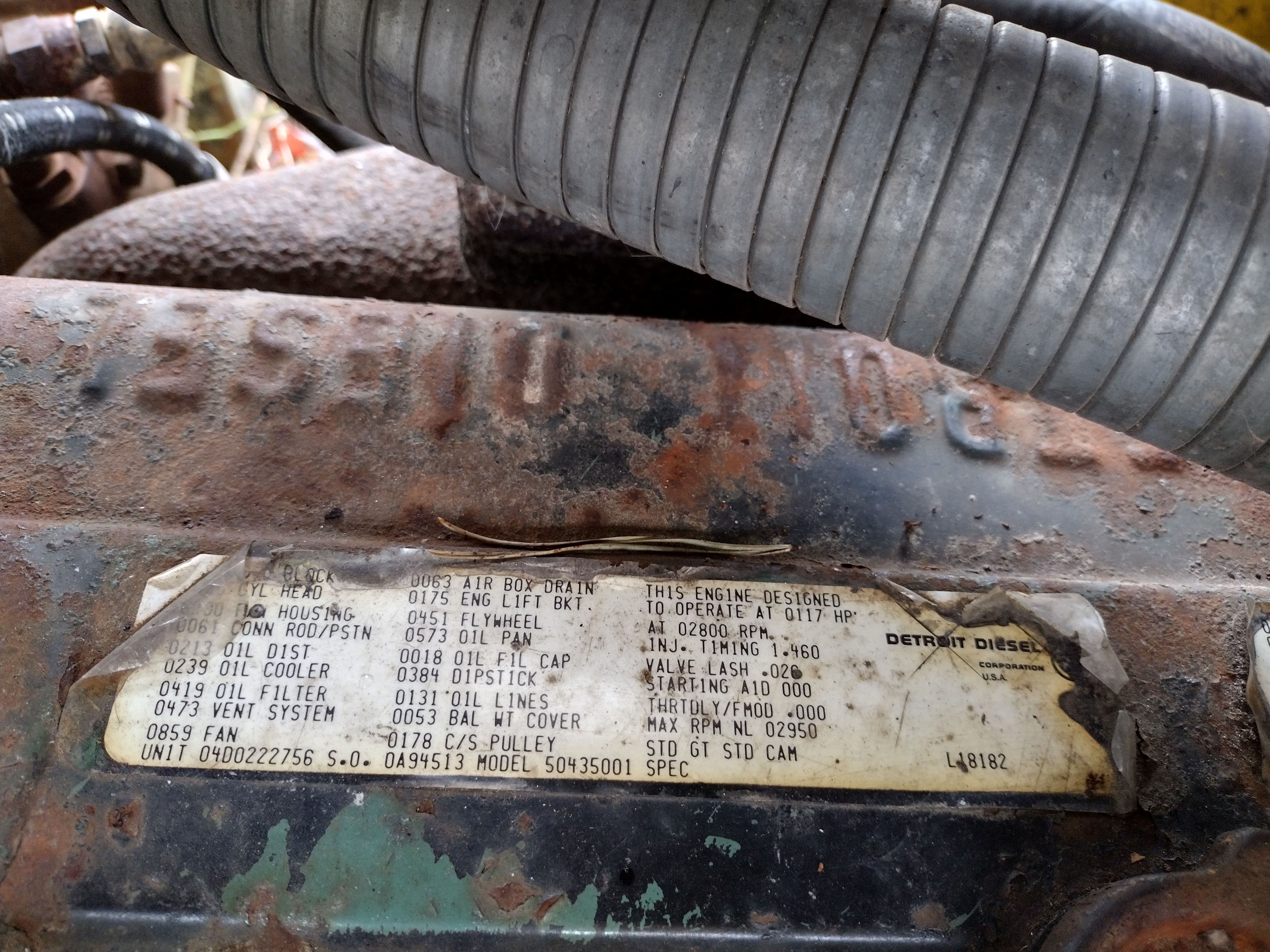

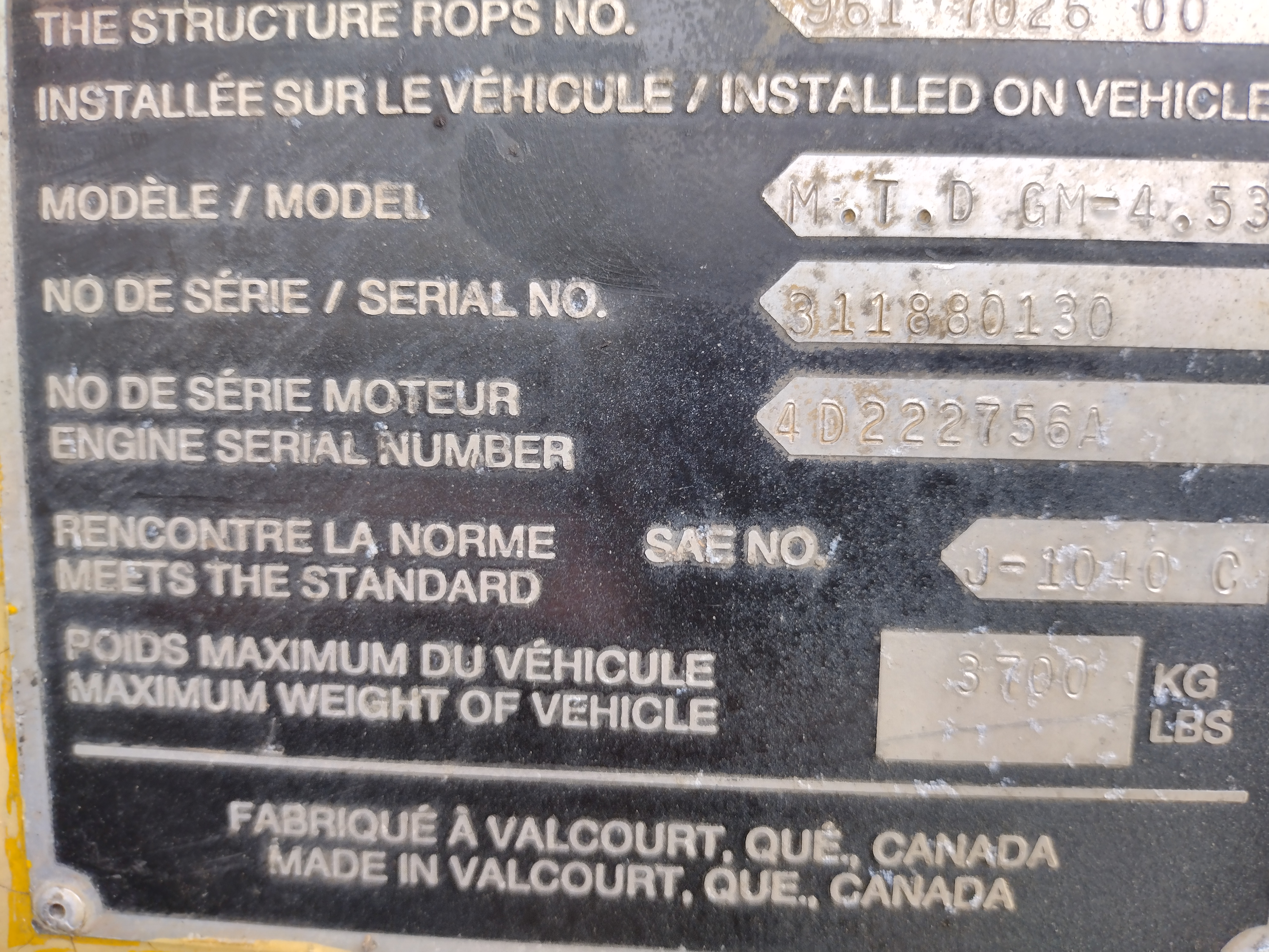

The one tag in the cab I've found so far referred to model M.T.D and had GM-4.53 both where it said model. By serial number it has 311880130. Didn't find anything else, but I plan on going back to look at it tomorrow.
J5 Bombardier
Bombardier Archives shows your machine was produced in 1983 , one of a batch that went to Belisle Track Sales Ltd . M.T.D , I would say is, Muskeg Tractor Diesel , that detroit motor is mounted behind the cab correct , making it a tractor. The Muskeg made right after yours "31" is a M.C.D , " muskeg carrier diesel"

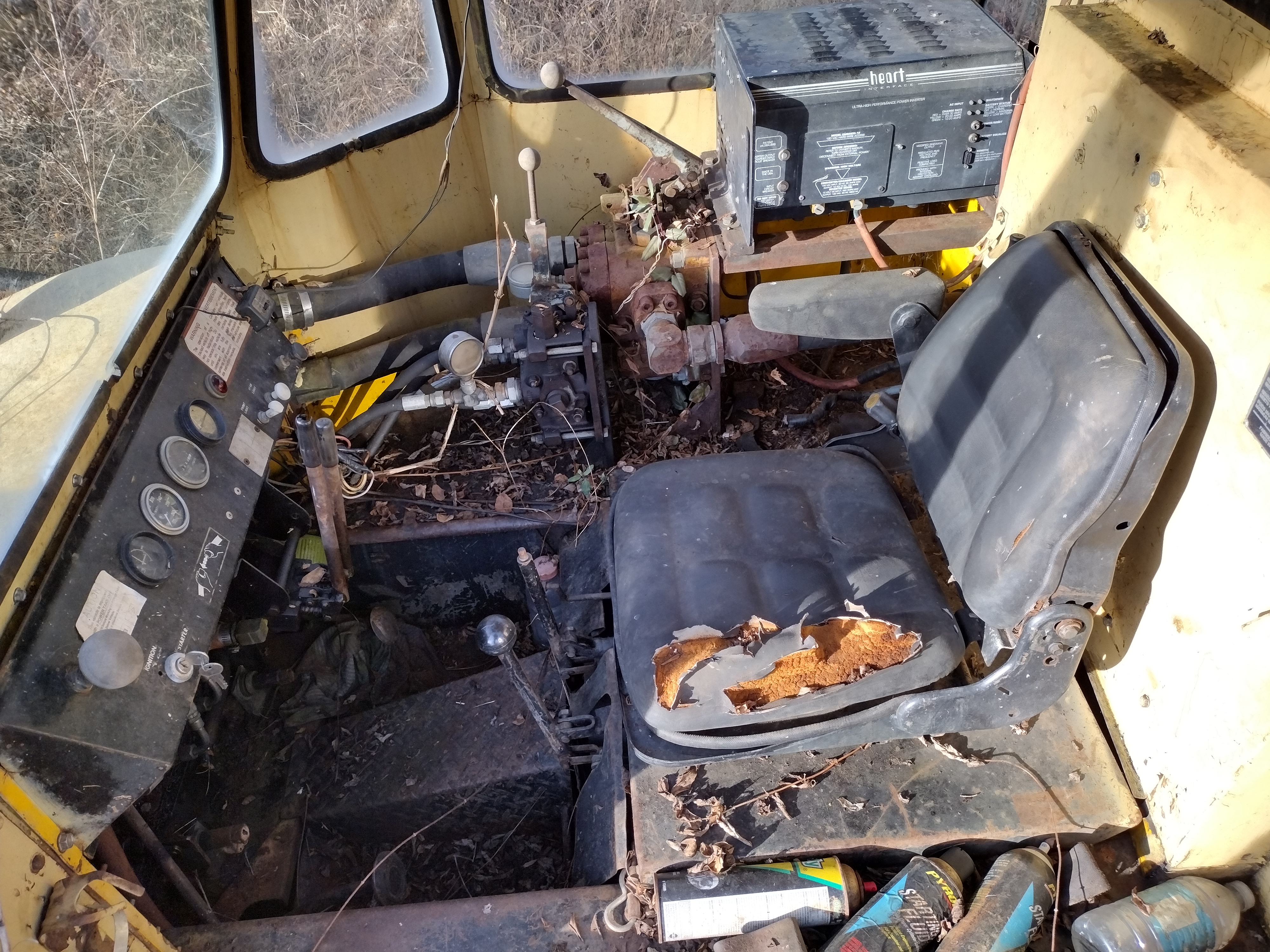

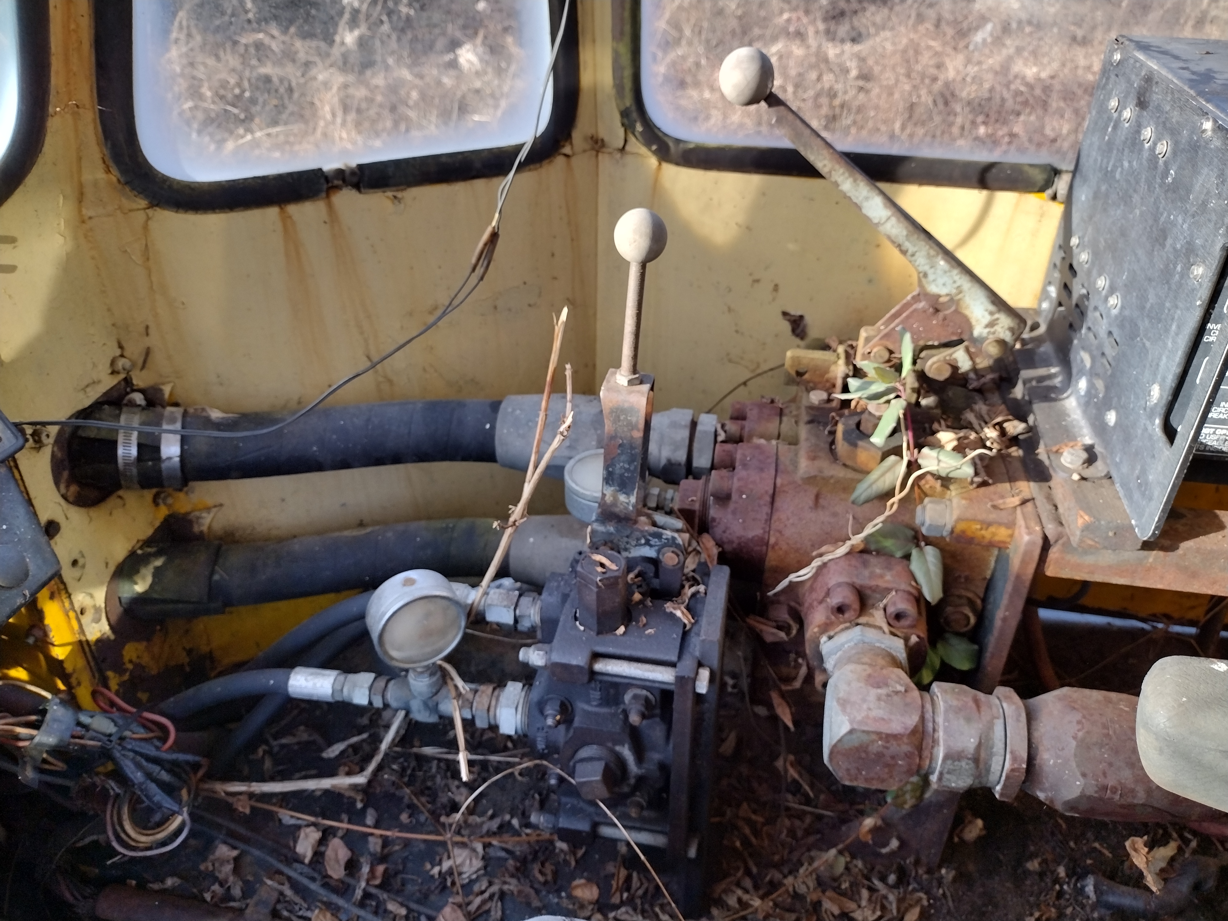

Correct, it's hooked to a five speed transmission (according to the plate on the dash). Small single seat cab. It has a decent size hydraulic pump attached to the front of the motor... almost in line with the crank. Haven't gone deep enough to see how it's attached. The welds for some of the brackets look factory. Also the arms coming back from the cutter look original. It appears to have hubs of some sort if that means anything. Did the factory ever produce these with attachments?

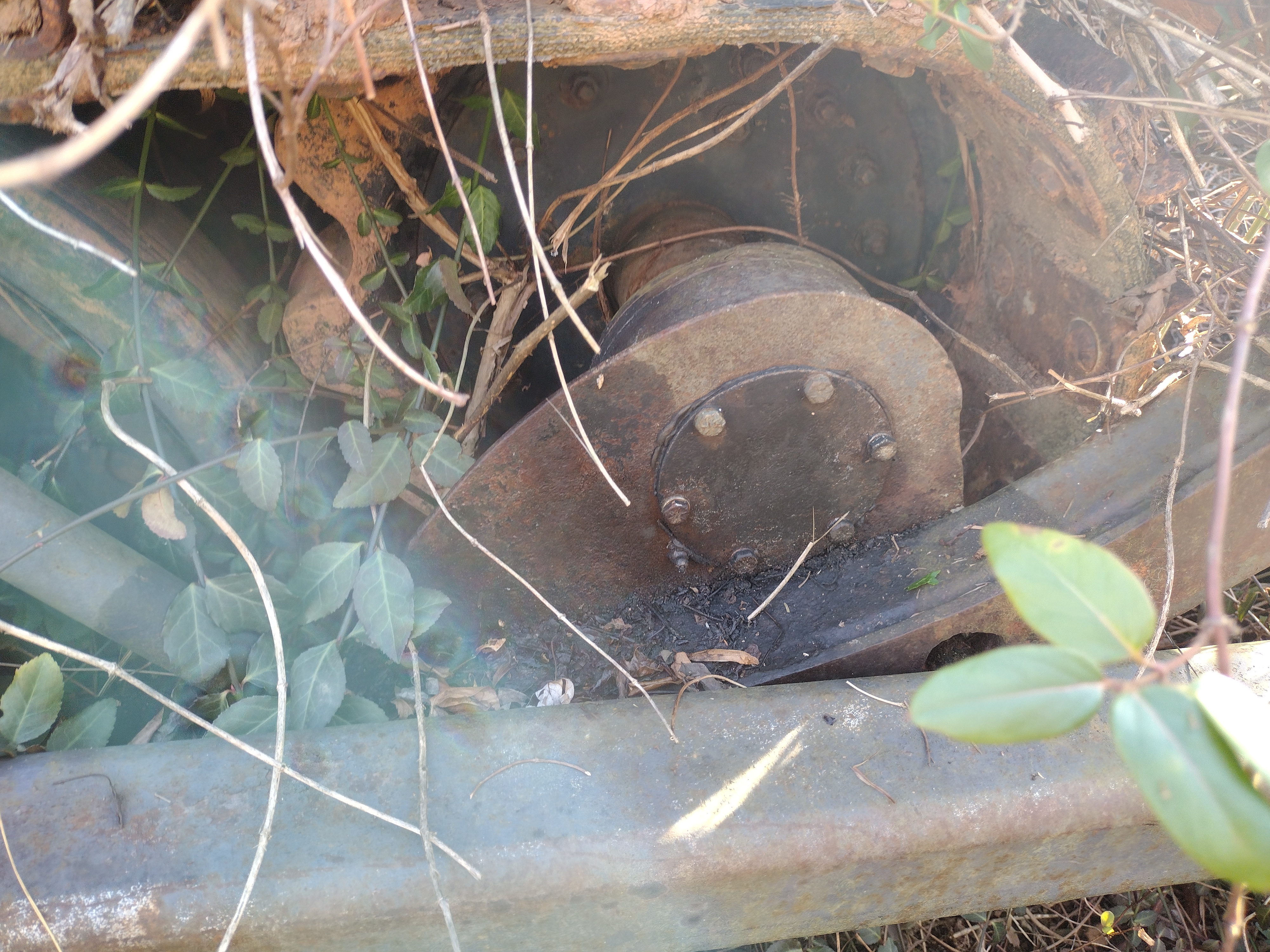

I've 'heard' that there were structural modifications to beef it up and the tracks were heavier. Are all the tires solid ?

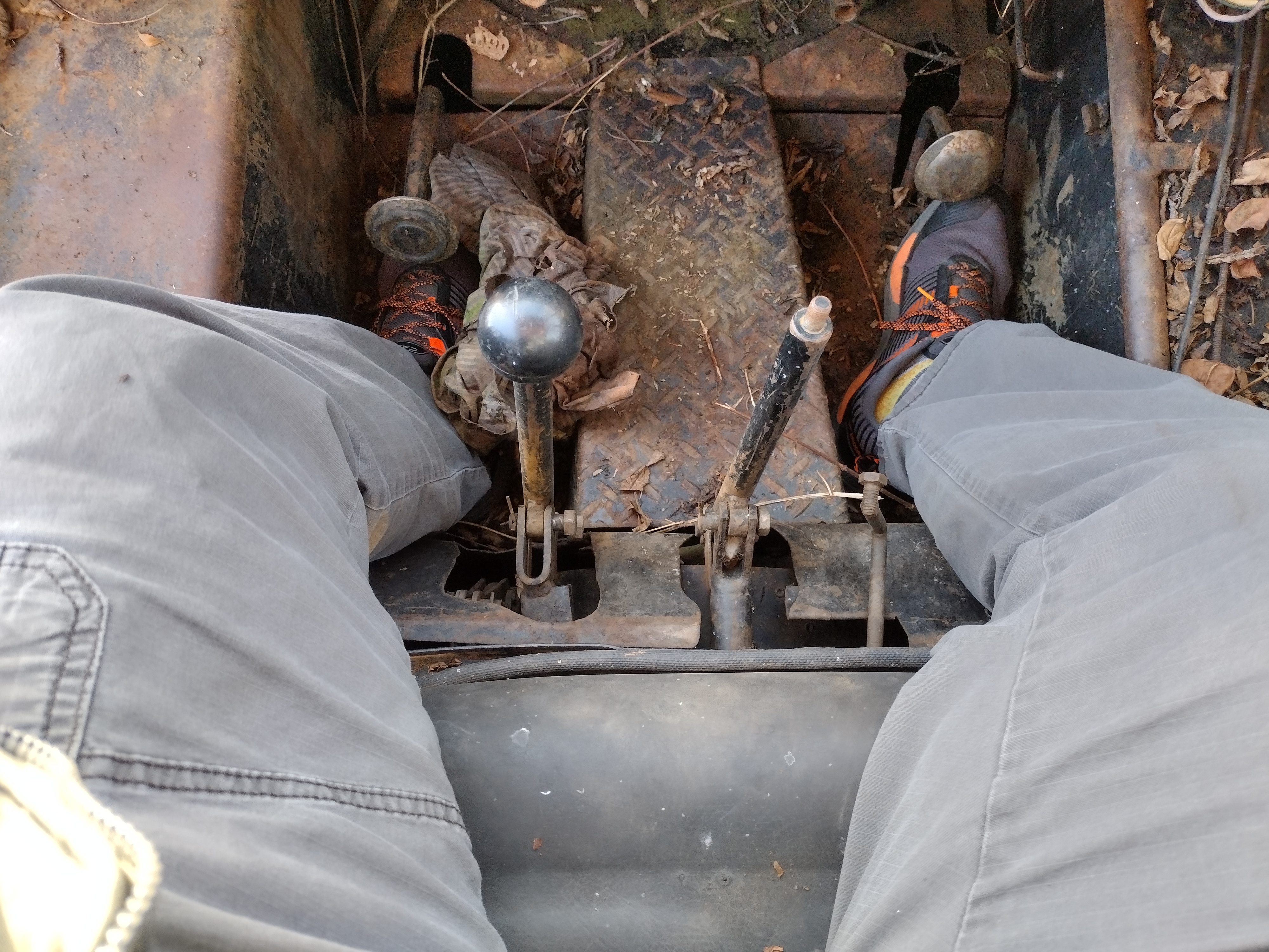

Ok, I'm not afraid to ask...... where's the clutch at??
Concerning the tracks, tires. Yes, they are all solid tires and seem to be in decent shape considering it has sat here for five or more years.

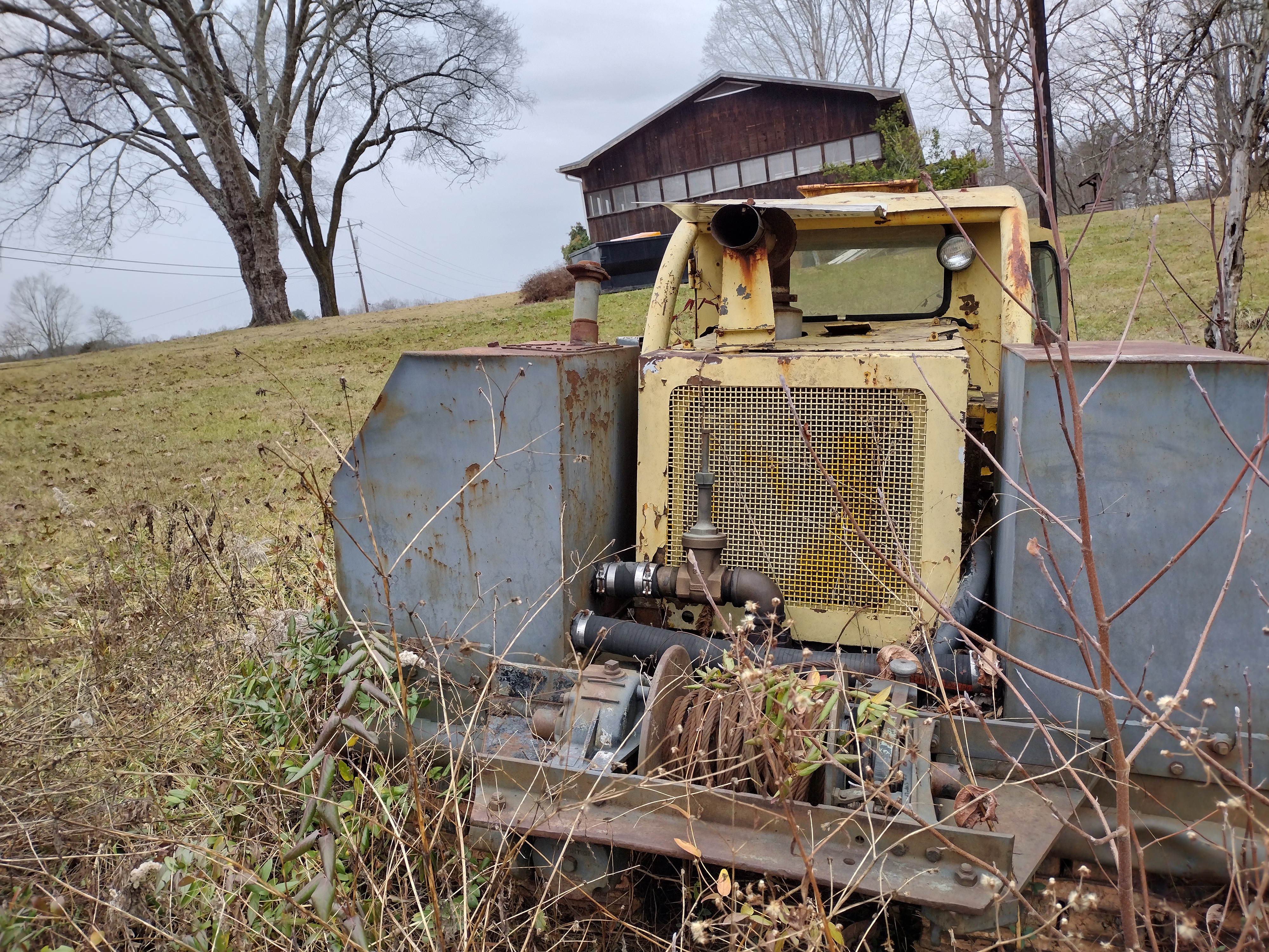

I know there seems to be plenty of surface rust, but nowhere did I find anything substantial. A major pressure washing would yield a much better looking machine. I'm trying to get an accurate idea of what it is and machine concerns before making an offer for it. He's a very nice guy, let's me stop and look over it for any information. It's sitting at his deceased father's place that they are renovating for family. They plan on getting rid of it soon. If there are other things to get pics of let me know.
Shea
J5 Bombardier
Nice pics , first one I've seen set up like that. That detroit must be working hard turning that pump to keep that brush hog going.

It's a beast ! Looks like another I saw in NH years ago.
Is that a dead bird on your foot lol
Clutch is on the left. Brakes are in your hands.
I agree that the engine might not be up to both mulching and moving.
I think the weight number is way too low. The solid tires and heavy track and all the hyd. plumbing add lots of weight.

No dead birds that I remember. From first hand accounts that machine is an absolute beast. That engine is rated at 117hp and probably more than 300lb-ft of torque. Drive losses in a forward low range wouldn't be so bad that it couldn't also cut effectively. I bet the weight is machine empty only. The cutter is over built and with both of those hydraulic tanks I wouldn't be shocked with 1500lb extra at a minimum.

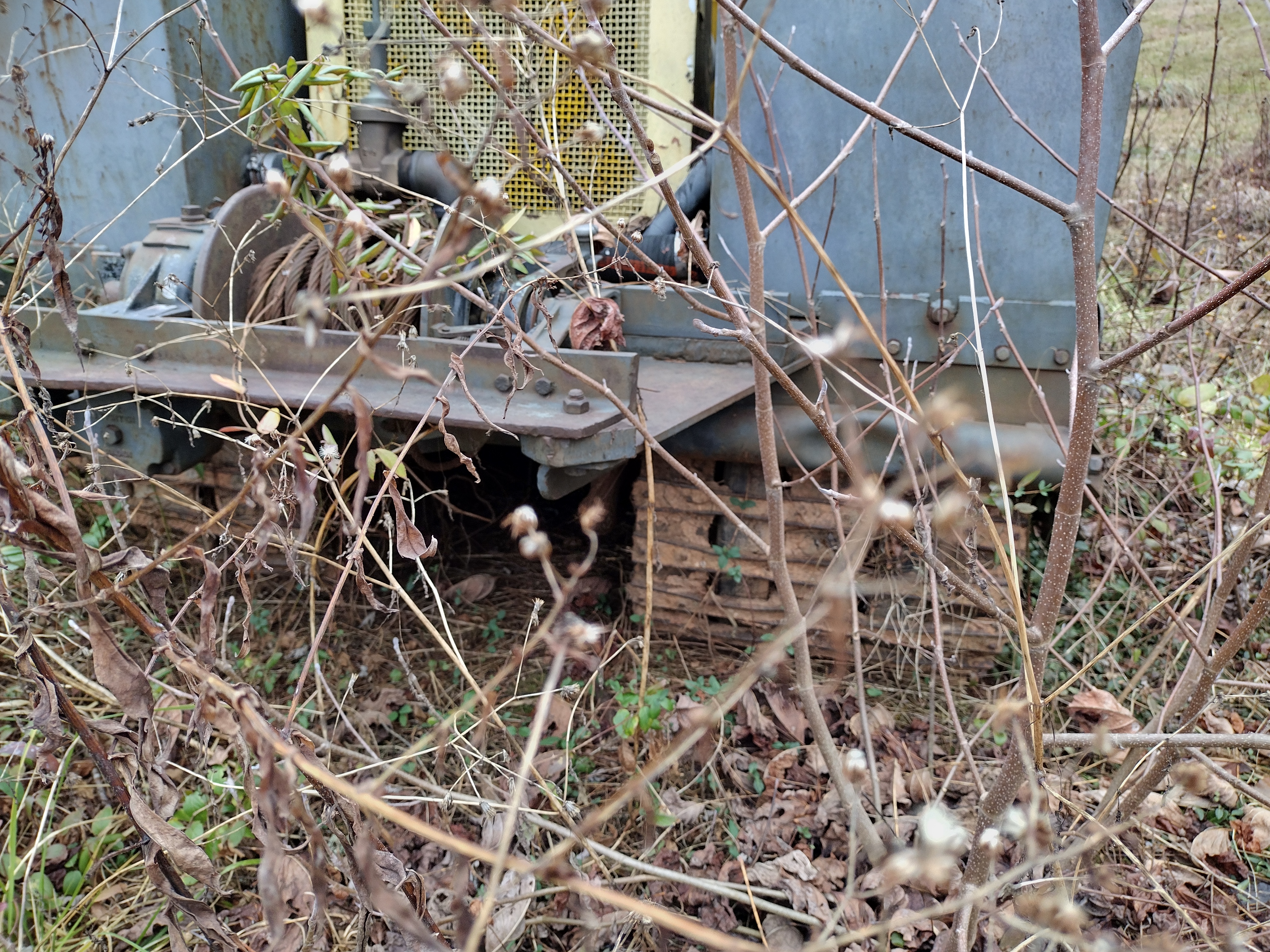

3700 kg stamped at the factory , 4 ton sounds a little light , but all the brush cutter stuff would have been done after leaving the factory I believe. Rust , cosmetics is not a problem , I'm sure the Jimmy would fire up after a little coaxing , if it moves and steers that's a bonus ( diff parts are pricey) Flat crossers which you don't see much, easier on the ground) , all solid wheels , detroit power with possible a reverser that's a nice machine. If it was mine I'd chuck the brush cutter and run it as a tractor, you can never have enough Muskegs.........

It does have a reverser to the left of the shifter, I forgot that tag was on the dash. There is something to the right of it, not sure what that is. I'll be honest, not sure what flat crossers are. If I'm thinking grousers, they aren't flat....U shaped if that's an accurate description. What's the easiest....if that's even possible....to check the diff.

Hard to tell on the grousers, going by one pic , not important either way.

I assumed that. We were hoping to get it and have it moved at that price, we'll see. I did go and look at a couple of things. The Braden winch is pto driven and the hydraulic pump is belt driven (x2) off of the crank pulley. I think the cutter and setup came new. Everything is too well engineered and put together to be a cobbled up job. The rear winch mounting job is seriously heavy duty. Will probably figure out how to add a pintle hitch to it. I'll know next week whether I become a member of the owners club, but don't see why it won't happen.
