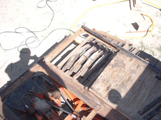

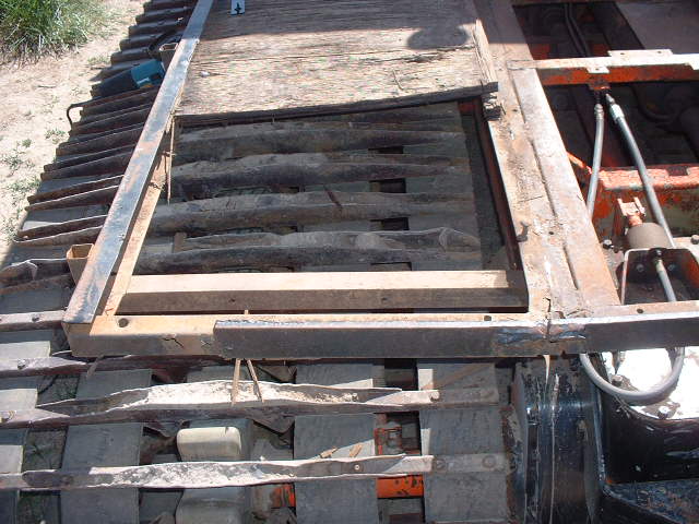

Started the extension job on the rear deck. Need to remove the bad section anyway and weld on another 12". This should help keep the snow off the deck and give ne some more bed to place stuff on. Heres the beggining stages.
I am not sure if you can tell in these pics but I have revoved the home made center section of angle iron. The rear sheet nmetal cap for the ply wood was also remove. All this was done with a 4 1/2 cutting wheel on my grinder. Cut a section of the weathered plywood off so you can get a better idea of the damage. Looks like they had something heavy off the back which stressed the light deck material.

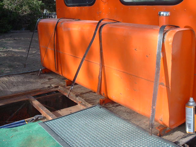

Well I finally got around to removing my tank today. Needed an extra set of hands to help move her since she was about 1/4 full. My new self priming siphon hoses should be here next week but I wanted it off so I could finish my rear deck! AND no I wont siphon it the old fashioned way.
I also finished cutting the rear deck section off. I will weld up some new supports and also extend the deck back a bit. :thumb:

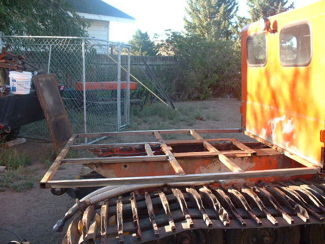

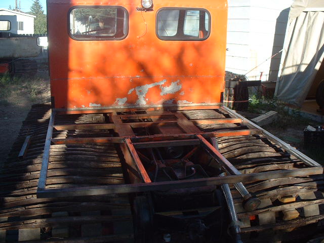

Finished the new rear frame for the deck. The inner two are 1/8" wall as is the very end piece. The rest are factory thikness which is 1/16". The outer edge is done in 1-1/2 " x 1-1/2" steel square tubing which is much stronger the the sheet metal they used at the factory. I also beefed up the rear OC12 frame mount with a piece of 1/8" thick 1-1/2" x1-1/2" square tubing. I will get some pictures of the plywood deck (Form plywood is very H.D. and water resistant!). I like this stuff better than marine grade plywood. I think it will last longer plus I will spray it in my Bedliner stuff both sides.
