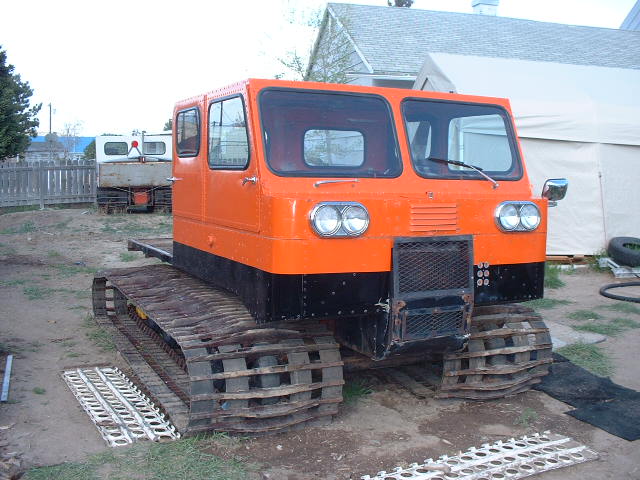

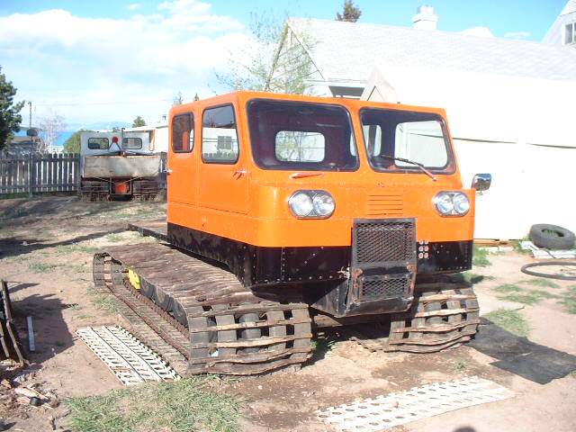

I like the before pictures better . Can you throw some dirt and mud back on it ? Maybe a little grass seed in the tracks to give it that nice stationary permament look .
OK now i'm just bragging!:yum:

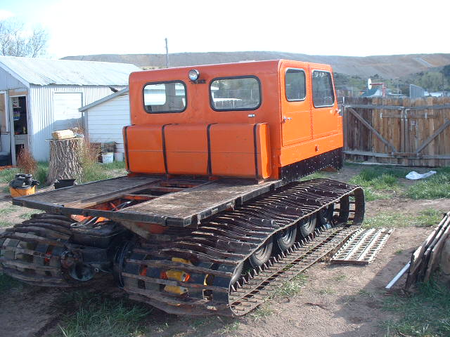

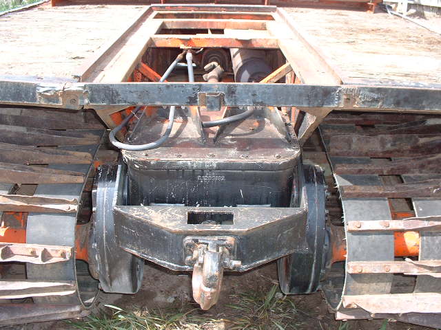

OH yah the rear deck gets worked on next. Need to pull the tank. Buff both sides, have it boiled out just to make sure no gunk is in there then add some nice new plywood and spray it with bed liner.
Nice series to show the 'metamorphosis'! :thumb:
I think we should all just start this as a standard whenever any of us pics up a new addition to the fleet. With plenty of pics :weneedpic like here for 'The General'!
What a steal too! I just picked up my 601 a couple weeks ago. Haven't had a chance to do anything on her but I can at least describe the ridiculous journey to get her! :pat:
Keep up the photo trail! Good stuff.
Mike ,
Just remember when you boil it out at a Radiator Shop ,you will lose the paint job . Heres is a easy way to tell if you need it done .
1. Remove the sending unit .Scatch mark it to know which way the sending arm goes .
2. With a high power flash light ,shine down at the bottom and look at the interior .
3. If it is fairly clean just rinse and air dry real good . Add a container of water additive with the first fuel .
4. If it is rusty , put about 100 assorted nuts and bolts in it and slash it to a old cement mixer and turn it on for about 2 hours .Duct tape the sender unit hole closed . Makes a hell of a racket but it will knock the rust out .Rinse out till it runs clear water and you are good to go . It you decide to go with a Plastic liner have a Rad shop do it . The do it yourself kits are crap . NEVER EVER weld on a tank that has a plastic liner installed . It will turn the liner to a grain like substance and plug everything up !!!!
5 .IF it is full of gummed up gas dump a bunch of dish soap in it after you get all the old gas out you can . Put a garden hose on the bottom of your hot water tank and use the hot water to soften up the gunk . It also makes your water heater more efficent and gives it a good cleaning too .Repeat with step 4 if needed . It should save you an easy 100 bucks .
Well today will see me really cleaning each window. There seems to be some over spray on the front and side window. It was parked in a automotive repair shop for a bit. There is also tape residue from the for sale signs. I will scrape that off as well. Then the window seals will get cleaned once more then treated with a UV protectant and rubber treatment. I need to pull the fuel tank and remove the rear plywood. I will reinforce and weld up a few spots on the rear deck that have cracked over the years.
