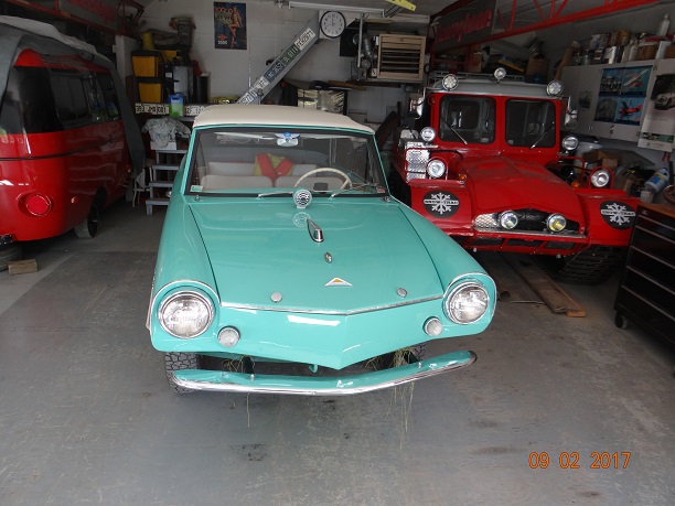

NOT A SNOWTRAC (WINTER TOY ) A SUMMER TOY !!!!!!!!!!!!!!![[ame="www.youtube.com/watch?v=8mz3sSHxFG0&t=1s"]www.youtube.com/watch?v=8mz3sSHxFG0&t=1s[/ame]
PICTURE OF WINTER AND SUMMER TOYS
AMPHICAR ENGINE BAY

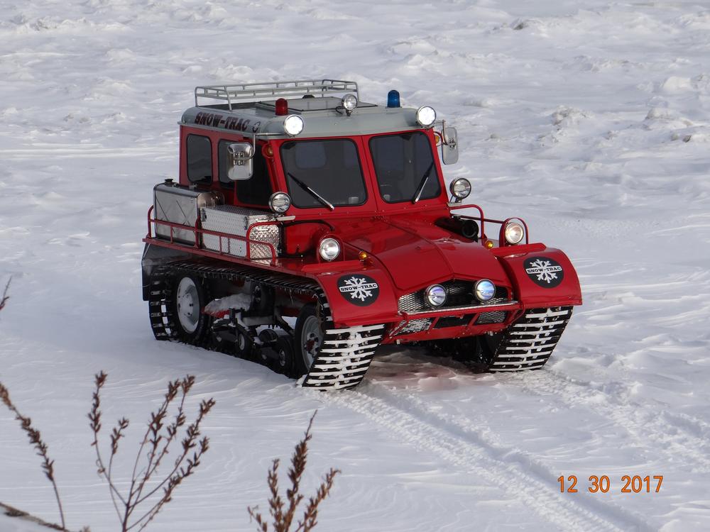

PICTURE # 1 hivert 26 dec.2015
PICTURE # 2 hivert 30 dec.2017
PICTURES 3 & 4 early winter SNOWTRAC season !!!!!!!:clap:::slider3:

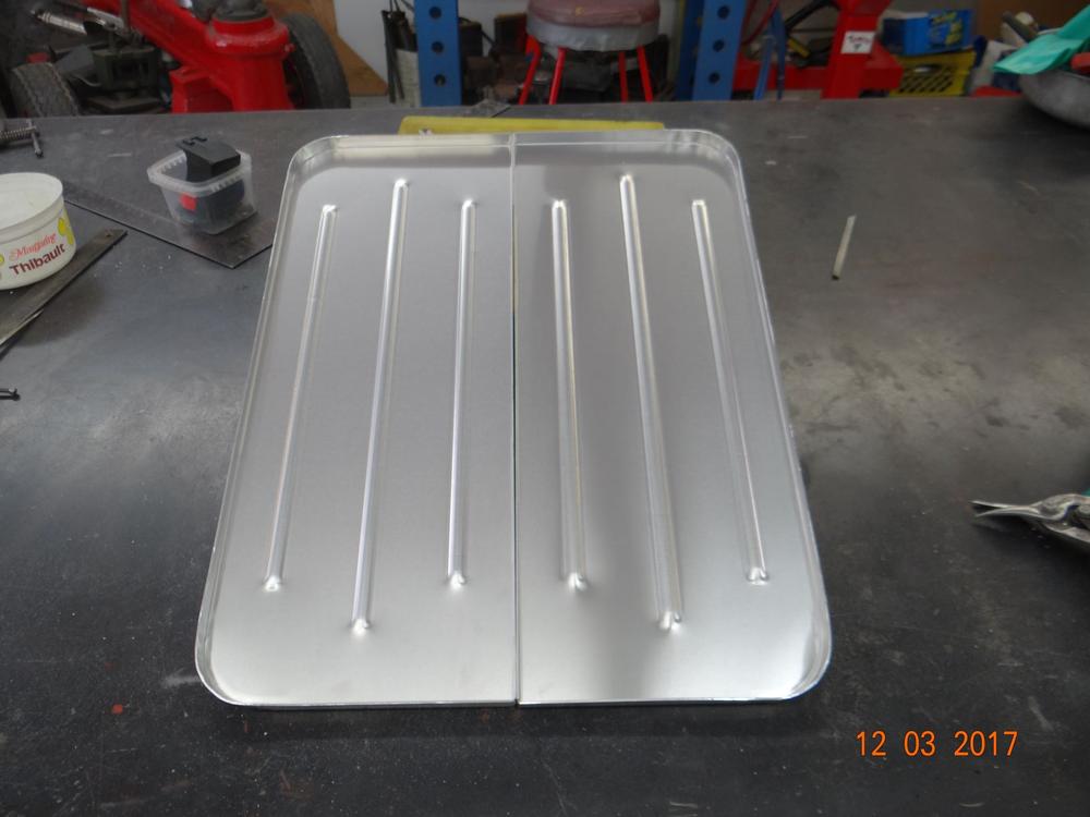

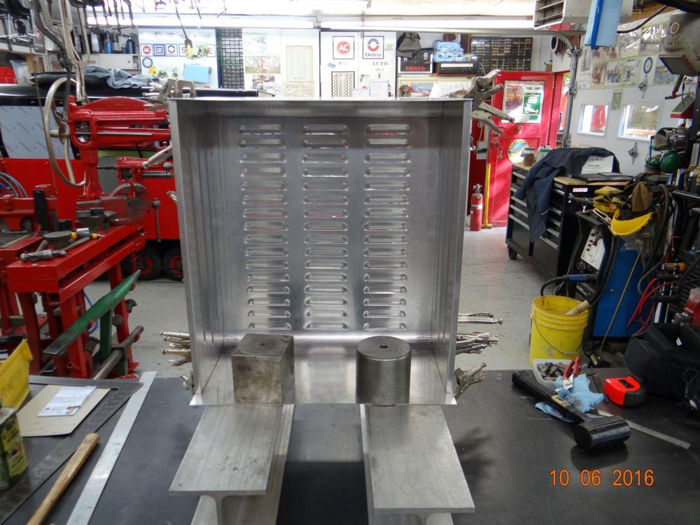

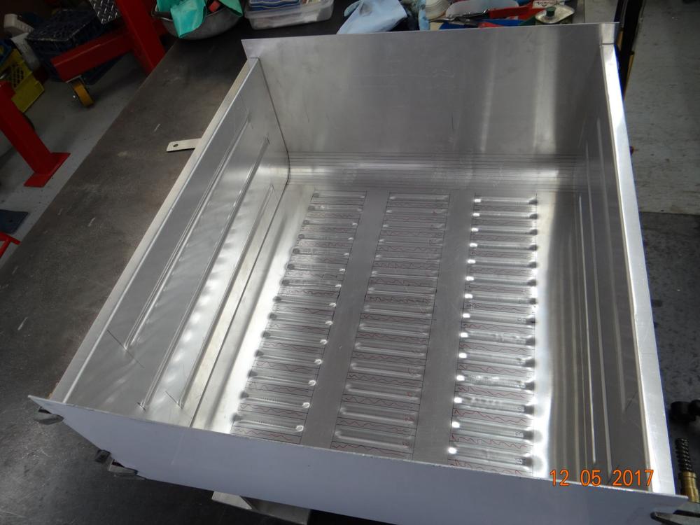

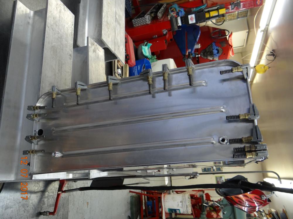

IN THE BACK ; PICTURE #8 YOU SEE ONE TANK ( 18 GALLONS ) AND ONE RADIATOR CAPSULES
PICTURES # 1,2,3 RADIATOR CAPSULE
PICTURES # 4,5,6,7 GAZ TANK
46 MAN HOURS TO DESIGN AND CUSTOM BUILD THE RADIATOR CAPSULE
52 MAN HRS FOR THE GAZ TANK ; DESIGN , BUILD , HARDWARES FABRICATION , WELD AND TEST

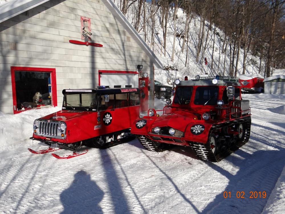

MINI SNOW PROTOTYPE + SNOWTRAC
[ame="http://www.youtube.com/watch?v=quRDHqYxALc"]http://www.youtube.com/watch?v=quRDHqYxALc[/ame]

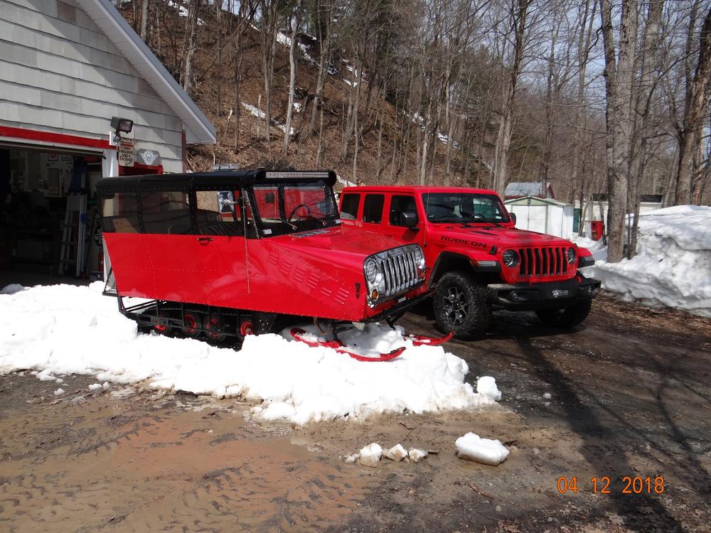

PROTOTYPE MINI SNOWMOBILE
TEST DAY ; C.V.T. TRANSMISSION CALIBRATION
[ame="http://www.youtube.com/watch?v=uprFMyQhqQw"]http://www.youtube.com/watch?v=uprFMyQhqQw[/ame]
THANKS Nikson

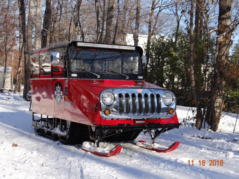

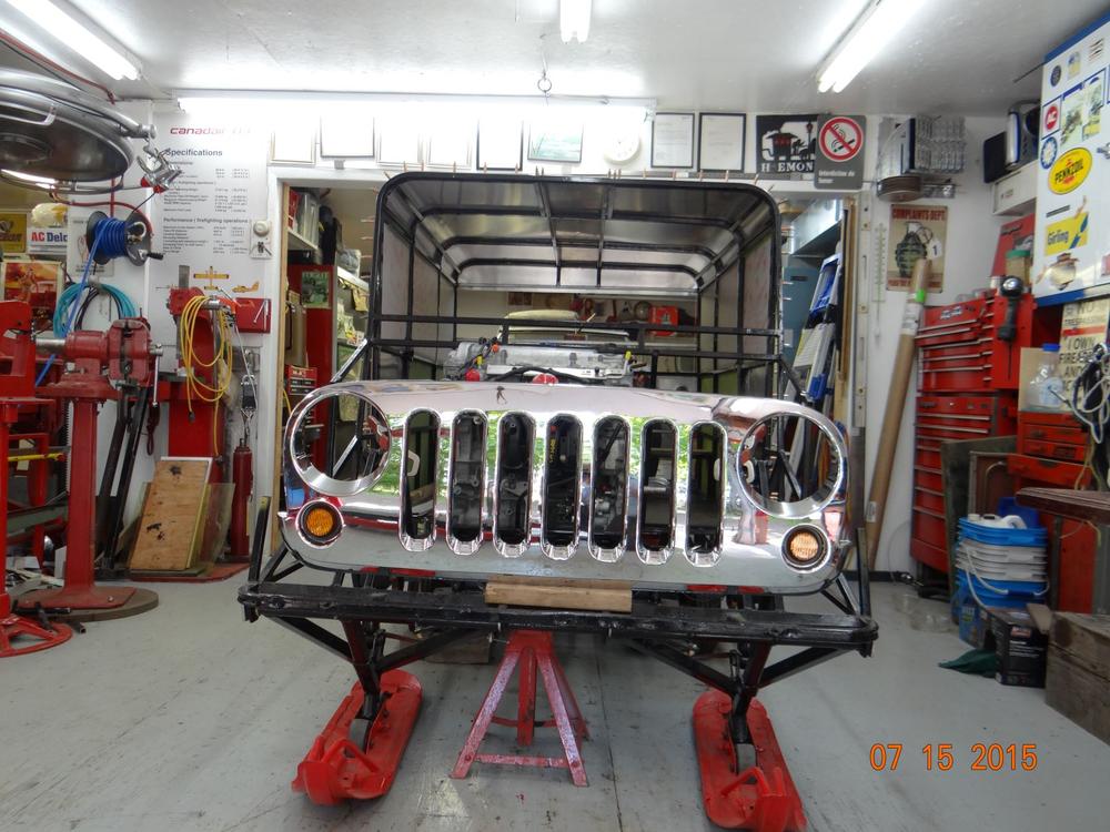

Here are some pictures showing the process to install a Jeep grill :
Be aware that the plastic Jeep grill alone has no structural integrity; it must be installed at a precise angle on a solid support; also the lights are not part of the grill but should be part of the support
The process of installing a Jeep grill is easier done than said !!!
You have to take in consideration: building the support, installing the lights with their ajustments, respecting the proper angle of the Jeep grill and so on
It took me fifteen days before the painting process:thumbup:
