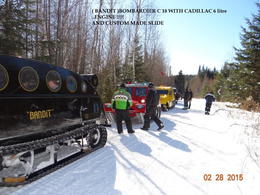

At the Hosanna Jamboree, all snowmobiles were Bombardier:
B12 narrow-gauge mostly with original Chrysler T 120 engine
C18/R18 wider gauge with V8 engine “those snowmobiles can go easily 60 to 70 M.P.H. “
Out of the 28 Bombardier snowmobiles at the Jamboree, I would say that 50% now ride on custom made slides (see BANDIT picture bellow )
(they removed the 3 front wheels and install a set of custom slides keeping only the 4 th wheels)
At one place (Lac Canard) in up hill situation all the Bombardier snowmobiles with slides go up easily;
Some of the B12 on wheels need to be winched by the big Bombardier C18; (the slides are definitively superior of the wheels set up)
When the Snowtrac took the challenge, the Ecotec engine make all the differences and successfully climb the hill

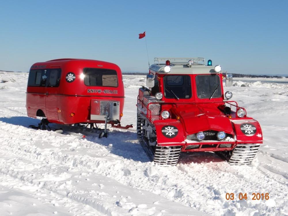

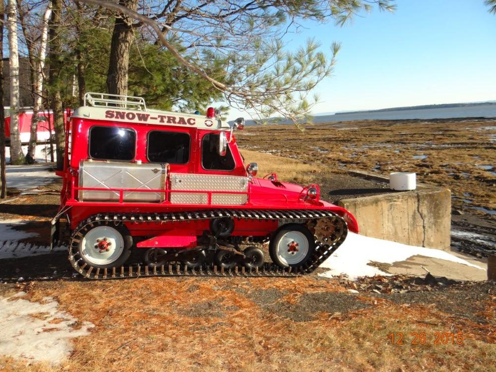

First picture:
Snowtrac and snowshack on the shore of the Saint-Laurent river

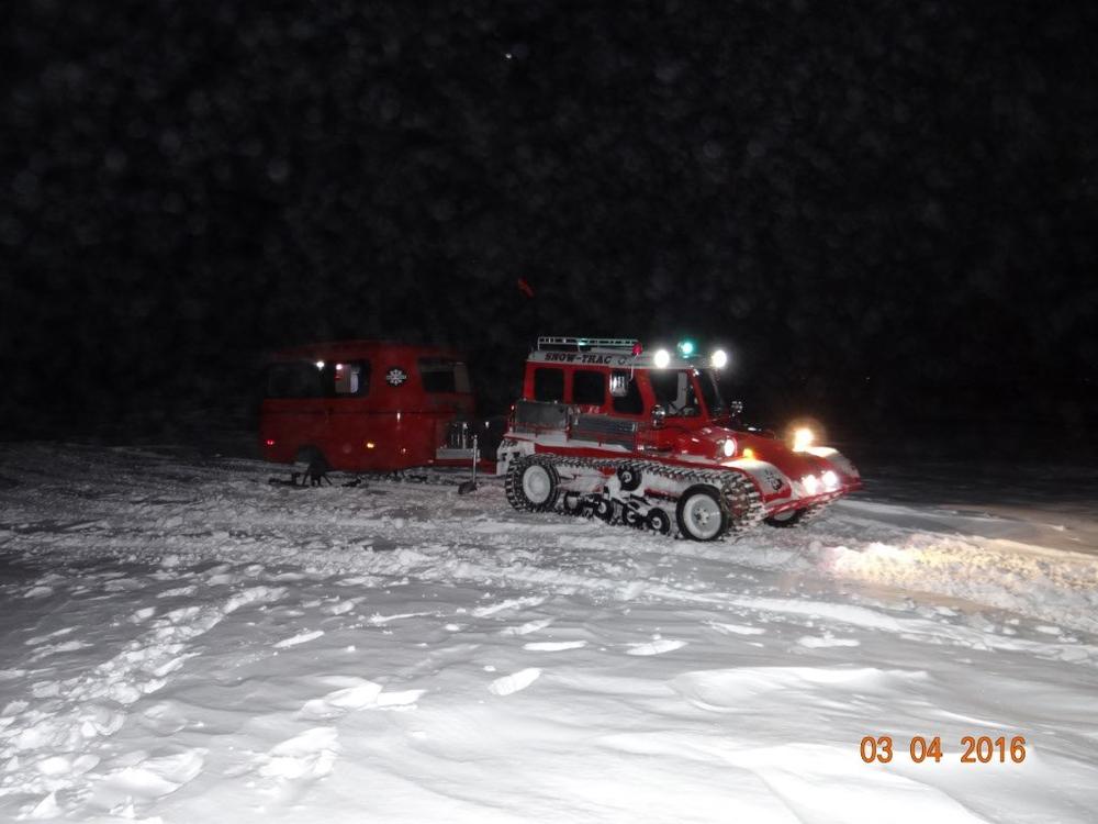

Second picture:
Snowtrac and snowshack by night (very cold outside but comfortable inside for the night )

The snowtrac Ecotec performs so well; it is amazing! i have so much power available at any RPM range; during the air strip preparation I was at third gear all the time, changing the speed from 900 RPM to 6500 RPM
Working hard with the snow drag to prepare the air strip for the landing of the airplanes (the outside temperature was minus 9 F, the oil and water temp of the Ecotec were in the green range all the time)
I am very pleased with the snowtrac Ecotec program; I recommend it to have fun or to work with the snowtrac
And to finish, it has a very good gazoline economy compare to the VW engine!

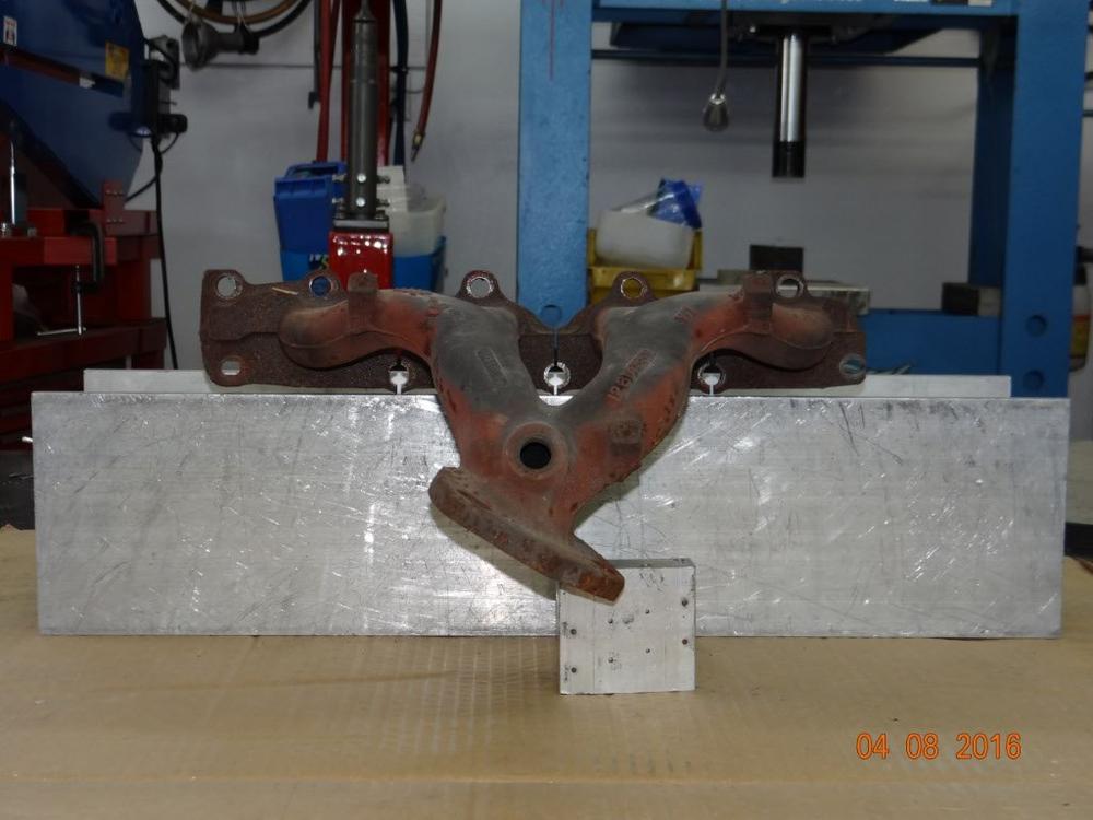

I received several private messages concerning the Ecotec conversion.
For the benefit of the Snow Track community, i will answer on my thread
Concerning the snow master of "NWERRING", being rebuilt with a Ecotec 2.4 from a 2011 chevy Malibu.
Question 1: Solo-Performance header?
In my Ecotec installation I used a header expecting to gain 10 HP
During my test program, the Ecotec 2.4 gave me so much horse power so i realized the header is not an absolute must; a regular cast iron manifold from a Pontiac Solstice/Saturn Sky can do the job at a better cost ( see picture )
Question 2: Engine injected or Natural Aspirated?
The Ecotec 2.4 LE5 engine is a OEM reliable fuel injection system
Question 3: Where did you mount the cooling radiator?
I have installed a RADIATOR CAPSULE in the back of the snowtrack (left side) to have a better weight distribution (radiator, fan and prestone 40 pound )
Question 4: "You said you have a set of 15 tooth gear sprockets"
Personnally, i would try the 15 tooth gear setup at the beginning and if you have to make special gear i would go higher up to 17 tooth
For the benefit of all members willing to install an Ecotec engine, i will be happy to answer any questions on my Forums forums thread (Snowtrack restauration project ); so the information will be centralized at the same location
