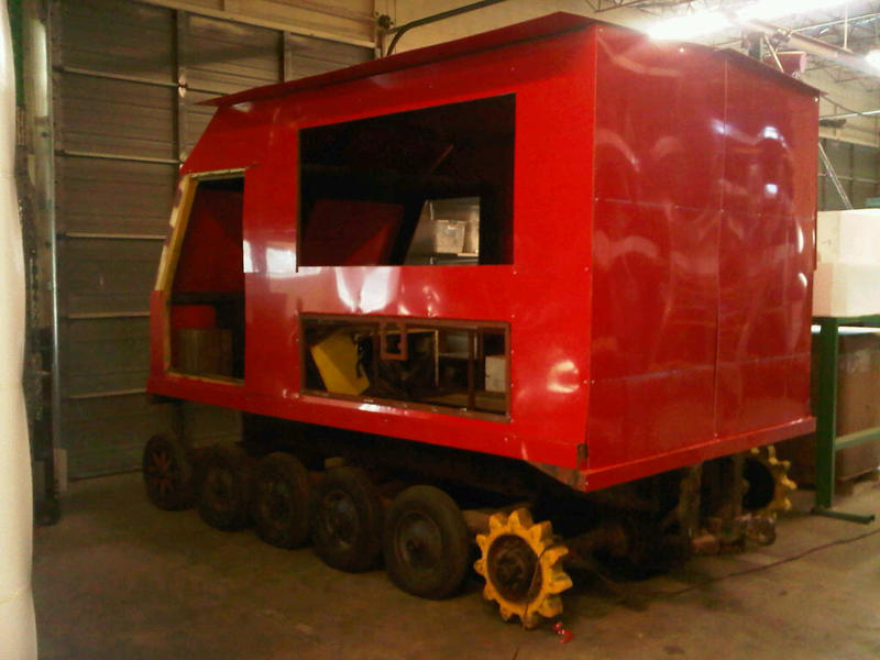

Pic of the 302HD almost fully wrapped in .040 red alum skin. still need to cut out the 6 factory windows and the rear door. The large side cutouts are for a 60x30 window on each side and access panels under them. Fuel on one side and general storage on the other.

Been a long time coming...but it is finally starting to get close...
put one track on...then unrolled the other only to find is was in much worse shape than the other, had a bunch of track guides bent/smashed. Wonder if it was run with a flat tire? I have removed them and welded on new guides.
The problem i now have is cracked Alum grousers, some of the inner square grousers are cracked. Was wondering if anyone has slid steel inside the ~1"x.75" hole to give the alum grouser additional strength right where the drive cog applies pressure? Build a internal steel bridge?
