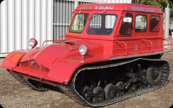

So I got the brakes bled, adjusted and working. Adjusted the chains and tracks. Engine turns out o be a 1600cc dual port with the 009 distributor and a spin on oil filter mod. Runs well.
0
I took it out for a spin in the parking lot across the street. Shifts thru all the gears and drives well. Planning on a New Years Day maiden voyage.

Thanks for the info. I thought the drive would have some sort of gear reduction like on a conventional transmission attachment, but if it is just a direct drive off of the big drive sprocket, I think i can craft something that will work. I mounted a GPS yesterday that should work until I get the OE unit back in shape.
Overall the rig is responding well to love and attention. Spent yesterday welding a few cracked grousers, sorting out a few poor grounds that were causing some lighting issues, cleaning and polishing. She is starting to look as good as she runs.
After looking a little closer and conferring with Don, it appears that a PO at some time decided to cut the longer grousers off to the ST width. Don says this is not an uncommon practice to narrow the rig for trailering. I guess the up side is that if I want to return it to a wider track, I have less work ahead than if I had to replace every grouser, but finding the needed grousers may prove to be difficult. I guess it
s like Mom used to say, "Never cut what you can untie"....
This rig, like many it seems, is missing the under engine tin. Any opinions on fabbing one and putting it back in place?

If I were to guess, I'd say someone put snowtrac fenders on your trackmaster like someone put snow trac tracks on my snow master...
I thought my master was (cut) down as my machine looks like utahs.
RD:
I am thinking you have a master with just the outside belts cut off. the snow trac st4 tracks are shorter than trac or master or 4b tracs.
I agree. I can see where the wide grousers have been cut off in slightly different lengths and angles. If I keep the rig long enough to consider re-belting it, I think I will just make the belts extend beyond the wide grouser by 1/2 to 1 inch and call it good. Currently the grousers extend beyond the belting by about that amount.

So finally we got the crew together and headed out for a shakedown cruise
Not tons of snow, but enough to get an idea of how she runs and handles
All went well. Ran great, no hiccups, Probably going to fiddle with the steering wheel a some, seems to rub on the shaft housing a little. I may have tightened it more than it is used to. Otherwise, seems to be ready to head into the backcountry.
Very cool steering system. I had a chance to traverse a slope that would have given the LMC fits. Very nice to not have to drag a brake to stay on the slope. Also was able to turn uphill without any drama or loss of power. Like I said, not very challenging snow conditions, but enough to get an idea of what the machine was about....
I never got my pointed head into position to count the teeth on the small sprocket. She seems to be very happy to cruise at 10 MPH on the flats in third at about 2100 RPM. If it is geared a little lower than a ST, I think that may be a blessing at our altitude.
Thanks to all who have helped out with this project thus far. Of the cats I have owned so far, this one seems to be my favorite. At least today...
