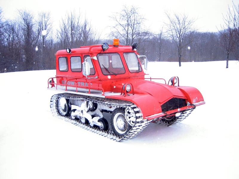

Got her home and off the trailer. Seems to run and move well, no brakes...
If anyone recognizes this rig, let me know. I'm interested in some of the history.
and a few more pics...

give us the number. that brass boggie is off an st4b. But that is good. Did he have a parts one?
after looking closer it looks like a st4b.
that's a narrowed down snow master I have seen the pics before can't remember where it does have the rare brass boggie also the tracks look a little loose the front wheel should be off the ground. the reason the rear tire looks small is be cause it extends out past the rear by about 12 inches. other wise looks well cared for.
Look at this picture, look at the distance between the top of the tire guide and the wheel. Also the top flatness of the track.

Yes the tracks are way loose......
I agree the rear wheel just looks smallish. too much gap to the fender for it to be corrrect IMHO. IF the track tensioners are all the way out that would explain why.....
Other wise it looks ok....
Regards, Kirk
the snow master runs a longer track frame and generally uses 3 boggie wheels in the rear rocker assemble I only see 2 in that one .
Looks like the rear rocker has a place for a middle bogie. I thought the front fenders looked wide for the machine. Think I should install a middle bogie on the rear?
if the tracks are narrowed it must have been working that way. why not give it a try??
can you post a rearend picture?
I don't think that is my rig, but setup is the same...although the hitch on that one and mine look the same. Is that a ST vs. SM difference??

In the original pics, the rear tires and all bogies were flat. With new rear tires on and all bogies filled up, tracks look much better! I'll post a pic or two tomorrow.
I think the rig would function fine with 2 of 3 rear bogies, but since I have one extra tire/wheel assembly and several new bogie tires, I might as well find another one and run 3.
