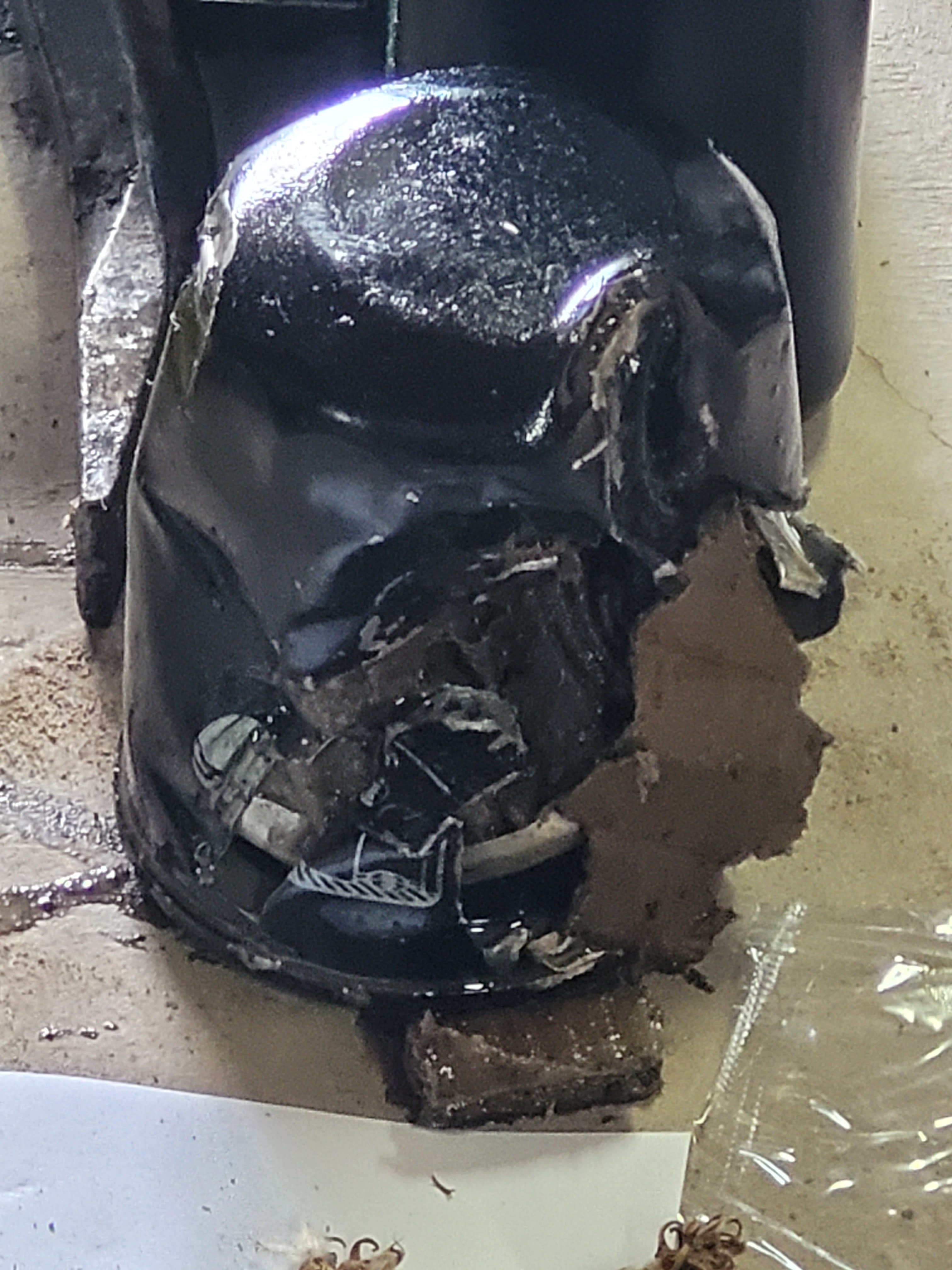

Let me elaborate a bit on that oil change.😡
It involved a few choice words trying remove the oil filter along with some creative use of a hammer and assortment of screwdrivers and pry bars. Here's what's left of the filter.
My stepson apparently felt it needed 300ft pounds of torque to secure the filter when he installed it. Same with the drain plug. It's an Allen key head. I had to use a 2ft breaker bar on the Allen key to remove it.

Been there when the filter wrench, just won't do it. If you have the clearance a big pipe wrench on the rim right next to where it scores on can get those off.

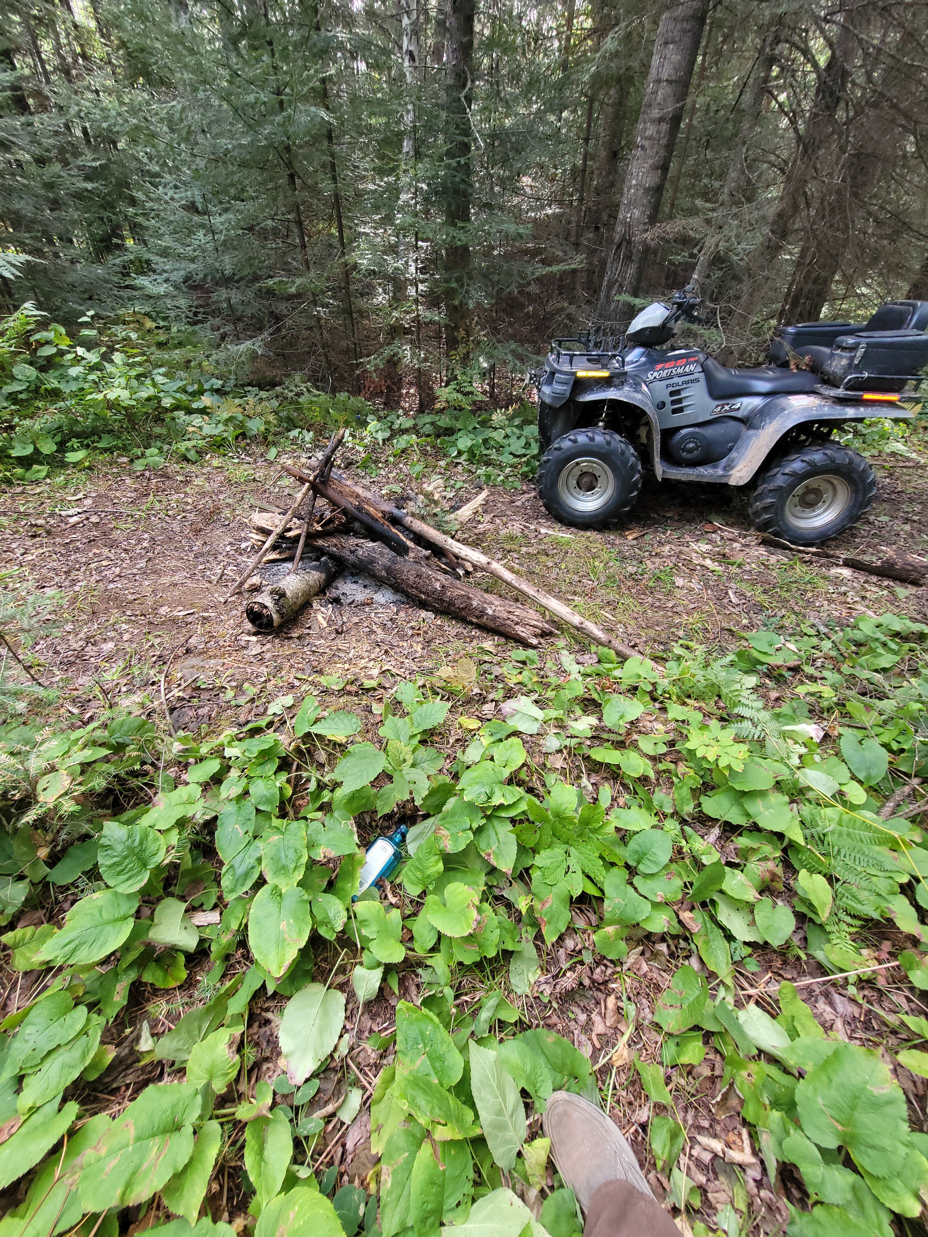

I tasked my 14 yr old to run the old sportsman around. He used it a couple weekends ago when we were at the fair to get back and forth to our house. The fuel was about 3 yrs old in it. I put a good dose of seafoam and topped it off with fresh fuel. I checked it today. He's almost down to reserve. I filled it up with fresh gas and took it for a longer ride up at higher speeds. It ran great. A little backfire when letting off the throttle at higher speeds. But everything worked great. I had to stop and adjust the air pressure in the tires as I had filled the front ones too much. But she's ready for hunting season.
(the picture is from yesterday on one of my back trails on our property where I discovered someone recently had a fire and a bottle of gin)
How old are the kids? Might want to set up a trail cam in that area
Our youngest is 15. Oldest is 21. Wasn't any of them. But yes. I'm putting a trail cam back there. Same as my neighbor. I informed him of what I found as well.

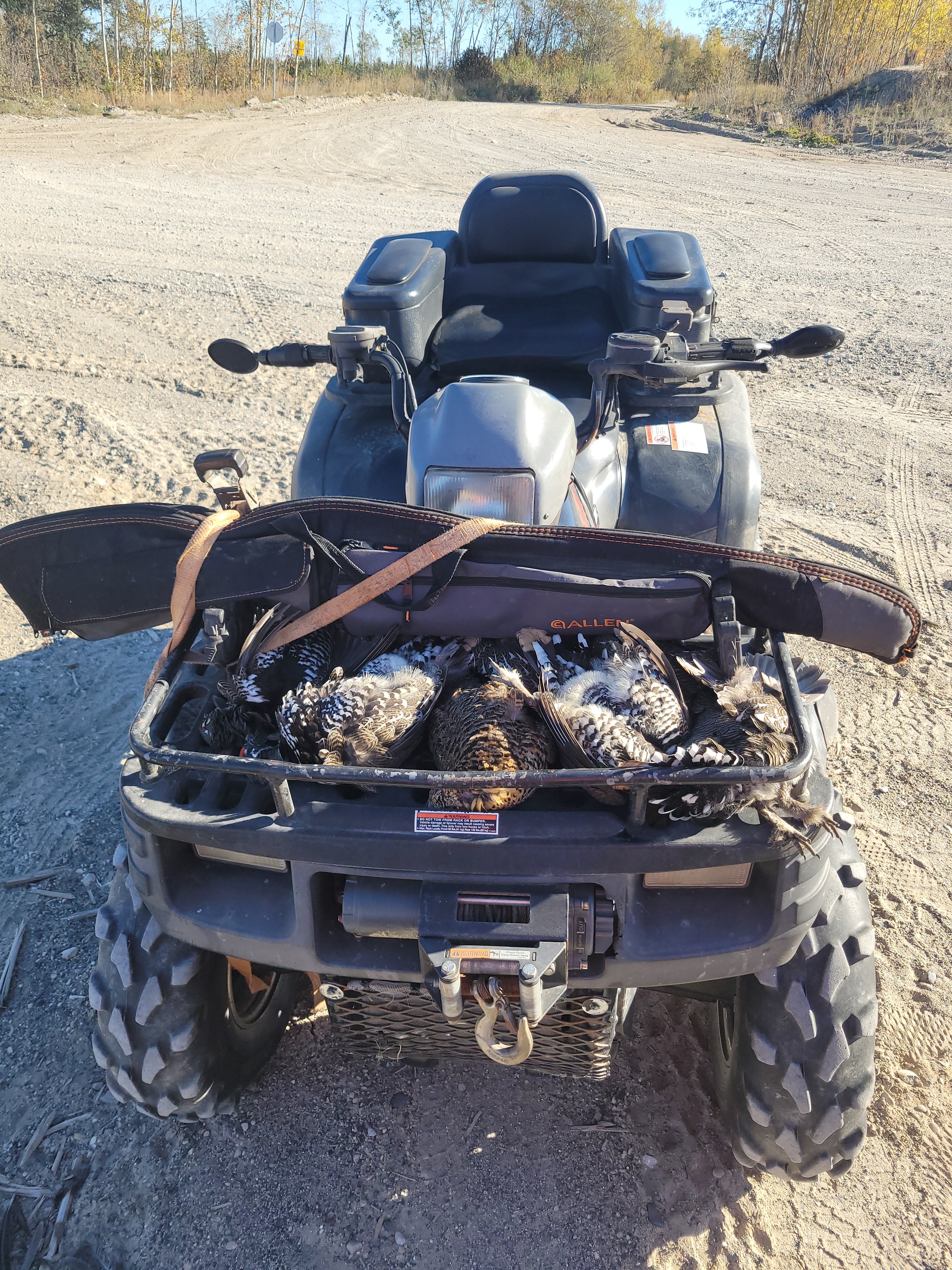

Another 10 in the refrigerator. My wife has her gun license and hunts birds as well. I taught her how to clean them yesterday. She's gone out with the ladies for an evening hunt.
I bought her a nice single action 20ga that practically folds in two. She was riding behind me holding onto it folded in half ready with a pocket full of shells.
