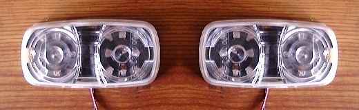

Well I just spent $48 (with shipping) and bought an inexpensive pair of 2" by 4" self contained strobe lights. These have 24 LED diodes so they are not the brightest strobing LEDs out there, but as they are going to be suppliments to my main strobe I think they will offer the little bit of extra warning light that I am looking to get. They are available on Ebay.
Also, because they are very small, and because they are surface mount style, I believe I can install them in the small space ABOVE the rear windows, but BELOW the rear roof gutter. I'm hoping to install them directly under the rear facing auxilary lamps.
