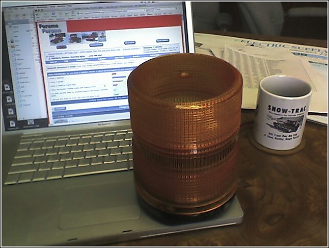

Al, just an update on the energy draw issues . . .
Here is the technical information for my new strobe, it uses a LOT less power than a lightbar!
824 Multi Strobe Beacon
Medium-profile Double or Quad Flash Strobe
The model 824 family is a medium profile, multi-flash strobe light which can be changed by the customer from double flash to quad flash operation. It features universal mounting, full size 360° Lexan® lens, high efficiency regulated solid state power supply, and heavy duty xenon strobe lamp. DC units have polarity protection and built-in filters to protect against radio interference and spike voltages. AC units are designed to withstand multiple line transient spikes of 6000V without damage. The model 824 strobe features a fully potted, Lexan®, multi-purpose mounting base which is vibration and water resistant, and has a plug-in strobe lamp and photocell which can be activated to automatically reduce intensity during nighttime operation.
Available Colors
Features
  • Universal mounting
  • Built-in RFI filters
  • Solid state power supply
  • Xenon strobe lamp
  • Available in amber, blue, clear, green, purple, and red
  • 5 year warranty on power supply
  • 1 year warranty on lamp
  • UL listed (AC models only)
824 Multi Strobe Models
Model Description Voltage/Frequency
824–1228 DC strobe with 10” leads 12 – 28VDC
Specifications
Item Description Voltage and Amperage 12-28VDC draws 2.2 to 2.4A @ 12V tapering to 1.2 to 1.4A @ 28V at hi intensity
Power Supply Output 11 Watts 17 joules per double flash
25 joules per quad multi-flash Flash Rate 68 to 72 double flashes per minute
58 to 62 quad multi-flashes per minute Size and Weight 6.75” tall x 5.5 ” dia. x 2.2 lbs ( 133mm x 140mm x 0.9kg )​

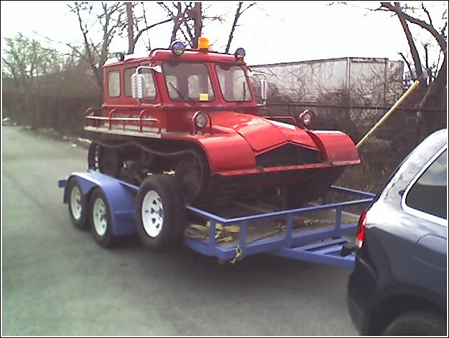

:snow_smi: Well here is a photo showing my Amber Strobe, mounted on the Snow Trac.
A pretty damn sad picture actually, its December 29, about 50 degrees (F) outside:sun1: and obviously NO SNOW anywhere.:letitsnow:

Sure, rub it in! Most of the midwest and the east are snowless!!! :(
Hey Bob, even I have a little snow, darn little but enough I was able to run the Snotrac down the road and back. :thumb: Looks like we may get a bunch of snow before the week is finished. I will try and send some further east.
