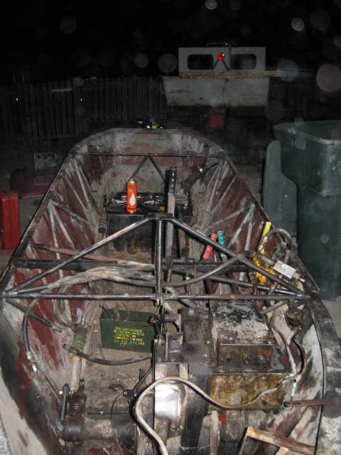

Started work on the KT-2 on Sunday. A little bit of time was spent seeing what we have to work with. The body is in pretty good shape despite its age and the thinness of the fiberglass (looks thinner than the KT-3 to me). Also, the KT-2 paint appears painted on instead of impregnated like the KT-3. The fiberglass is translucent on some spots.
The engine is apparently not the original industrial 1200, but instead a standard 1200. The Kristi hydraulic pulley, pump mount, and pump were moved over to this engine. This is based on the assumption that all KT-2/-3s had either VW industrial or Porsche engines.

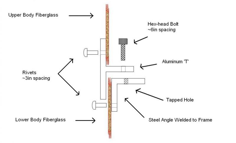

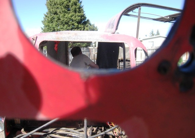

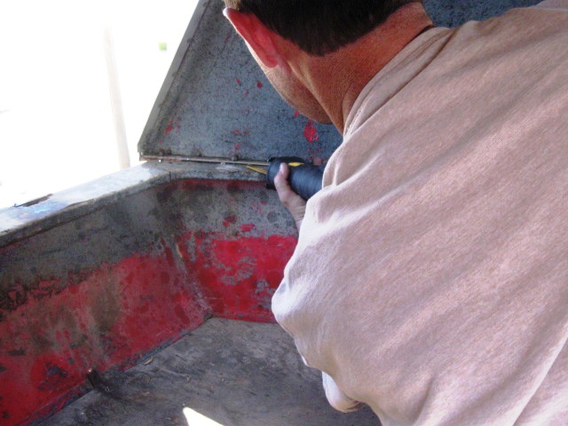

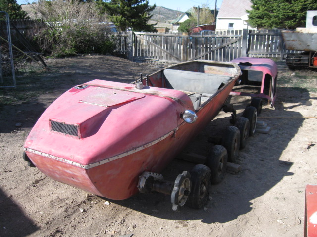

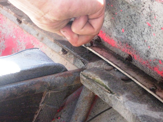

Alrighty then, time to take the top off. The first picture illustrates how the upper body is attached to the lower. The steel angle is welded to the frame starting from the face of the dash to the rear of the back seat, which is the only area where the side of the body is straight. For whatever reason, they did not follow the curve of the engine compartment or the rear cargo area. The upper body follows along the top of the dash and is held to it with about a dozen nuts and bolts. While the upper body doesn't attach over the engine compartment, it does attach around the cargo area. Instead of using steel angle here, they framed it in wood (spruce) and laminated it in fiberglass. In this area the upper body is held down to the lower body with nuts and bolts through the aluminum and wood.
Some bolts came out easily with an allen wrench..
Some required vice-grips...
And several of the ones over the rear cargo area required a reciprocating saw. This is because the nuts under the laminated wood had pulled up into the wood and it wasn't possibly to keep them from spinning with the bolt. The wood framing scheme will have to go.
Top off view from the rear.
Top off view from the front.
Once all of the bolts were out, the upper body could be slid right off the back after lifting the front over the brake levers. It was very light and could have been lifted straight up and then off, but my back wasn't cooperating that day.

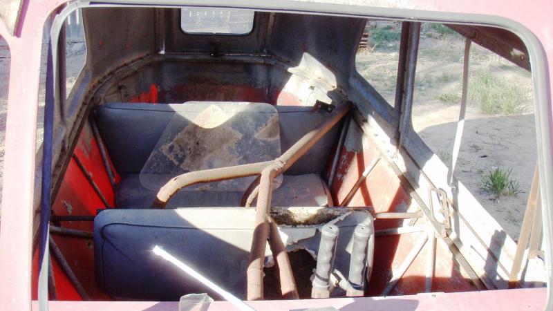

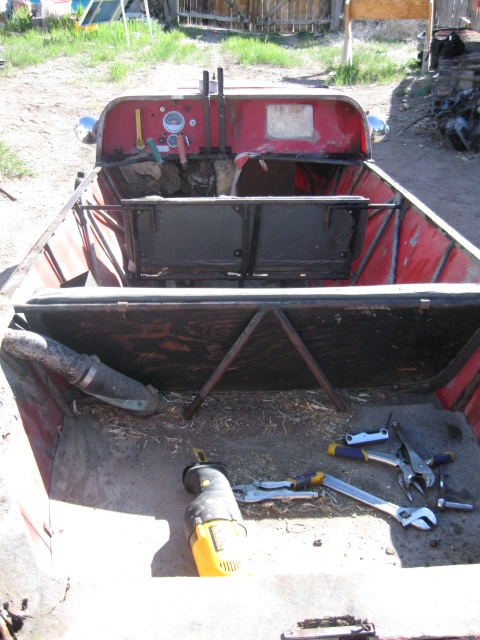

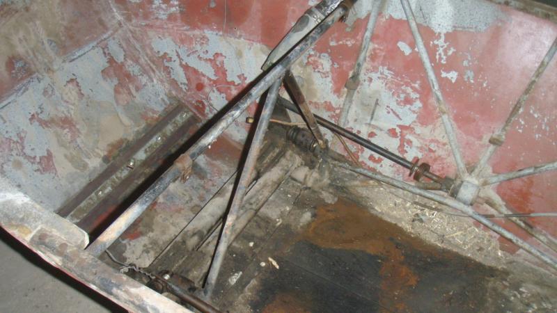

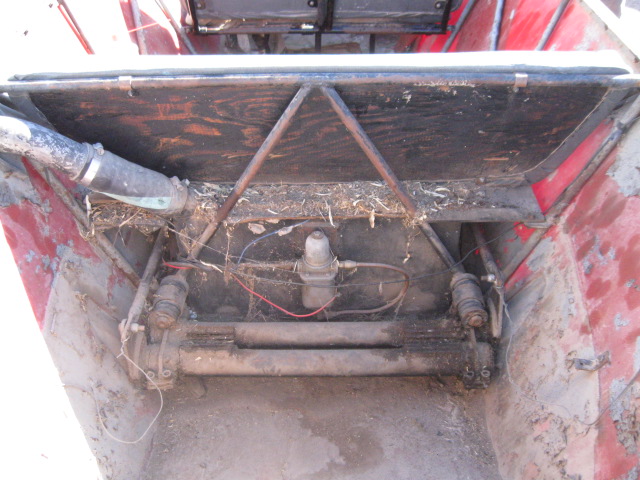

Here is a view with the rear cargo area wood deck removed. You can see a line of discoloration on the sides of the body where it used to be. It's priary purpose was to protect the twin axles from getting debris caught in their half-gears. I will probably box out those shafts to recover about half of that wasted space. Also seen is the back of the rear seat, the fuel pump, and the fuel tank under the rear seat.
All if the seats removed. The rear seat had about a half-dozen nuts and bolts holding to the frame. The front seat had about a half-dozen wood screws holding the seat legs to the floor and that was it. The back of the front seat had a bar on each side that would lock into the frame to hold the seat upright. The bars could be retracted and another leg would swing out to allow the seatback to lay flat. I don't know if this was a factory thing or a previous owners mod, but I'm gonna keep it. :thumb:
The dash had about a half-dozen nuts and bolts holding it to a piece of angle that's welded to the frame and runs along the bottom of the dash. There was another half-dozen allen-head bolts securing it to the sides of the body in the same manner as the upper body was attached. Half of these were on the inside of the cockpit and half were accessed from the engine compartment. There were four more sets of nuts and bolts holding the top of the dash to the trianglular framing in the top-center of the dash. Other than removing these nuts and bolts, all that was needed to remove the dash was to disconnect wiring from the engine and guide the harness through the frame members.

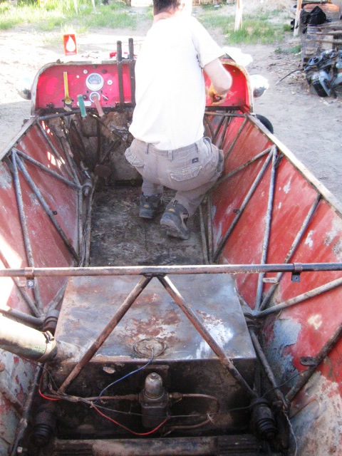

Nothing left up front except controls, tranny, and diff.

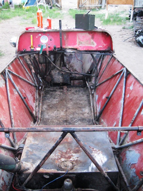

View looking from front to rear. Black fuel tank can be seen in the back.
Fuel tank gone. The tank was held to the floor with four wood screws, one on each corner. Before the tank could be lifted out, we removed the fuel line, the rubber hose coupling the tank inlet to the filler, the pump wires, and the fuel level sensor wires.

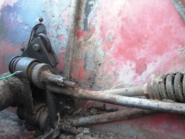

Now for some ugly bits...
The hydraulic reservoir is missing as well as the front hydraulic rams. The rams had been replaced with all-threads. :pat: The all-threads were not up to the task and bent under the weight of the machine. Ah, well, more stuff to tinker with! :thumb:

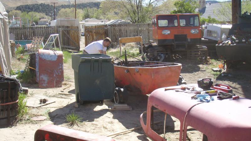

Next, for the hard stuff. Below is a picture of SnoOps trying to figure out how to get the tranny and diff out. This was documented once in BigAs newly created, and newly lost, KT-3 restore thread. Now we get to start from scratch. :confused: :pat:
