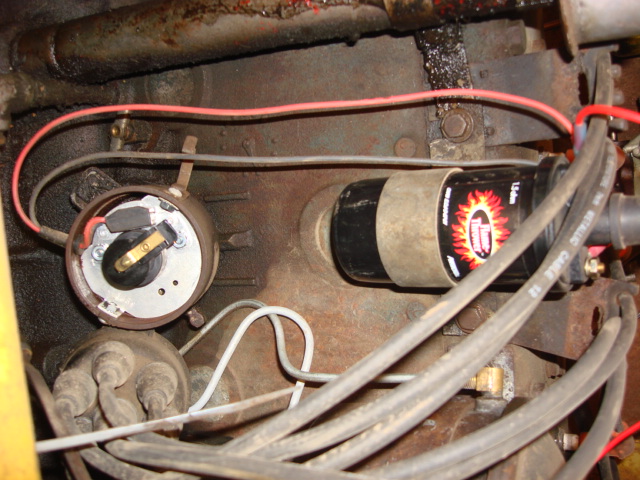

Here is a pic of the one J5 with the Pertronix #1564 ignitor pickup and coil, works real good and was very easy to install maybe 20 min's or so.

Same, they both use the 1564, on the Pertronix website there is distributor look up page, type in Autolite, IAY-4004-1 the module is 1564 I have one see the pic i put up exact same as yours it has over 200 hrs on it works great. you should also get the 40,000 volt FlameThrower coil from them, it is designed to work with this ignitor, see other pic. If you want to get real fancy, get the ignition relay package and wire it in for perfect setup. It works great with the relay so you do not have a voltage drop from headlights or other stuff turned on. It is not required, just thought I would mention it if you want the best performance from the ignitor.

Finally got around to installing the pertronix.
No spark though.....but looking at your pic....it seems your distributor is turned clockwise much further than mine.
In my pic it is turned clockwise as far as it will go....and ideas?
If you removed the distributor, you should try with the rotor pointing the other way, you may be out 180 degrees.
I did not have the distributor out....the previous owner may have...but it was running. Even so I cant turn the body to be anywhere close to look like his regardless of rotor position.
If you didn't take it out then the rotor position is correct. When the engine was timed, it may have been set up with the firing of #1 in the next position of the cap. You need to be sure you have the wires on the coil correctly and the at the cam is seated, and the gap set using the clear plastic gauge provided in the kit.
? is there any spark from any of the plugs, with the plugs out resting (grounded).?
I only have one plug out..
So your saying mine may be timed starting with a different starting cylinder...seems odd....
I guess what im saying ....could the degree tab be attacked in a different location on my distributor? This also seems odd.
No not starting with a different cylinder, with a different distributor cap position. #1 cylinder is always #1, not the same for the distributor. Anyway you didn't remove the distributor so that is not the problem.
I you didn't loosen the degree tab that should not be the problem. My engines run at any setting on the degree tab, adjusted only to get best performance depending on engine wear, altitude, engine knock etc.
If there is no spark at the plug, it must be electrical.
Does the cap snap in and on correctly?
Yes...cap can only go one way...and does pop into place nicely.
Have you jut one machine? Just curious if they are all similar to your pic...or have you seen any that look like mine?
I could be getting spark on another cylinder....but this must be 40degrees advanced compared to yours.
I have 3 J5's, two have #1 on the distributor as per the picture and the other #1 is in a different position. Again, if you didn't remove the distributor, position is not the problem.
Did you remove the "ignition resistor", it is usually mounted behind the seat back on the inside of the engine compartment. This needs to be removed as it lowers the voltage to the coil. New system has this looked after.
Check for 12 Volts at the ignition coil with the key in the run position.
