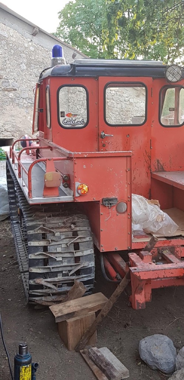

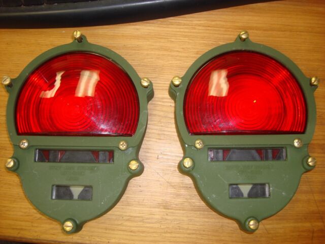

Sorry, I don’t have what you think. I have no rear reflectors (image below - no reflectors, no tail light - yet), but I do have some cool nato taillights left over from a previous project that I hope to utilize. While the snow trac is not a tank, let’s let outsiders out there think it is!
okay, I hear the purists crying, and I greatly respect that, but this snow trac is on the road to being it’s best self as a functioning dependable SAR vehicle. Having it in the best possible, fully capable shape possible is my priority. Adding a few little unique character compromises that I hope draws attention to this community is a bonus. Even the most famous tracs that were used in the Antarctic Expedition were customized.

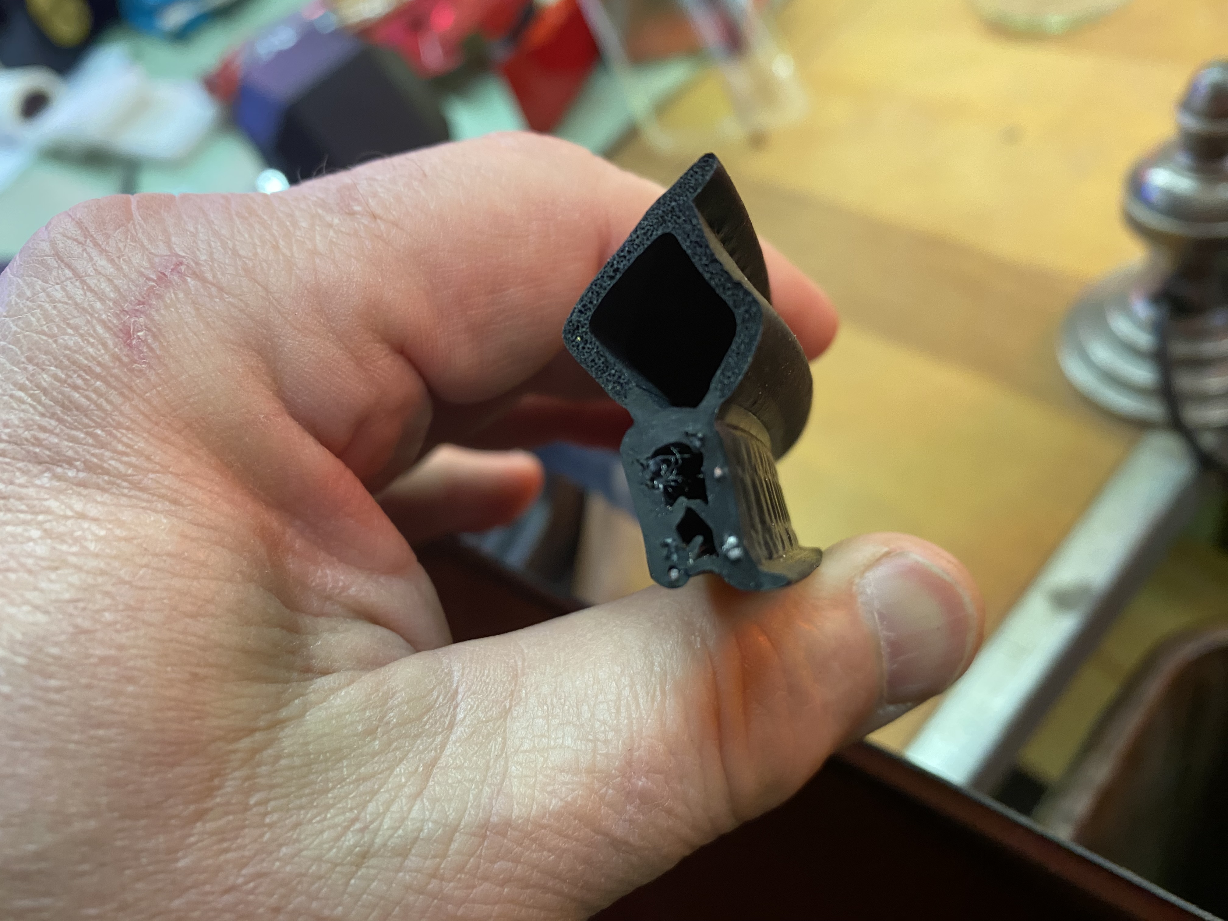

You may consider new seal material on the air horn to assure that the air coming off the fan is exiting the engine compartment. Changing the air horn seal on my Snowmaster made a very noticeable difference in operating temps.

1. New air intake seal (2 photos),made by Seal Rubber, called “Trim Seal Vertical Bulb” 20feet for $29 on amazon.
2. Heritage badge and tail light

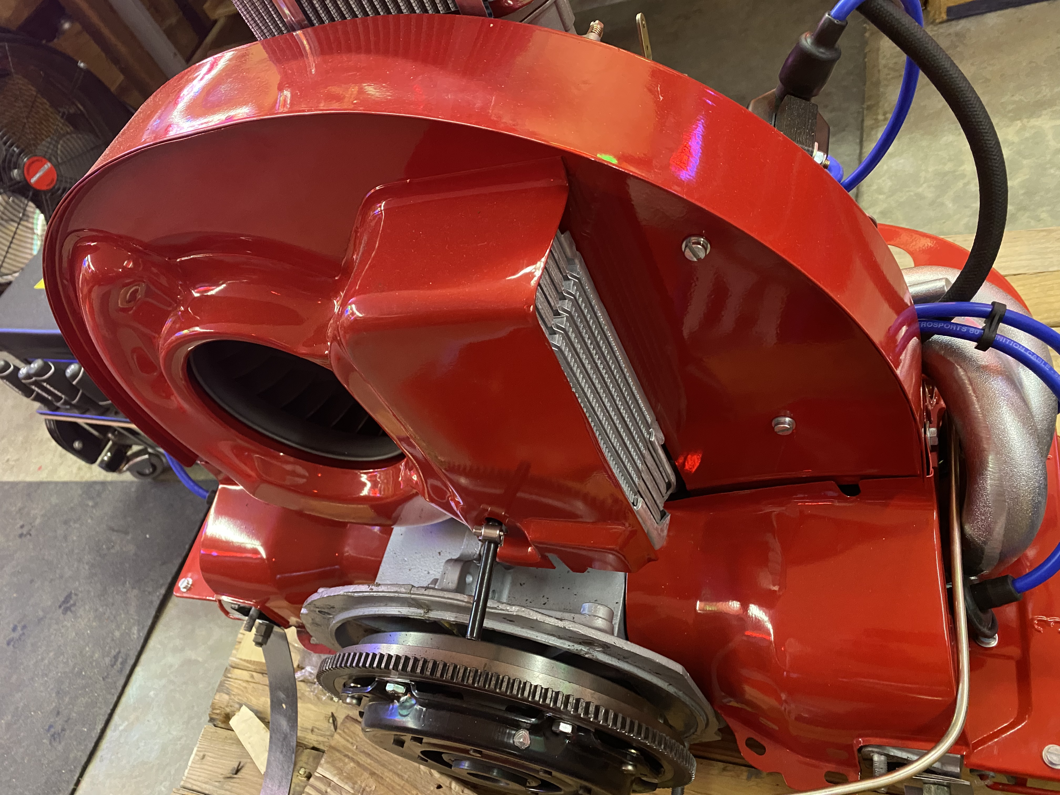

4. Old engine, new engine back side. New has a doghouse oil cooler so the original air intake won’t fit. Making a new one and wondering is anybody has dealt with this.

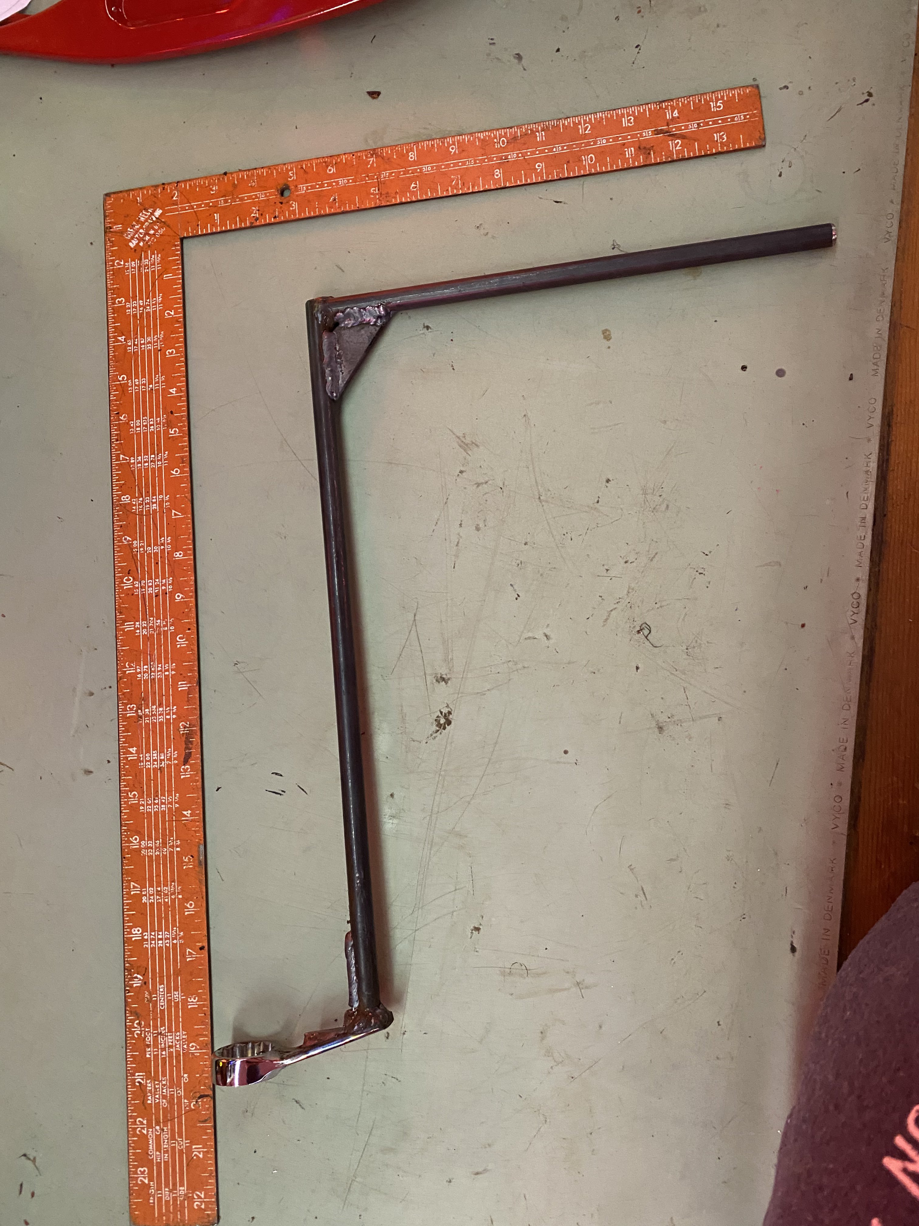

5. Made a variator wrench as designed by “Lyndon”. Worked great. Trying to adjust the lower nut without it was impossible. If you haven’t found Lyndon’s forum posts, start searching. Definitely the holy grail of SnowTrac info.
