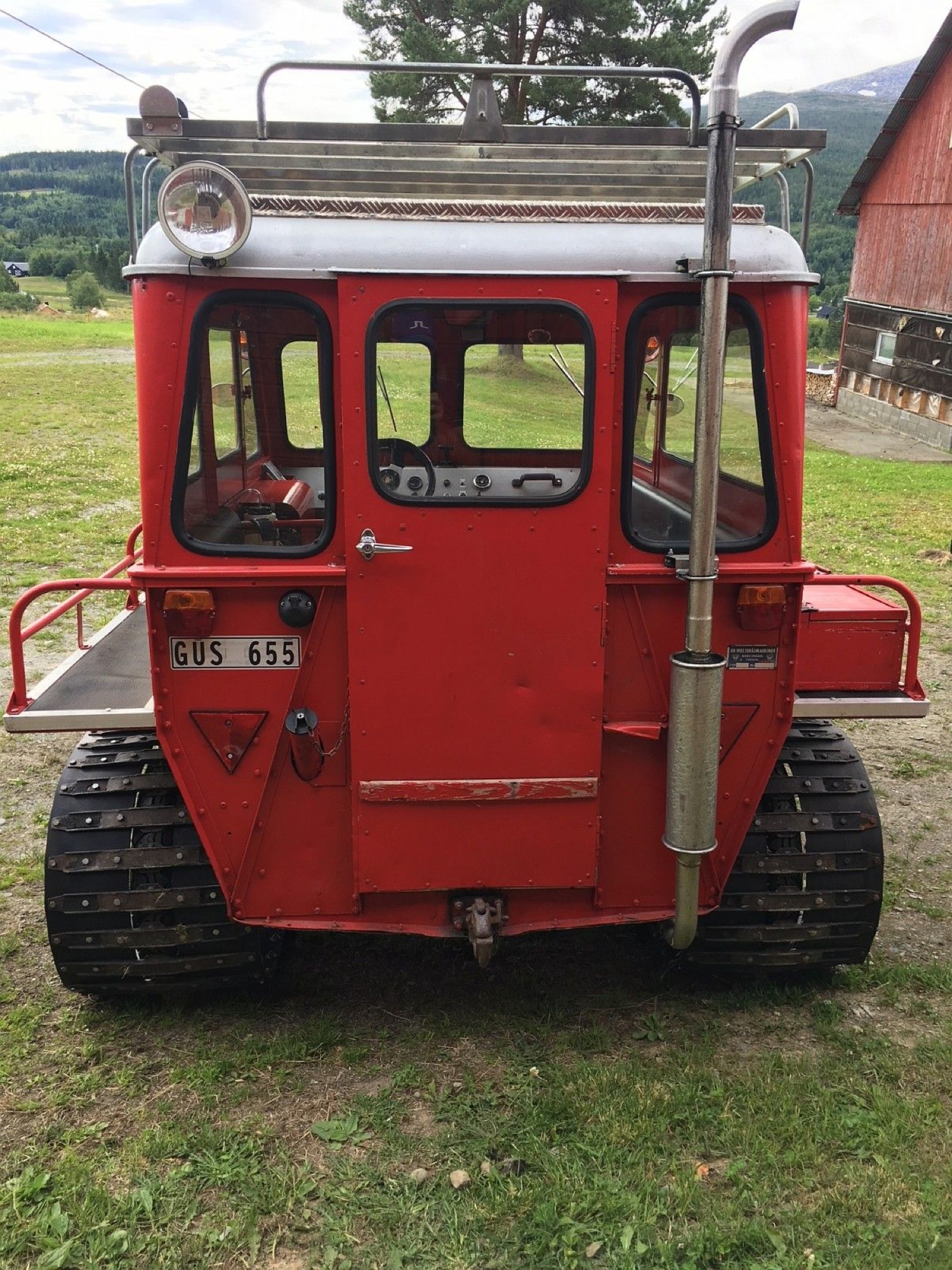

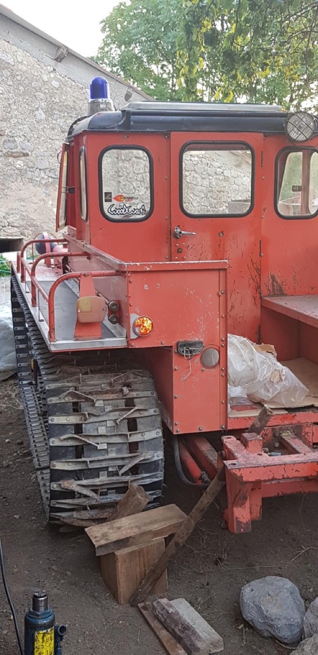

I just inherited a retired snow trac from Search and Rescue

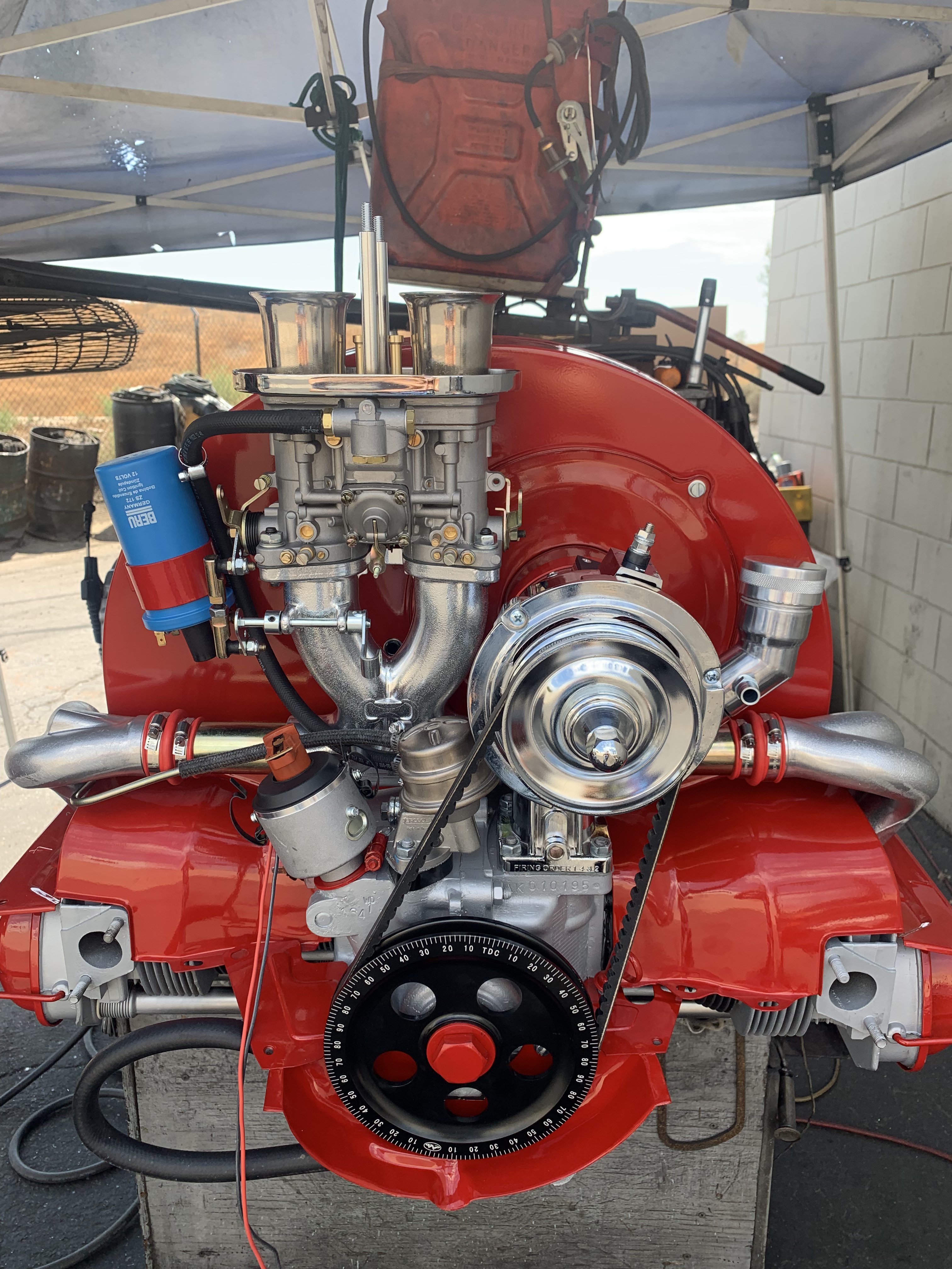

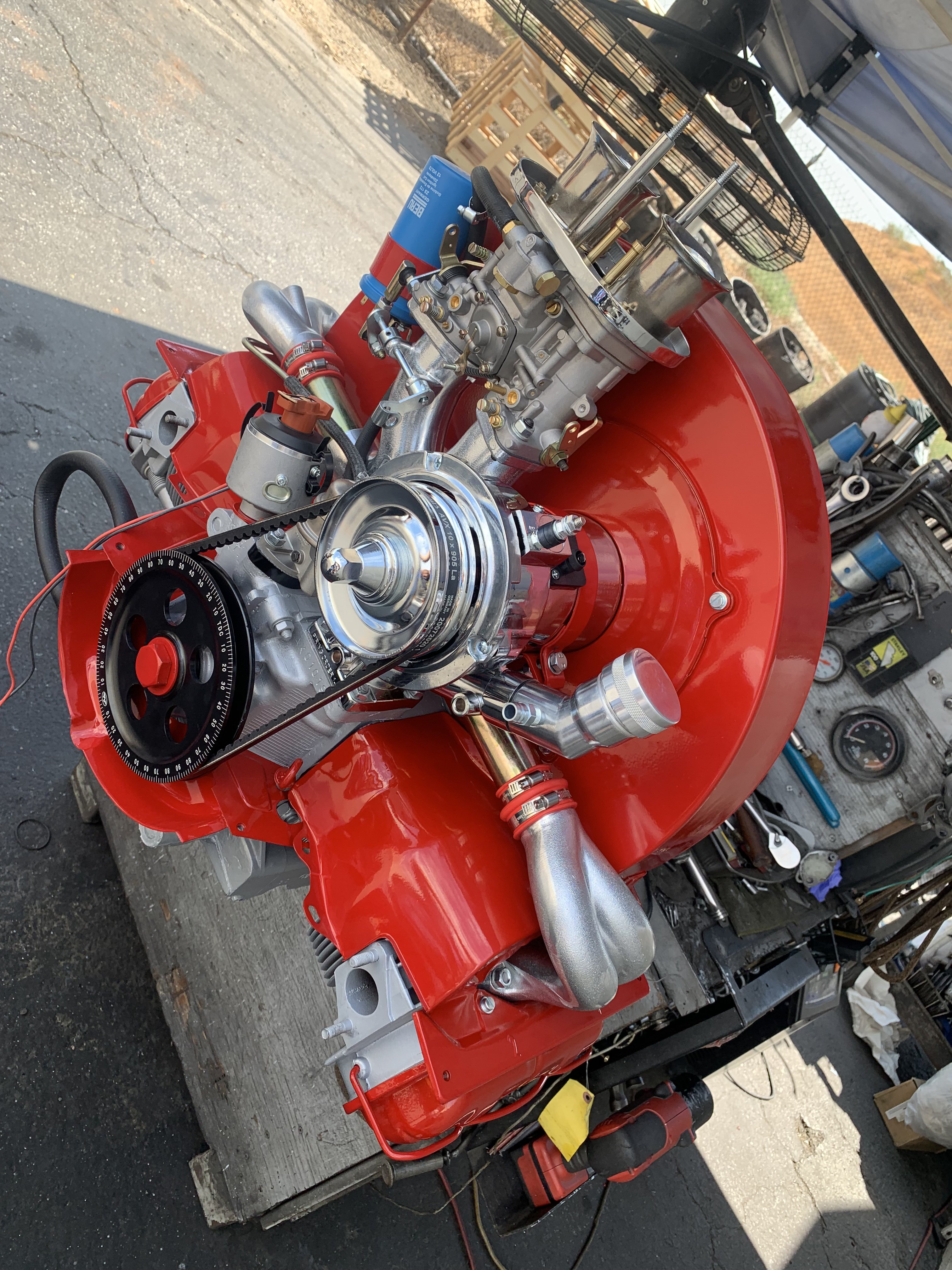

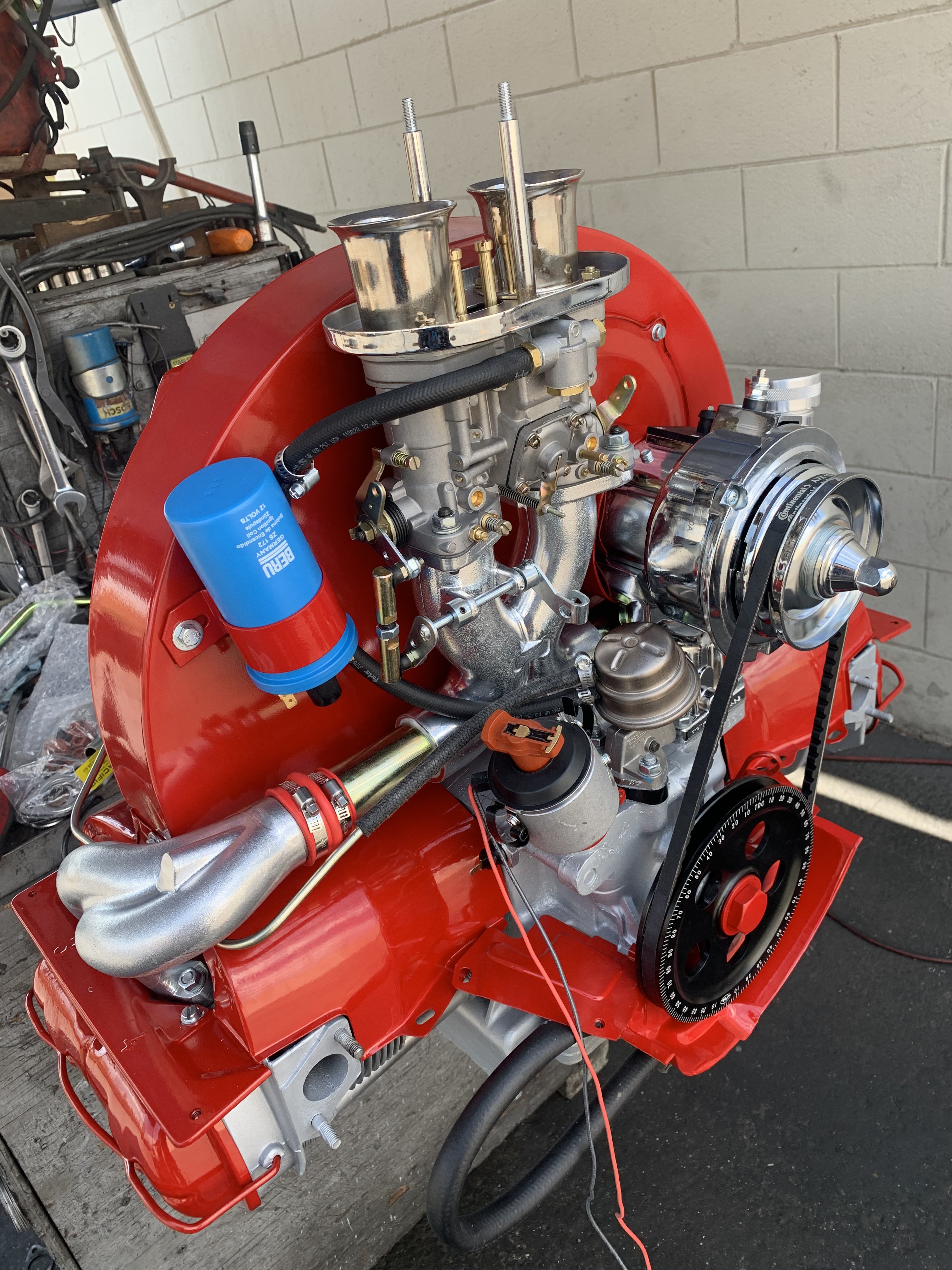

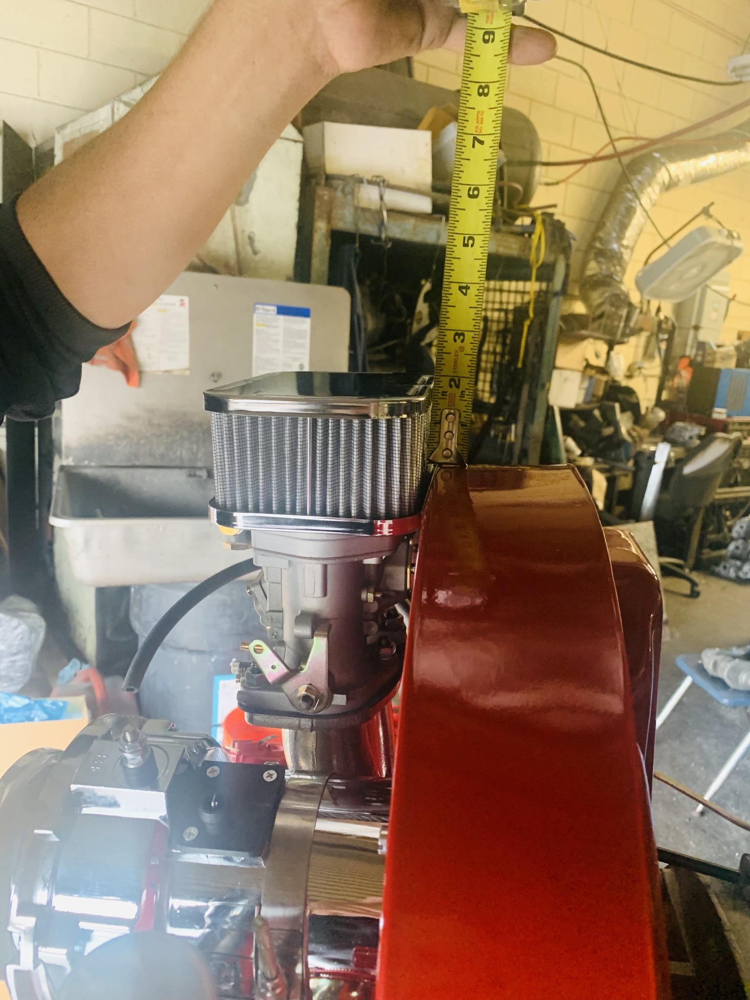

Update… bought new engine: vw type 1 1835cc dual port single carb, low/mild cam, 92mm bore, 90hp (image attached).

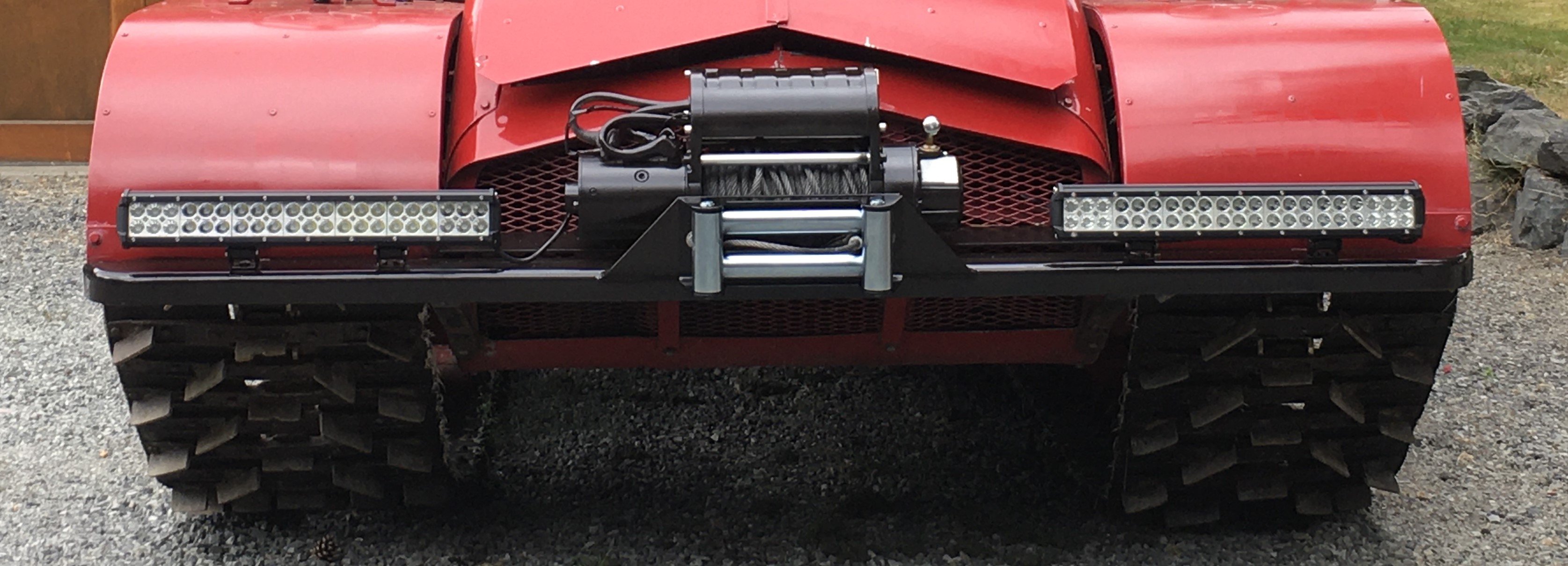

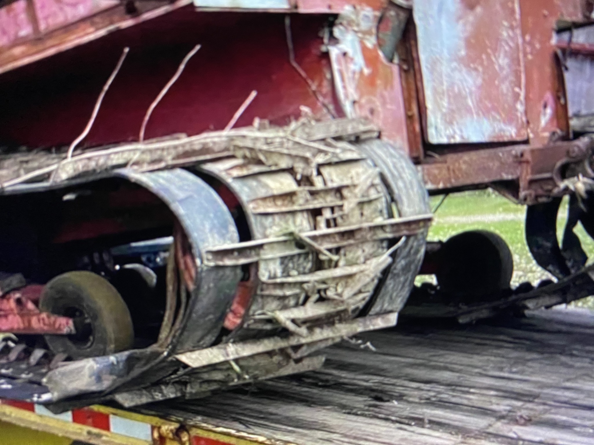

New tracks to be delivered in 10 days. While doing critical measurements found large gash in rear tire and it has a different tire on each side. Knowing the tracks will be off soon this is my chance to easily replace questionable tires. I have ordered two with high pressure tubes and am trying to find a local source for poly fill. If nothing local I can ship them to fallline.com for filling.

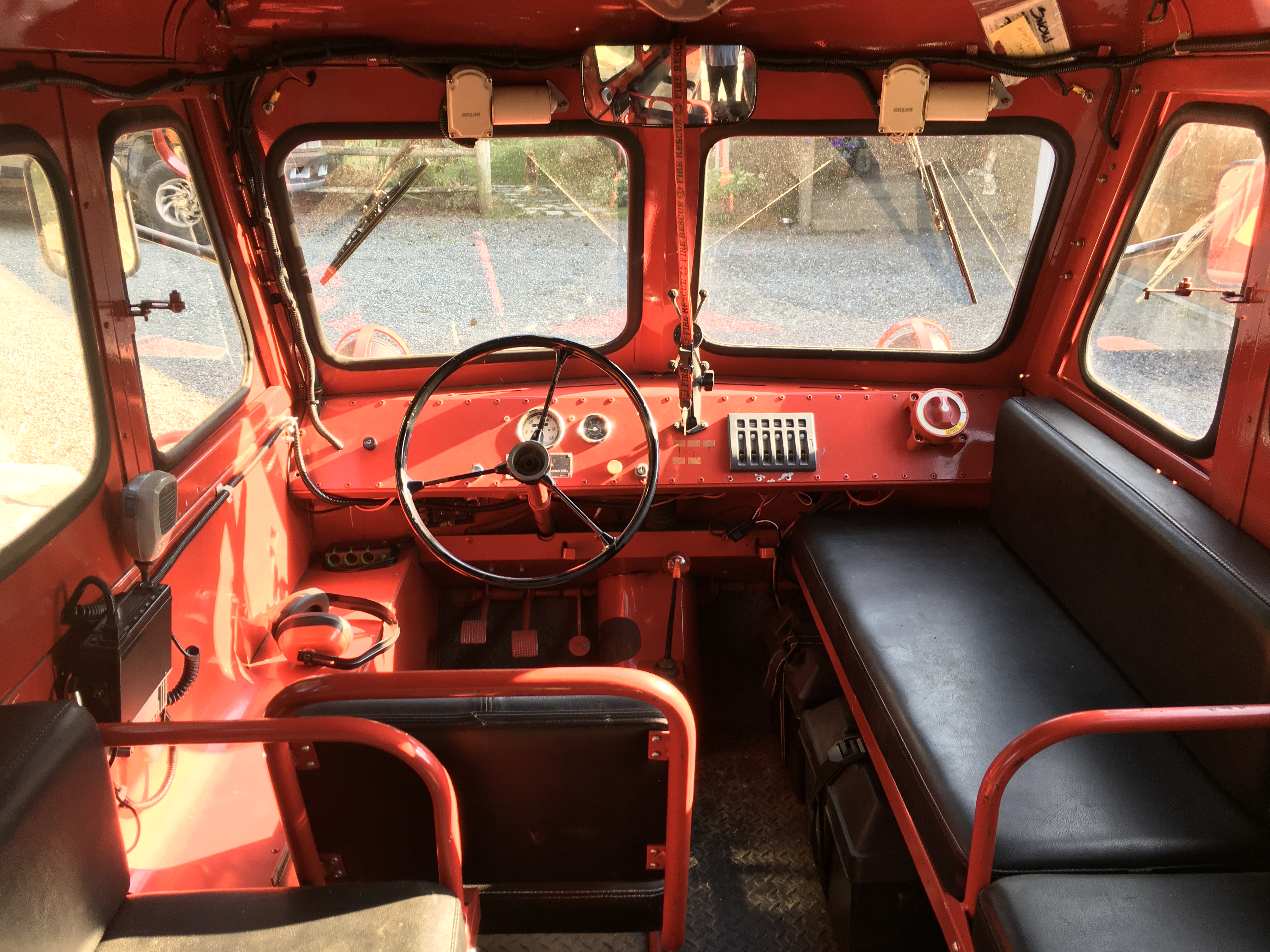

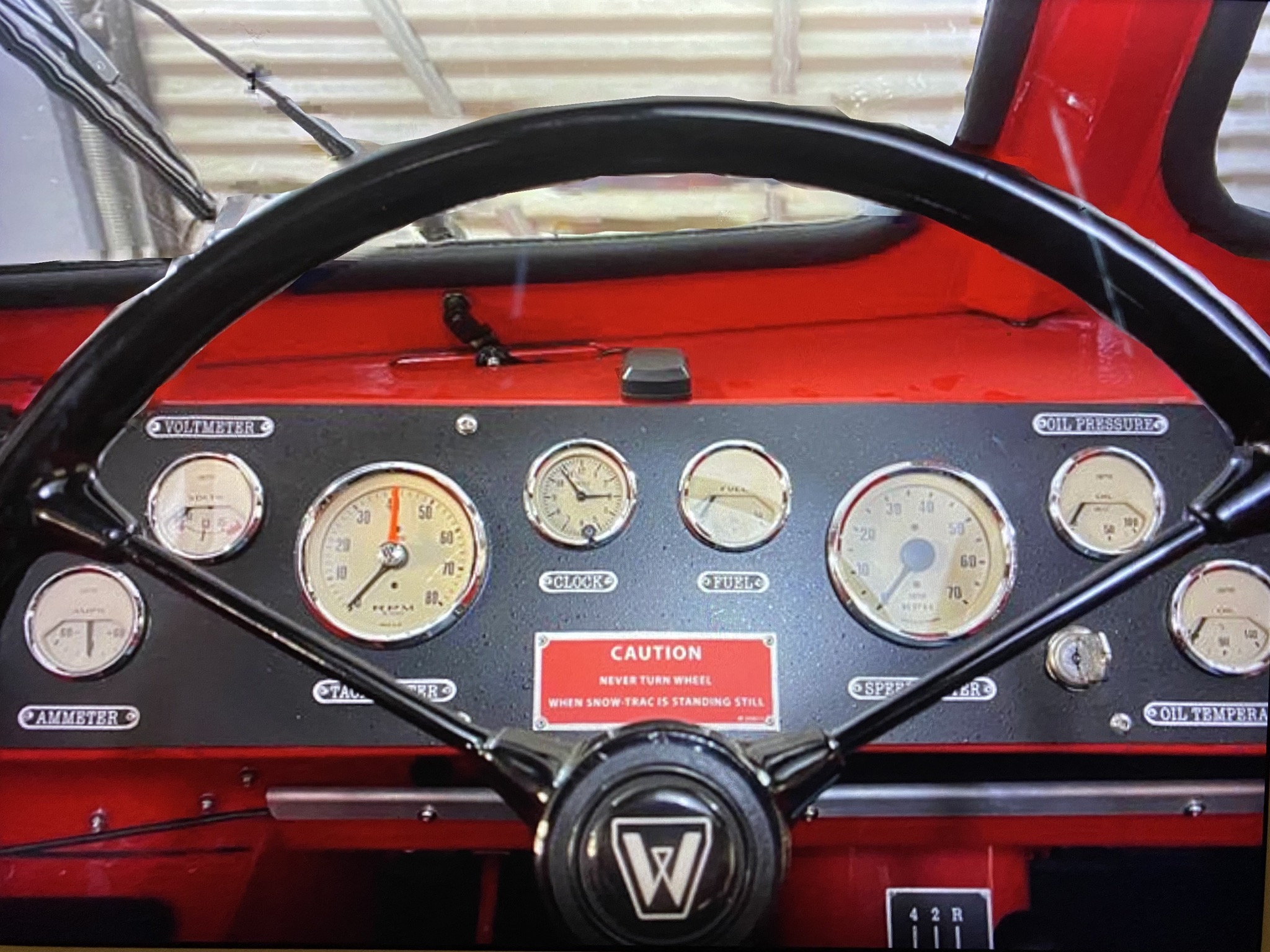

regarding photo requests: in addition to what I posted I just took an interior shot as of today (a lot has been done).
Additionally, I’m showing the dream dash I found online and am hunting for gauges accordingly.

It looks like you are doing really well!
That engine should prove to be a real powerhouse!
I hope the builder used a "counterweighted crankshaft" and the thick wall version of the 92mm piston and cylinder set. (That version fits in the crankcase bore normally used for the 94mm cylinders.)
If so, you have an excellent foundation!
My only real concern is the carburetor and intake manifold in the photos. The carburetor itself is more than fine, but the intake and air cleaner are going to be it's downfall. The carburetor sits too high to allow an appropriate air cleaner (with warm air inlet provision) and still provide Snow Trac hood clearance.
But the biggest issue will be the intake manifold. That model has no provision for exhaust to heat the cross tube portion of it. An exhaust-heated intake is ESSENTIAL to good cold weather operation of a VW!
There is a vendor for Weber products called Redline. They offer the proper heated intake manifold for the VW. Their intake accepts the Progressive Weber carburetor. The Weber Progressive cannot equal the power potential of the carburetor in your photos, but it doesn't sit as high (remember, hood clearance), but the "good" heated intake and warm air inlet air cleaner will let it RUN CIRCLES AROUND the intake/carb in your photos!
Visit aircooled.net or the "sticky" under Performance and Racing in the Forums at thesamba.com that deals with "Making the Weber Progressive Work on a VW."
There is a contributor on there (John, from air-cooled.net) that explains exactly how to make the Progressive Weber work properly on a VW. Solid gold information, there.
The proper, heated intake and a header/muffler with the appropriate heat crossover plumbing (and the warm air inlet for the carburetor) and you will have a FINE running Snow Trac!

The very learned Cidertom makes good points.
I too have experienced fuel boiling in the carburetor bowl. My further testing showed that to be due to the "low vapor point" of the lousy crap they call "gasoline" these days. The modern, fuel injected engines can deal with that just fine. The older, carbureted engines struggle with that a great deal.
The problem for the opposed VW engine is the cross tube portion of the intake manifold. If the manifold is not thoroughly heated the fuel condenses onto the insides of the intake, before the fuel gets to the combustion chamber. This makes the fuel/air mixture too lean. To compensate, the driver has to engage the choke and/or jet the carburetor much richer than is ideal. There goes your fuel economy. And worse, sooner or later that condensed fuel will dribble it's way into the combustion chamber and now the engine sputters and gags on all the raw fuel! Worse economy! No power! Rough running! (If it keeps running at all...)
Heat that intake! Provide hot air to the air cleaner snorkel! Use high octane, Non Alcohol Blend Fuel!!
Your air cooled VW will thank you for it!
Excellent input. The engine photo is from the shop that’s building mine. Mine has a estimated delivery before thanksgiving. I will have the builder make modifications regarding the intake and was already researching hood bulge per ‘Luvthemvws’ thoughts.
the crankshaft is spec’s as counterweight.
the only fuel I run in all my vehicles is ethanol free.

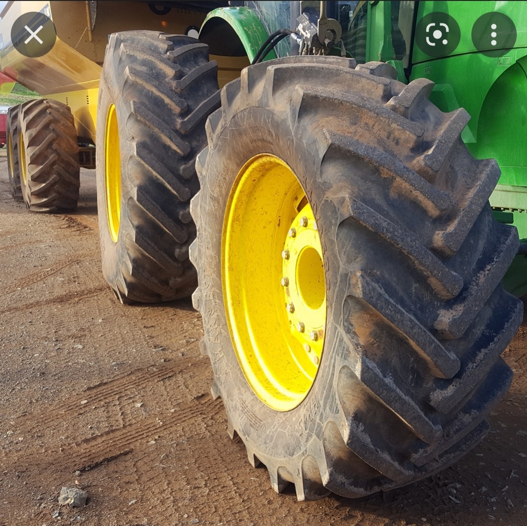

As we talking about the rubber tracks, i think when its necessary to replace the belts, you have also to change the derection of the custom grousers, because in the fotos,
the V Shape, the pattern of them it is not in the right direction. Its opposite.
Nikos
The V Shape, the Pattern of the grousers in the rear tyre in the ST4 and in the Tractor with the rubber belts.
The defence.

If you have track spin, the snow under the track is being forced INTO the center of the wedge catching it and filling it. Flipping the other direction, the snow would be pushed from the center to the outsides of the track if spun or in a tight turn.
??????????????????????????? So these are backwards?
Exactly.
Ed you can see the difference of the V Shape on the front Tractor Tyres.
When you decide to broke the track, just to replace the two rubber bands, then its easy to fix them from the beginning. Ok

I think Davenet is on the right track. If the tracks are turned around the Snow Trac will tend to dig itself into a hole. The way they are now, scooping the snow towards the center of the track, will tend to keep the Snow Trac on top.

Dear “RedSquirrel”,
I wish to acquire the 15 tooth sprockets you have.
send me an invoice: wardpilot@yahoo.com
To Everyone following this, here’s a status update - focus has been on accumulating everything upfront before jumping in with both feet to begin this rebuild marathon.

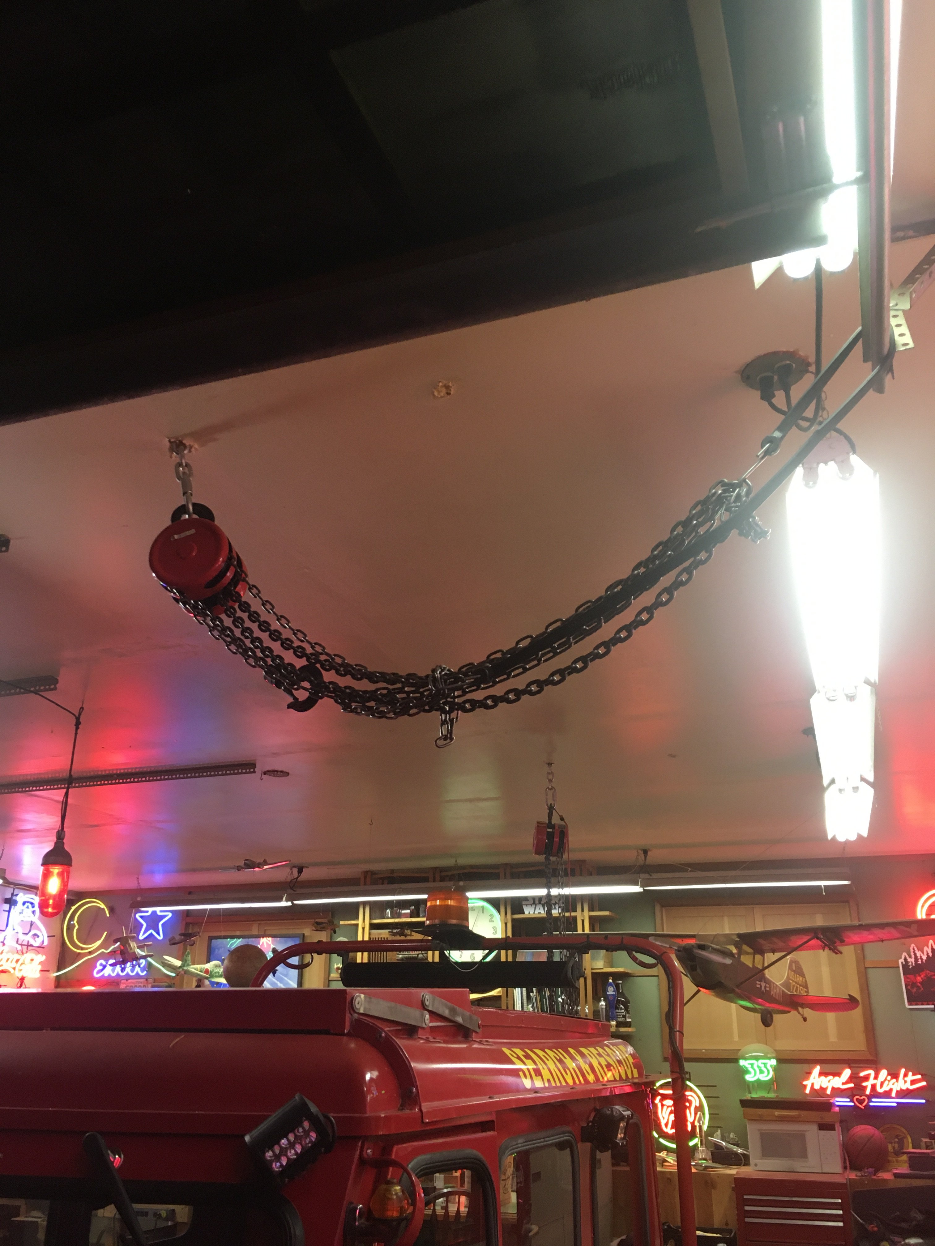

Prepping my shop was first with lots of rearranging and have installed ceiling hoist (images below), gotten jacks & roller Dollie’s…
1. Engine arrives this week. Image below is mine. Based on specs, it’s a perfect, albeit tight fit.

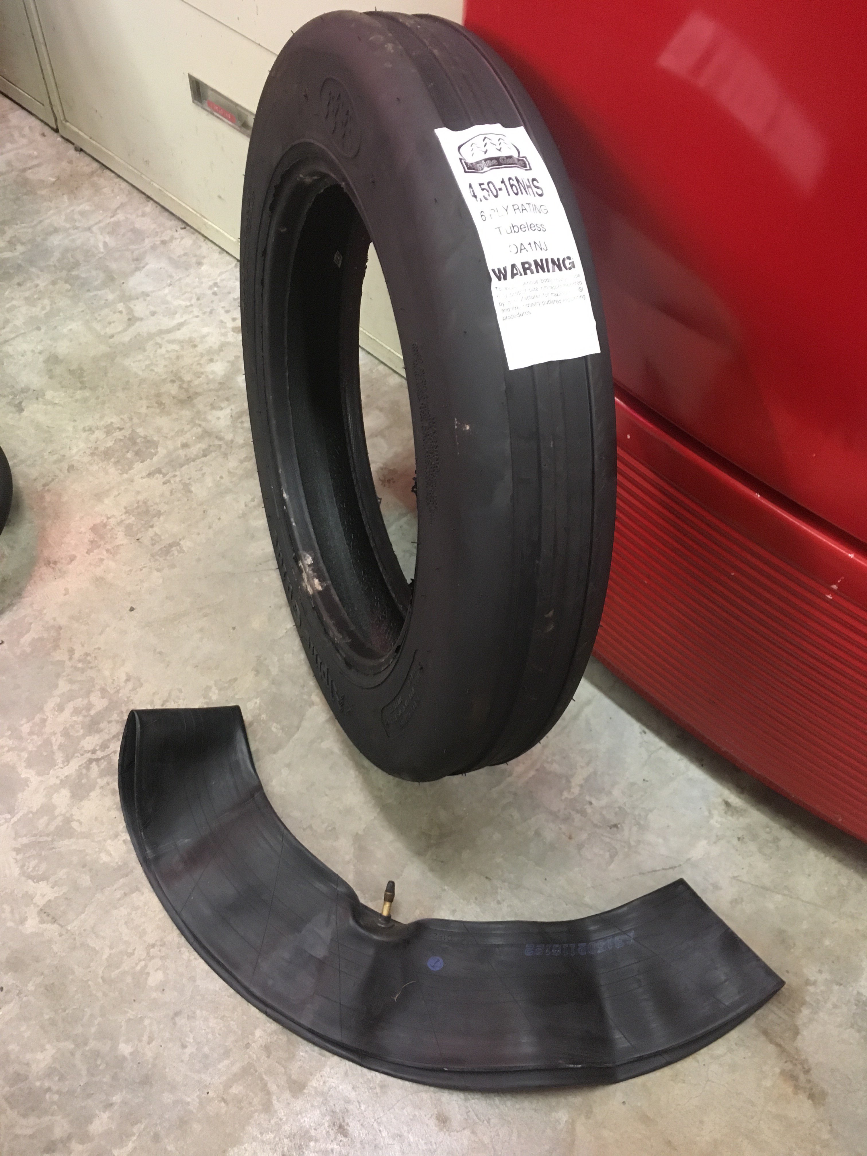

2. tires and tubes are in
3. new steering wheel (original made getting in a bit too tight). For you purists: I can go original when I lose some weight.
4. track belts have arrived
5. variator belt has arrived
6. Hood lovers are in for windshield defrost and engine heat outlet (they not exactly what I hoped for and will likely make a replacement mysel).
7. Plan on keeping the herringbone grousers “backwards” based on the detracting history and images relating to snow trac that my research uncovered. See below.
8. current mindset is to wait indefinitely on having tires poly filled. Something I can always do later.
