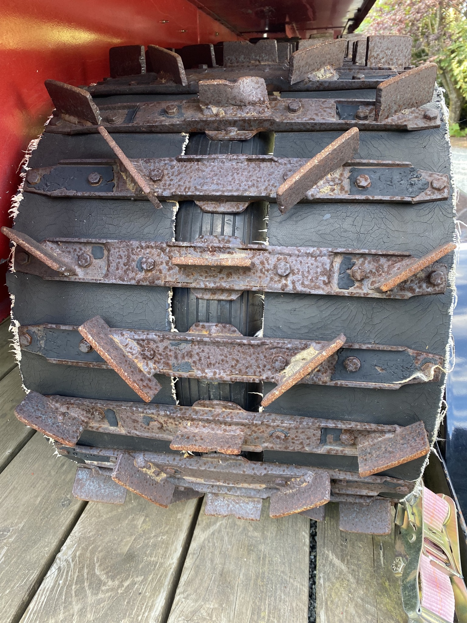

The track need to be replaced. (New tracks are ordered)
Hi Ed. Your Snow Trac is an earlier model "small wheel" unit, the photo makes it look like it is in nice condition, nicer than your description. Sounds like the Variator needs some work if you can only turn left. Engine should be an industrial VW engine, pretty much the same thing they put in the VW Beetle/Bus street vehicles and if your engine is trash you can do an engine swap, even trick it out for more performance.. Tracks are tedious to rebuild but not all that hard, just a lot of repetitive steps drilling and attaching the grousers.
I sold my Snow Trac a few years back but I'm sure there are several current owners here who can help you with current parts sources.

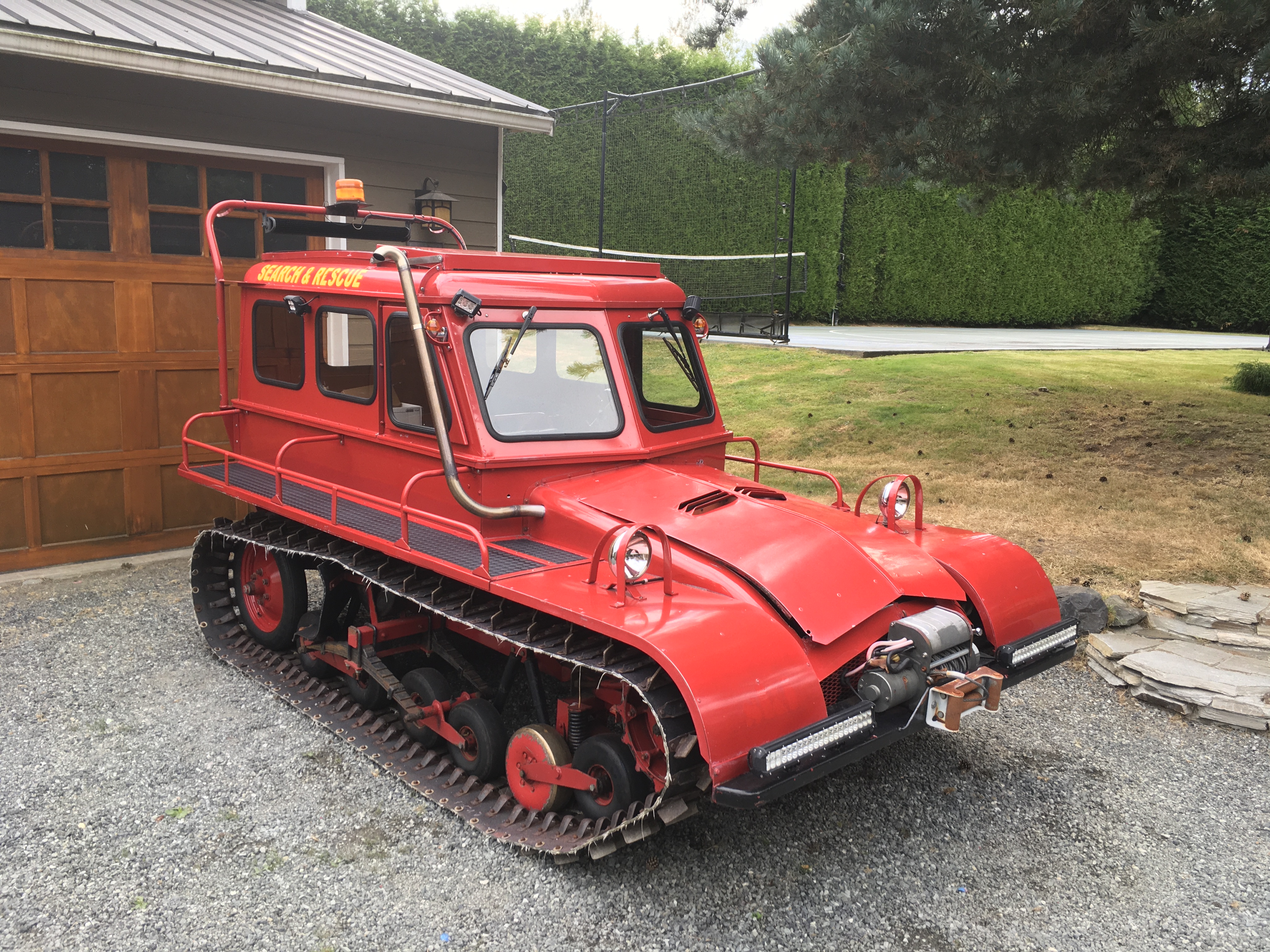

the previous photo I took last night in the dark. Yesterday I de-oxidized and detailed the exterior to try and preserve the paint job it got 6 years ago.
here‘s a couple of daytime shots I took this morning.

Looks a heck of a lot better than what I had when I started with mine and I've seen others bring them back from total junk piles so you have a great start on a machine that is not at all hopeless.
The VARIATOR controls your steering and that is likely the biggest hurdle you will find for parts. It was custom designed specifically for these things and, if it truly is broken, you may need to find a machinist and have him make you an internal part or two, to get it so you can actually turn both directions.
Welcome to our forums. I agree it does look better than I expected from your description.
