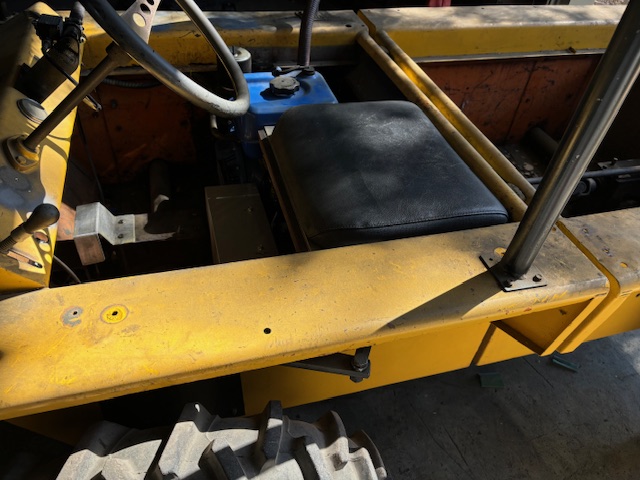

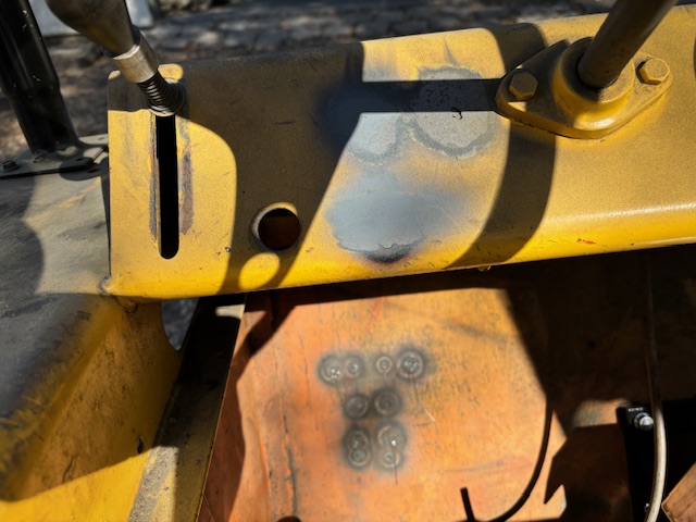

Sometimes its better to ponder things for a while, I took the seat back off and mounted it to a piece of aluminum plate.
Now it drops in and is easily removed for access to the transmission, I got 4" more leg room and can actually stretch my legs and makes it much easier to get in and out, just sit on the fender and pivot in or slide in from the back, the grab handle I never use needs to go making it even better to get in and out. The key switch and seat make it much more user friendly.

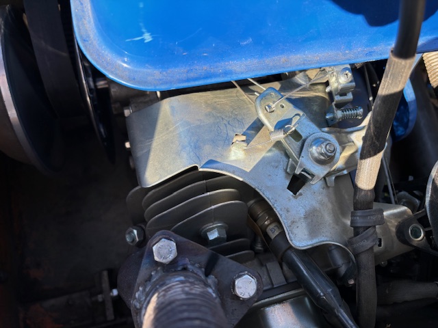

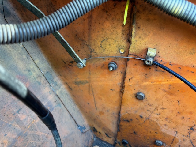

While I was on the work cabin trip the throttle cables showed up, so today I hooked up the OE hand/foot throttle.
Was very easy, the foot and hand throttle are on the bottom picture. The unit gets more user friendly with every modification. When the bike brake shows up, I can add that to stop the transmission from turning while changing gears then its just use it for a while before paint and a new roll bar.

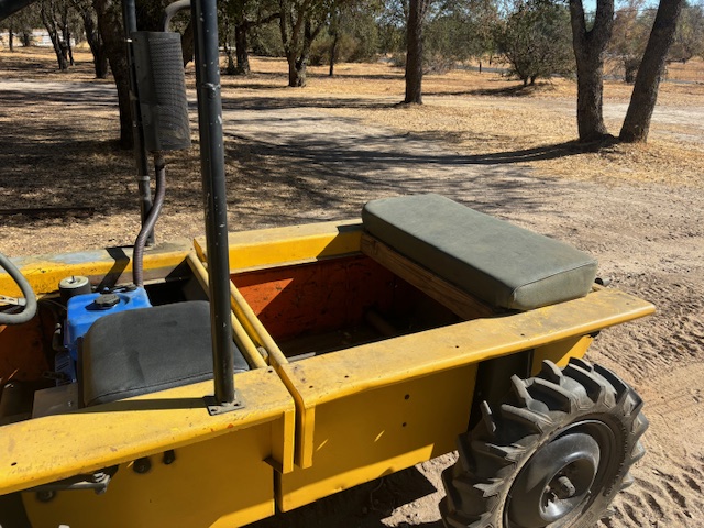

It took some effort, but while in the shop working on the raidtrac parts, I had an idea of about where it was and after moving a few things I found the rear seat. Now I can scare the hell out of whoever is brave enough to get in with me. I have been playing with it and its a completely different rig than when it had the hydrostatic drive ( slow and weak, even with a 20 hp Kohler ) now when you hit the gas it goes over whatever gets in the way, I haven't found a need to put it in first gear yet around the property, I imagine when it goes to the mountain, first gear will get used.

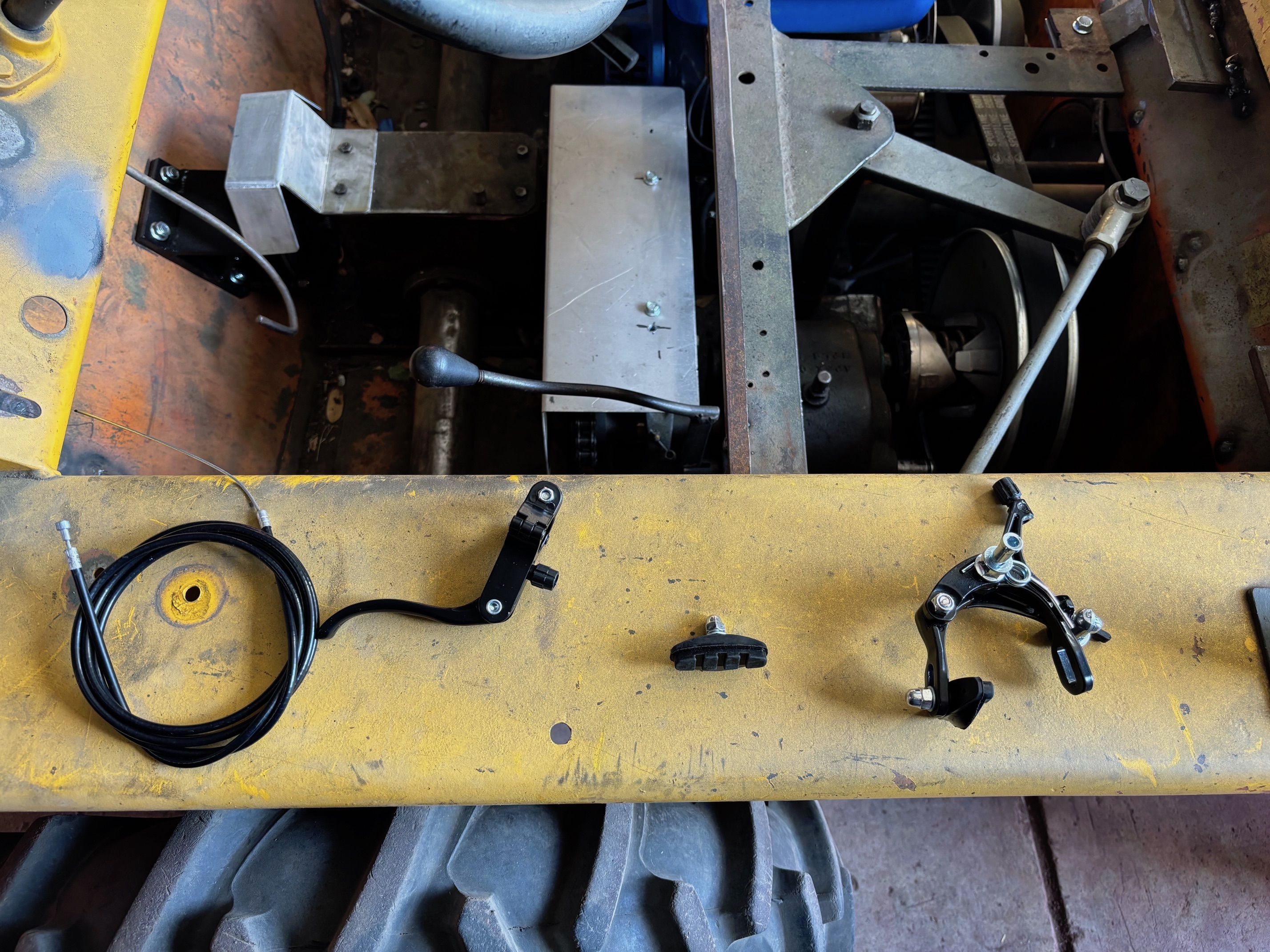

Today the bike brake assembly showed up, I will have to fabricate an articulating arm using the brake pad from the assembly, I had hoped to just mount the whole brake assembly on the large pulley but it doesn't open enough for the pulley when its in its open position at full throttle and to close to the firewall to grab the rim on the fixed side of the pulley.
The brake lever will be mounted to the shift lever so you can just squeeze and shift. Should work good.
And it actually works, I have done about everything I need to do for it to do its thing without hurting itself. Next year or so, I plan to disassemble it, do a camo paint job with a new rectangular tube roll bar, also add LED lights and a winch with a receiver on both front and rear, also thinking about adding a 1 wire alternator and an automotive size battery for all the accessories. For now its done and will go to the mountain in the spring.
