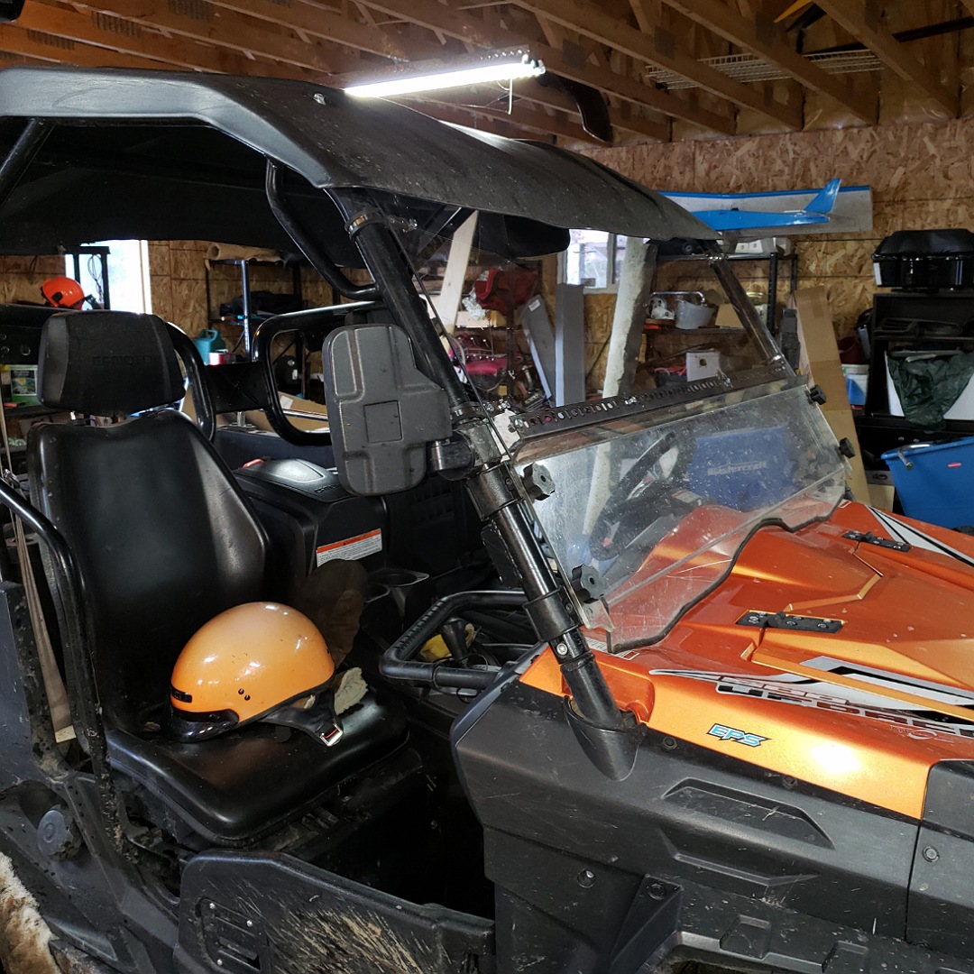

No birds yesterday so I believe this hunting season is done. I'll be working on the moto again today installing a piece of thicker lexan to fill the gap between the half windshield and the roof. I wanted to keep the half windshield for summer but also have the benefit of a full one in the fall as the wind gets cold on the face. They do sell a folding windshield for it but two things...1. They're all on backorder. 2. I'm too cheap to spend $650 on a windshield. That's what they want for them up here. So for $76, I had a glass company cut a piece of lexan the same width that I need and ordered a set of 2" rubber backed strap clamps for $15 on Amazon to attach it to the rollcage.

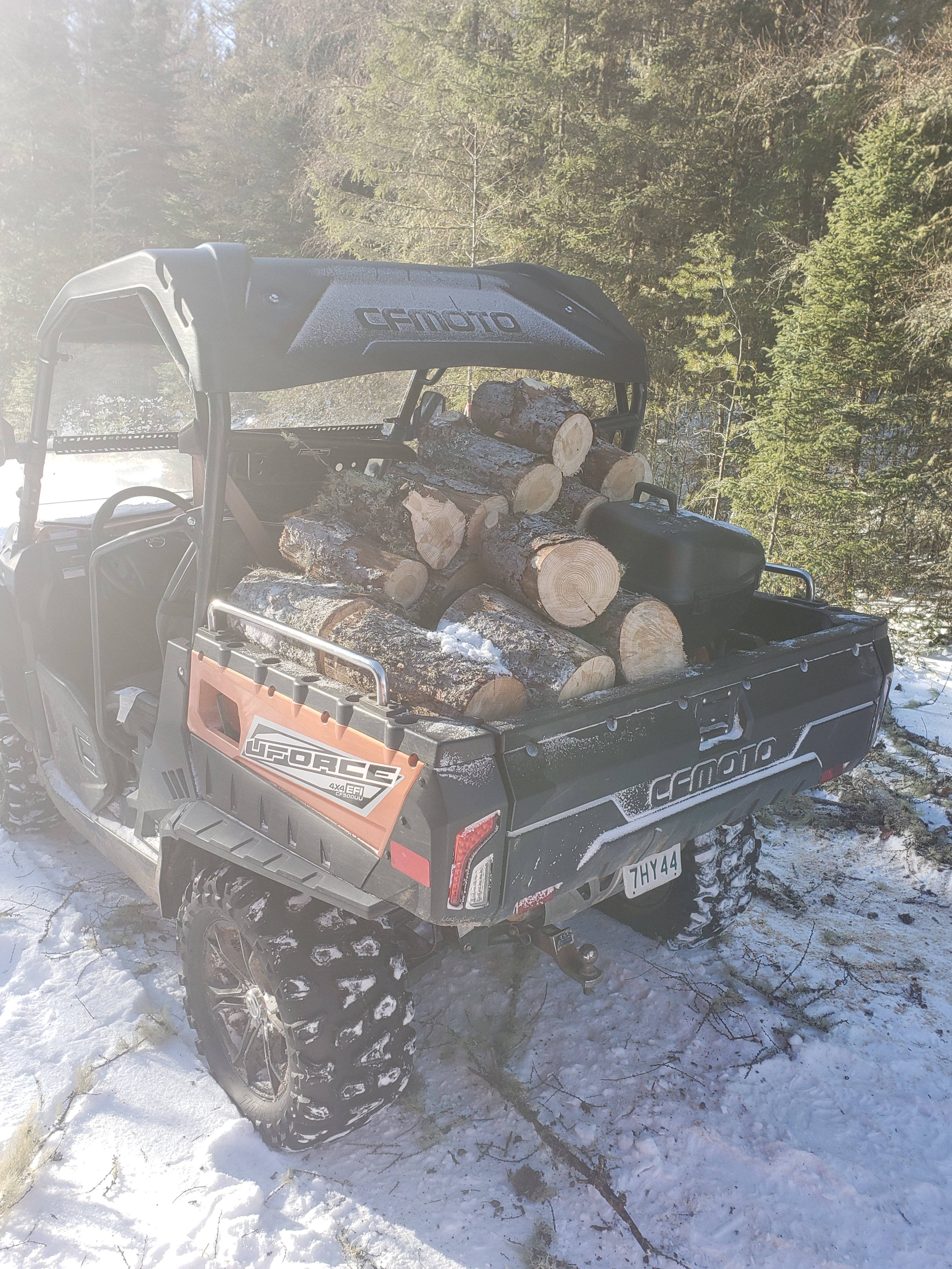

I just finished installing a homemade windshield to cover the opening from the factory half windshield to the roof. Of course I wanted to try it out so this morning I loaded up and ventured out for 3 hours to hopefully see some birds. The season closes on the 15th. No birds but I did fill the box with firewood.

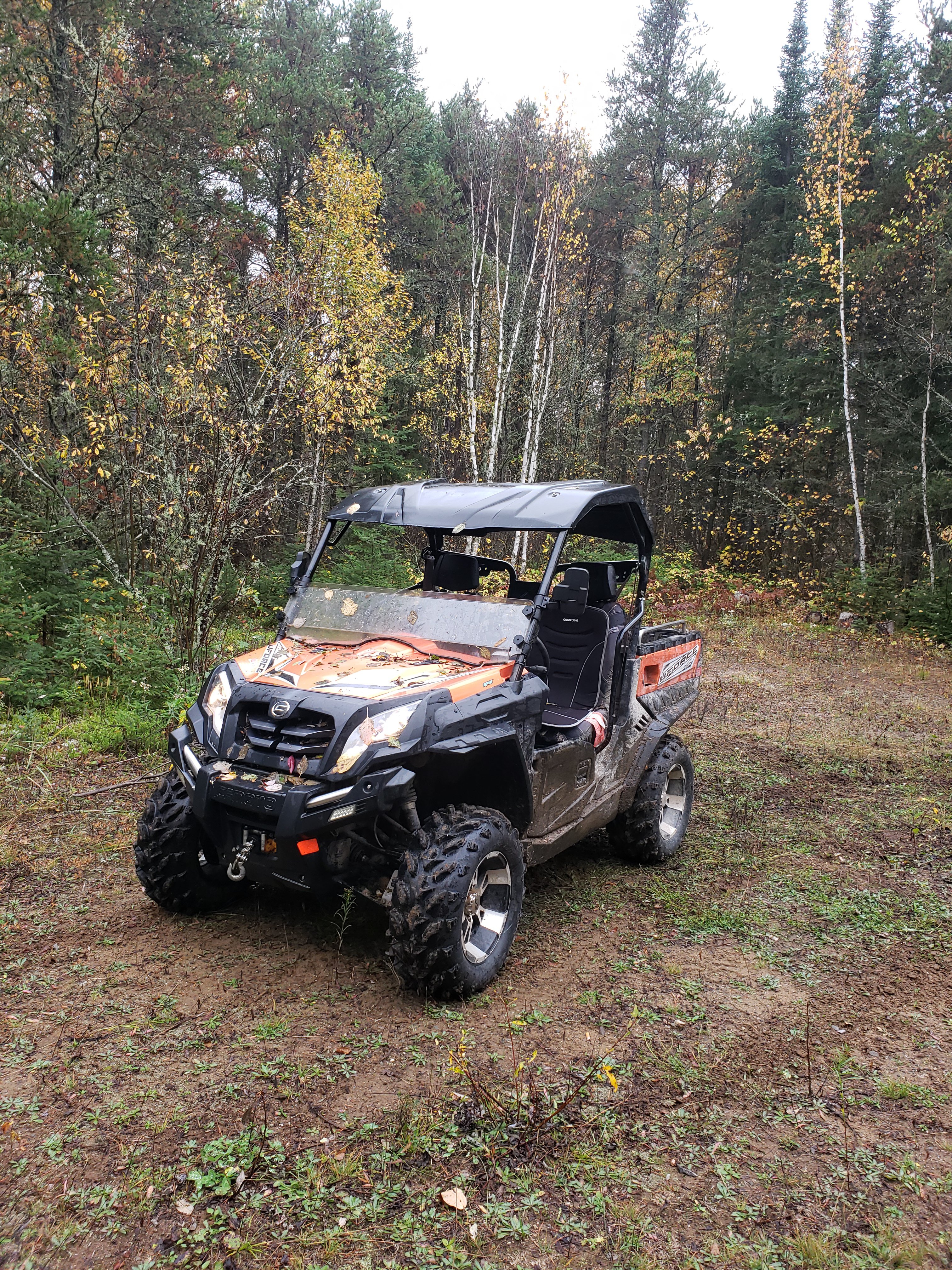

The lift kit is working out perfectly. The windshield as well. I didn't exactly want to pay what they wanted for a full one so I took some measurements and went to a glass shop where they cut a piece of lexan then I used 2" strap clamps to hold it in place. To stop the two pieces of windshield from rattling together, I used foam weatherstripping. I can easily remove it with 4 bolts for the summer.

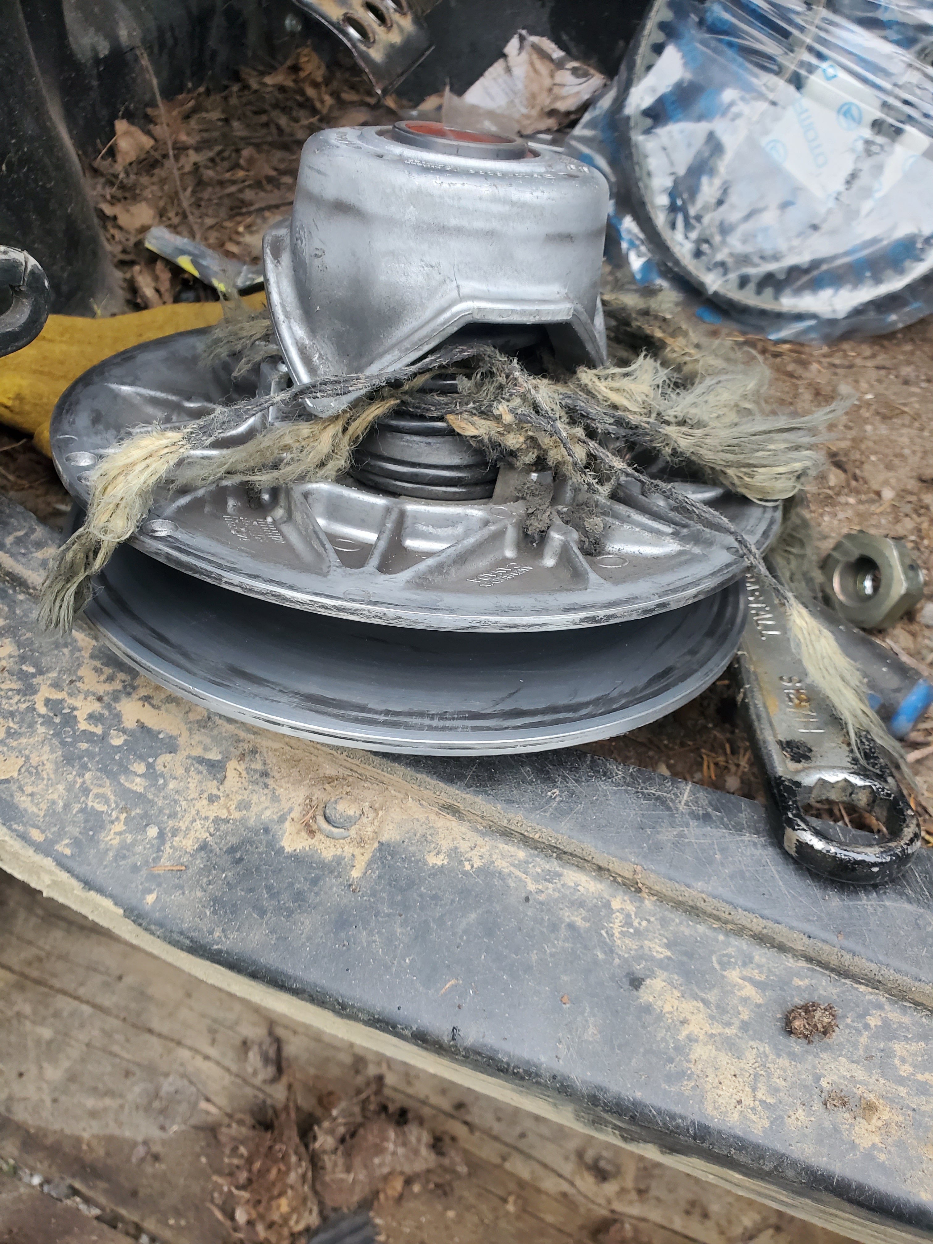

Another annual update. Lol. I now have 4600km on the uforce 500 and finally had an issue with it however I can't blame the machine as it was operator error and procrastination that led to a drive belt failure. I had bought a new drive belt for it last February saying "I'm going to change the belt as it's the original one before spring." That turned into...."Well, I'll just be cruising at low speed around camp so I'll bring it out and do the belt before hunting season."

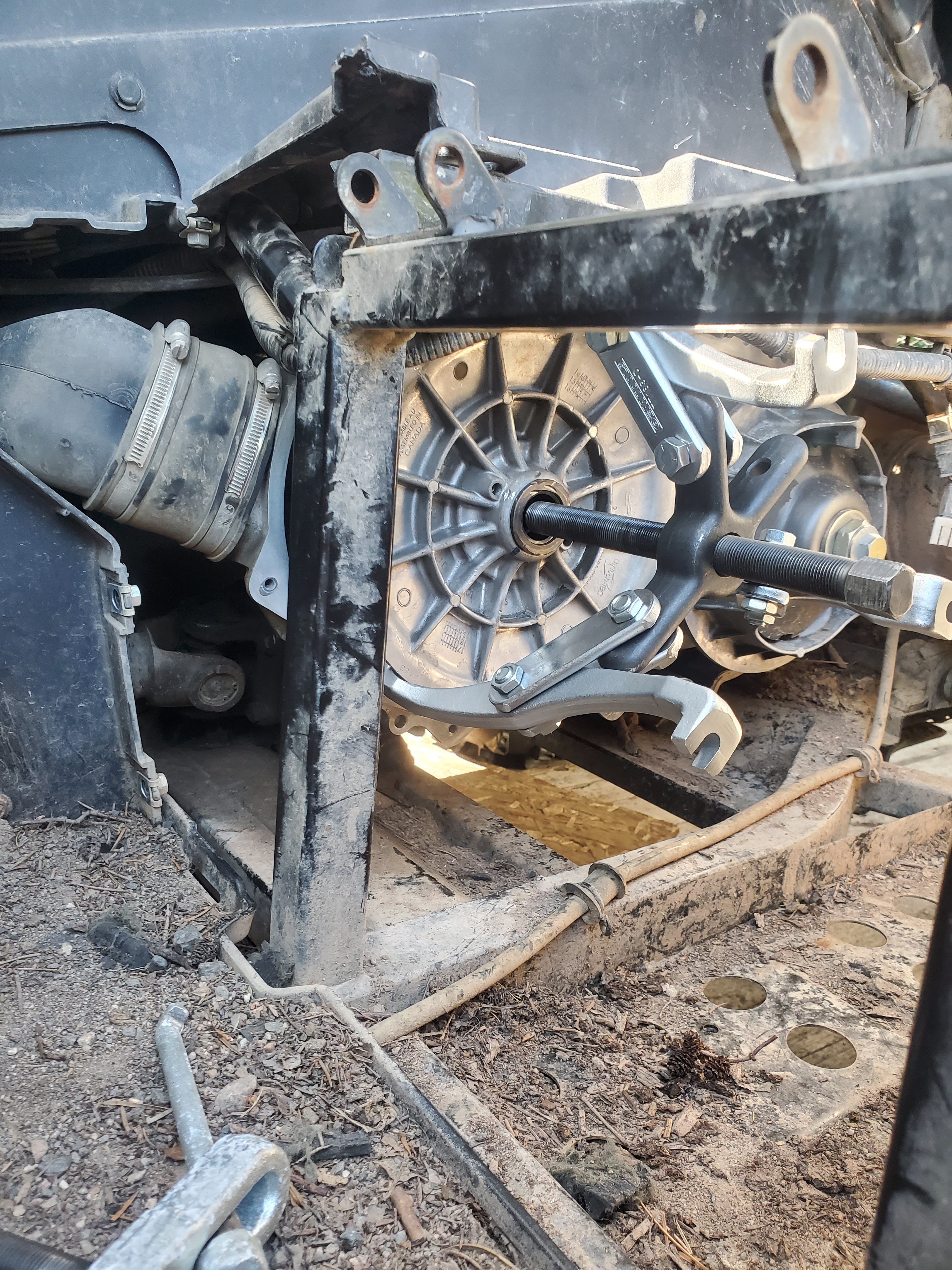

Fast forward to 2 weeks ago. I went out on a ride with a couple other guys from camp and was fine while we were cruising down the trails but we came to a portion of main gravel road being used by logging trucks so we had to cover a few kms of it before accessing another trail. I had it wound out full throttle coming down a hill when the belt disintegrated. We pushed it off the road and headed back to camp for the truck and trailer.
I tore into it at home and discovered this when I removed the secondary clutch.
I got the shredded belt removed from the clutch but discovered a broken part in the clutch from the belt so decided to drop it off at the dealership for a rebuild.
I reinstalled the clutch and discovered that I should have greased the splines on the shaft first to help it slide on easier. It would not go back on all the way so I had to rent a 8" gear puller to pull it back off to grease the splines.
It is now back together and running great.

Time for another update. Still going strong! I decided last year to get a sheet of lexan cut to width then took the factory half windshield off and traced the bottom contour to follow the shape of the hood then fastened it on with strap clamps. Factory full windshield is over $600 up here. I did this for roughly $150 in materials. I then ordered a set of universal utv windshield vents and installed them. They make a world of difference for heat in the summer inside the cab. As for mechanical, not a single issue. I do a yearly oil change before hunting season and keep it greased. Even the cv boots are original and not cracked or torn which is surprising considering the 2" lift and the places I get into with lots of alders sitting up everywhere on the trail.

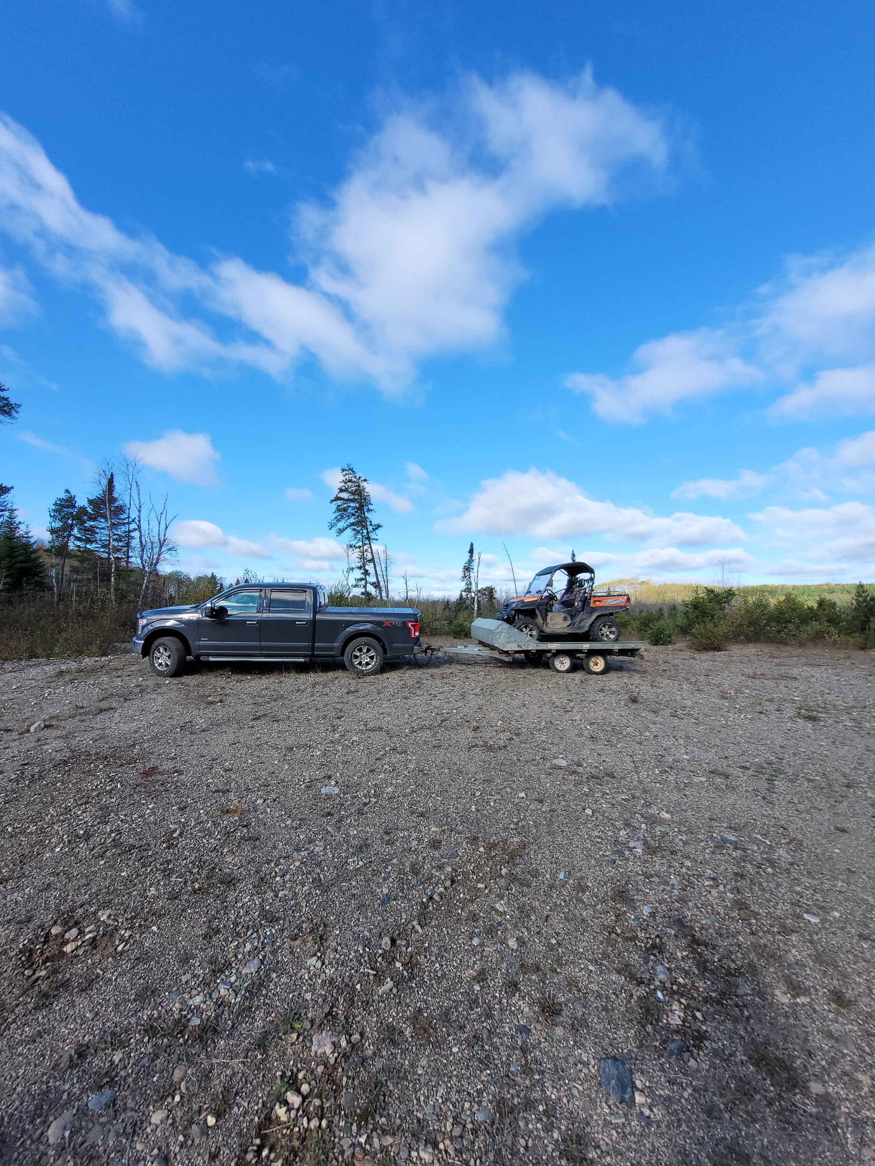

I had been using my 6.5 x 12 flat deck single axle trailer to haul around the sxs since I bought it. However, a few weeks ago at the beginning of hunting season, the trailer suffered from a catastrophic failure putting it out of commission for a couple weeks. This forced my hand. Either I don't hunt until the trailer is repaired or....
I also have a double axle 2 place snowmobile trailer for the winter. It was sitting in storage with the snowmobiles on it under the attached carport on my garage. I hauled it out and offloaded the snowmobiles. I had a set of good folding atv ramps and used those for the trailer. They lined up perfectly and with that trailer being only 12 feet and a double axle, I can barely feel it behind. When towing the flat deck with sxs, I was averaging around 18.5L per 100km for fuel mileage. With this trailer, I was getting 15.8. So better fuel economy as well. My buddy and I rewired the lights and I gave a good thorough once over on the tires and bearings. Last weekend we trailered to his camp 2.5hrs away to go hunting. It performed flawlessly.
