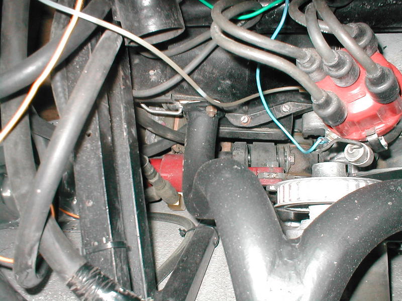

Kirk ,
Too many exhuast pipe connections under the hood cause exhuast fume leaks into the cab . That's why you see the wind window open . This was a major mistake by the Kristi company designers . You need to check the connections all the time .
I took the time to redesign my exhuast on my KT3 and have NO connections under the hood . No more Fumes !!

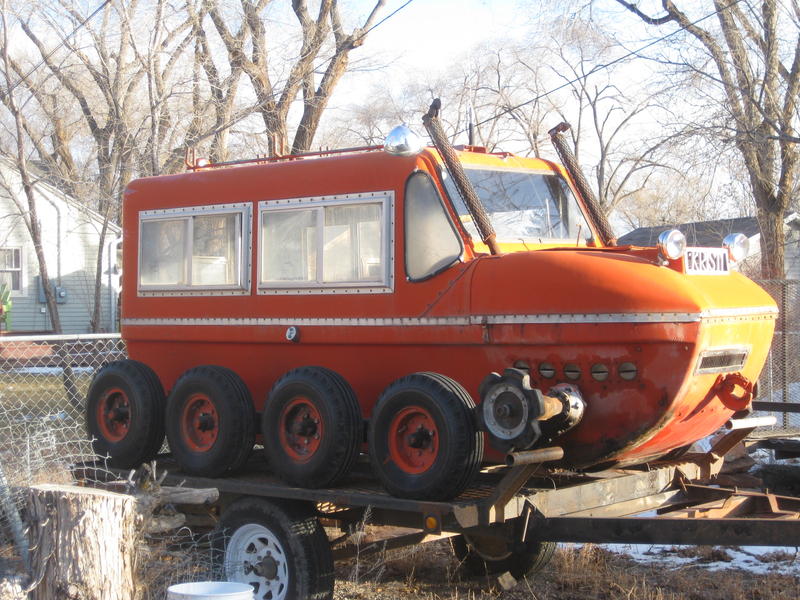

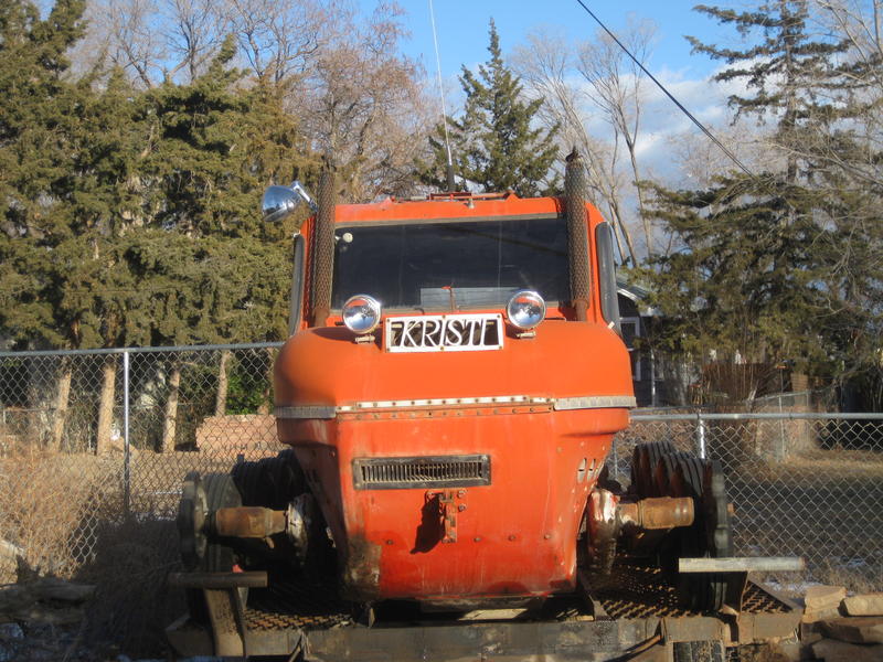

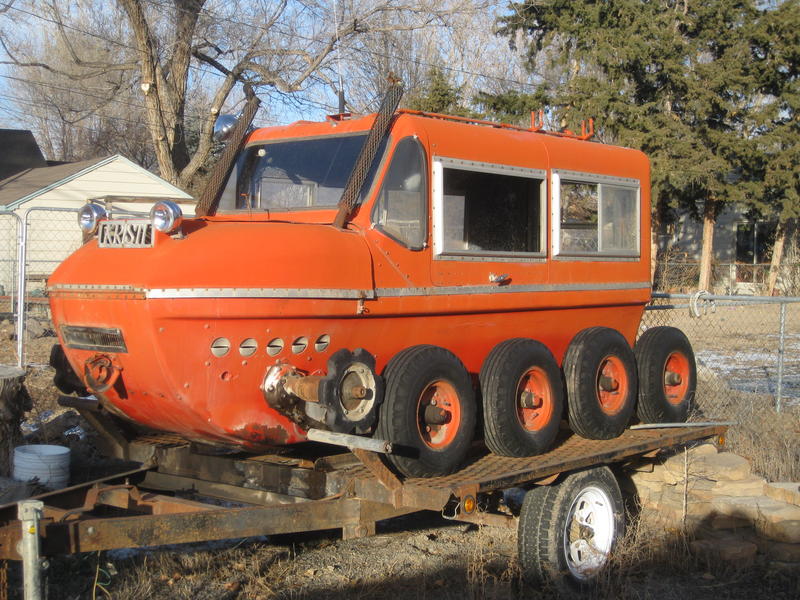

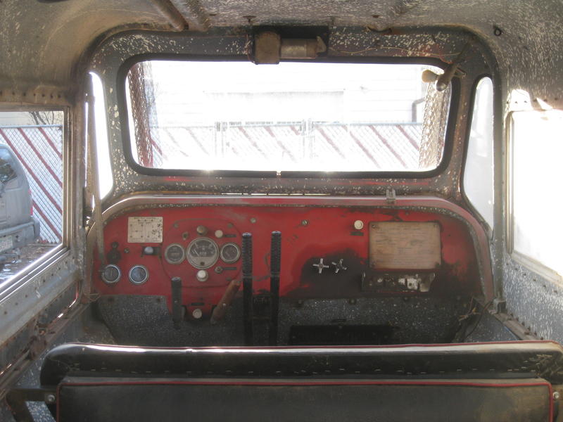

Well when I drove by New Years afternoon I sure thought it was moving but my buddy tells me I better quit the egg nog 'cause that Kristi has been sitting there for over a year!!

that one is sittting how most of them are on a trailer notice it also has a hitch on the front to ease the job of the snow track or thiokol owner when towing it back to it's trailer where it feels safe and secure
