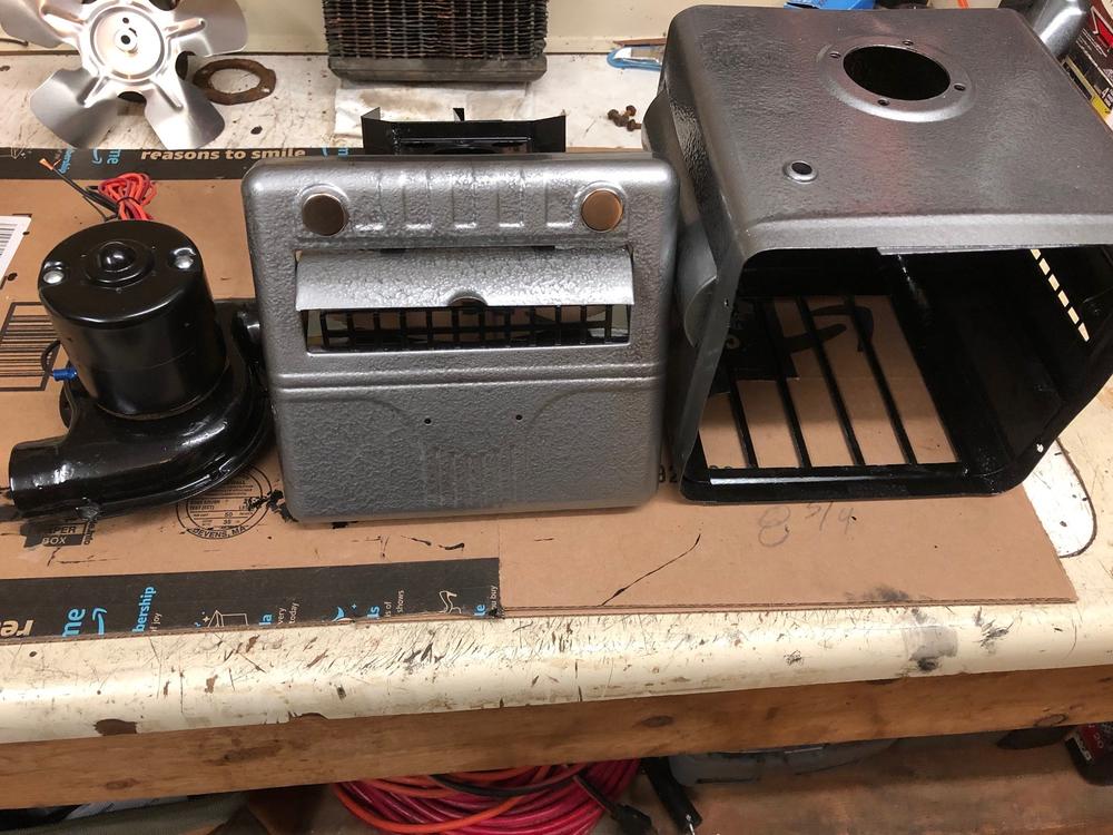

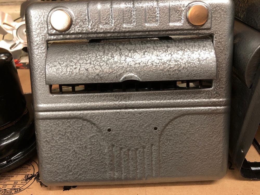

Sweet heat potpourri:

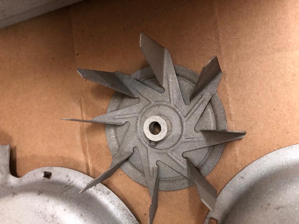

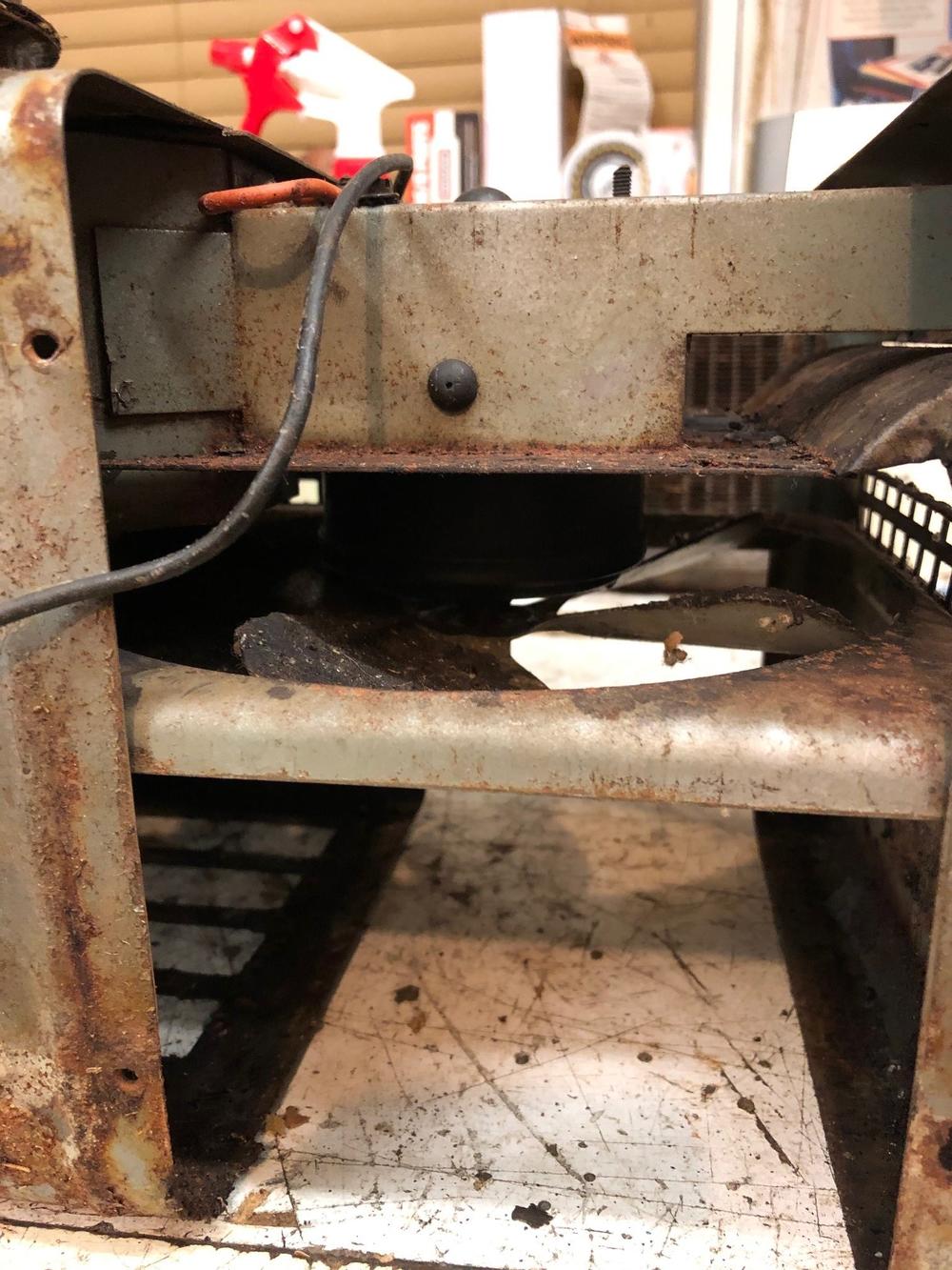

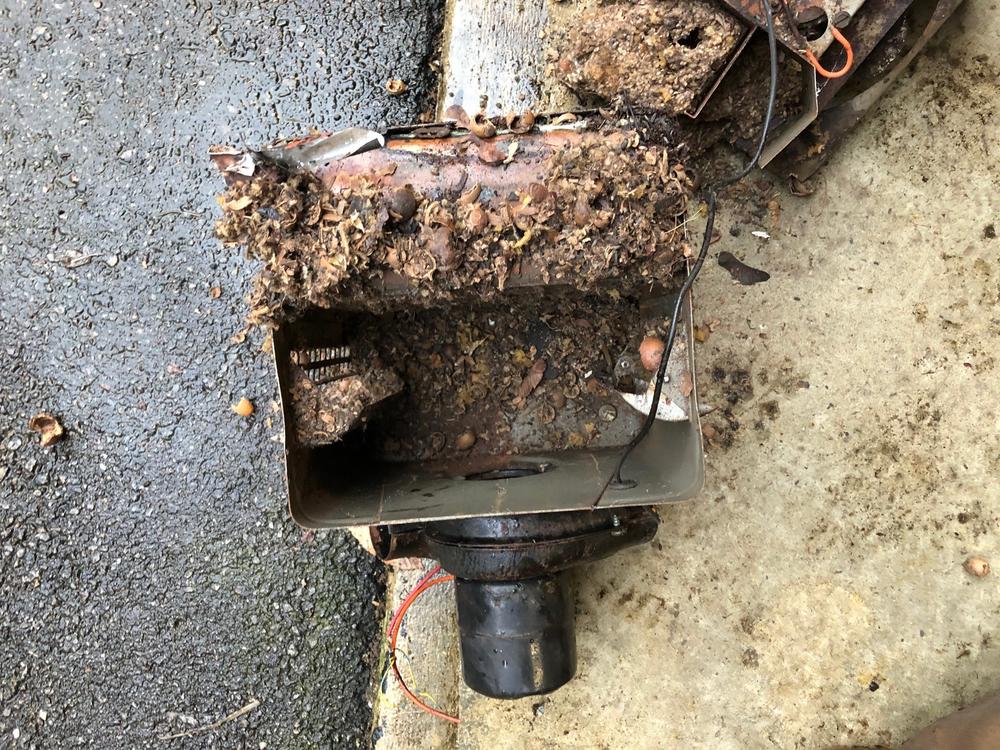

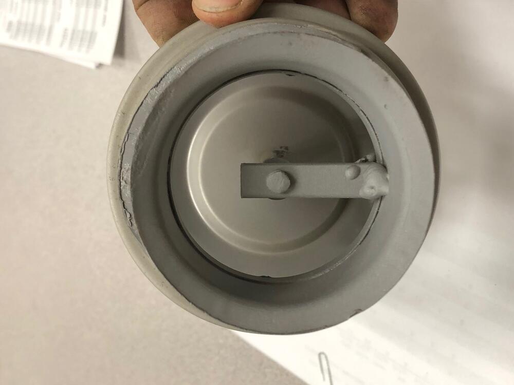

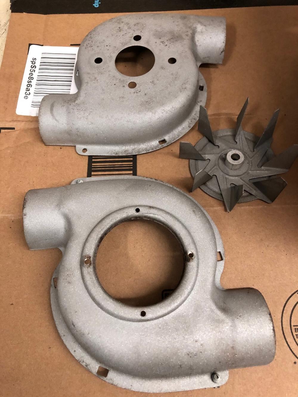

This evenings "what's wrong here" challenge problem. Anyone see what's going on?
The mouse should stay at zero gravity between the fans if turn them both on.
If you turn the heat on leave the defroster off it should cool down the cab nicely with the windshield air! Those close quarters generate plenty of body heat between the two occupants.
……… the ''yellow '' sticker also doesn't instruct you to flip the fan blade over 180 degrees , for ccw rotation..lol,... like a reversible radiator fan..... not that , that works on non-reversible fans... and,....
Is there a snowcat restoration that did not include removing mice from heaters?
…… not that ive ever run into,... and also air filter bonnet's , have had a run of these this year..... remember sno-drifters earlier advice … ppe & vacuums ….:thumbup:

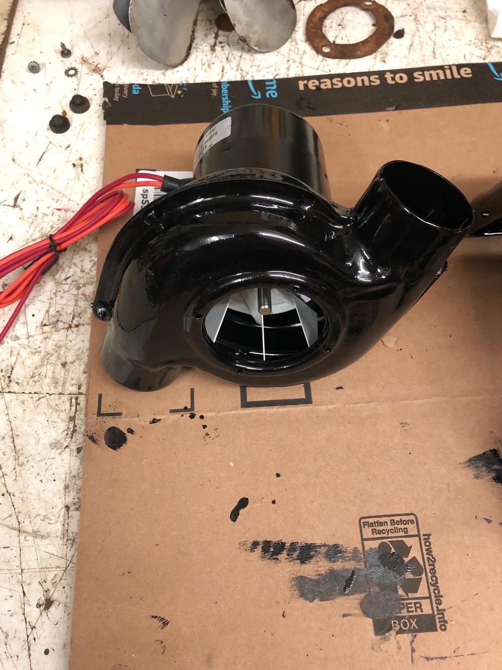

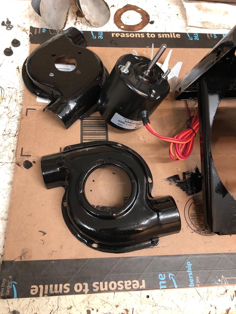

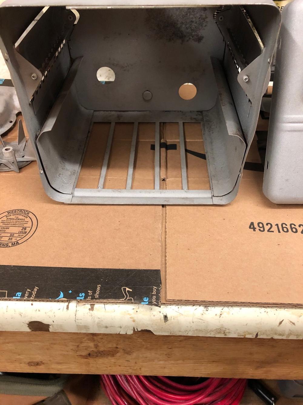

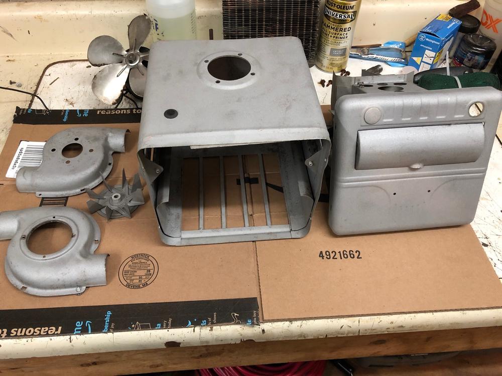

Well, heat box complete, less a coil (currently). Replacement on the way. Mine didn't pressure test well (leak between tank & core) but may be salvageable at some point.

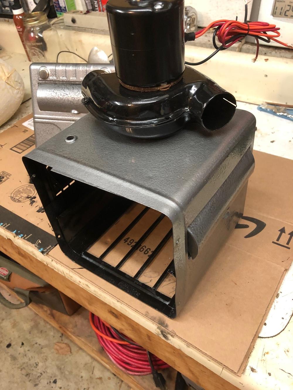

Batch two:

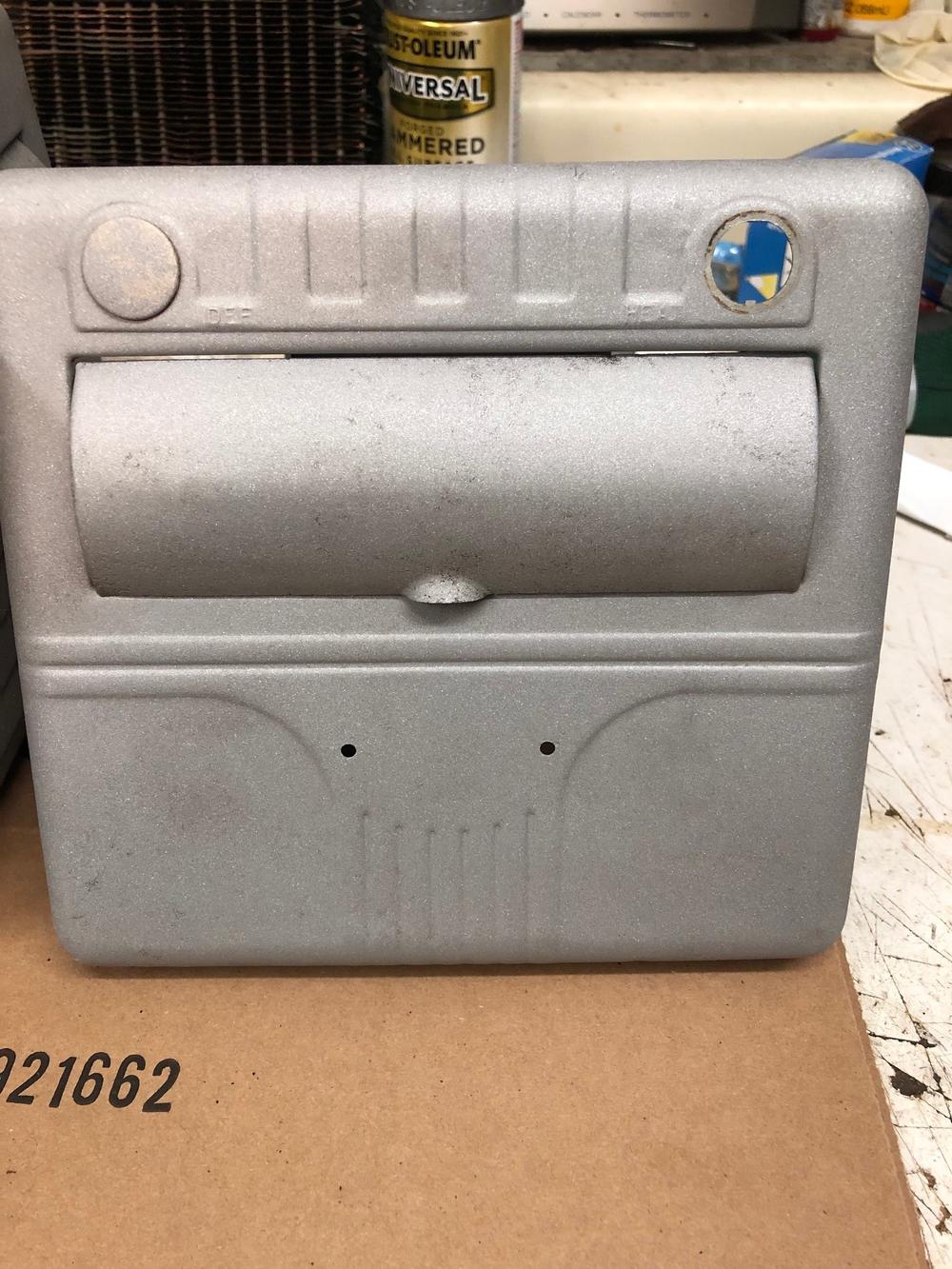

Heat three:

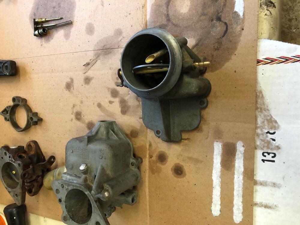

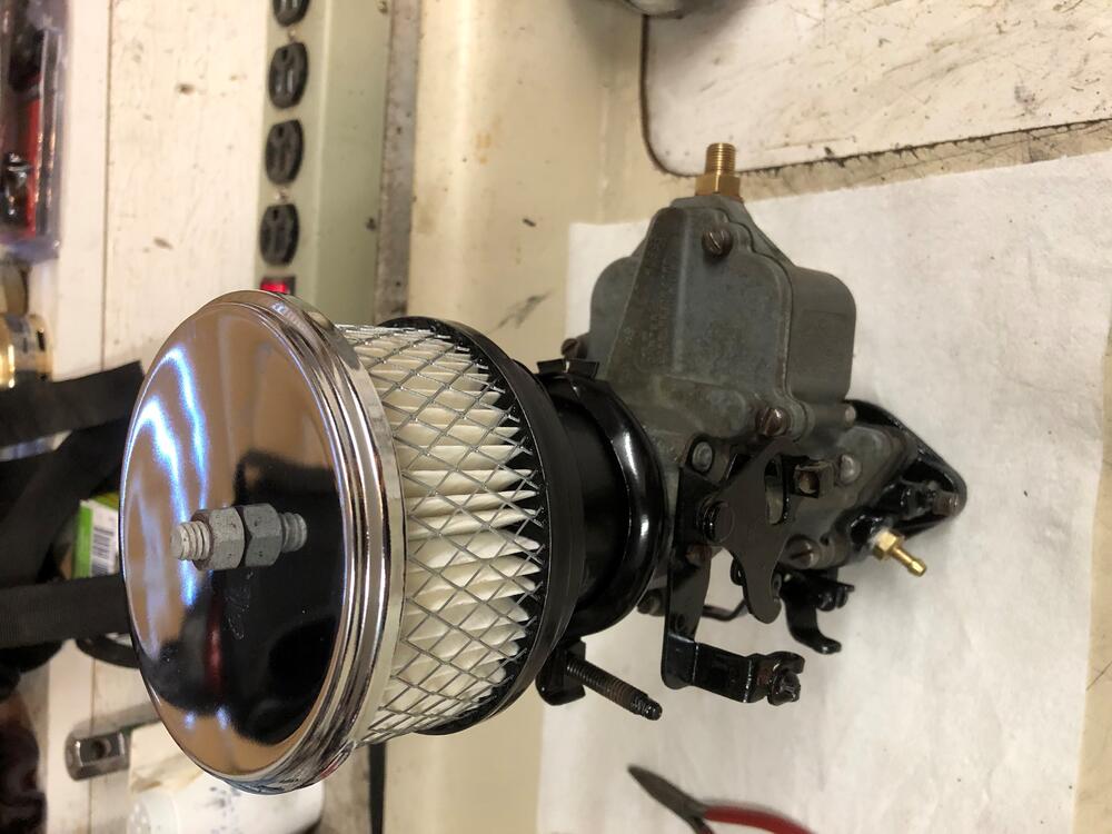

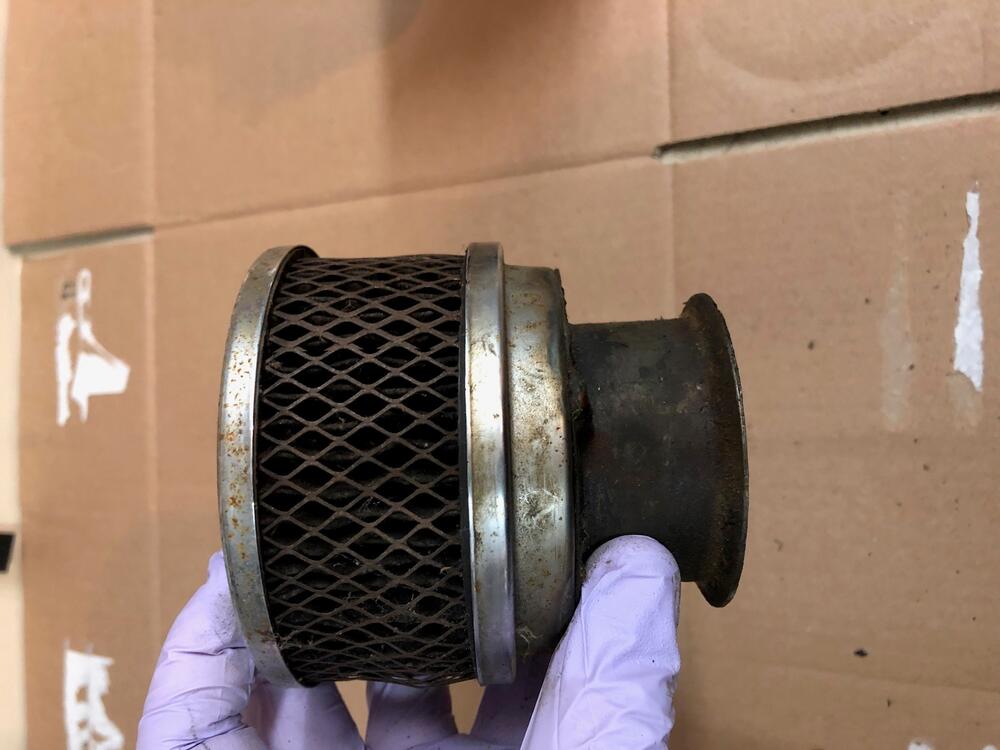

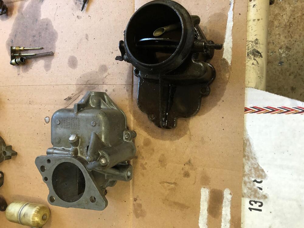

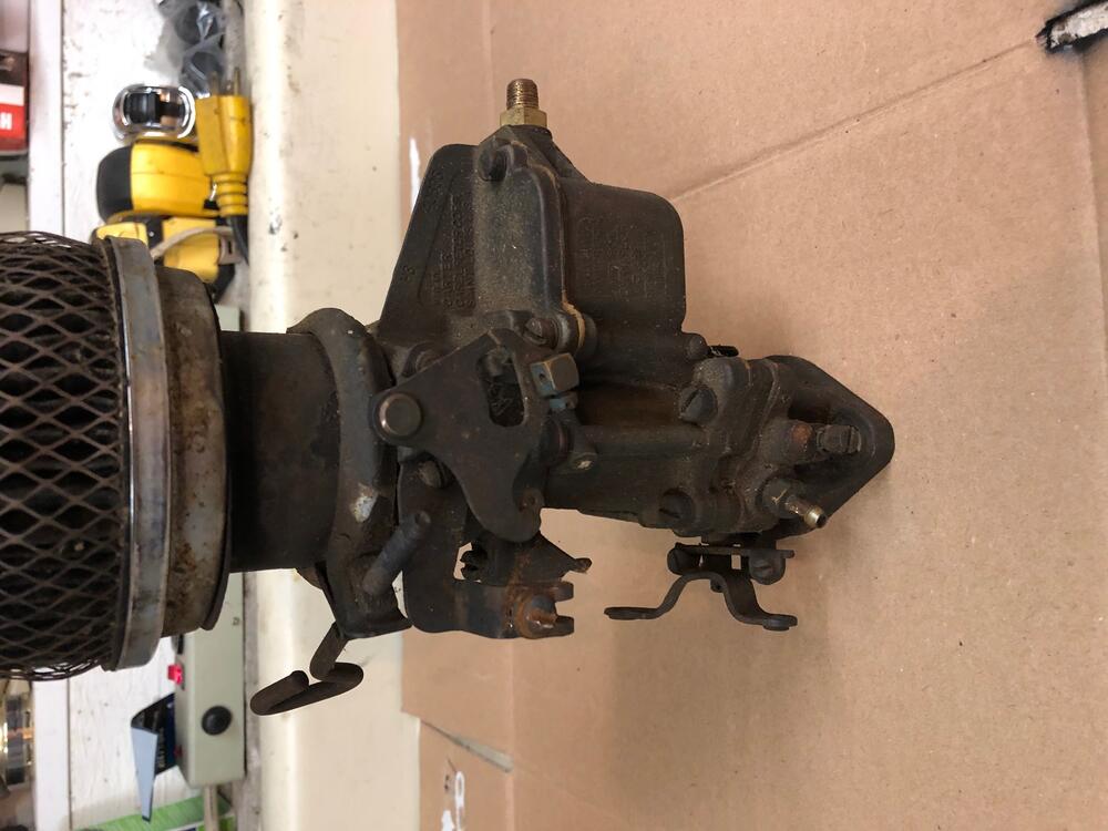

Some Carter BB1 carb work (Sorry for side view- pics won't stick & tired of trying!) :

Carb #2 -- An ultrasonic cleaner would kick ass, but would be a waste for the amount I would use it. Good enough for a crawler!

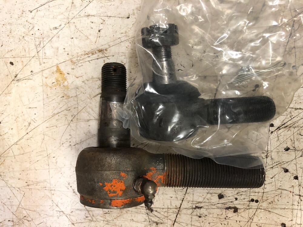

New tie rod is in the works...
ES2010L and R are the end part number. Thinking this kit for the upgrade. Sheet says 52 1/2”. Wonder if that is tube length or end length according to Tucker?
https://www.ruffstuffspecialties.com/catalog/TRESTAND-KIT.html

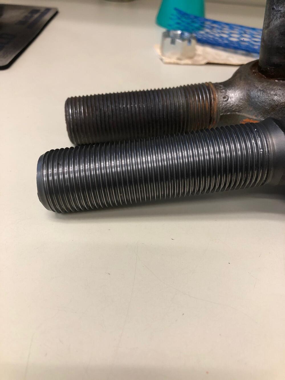

Well, going off the info from Tucker Someday and TA's repair, and even though I knew better (since we are dealing with Tuckers), I dove right into the shallow end to try to get rid of my angle iron reinforced draglink. Sister-ship on the same mountain, a year apart, you would think would have similar set-ups. Looking at the ends above I was thinking that sure seems 'small', but the tube kit looked rugged enough and obviously fit on TS's machine. Mine showed up Wednesday and all I can say is I can't believe the ES2010's hold up to the forces of turning a Tucker. Mine is completely different and WAY beefier from a heavy duty truck application.
Original casting has 24-5000 on it (manufacturer unknown). Chasing sizes thru the parts book brings it to current day numbers: Meritor R230060(LH) and R230061(RH). Still searching the correct cross tube.
I believe you are looking at a standard 400 series with 3/4 inch roller/tie rod end and the bigger one is from a 400A series with 1 inch roller
Except on the 68 442A. That one has the smaller tie rods and ends.
Let me know your tube solution. Have two to build this fall!
They would have had to magically reduce the taper on the tables and center pivots tie rods. Plus there is no room to have the bigger rod without hitting the transfer case on that machine.
End Number notes: Meritor R230068(LH) and Meritor R230069(RH) ends are the same as the numbers above, but have 1/2" more thread length, are much more common and much less expensive. For dimension reference: https://mpparts.com/part/meritor-r2...Ntc9XRXB-ytv1_bWciH_vVr4qDZnnpOUaAmugEALw_wcB
I needed to order them in to verify it would work since a lot of the time stock photos are used. All sizes are correct, but the actual ends have a very slight offset which leaves the rod proud (see arrow). I don't believe it will be enough to create an issue given the drop of the rod, but will need to test at full table deflection to verify.
