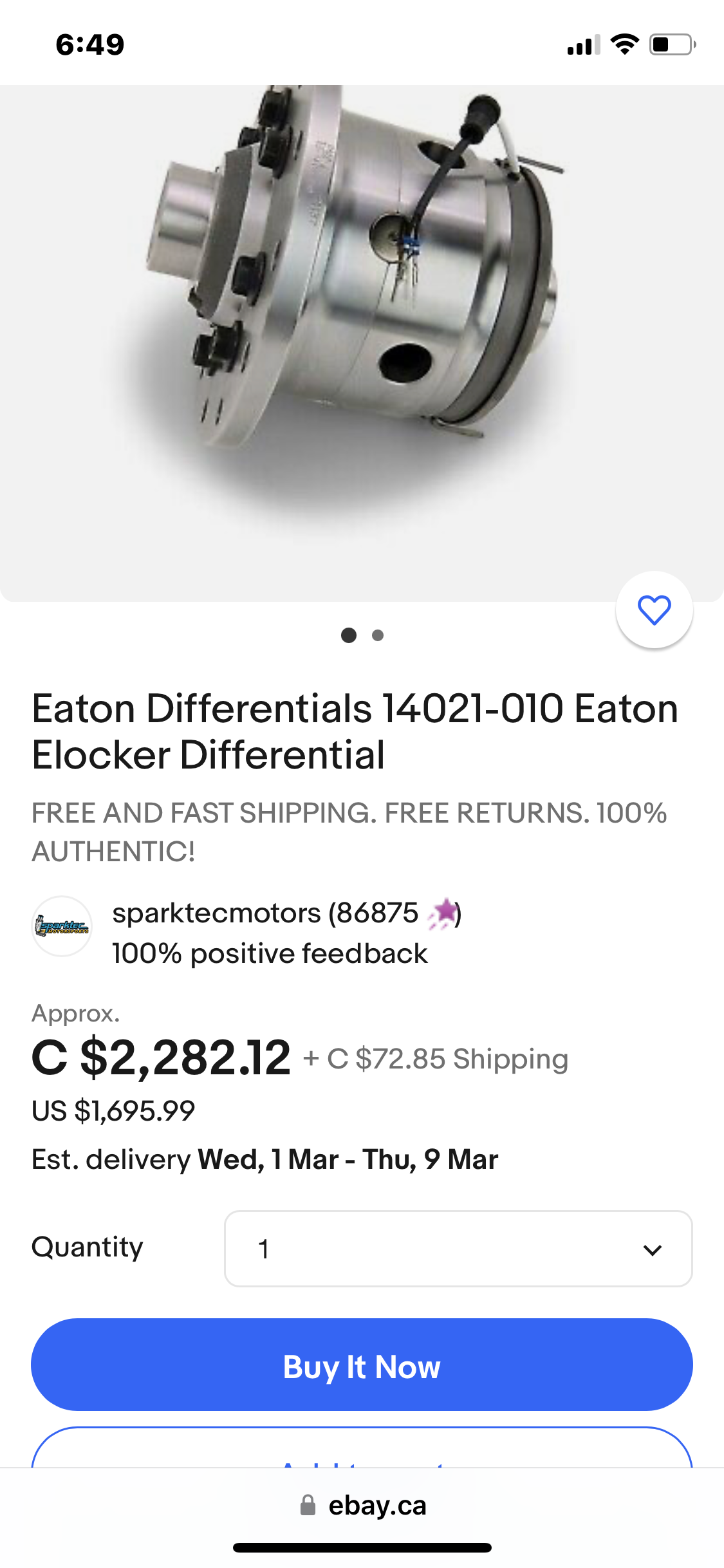

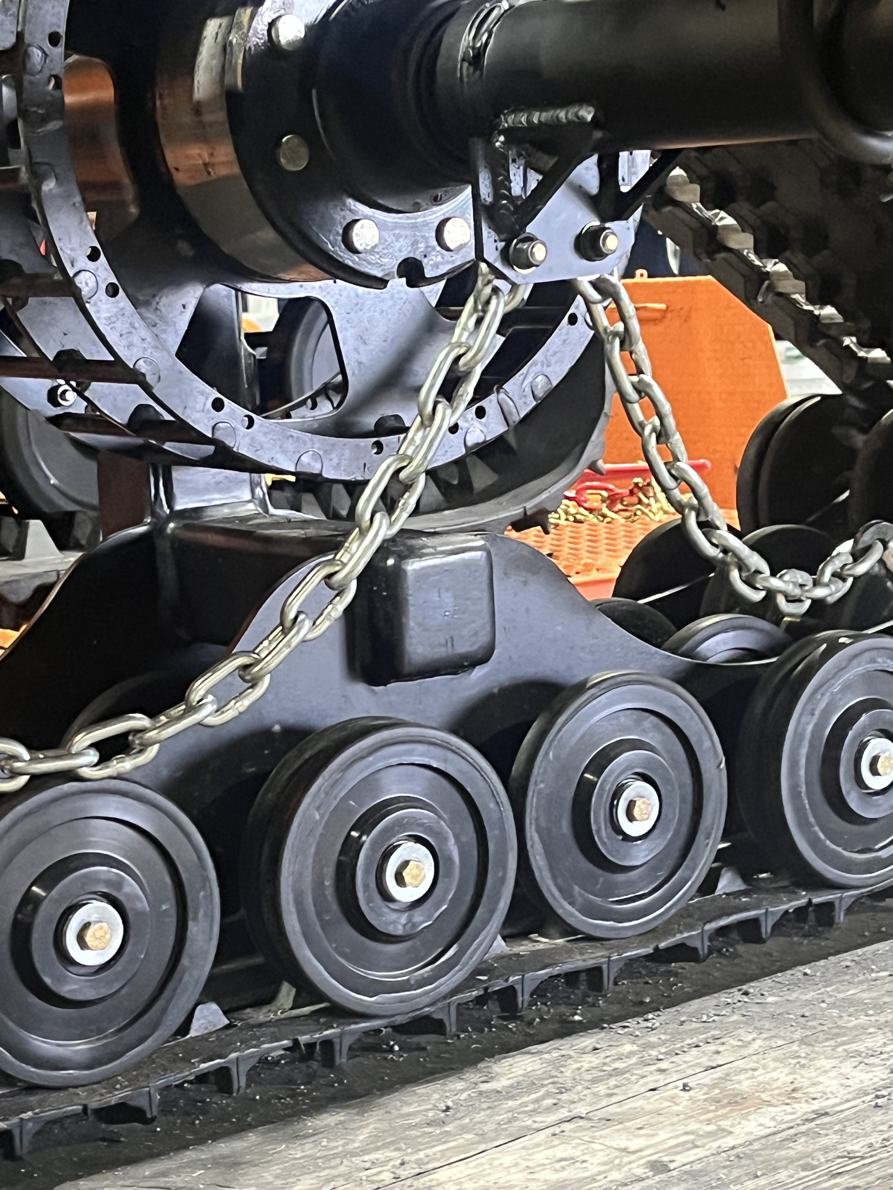

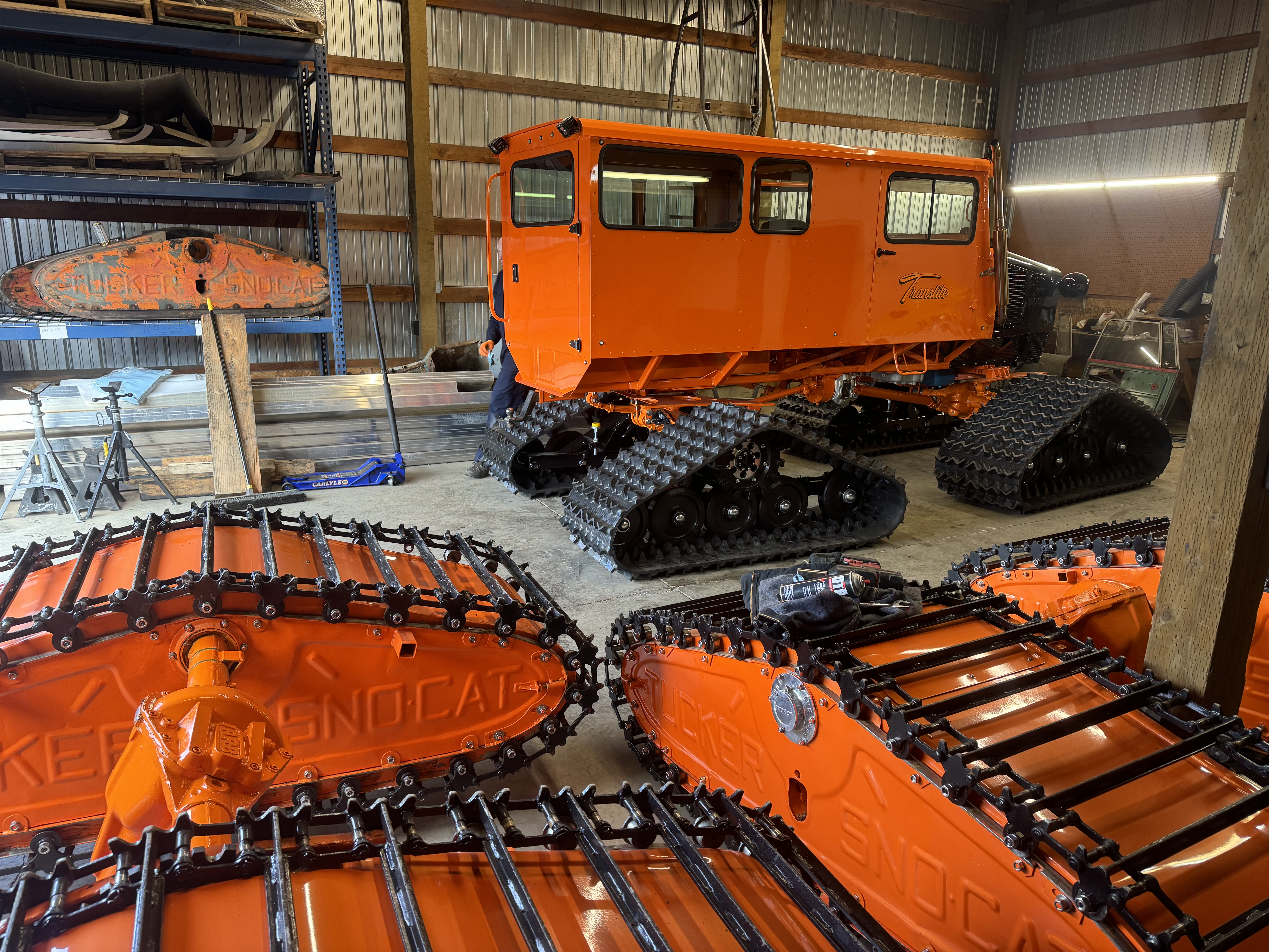

I installed an Eaton electric locker in the front diff. I usually only use the locker when pushing snow, otherwise I end up with one front and one back track spinning. That one locker makes a huge difference in push, and makes the Tucker hard to steer, so use sparingly. The Eaton system is instant lock and unlock, the hardest part is getting the dash safety switch to move! It has some child proof lock on the switch.
