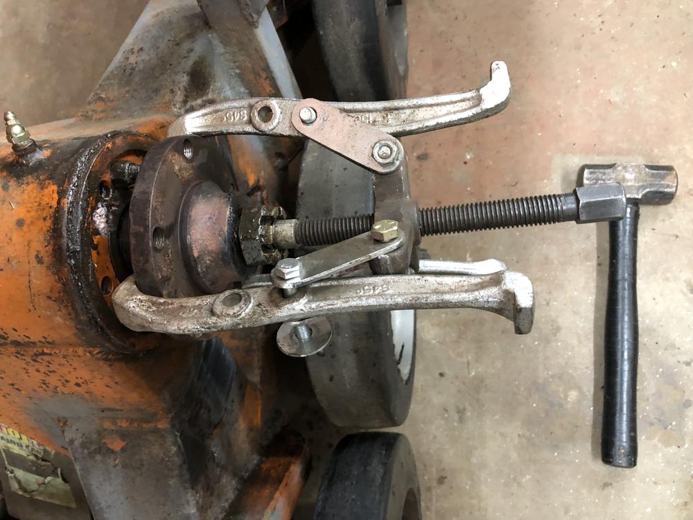

Any tips for this hub removal?
Right now using lubricant, puller, heat, tap, and time
I just went through this on one of mine what a pain! You're doing everything right except you probably need more puller pressure and what I had to do is hit the spindle extremely hard to get it to pop off kind of like when you shock a automobile tie rod. Use lots of anti seize on reassembly. What do you plan on doing to fix the problem with the sprocket rubbing?
I even used a porta power at one point. Didn't budge. Shocking it with a large Hammer with all the puller on is what worked and it shot off probably 10 ft. Good luck.

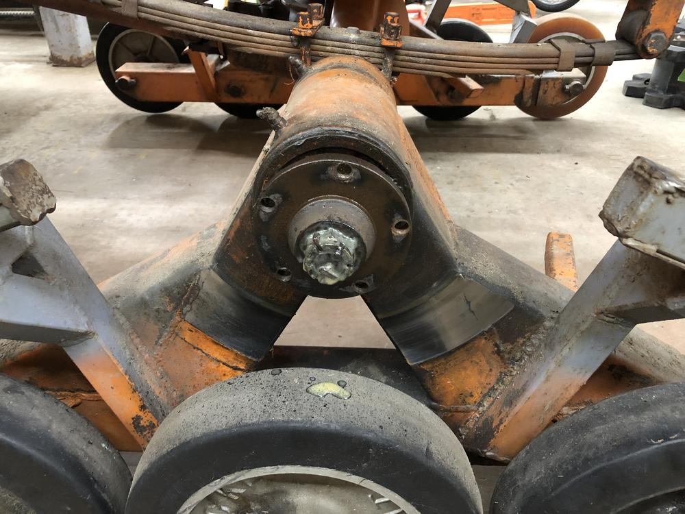

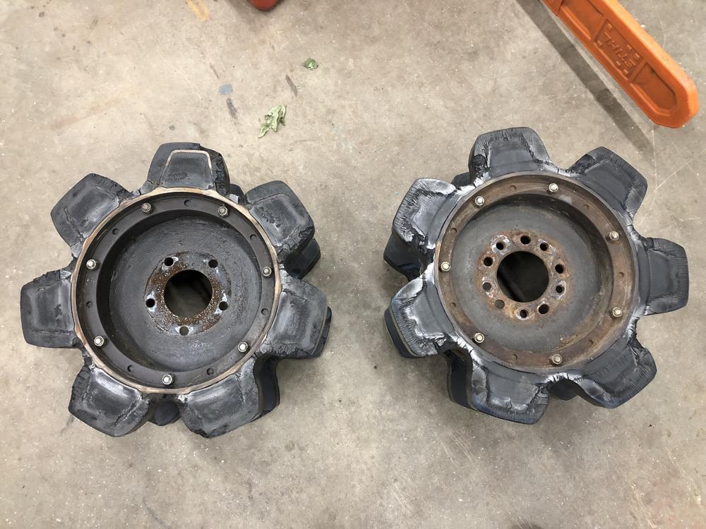

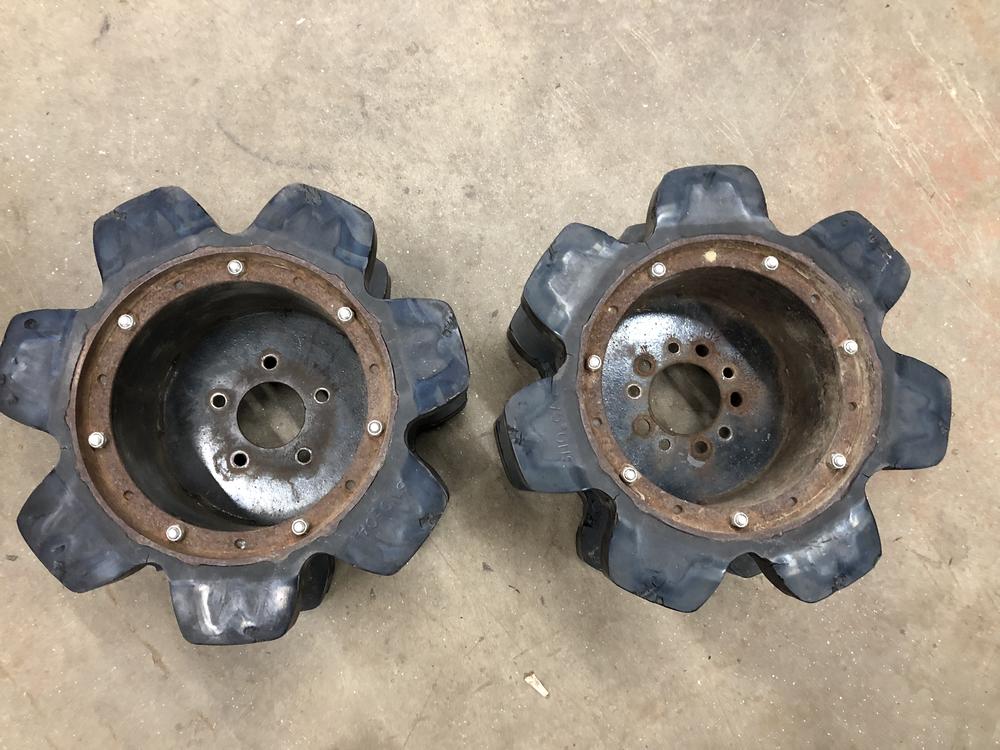

The rubbing is do to the carrier wear. The journal welded to the axle housing eats into the carrier housing. The inside wears much faster than the outside so as the carrier top tips inward the wheels start to tip outward. This makes the sprockets start to hit the carrier .
Not sure where the most wear is but I believe it is the carrier housing. Hobbiest fix is to use bearing taps to take up the slack. Correct fix is a Tucker retro kit consisting of new weld on journals and a uhmw sleeve. Kit is over 2000$.

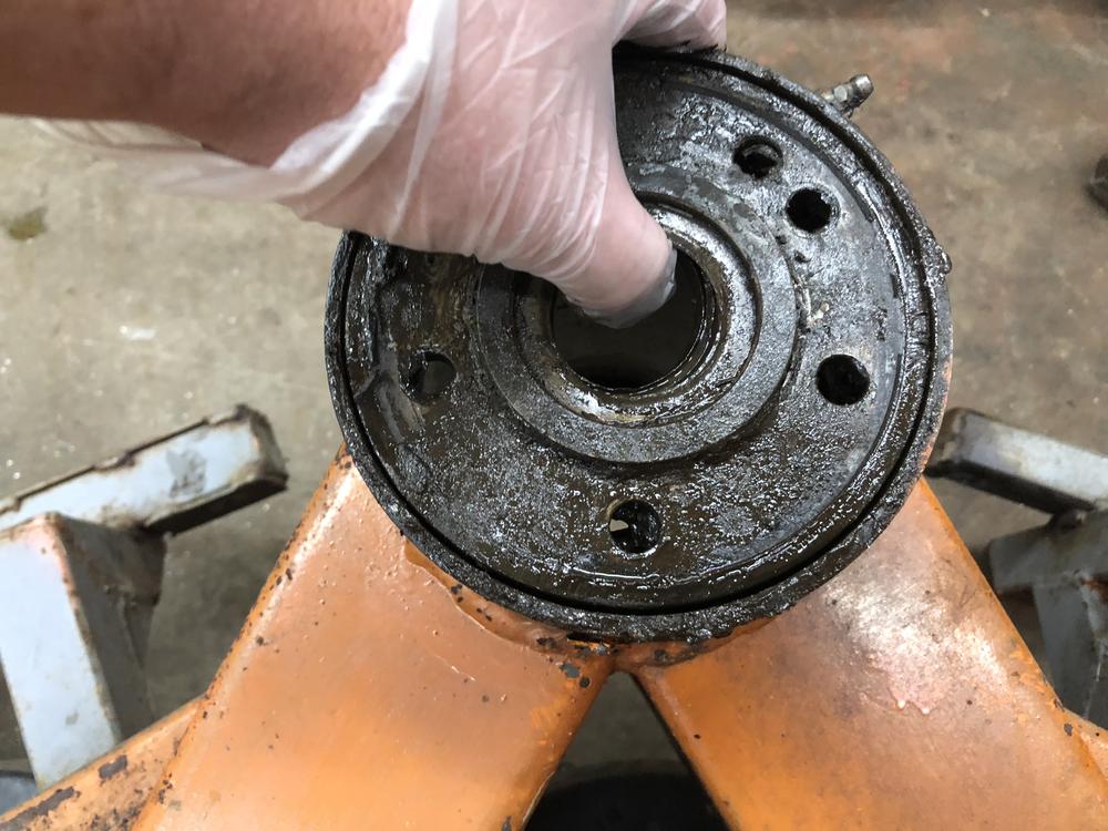

Waiting to see what I find in there. Here are some pics of the wear on the inside of carrier . Though to see but bunch of slop to take up.

Took a new approach using “bigger tools”. Other than being down one harbor freight puller hub off .

Yup one shot one kill on that hub. New puller hopefully get to it this afternoon.

This side had to have been off and was anti seized. Started with the big tool popped right off.
Wish it had my hours back on the other side .

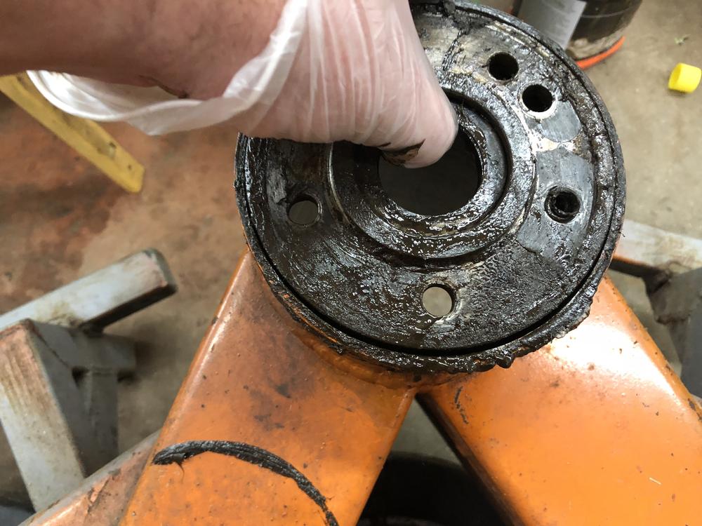

Carriers off. Now I understand what I am working with. First glance the grease fittings are 180 degree off from where the load is. The carrier has a proud grease groove and the journals have a recessed. On the carrier that proud surface is worn off bottom 1/3 and toward the front. Makes sense driving forward and machine load. Fittings appear to fit in that wear location on bottom not sure why that wouldn’t be the spot.
Bearings and seals/races are good shape but going to replace. Diff fluid might have been over filled and slightly milky. Will be adding magnetic drain plug on the diff.

This is the type of wear we are working with .
You can see the proud grooves on the top.

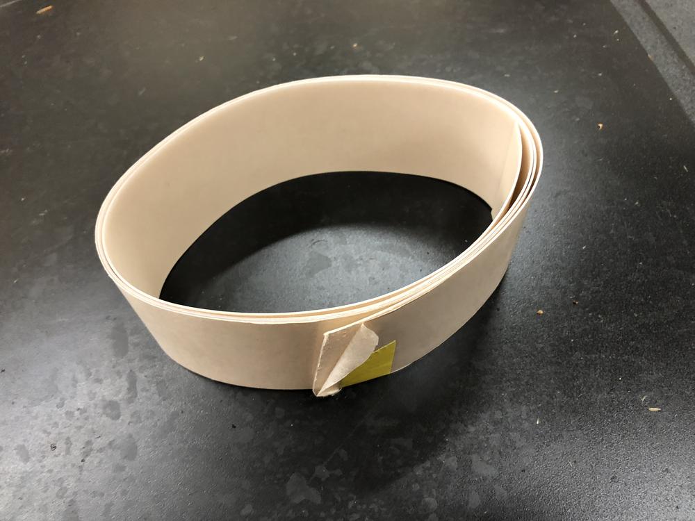

Here is the solution I am counting on.
Bearing tape courtesy of Tucker and GetSno!
