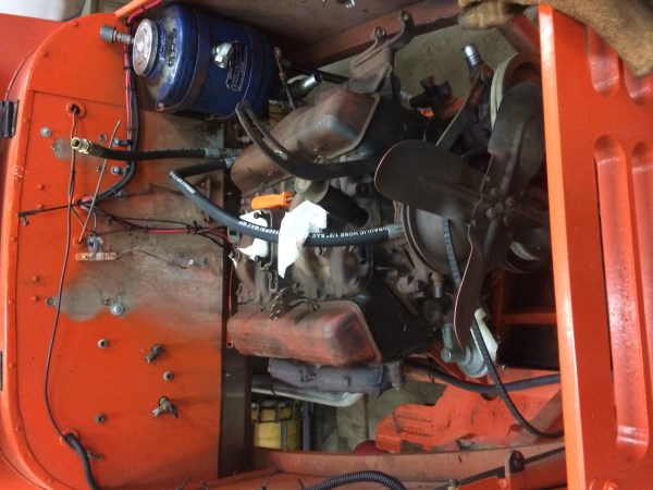

Cat is power washed, degreased and backed in the shop till further notice. Let the dismantling begin!!!
Trunion, front differential, leaky v8 oil pan and timing cover, transfer case seals. Rear pontoons a definate maybe.

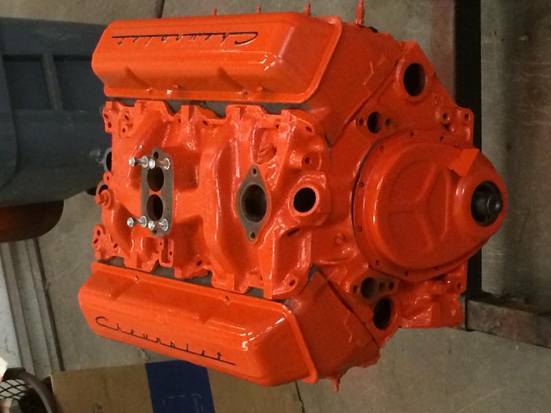

Got the engine torn down to block. This thing was freshened up in life prior to me. Everything is tight, clean and smooth.
Little paint and some new gaskets/bolts back together.

Heads on. More paint

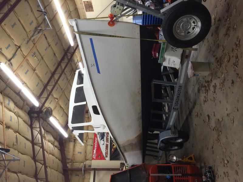

Boat boat project is now mobile. Put on trailer and towed back today.
