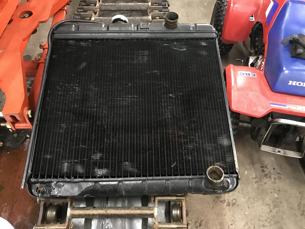

Radiator leaking. To recore or replace?
I can make anything new fit but would like to keep original.
Thoughts?

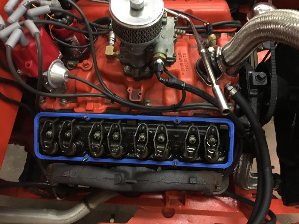

Little tuckering. Adjusted the valves a few months ago and have had an oil leak ever since. I usually use the thick cork but for some reason the 4 bolt small block Chevy valve covers like to leak. Was good until I touched it.
Got these new felpro perma dry gaskets. Silicon steel in the center to hold firm and spacers to prevent over tightening. Sounds nice we shall see!
ive used them before they tend to swell over time when too much swelling happens they crack usually around the spacers and splooge out the sides and leak. when installed properly its tough to beat the old cork
Time will tell. So far leak free after a few warm up and cool down cycles varying rpm.

Been chasing this ignition ghost in my Tucker. Thing wont start at random. Finally figured it out. I installed a new MSD distributor and blaster 2 coil. Other night I was warning the cat up to address the radiator leak location and it shut off like someone turn the key off.
After much back and forth with MSD troubleshooting swapped in a spare coil and touched off quick. Only 150 miles what I believe was a high end coil. They think heat from the stock SBC location and vibration could have caused it. Planning to upgrade to a vibration resistant coil and waiting to see if MSD will make good on this barely used part.
And I am fixing the radiator correctly.
Pulled the radiator. This thing looks to have been repaired before and in rough shape.
Going to try and source a new replacement

Radiator is actually a Chrysler product. Wish it was mr goodwrench because I could just buy a replacement!
