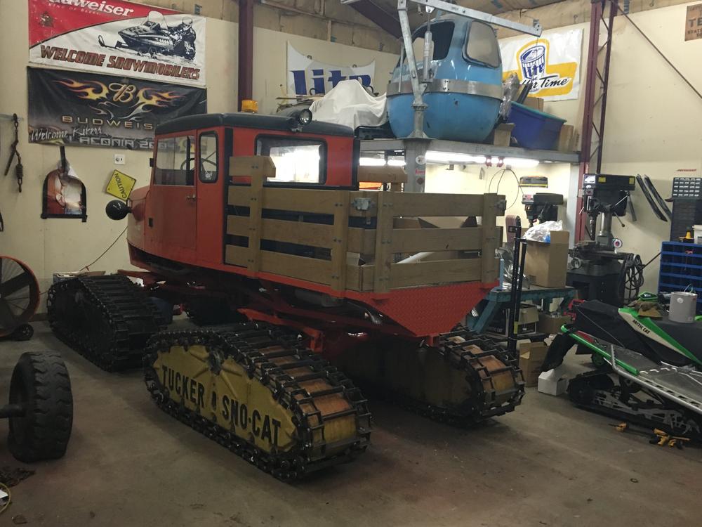

1968 Tucker 442 New to Me
On track
Yard test check. Much nicer end to look at.
Had to swap 15 rollers between he two rear tracks. All freshly lubed with Scott's secret recipe.
Thanks dewalt grease gun.

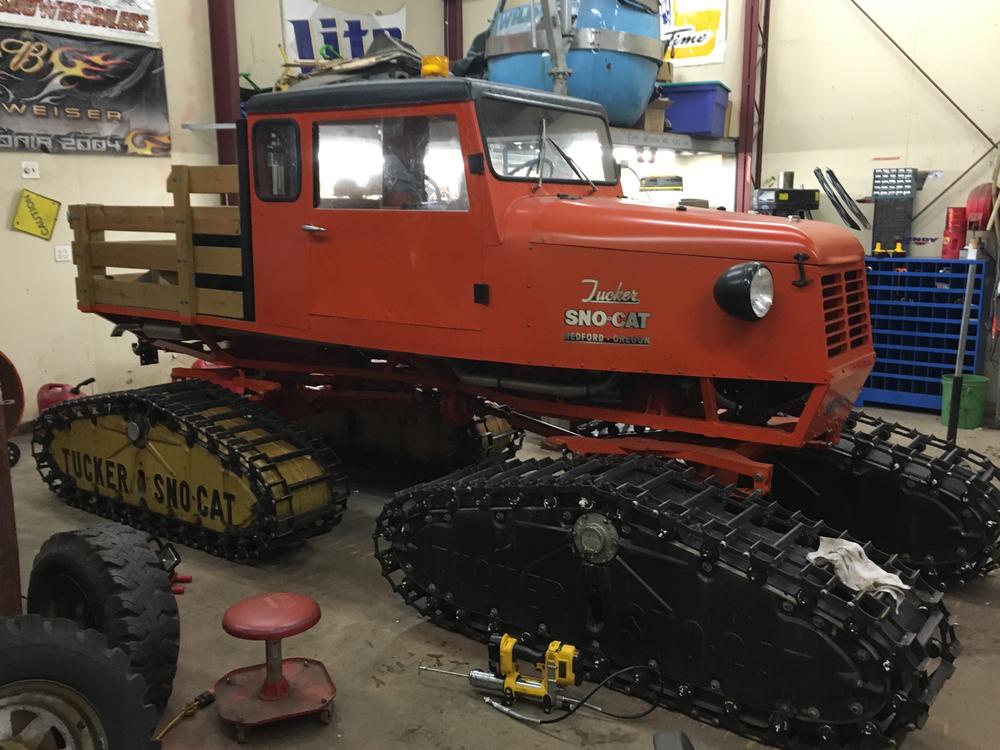

Technically no. Plenty of grousers overall. Think there is one on the table to the right.
What is the minimum grouser count for a tucker with no snow?
T/A, you ben busy. Less than 24 hours from no pontoons and tracks to ready to go. Santa's eves must be helping out after delivering presents.

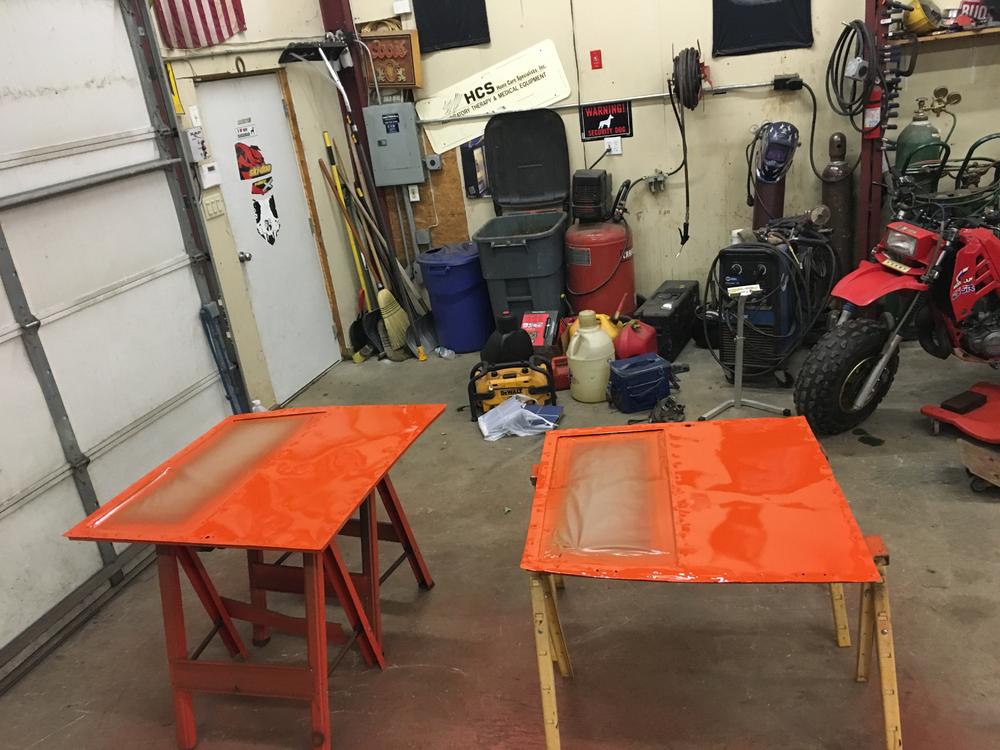

Take two on the door color match.
Tracks adjusted rollers and all fittings full of fresh lubriplate. Hydraulic issue fixed. Double checked all axle hub nuts for torque and greased.
Still need to fix the snow situation. Last year no snow until Jan 27 so will stay positive.
Once the gloss fades will be closer than the other shade. Or buff out the rest.

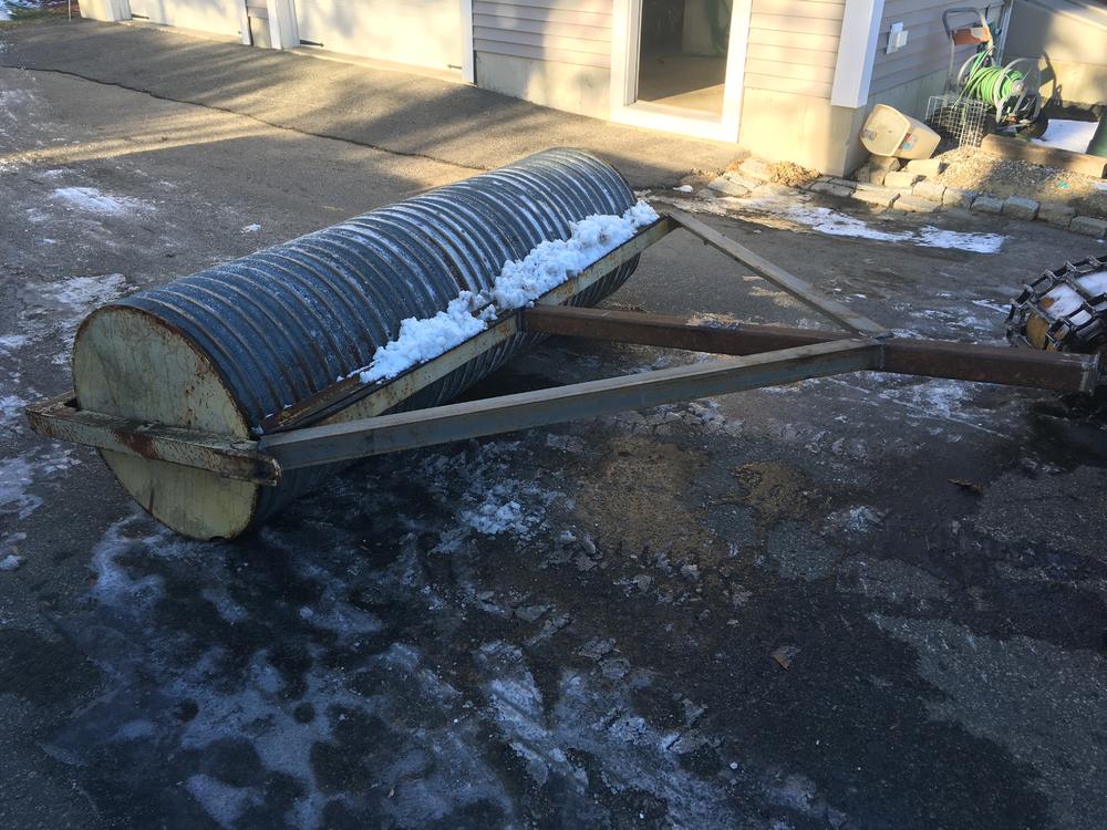

Tucker ready. Working on the roller today.
