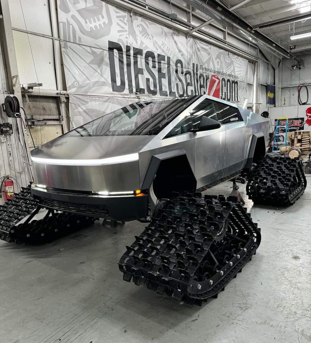

Tesla snowcat?
NorthernRedneck
Will be interested to see how it performs in the snow.
Hmmmm
EVs are heavy, it will probably be fine on packed or heavy snow. I’d be curious to see what it can do in Utah powder. Probably work ok as a cabin access cat, but not with a plow

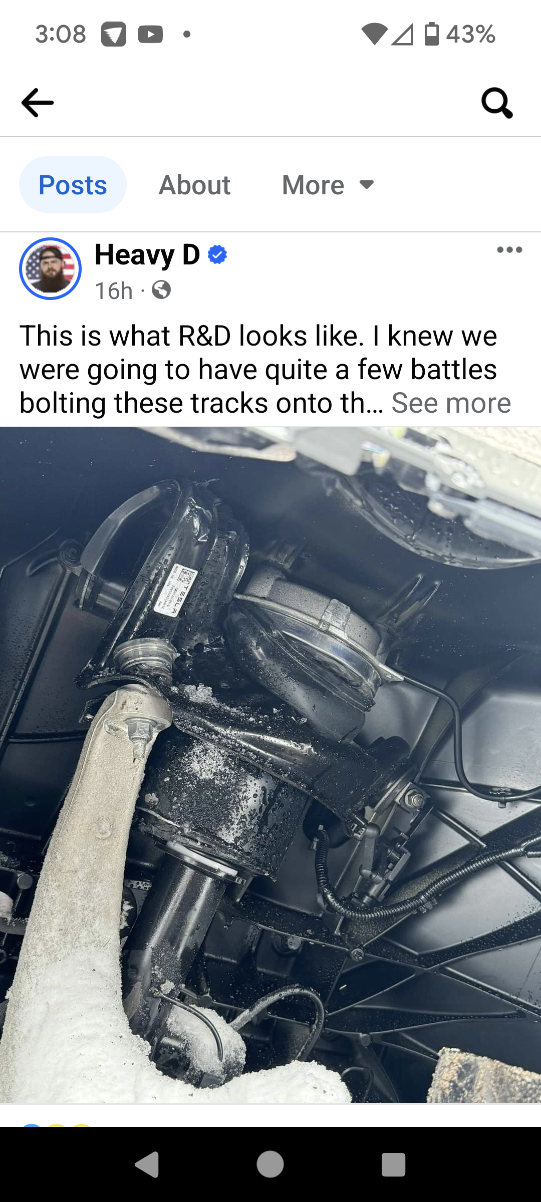

I think you nailed it better than you realized. Should be a public link even if you don't have Facebook.
Bennyboy1337
Bawhahahah.... that A-arm folded like a pretzel. The steel in that material looks like sheet metal too. Even if they fabricate a custom beefy A-arm, I'd worry about the bushings on the frame getting destroyed, which I would love to watch happen!

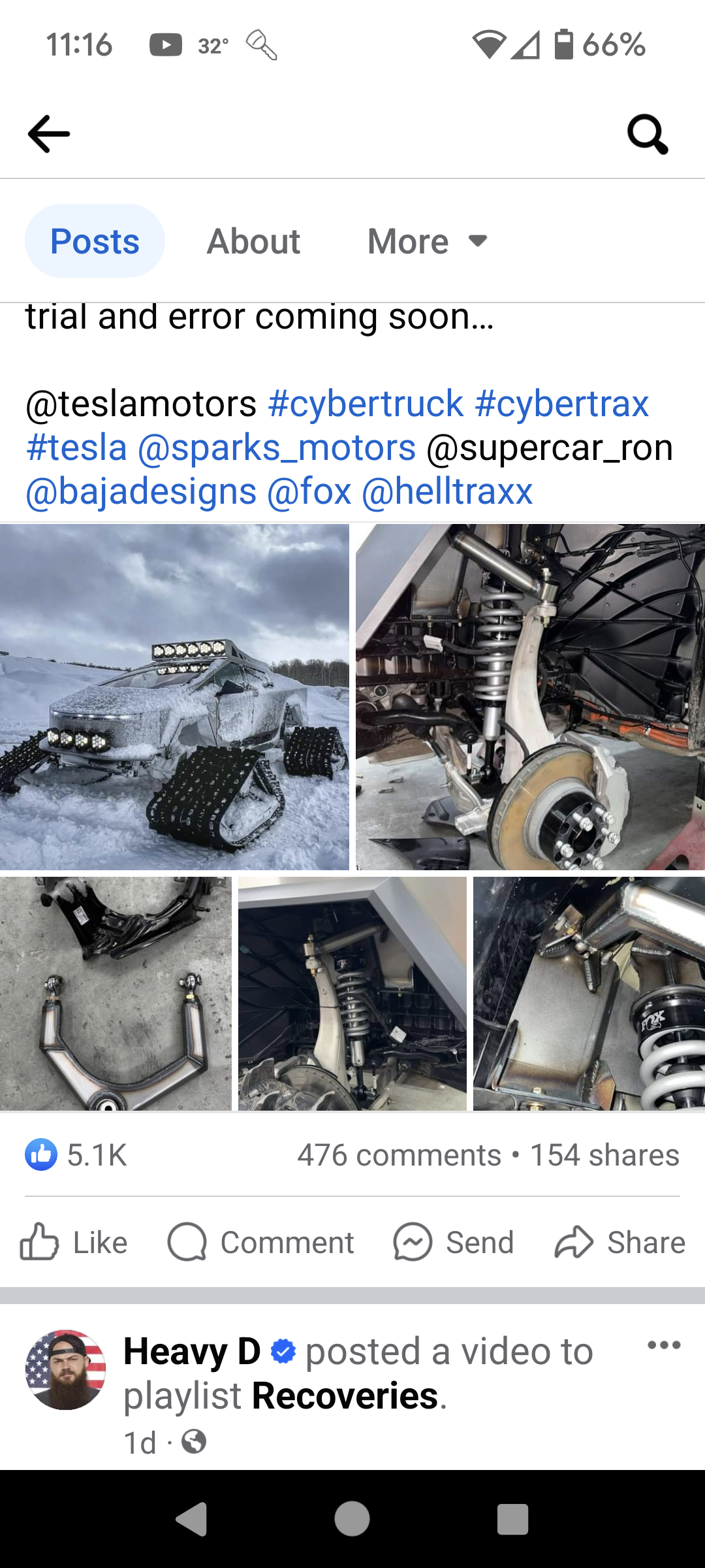

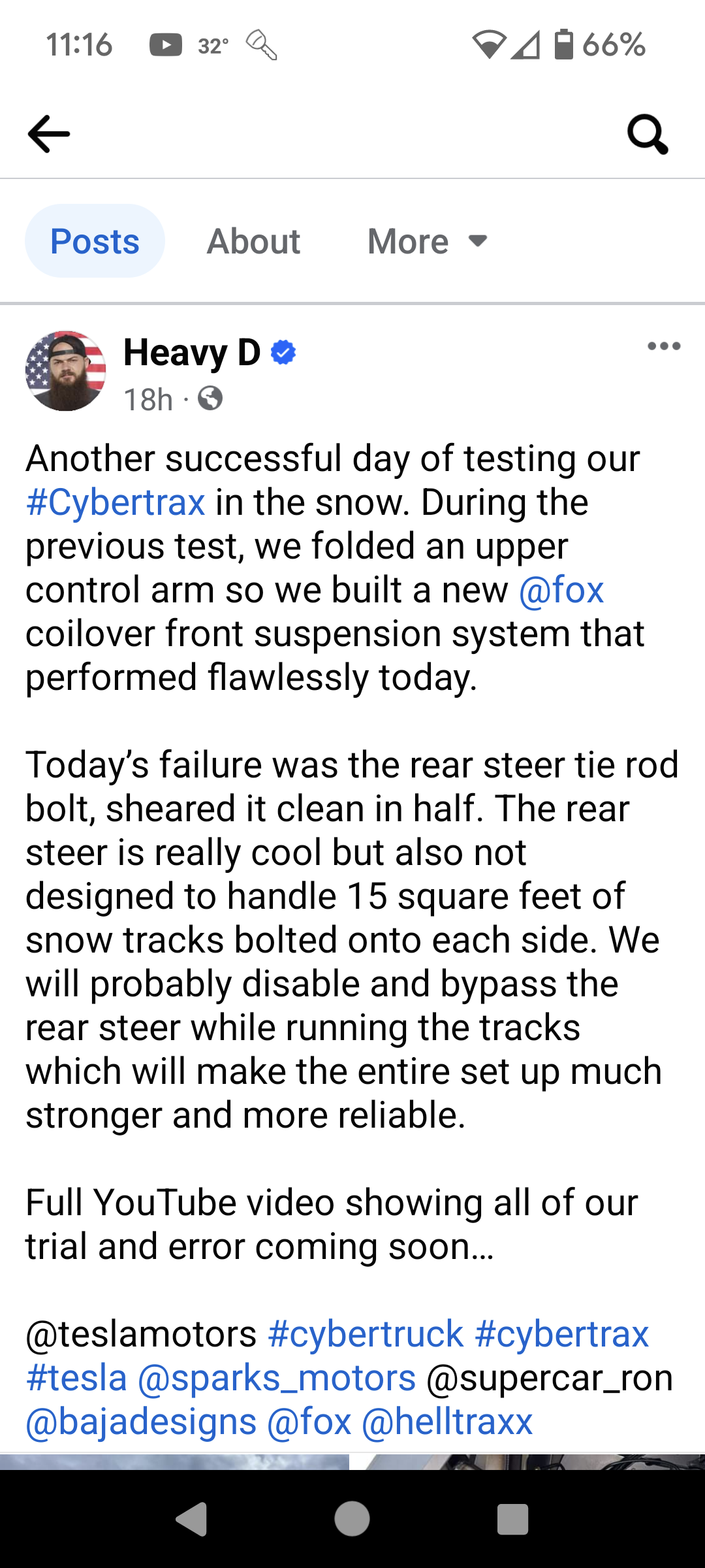

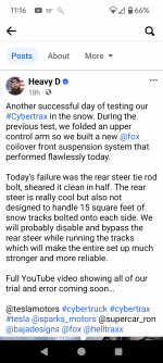

Looks like a major rebuild was in order.
