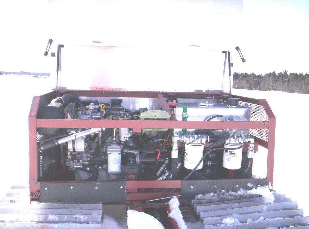

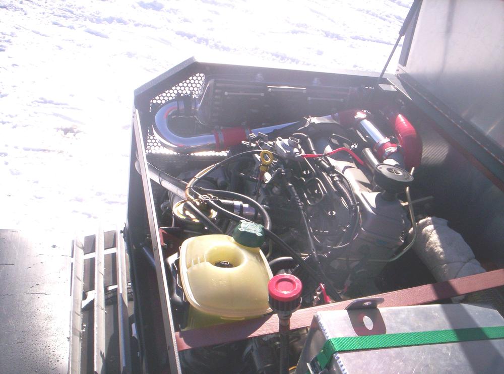

It is turbo diesel powered, (VW Golf 75HP). The engine as been completely
disasembled, checked, re-ringed, and painted. It is in perfect order and has
a block heater.

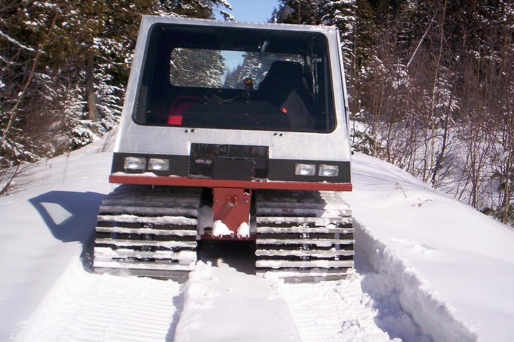

The total width of the tracks is variable via a ram, controlled from inside the cab too. In "narrow" mode tracks overall is 72inches and in "wide" mode, 84
inches. Those 2 features to permit entry in a trailer/ home garage/ narrow
pass in a trail.
Some pictures show the difference between track width, (the un-painted pictures).

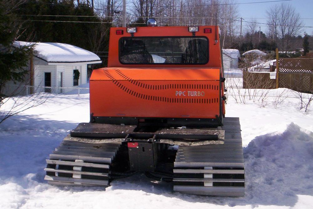

I designed and built this cat myself, being a cat maintenance mechanic and
operator ( BR-180, 275, 350 ).
It took the better part of four years to built and countless hours to design.
It is not intended for hard work or mud rides, it is a fun winter rides cat!.

Additional info: this has been put together with name brands Sauer Sunstrand
pumps and White georollers wheel motors.
The front bumper assembly with winch is bolted on and can be removed in minutes. Same for the "power unit". All the engine, pumps, traction motors,
can be removed without even dismantling a hydrostatic hose so no contamination of fluid occurs.
Cab is made of 3/4 inch plywood covered with aluminum. It is bolted on
frame and easy to remove. Track adjusters are at the rear!, via a bolt/nut
adjuster. Very solid construction. Brackets are there if a front blade is needed. The custom joystick has a 12 function capability.
