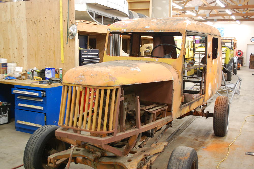

more tucker history has been found, this time it has a great NW connection, Timberline lodge, MT Hood, Oregon, to be exact, they bought several Tuckers starting in 1948 right through the late 60's, and all of the Tuckers, somehow found their way into advertising and on magazine covers, shameless promotion of the Tucker Sno-cat.
so, a 1955 Tucker Sno-cat model 443 has found it's way to tuckerville and the minion is happy.:wink::wink::wink: Amazingly, the machine is complete and very restorable, as soon as, a couple other restorations are completed, this is the next one to be restored.

Hmmm, I thought the 'Woody' cat referb from last winter was the one from this photo? But I'm pretty small minded and wasn't thinking about how many different machines have been run & down that mountain!
(I see my baby (to the right) is still waiting on her new clothes . . . :brows::whistling::wink: But it does look like a little work is being done on her:flowers: )

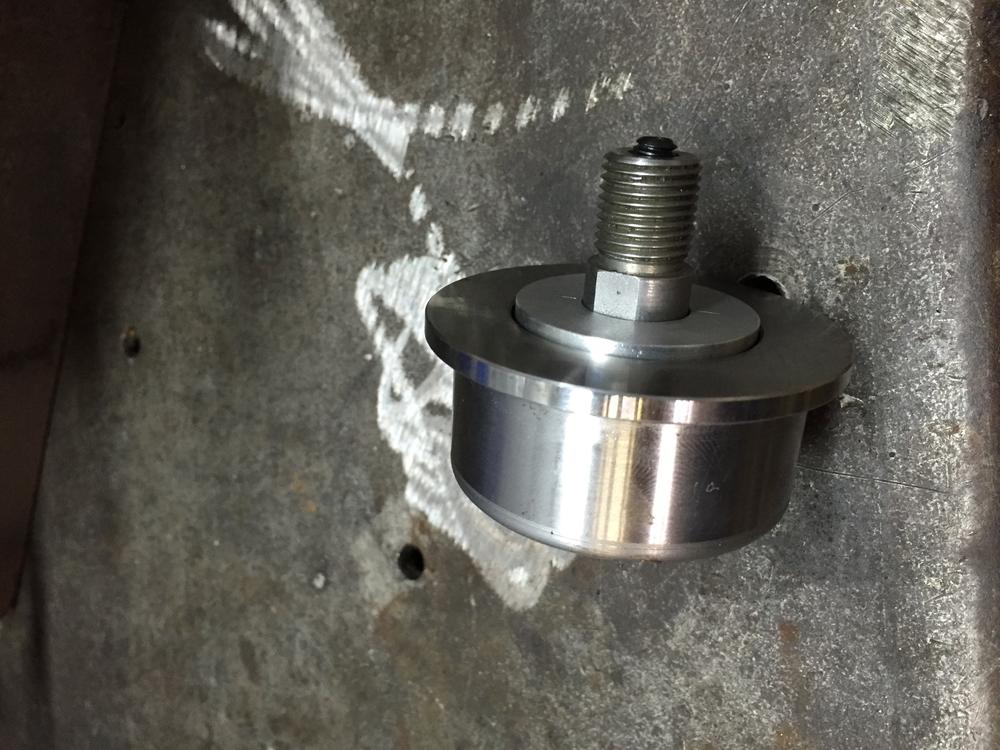

I've been working with a local machinist on replacement rollers that have sealed bearings I have a few trips on them with great results
i have seen this set up and found that the sealed bearing being pressed into the flange tended to become lose, so, you being very smart and talented, what did you do to keep this from happening, and are you hardening the roller? this is great to see what you have done, excellent. will be very impressed if you can bring the cost in under $60.00 each
They are a hardend steel he has been researching bearings for this application for a few years so far so good and the non greasable feature is nice. No price yet
excellent on the hardened steel,
excellent on the sealed bearing, no grease required,
the next issue, and testing will be needed to see if the the pressed in sealed bearing does not work lose in the flanged wheel, there is a lot of forces at work on the roller, i have serval different rollers with this design, made by different folks, and they are suffered from the same problem.
how wide of a sealed bearing are you using? are you putting 2 narrower sealed bearings instead of one?
we at tuckerville having been doing a fair amount of research and testing to resolve the replacement roller issue, seems anyone can built a roller, life cycle is the real stumbling block, and then consider the cost versus life cycle.
like you what you are doing. good job
This design uses 2 sealed bearings the side loading of the bearing seems to be what would make them work loose so far this design has been holding tight.
