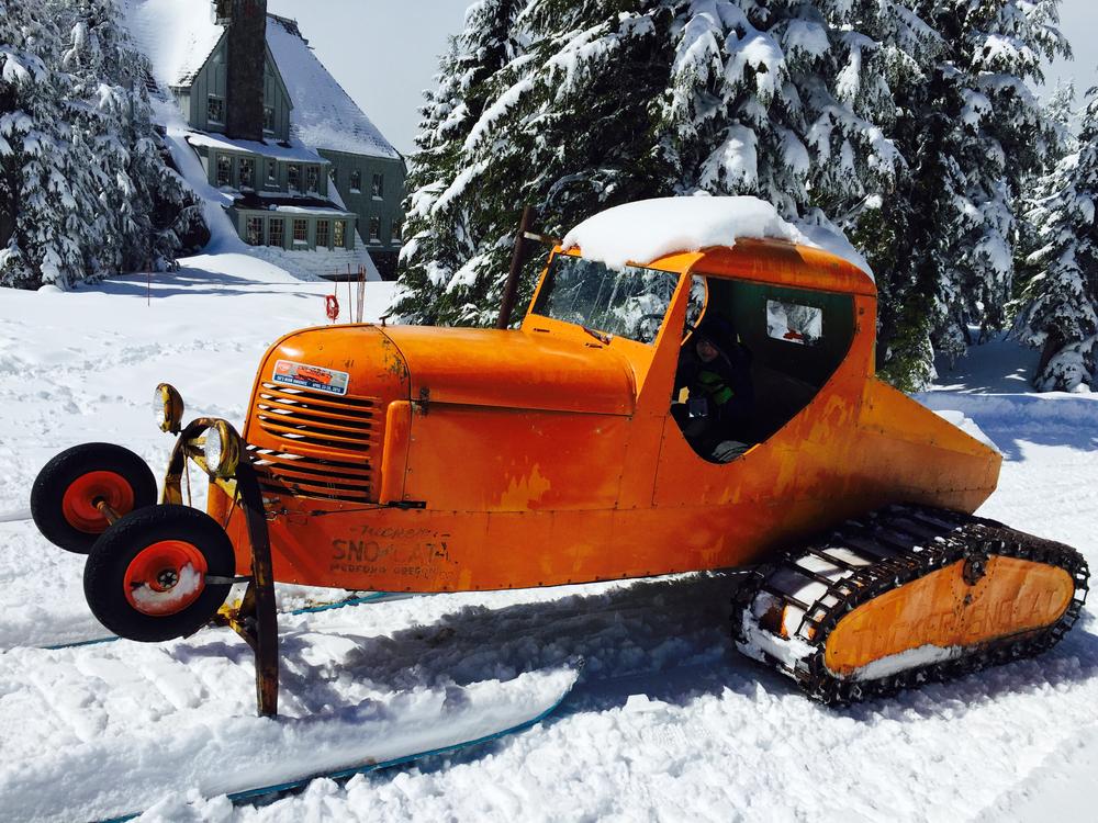

Well i got the little tucker home today,the tracks were frozen up so i made a couple toboggans out of a fuel barrel for the pontoons.I wanted it to slide easily and not gouge up the aluminum roll off body!:biggrin: I chained it to the back of the Diesel lombard to get it unloaded heres a few pictures.

I got the new steering pulleys,cables and linkage all on today as well as getting the engine unstuck !!!!!!! I got to say im a happy camper! I do have a question for anyone in the know,who or what had a 160 m.p.h. speedometer in 1948 ?????? thats what is in the tucker instrument panel,i know these things never went this fast.:biggrin::biggrin:
Think there is a math equation sticker you had to divide it by 12 or some other random number. Tucker Experts will explain exact details better.
Thats a pretty neat gauge ! i'm thinking this dash panel was standard in something other then tuckers,its a 1 piece unit ,seems if they were made for tucker they would be close to speed instead of going up to 160!:ermm:
Loggah, The gauge panel in your '48 is the same as the one in my '49 which was built in '48. They came out of Dodge trucks of the same year. When in doubt, try Chrysler light trucks for drive train parts too. Track Addict's gauge is also Dodge with a Tucker faceplate above the speedo. The mileage factor varies due to different rear end ratios and different sprocket diameters. Your banjo wheel came from the factory that way, so it is stock.
Thanks Scott, the different gear ratio,to mph on the gauge makes sense, the old guy that used to groom with it is still alive, and he said it would move right along !!!:biggrin::biggrin: I do know that im going to have to modify the seat if im going to be able to drive it, 6'3" and 285 lbs dont fit to well, my size 14 shoe barely fits in the little floorboard!:biggrin: This cab is only 3' wide outside,i cant imagine how narrow a 300 series must be !!!
Thanks for the update and photos! Congrats on freeing up the engine. You probably know this already but when you go to start that baby up take out the spark plugs and crank it over to get oil pressure first. Check for stuck valves. It's going to smoke quite a bit. I'd get it warm shut it off and let cool down. Heat cycle it a couple of three times. Not trying to tell you what to do just had these thoughts! Watching your progress!!
The engine has very little compression right now,im sure most of the valves have stuck open. I will spin it over quite a while and see if it will run on a few cylinders. Usually engine heat and vibration will free the other valves up. I have done this on a bunch of old flathead engines.I think i will fix the front seat and move it to the back,i picked up a couple of narrow front seats out of a old grumman delivery van ,in the junkyard yesterday that should work. I also got a bunch of the track loosened up with a "MEDIUM" sized hammer and PB blaster. I thank all of you for the offer of help and borrowing a seat, but i think its going well so far. I will have my wife take a picture of the new steering assembly.International scouts are more rare then tuckers in this area !!!! Don
Cheryl took a few pictures of what i have been up to,steering pulleys and track removal.
been freeing up pins,rollers, and bearings. I turned the engine over with the starter and the oil pressure came up to 40 by cranking, going to attack it again tomorrow !!!:smile:
Nice job an the steering pulleys Loggah. I have seen a stiff tension spring on the pulley attachment to the front hoop to the reduce the shock load to the components and your arms. Don't know for sure if that is a factory installed setup or users who have broken thumbs. We need to examine the factory literature to come up with the correct answer.
:smile: That was what a previous owner had stuck in there so it stayed !!:biggrin: I'm gong to be taking off all the bad rollers and getting new balls to rebuild a few ,i think only 6 are bad. i need a couple links and rollers ,i think my friend Dave has some spares.You guys have done such a great job on your restorations,i am just going to get the mechanical stuff done ,replace the plexiglass, and make it a good runable unit. I believe it will be nicknamed the "RAT CAT" !!!!you guys didn't notice the beer bottle i stuck over the mirror bracket,i almost poked my eye out on it and i grabbed the closest safety device at hand and slid over it !!!:biggrin:
