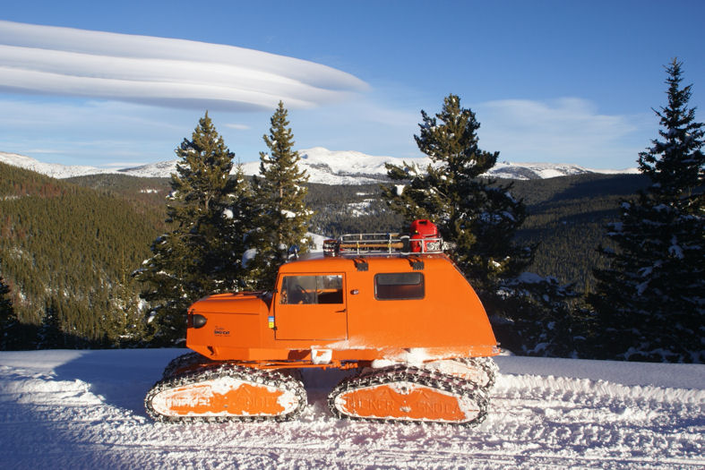

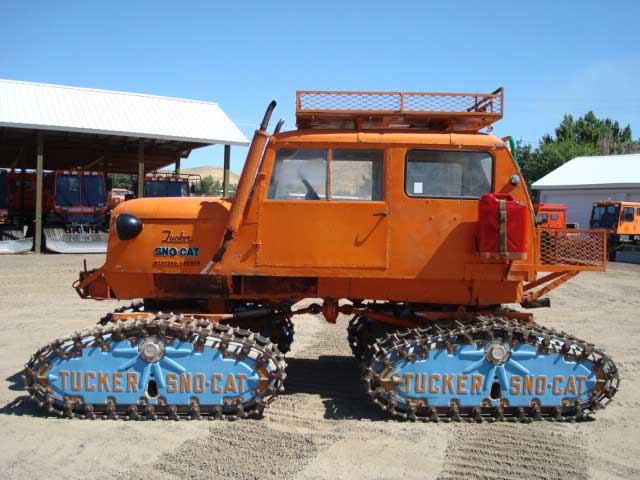

Cool thread -
Here's a comparison of my 443 and a 343 Bill up at Snotrans has for sale.

That was my hope, First question I have is which motor? It does say A on the listing. Strange thing though, I thought the pic looks like it has dual exhaust?

If you look carefully at the pontoons of the two machines (in the photos provided by Broken Grouser) it looks like the pontoons are shorter in the 300 series than the 400 series.
That makes sense with the shorter wheelbase and less weight.

It does look like it has dual exhaust in the pictures. Hmmm, why dual exhaust with an inline engine, especially a 4 cylinder?

You are correct: the 300's pontoons are 18" x 76", the 400's are 18" x 84", and the 500's are 28" x 84". Due most likely to the increases in weights.

I was told once, the 4 cylinder had exhaust on the drivers side, 6 cylinder on the passenger. No duals, so? Possible has a differant engine or maybe some one just liked the "more balanced look"?

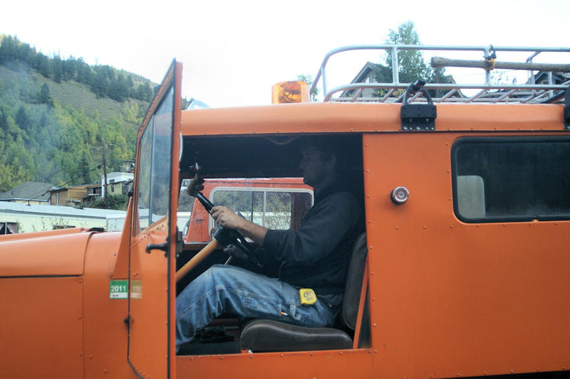

Griz - Here's some dimensions for you from my 443A.
47 1/4" - Inside Door to Door at centerline of seat
39" - Gas Pedal to Back of Seat
37 1/2" - Seat Bottom to Roof
33 1/4" - Door Opening
I'm 6'0" with my boots on and fit just right. The seats are recovered originals and I like lay something down on the seat when I'm driving too see better over the hood.

It appears the 300's are about 6" smaller in all measurements. Seems like it will just be too small for my body.

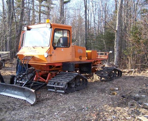

This was the cat up in Christmas.I am striking out with a phone number I do have his card I just have not located it.
if you can see the trailer behind it, that was full of another set of Tracks. the machine started out new in Escanaba, lots of extra parts and a drag.
I liked the idea that the motor and fan noise was behind.
I liked the blade and hyd. (single stick with push buttons)
I don't remember the model number but I am sure that someone here with the picture can figure it out.
I just went for something smaller because I needed to trailer it around.
I think you found the one in Sheboygan?

I believe that would be a 1342ME...
My impression is that vintage mid-engine machine sells pretty cheap. Though the forward visibility is much better than the traditional forward engine Tucker, you are pretty much stuck with a two person cab with minimal/no interior space for gear. From the interior photos I've seen it also looks like the space allocated for the passenger is pretty small.
Forum member swampcruzr (sp?) has one that he re-cabbed with a mid-sixties Chevy van body. It looks pretty darn cool and is much more functional for his family.
It was cheap.
I felt the cab was quite liveable...... for grooming.
I did stare at it from the side trying to see how to gain passengers. for my lake travels.
I remember that van that was cool.
great assesment.

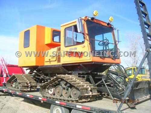

Blackfoot pretty much nailed the description. You can get a bit creative, like this unit listed at Safety One. Keeps your "guests" at a distance
