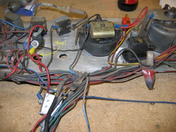

3'rd photo shows the dash from the back with more melted wires. My starter button is buried under the wires and had melted wires to it as well. The starter button was hanging out from under the dash by it's wires when I purchased the cat. Someone prior to me had troubles with it..........
All wires have now been replaced. Several fuses were added. All terminations are now soldered and have been insolated with heat shrink. But the best part is I now have a reliable wiring diagram for my cat!

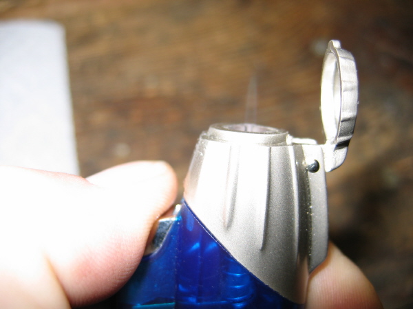

I attached a couple of photos of a pretty handy soldering device that just might work out pretty well for soldering when living off the grid. You can do suprisingly good soldering work with these. Would certainly come in handy for emergency repairs on the trail. Good fire starting abilities as well. Requires butane. I've found mine more reliable than regular butane-fired soldering irons. Works better in the cold. Not well in wind.
