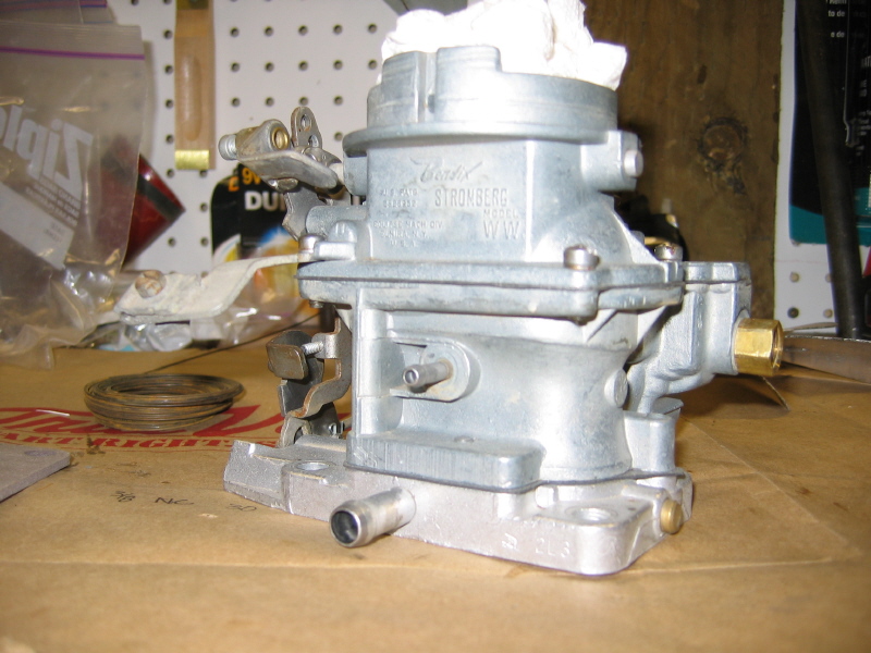

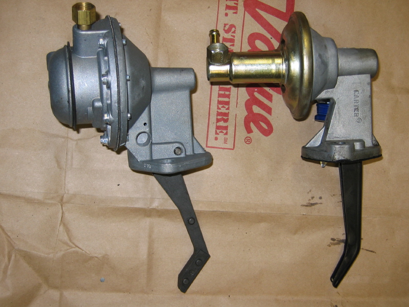

My '69 Tucker (with a 318 industrial) has a very simple Stromberg WW single barrel carb on it that is very easy to re-build. Don't be intimidated by a carb re-build. If you have this carb, I have the re-build kit#. Please see the attached picture. Does this look like your carb?
I also attached a photo showing 2 possible fuel pumps for my 318 industrial. I have part #'s for at least one of these fuel pumps

Yes, I think I have a Stromberg WW carb too. I pulled it out, and it looks similar to the picture. Taking it to a shop for rework, although I agree that it is probably not the whole problem.

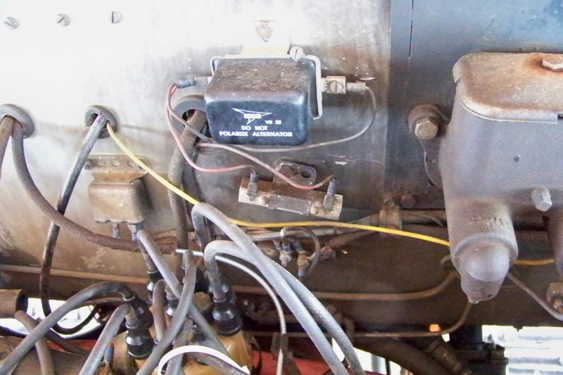

OK, I'm back from the holidays and working on my starting problem. I have the carb in for a rebuild, but I thought I'd try to see if the ignition resistor is bad in the meantime. I did locate a "ceramic thing", a ceramic bar about 3 inches in length, with two wires. I put the multi-meter across the terminals, and from the terminals to ground, and got gibberish. This is with the ignition switch on, but not cranking. There is also a black box (see picture attached, hopefully,) which shows 10-11 volts. Not sure if I have located the ignition resistor or where I should find voltage. This should be somewhere between the ignition switch and the coil, right? And what is the black box? It says "alternator equipped, do not cross poles" or something like that.
Do I need to be cranking to find the voltage? Any suggestions appreciated. As you can tell, I am no mechanic...

Phil, the ceramic thing is your resistor with your meter set on ohms from terminal to terminal you should get a reading if you don't then its burnt out
your black box is your voltage regulator for your charging system. it supplies your current to your field in your alternator the lower your battery the more it sends the the field. so that you make more juice to charge with.
with your battery fully charged you should have 12+ volts more like 13 or so
when you crank it will drop maybe to 10.5 or even 10 if when cranking it goes lower than that then. you could have a starter draging or other issues.

This may help, unplug both wires, put the voltage tester on one or the other of the two wires to check for 12 volts with the key on, when you find one of them to be that wire, plug it back onto the resistor and put the voltage testor on the blade on the other end of the resistor and you should have six volts coming out of it. If nothing, then it is bad.
If no 12 volts, then you have issues farther up the wiring, if you have six volts and still no spark then the coil may be bad and you need to test it. let me know

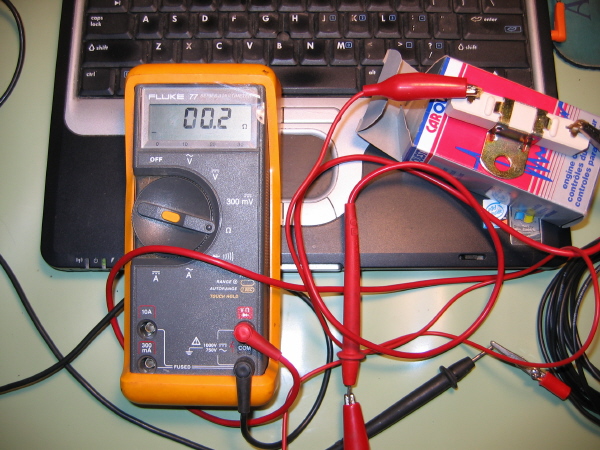

Phil:
With the ignition off and both wires disconnected from the ballast resistor, you will read very close to 0.0 ohms with a COLD ballast resistor. I attached a pic showing the reading of a brand new ballast resistor. The photo shows the multi-meter reading 0.2 ohms but it was ranging from -0.2 to +0.2 if you watched the meter over a period of time.
A HOT ballast resistor should read 1.x ohms (after the engine has run a while). Please see my earlier post to see that the resistance of this resistor changes as it warms up. Please also see: http://www.imperialclub.com/Repair/Electrical/coil.htm for a description of how ballast resistors work. The first part of the discussion refers to 2-wire ballast resistor/starting curcuits and the "addition from Bob" describes the 1-wire type (which is what I have on my 69 Tucker).
The part# for a replacement ballast resistor is Car Quest #73070. If you don't have a Car Quest - have your parts guy cross reference an AC Delco PN D1111. These lit'l dudes cost about $7.00. Everybody should consider carrying a spare............

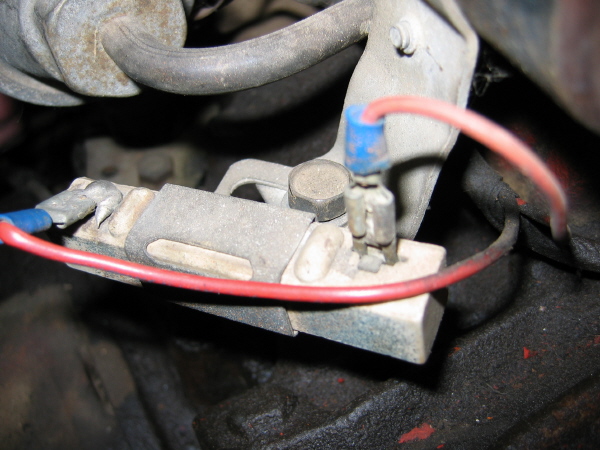

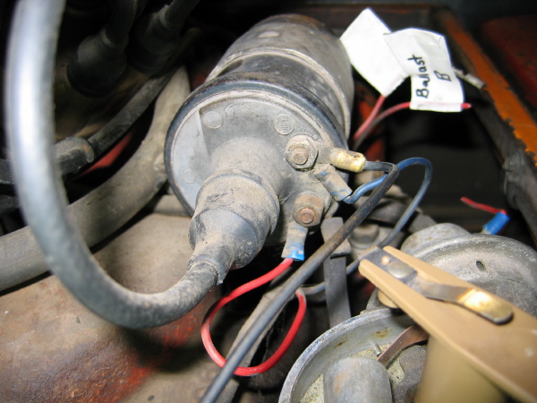

NOW what have I done??? I put in a rebuilt carb, got a new ignition resistor, put that in, and tried to start it. Turned the key on, went to push the starter button and noticed sparks and smoke from the starter button wiring. Now I have nothing, no headlights, no nothin'. What have I fried??? I did not have electrical problems before I started messing with the starting problem, and the only electrical thing I messed with was to put in the new ignition resistor. Could I have gotten the wires to the resistor backwards?
No, it will work plugged in either way. You may have found your problem that you had to start with though. Check your wires to the started and out from the switch for any grounding or cut wires.
Yikes Phil705!
It sounds as if you are zeroing in on some of your problems. Darn. It's getting rougher. If your cat is like my '69 Tucker, there are precious few fuses to protect your electrical system.
These resistors are generally not polarity dependent but there are some that are. If polarity is an issue they will be clearly marked with a + on one terminal. The Car Quest 73070 is not polarity dependent.
The picture that you attached in your earlier post shows me that the + side of the ballast is on the left as it shows a wire coming from the voltage regulator (same as my '69). The right side probably goes straight to the ignition coil. Can you trace this right-hand wire? Does it go straight to the coil. Are there any other wires that splice into it or is there another wire that attaches to the coil where it does? If not, then you have a 1-wire system as I described earlier (same as mine).

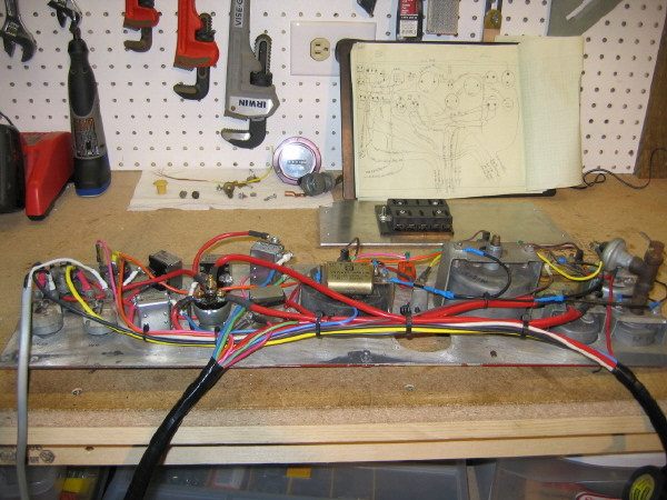

You may have a fusible link on your cat that fried. I hope so. Mine has no such thing. I re-wired my cat a while back and put in a main fuse (along with several other fuses) to try to protect the wiring harness.
I have attached a few pictures from my cat (taken during my re-wire project). Don't be confused by the pic's as my Tucker is wierd and does not have a firewall (it's a forward control thing).
The first shows a resistor that looks identical to your's 'cept mine has a blob of solder fixing an unknown to me problem (by previous owner). The second pic shows the ignition coil. The red wire off the bottom comes directly from the ballast resistor. The upper terminal has a black wire that goes to the distributor and a blue wire that goes directly to the tachometer. The 3'rd pic shows the dash during the re-wire.
I hope you get your cat going.
