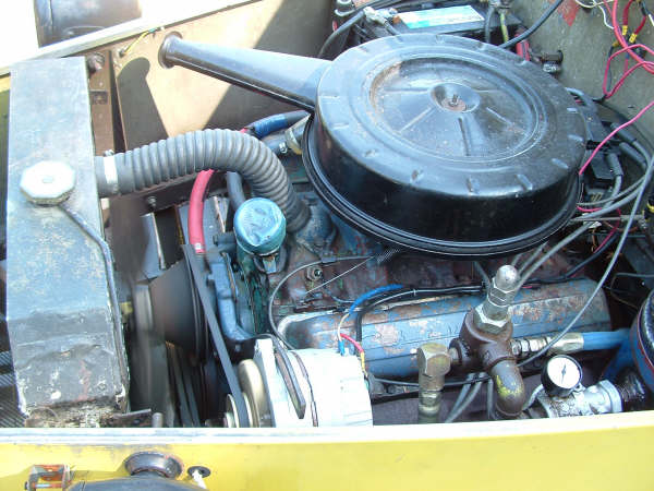

I've got the SBC, too. My '71 1342 has a 283 Chevy with a 4-sp trans. It really purs along and I have plenty of power. I do think the auto would be nice tho because with the manual you pretty much come to a stop between shifts (unless its downhill).

I know what you are talking about regarding the shifting. First time I drove mine I started laughing because I was coming to a complete stop between shifts.
I have not had mine in 4th gear because of some issues with one of the tracks, but I now just pick a gear and start in that gear.
