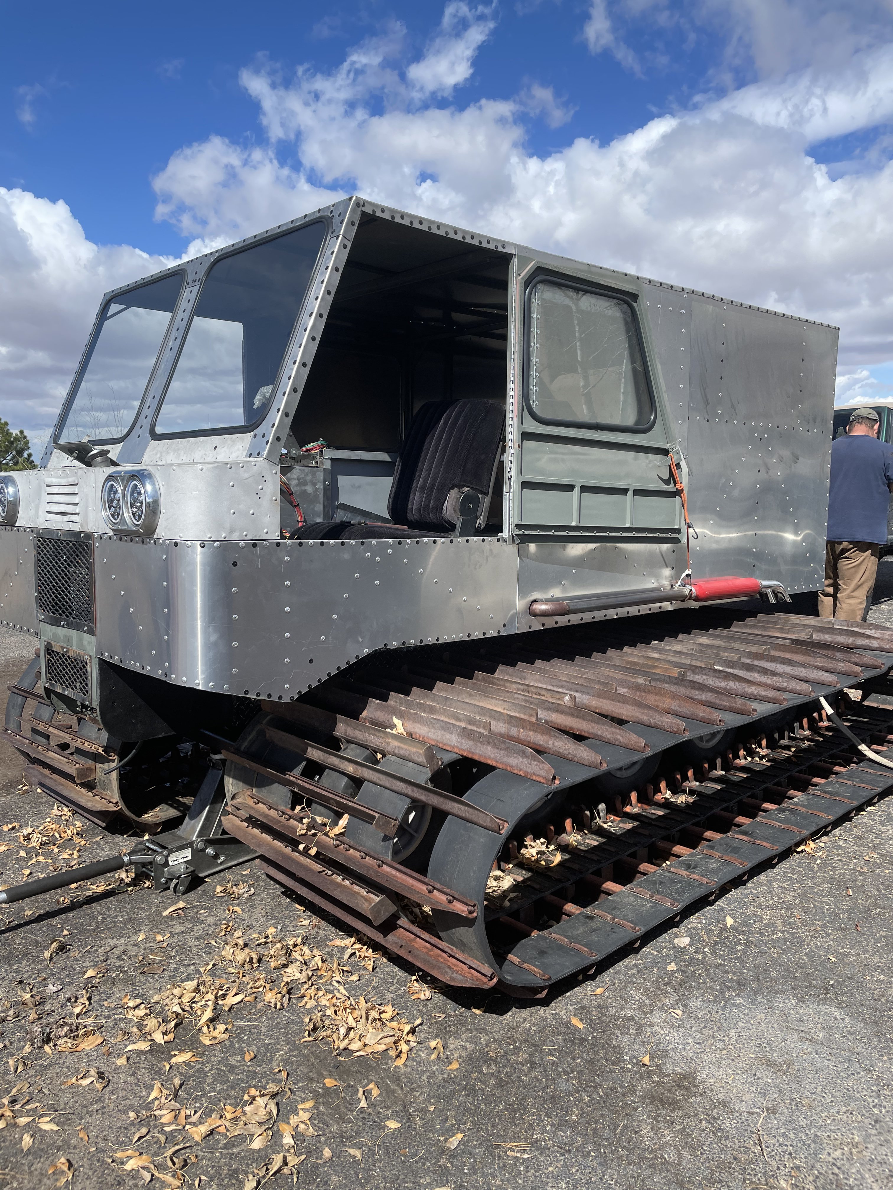

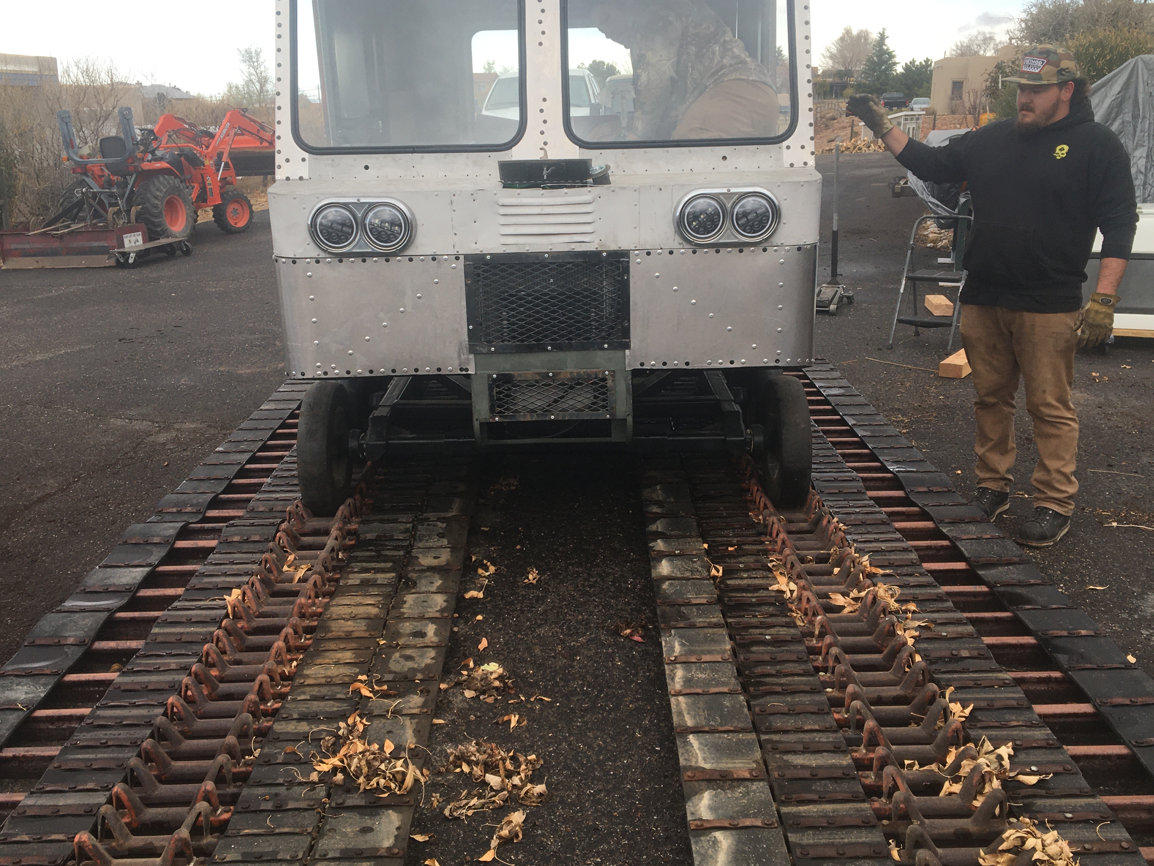

new to this forum. I have a 1965 Spryte that originally came with a ford 6 cylinder, 4 speed, and the OC-12 rear end. It was the 2 seat pick up style version and came from the Los Alamos Ski area where it was purchased new. I completely rebuilt it tearing it all the way down to to the frame. The frame needed to be repaired due to some small cracks. I had the axles straightened within specs and rebuilt the OC-12. I installed a ford 5.0 SB EFI engine with an E40D transmission. The tranny required a US Shift transmission controller (-4 model) to control the tranny. Still tuning it to get it to run correctly. I also built a full box body for it an raised the roof 6 inches to make it much more comfortable to drive. I have a set of wide tracks on it making it about 11 feet wide when installed. Trying to figure out a good way to trailer it legally so I can transport it to use. I may have to remove on track to get it down to legal width. I have a set of summer tracks for it which make it about 10 feet wide. I am looking for a set of narrower tracks to possible purchase if anyone has them.

Load and go! Offset to the passenger side a bit and haul on Sundays or at night! Ramps up in the air to block the view from the back and extra bright lights on your trailer all help!!!! Just saying! Or if your looking for a more legal option, depending on what state your in you can get an Overwidth/Oversize permit! PS we need picks and you should start a thread of your build in the Snowcat Restoration and Rebuild Forum, it’s just common courtesies for us rebuilders!!! Lol
Here are a couple of pics. I will start a thread when I get more time
