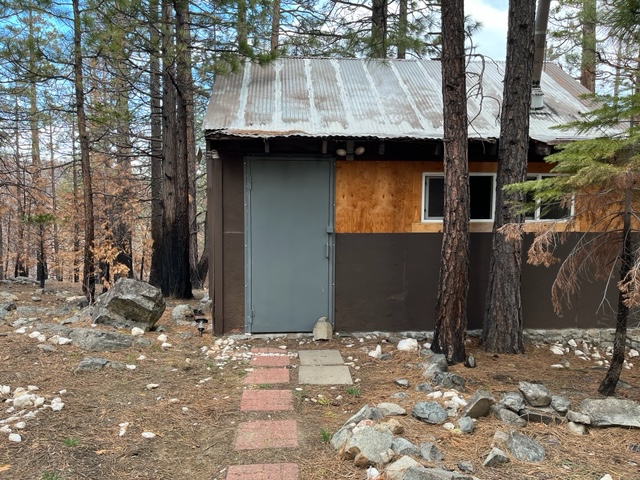

I think closing in the porch and the steel security door I put on it may have helped it not catching fire, by closing off anything the fire could get under.

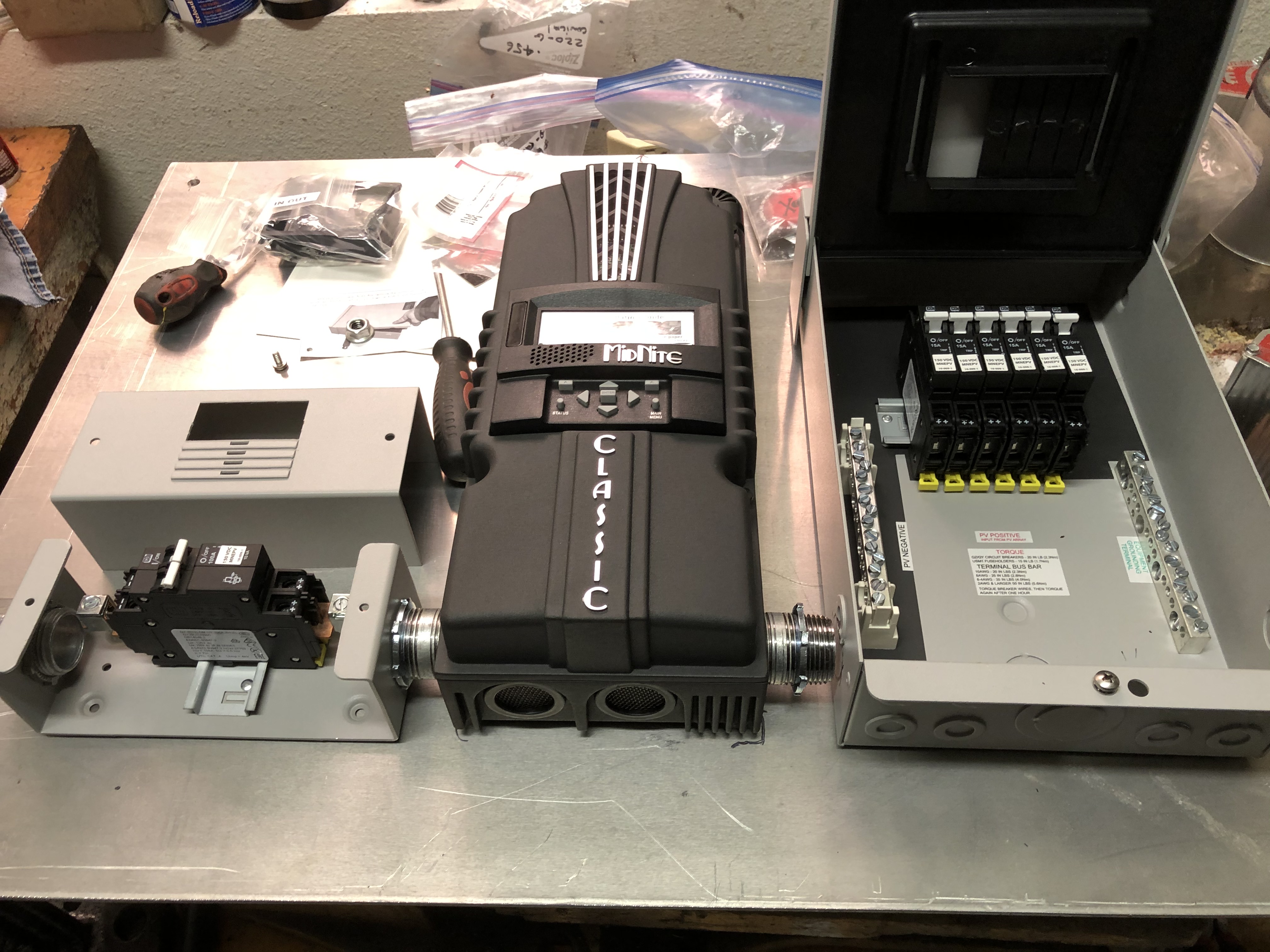

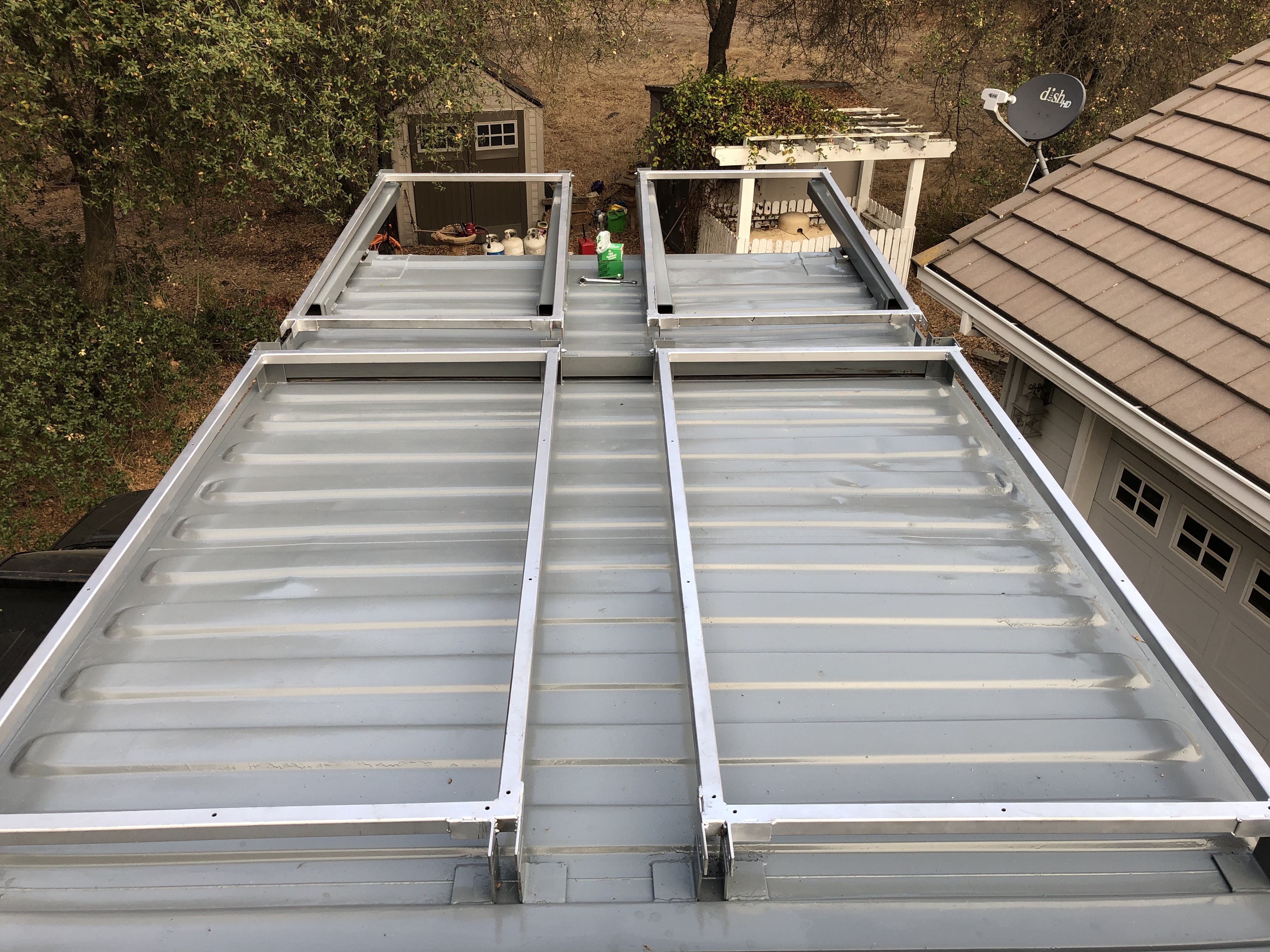

This is welding the mounts and installing the panel frames on top the container and building the solar charger plate with the panel breakers, charge controller and 100 amp DC breaker.

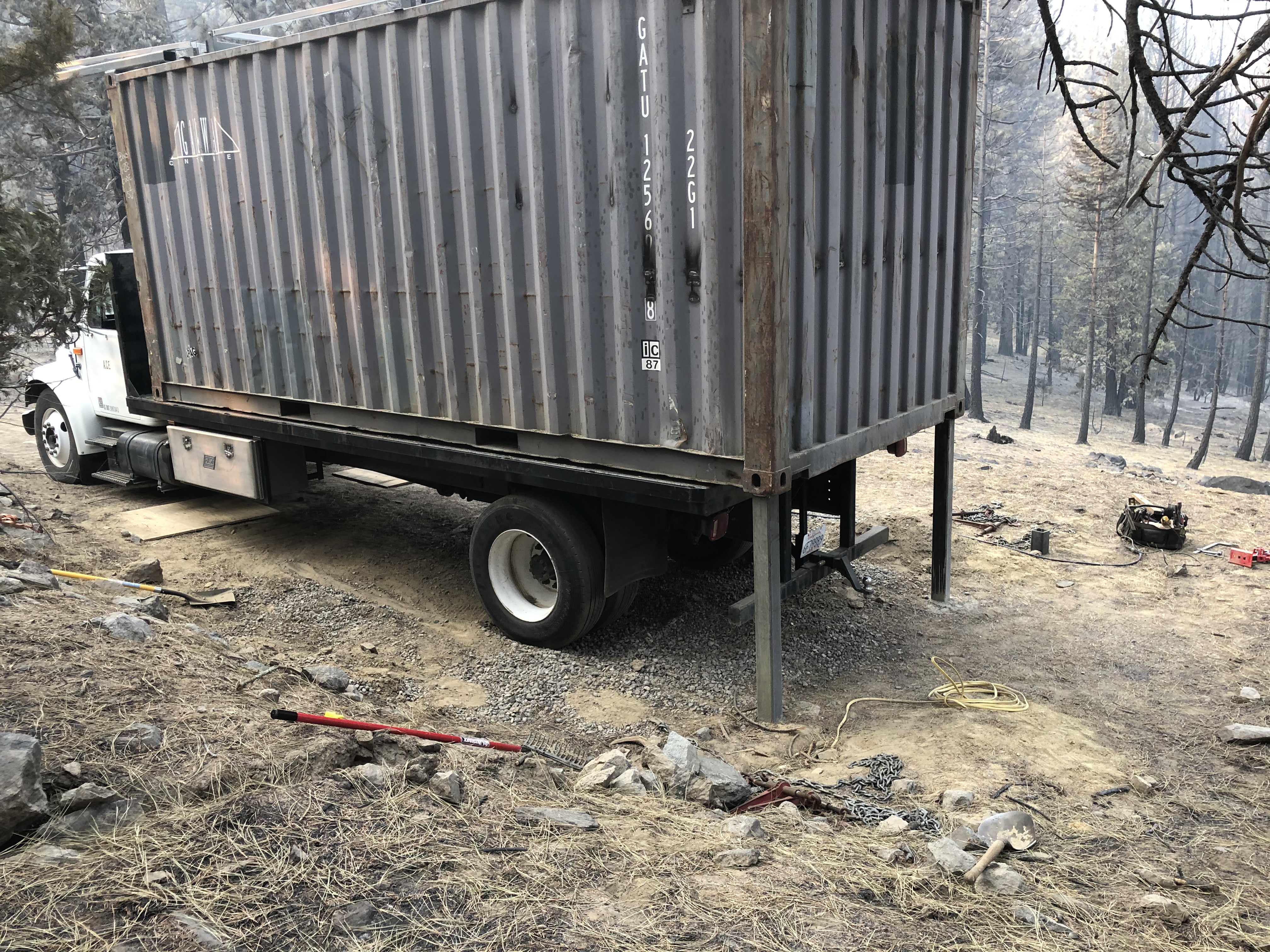

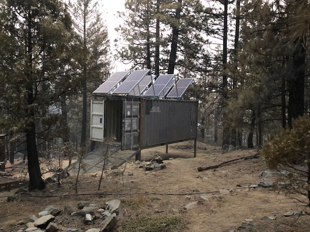

I installed the container about a week after the fire, it was still smokey. Backed in on the truck with it hanging over then welded it to the back 2 poles, chained it to the trees and drove out, until there was about a foot left on the truck, then jacked it up and pulled the truck out, welded on the front poles and concreted them in. Next day installed the ramp and the panels on the top frames. The next trip I ran all the cables from the panels to the charge controller and hooked up the batteries. I had already wired the panel in the cabin and ran a cable underground. As soon as I hooked up th 110V and turned it on we were out of the Stone Age. , lights, microwave, flush toilet and no more need for the generator, and that was good because it burned up. No shower yet because the water tank and all the pipe burned up.

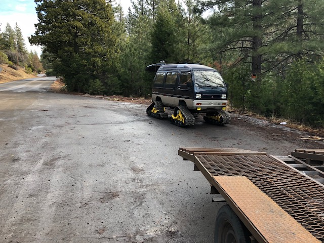

First trip for the track van, much more room and comfort than the truck, supercharged 3 cylinder. Plenty of power. One thing we encountered I haven't before was the road was solid ice at least 4" thick. The van did OK but almost didn't make it up the steepest hill sliding all around. I have been slowly here and there been screwing studs in the tracks, almost done. No more of that crap. My son made the trip with me and we did som hiking and shooting.

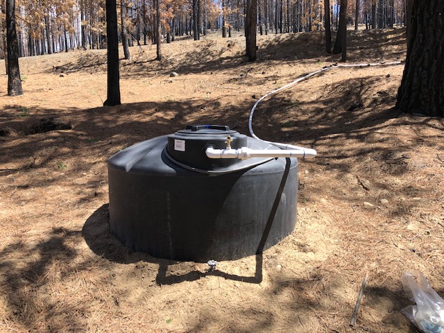

Then more digging in that awful soil. Buried the tank 1/2 way so I could leave water in it in the winter, trenching the road really sucked. I started at 7 am it took me 7 hours to dig down a foot across the road. When I started the Pick was sparking and bouncing off. Then we replaced all the buried pipe from the tank to the cabin a foot down, about 350'. Funny story, I first put the new tank in the same place as the old tank, hooked it up and filled it. turned it on and just had a trickle coming out of the yard spickets. the new tank is 600 gallons and the old 1500 gallons and much taller. So I thought I had lost the head pressure due to the tank being smaller. so moved it up the hill about 50' gaining about 10' in elevation. hooked it all up. SAME THING. The underground pipe melted shut about every 30' or so. That was done over 2 trips. Now we have water, power and septic. I bought a new heavy gauge standing rib roof and couldn't put it on last year due to another fire. The fire didn't reach us but it was so smokey on a trip I took up there that we left at 3am because we couldn't take it. When the snow melts this year, the roof is the first project. Should only take 1 trip for that, then I can get on the flooring ( wood look Ceramic tile )and cedar T&G boards on the walls. Long range will include stoning the exterior with the natural stone laying everywhere up there and steel shudders that lock from the inside. I also have a Glenwood Sunny cook stove from the 1800"s thats really pretty that will go in there with Stainless pipe, that I plan to double wall and hold about 10 gallons of water. I want to harden it against fires and thieves. Down the road will be an outside kitchen and a small pond fed by the spring. Likely it will never stop evolving while I can still do it.

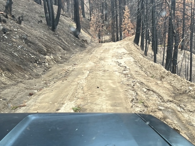

as the road had little snow left with some muddy spots, the road was not bad most of the way up with some wash out mud and snow.
Not much for a 4X4 but you would not make it in a 2X.

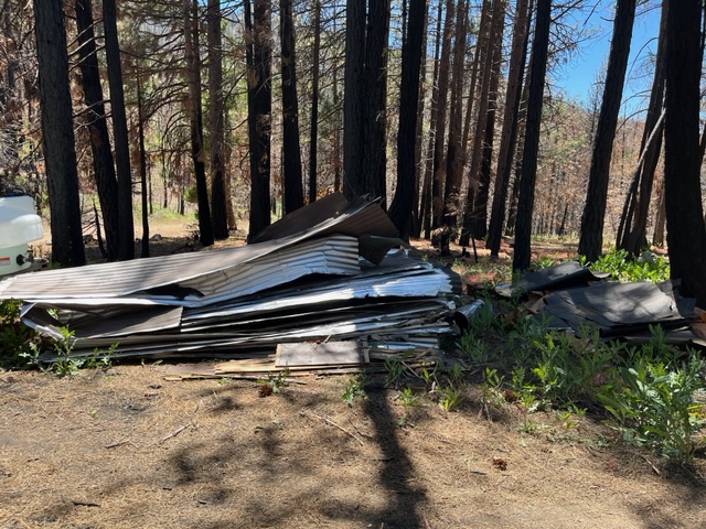

We left the house at 6:30 am, 5 hours later we got there and hit the ground running. We worked until 7pm and got the old roof completely off.

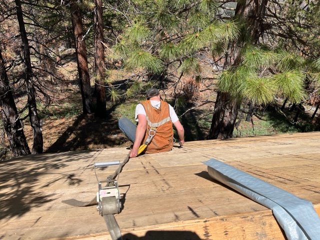

Next day Back out there at 6am. Got the rest of the panels on the hard side. The roof is 10" on 12" pitch for snow and its friggin steep. Even on plywood you slide down. We used an old piece of carpet and a safety harness with a strap to keep from falling off. The whole thing was a bitch. You wouldn't want to go off, especially the down hill side, long drop onto rocks. We got the underlay on the easy side as well as the lower sheets, then we pulled the plastic from the remaining sheets for morning, 7:30 pm again. Thursday morning, back out there at 6am. Finished all the sheeting and cleaned up. Duct taped the ridge as there was no time for the ridge cap. We were out of there headed home at around 10:30 am and got home around 3:30 pm. ass dragging. Monday I have to make a work trip to WA. state for a couple weeks. When I return I will finish the ridge cap and flashing. That was the last the hard projects, the others were Septic, solar installation and the re do of the entire water system after the fire. After this I can finally do the flooring and walls.
