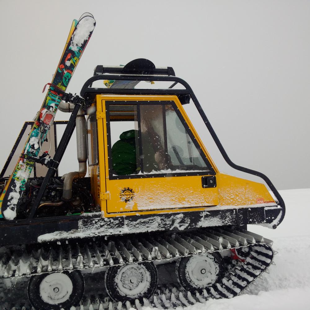

I have had a problem of the heat from the exhaust pipe/ muffler raising heck with the window glass if the outside air temp is not cold and the engine is working hard. Might be a good idea to check the temp of the stacks and shield if needed.

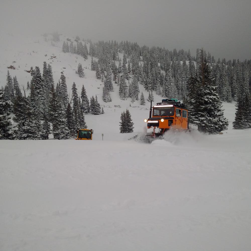

Went cat skiing yesterday. It was fun as always. We did some modifications to keep the engine cooler. It worked and the result was getting more runs in than any previous trip. We skied Ptarmigan hill and Boss basin all day. The snow was best in the basin. Lots of snowcats out yesterday. The Vail powder guides pistenbully was out with a group. A guy had a yellow trooper with rear cap and he had a group of skiers. I think he is running an illegal cat skiing operation. Nova guides had their 13 passenger 1643 Terra out. And we ran into archmage at the end of the day with his two Tucker's. It was a great day, maybe even our best. Thanks to my group for a great day and thanks to archmage for the apres ski.

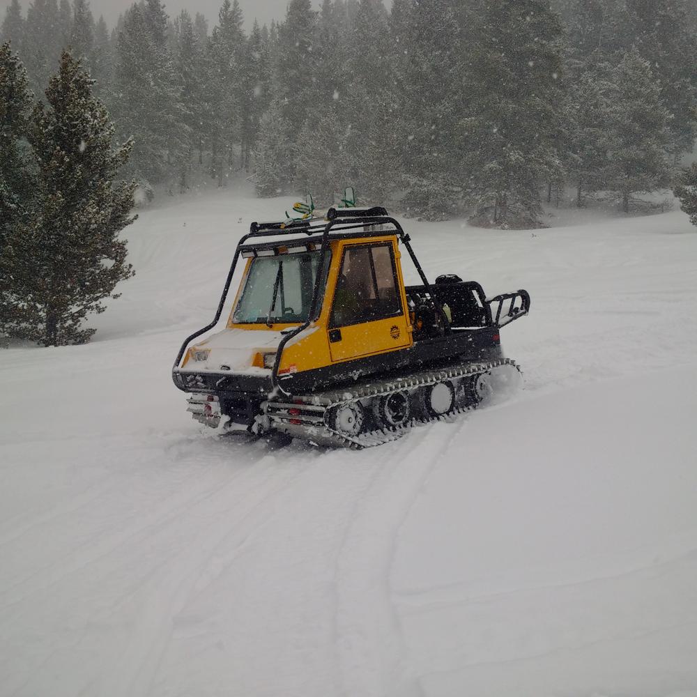

Blue bird day today. Went cat skiing Vail pass today. It was sunny and spring skiing. Got in a good number of laps, had difficulty keeping the cat cool because it was so hot. Finally had some company in boss basin in the form of some snowmobile skiiers. See everyone on Vail pass for the jamboree. Bring your Skis or boards.
...had difficulty keeping the cat cool because it was so hot.
