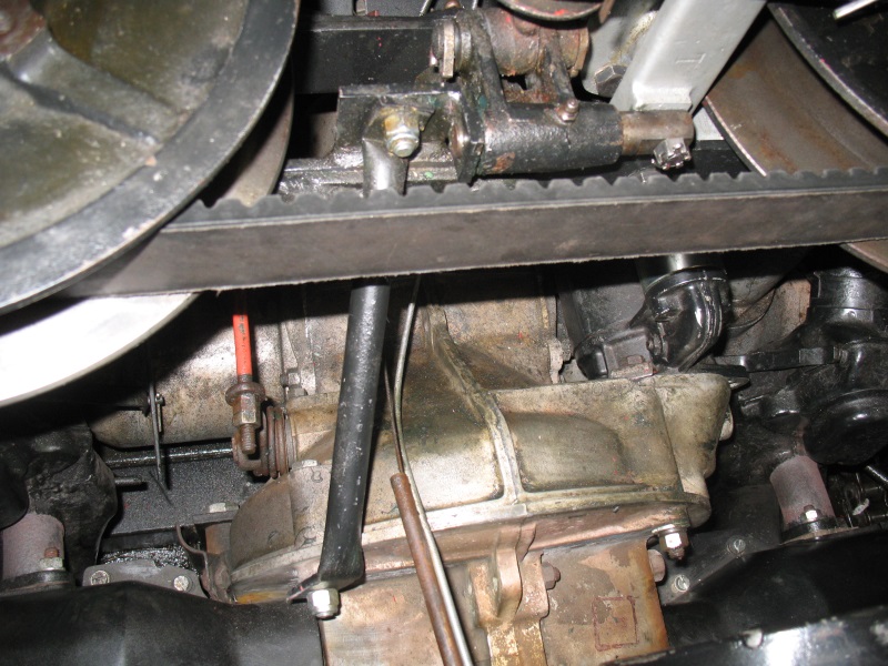

that missing angle that holds the end is a long piece that runs under my shieve. I am not sure it is setup that way on yours. Just welding a bracket to hold it may not be the way to go. can you find the missing part? What do you think,Don?
Look at my posted picture of it.
Jim
the angle is welded to the bar that runs under the shiv it's just a mater of fabing up a new bracket and welding it back in to place. on the 3 spare varriators i have that bracket has been field welded ( a nice way of saying bird terd wellding) back on 2 busted where mine did as there are just 2 spot welds holding it together and one wher wilsons did. it may not hurt to swing a magnet around the pan a bit you may get lucky and find it. all the repairs i have seen they always get into the shaft which makes it unremovable . thats why i took care to repair mine right you could make one with an end mill out of a piece of angle than cut it to fit and weld it on the back side of the rail with a wire feeder.

DD and JimVT, it is that time of year when the first snow flakes are starting to fall and I starting thinking about fixing the snowcat. Looking at the pictures you guys supplied of the piece that is missing from my linkage. I have a couple questions.
1. The pin that is in the cylinder. I am assuming it flows freely in/out of the L shaped piece?
2. The L shaped piece is welded to the support arm below and not the cylinder?
3. Anyone have this L shape piece that they would be wiling to part with?
Thanks
I have a couple but it's part of a larger part, and mine have all been butchered up with bird turd welding. your best bet would be to find a fabrication shop take the rig in with our pics, I bet they could fab up the missing piece and weld it into place for a hundred bucks or less.
the pin floats in the pivot piece that is falling off in the picture it should be bolted at the other side. it will also float in the hole of the missing part, if you were to weld it it will work fine but you could never disassemble it. hope that helps got to run to a meeting. call me later if you have questions 907 304 1383

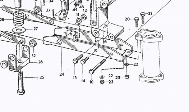

Here are some more pictures of how that bracket should look when it is intact. Note the extra tubular strut between ST-7020 frame and the bolt on the bell housing. You should be able to repair the broken ST-7020, but that will require removing it which will involve a complete removal of your variator topend...
The next to the last picture is a detail of the welded-on ear on part ST-7020 Frame. The last picture shows where ST-7020 fits in (#24 on the diagram).
that's cool I have never seen that strut it should add some rigidity to the piece although all the broken pieces. i have seen have just been the ear and and they all appear to be welded on one side only not both sides like yours.
I believe I only found those braces on later model Snow Masters and Trac Master, not on any of the early series. Also, as noted in the 26 post on Variators, that little bolt that holds the pin to the "C" Casting (ST26) has to be a Grade 8 or Grade 9. In these pictures it's the one with the castle nut and the cotter pin.

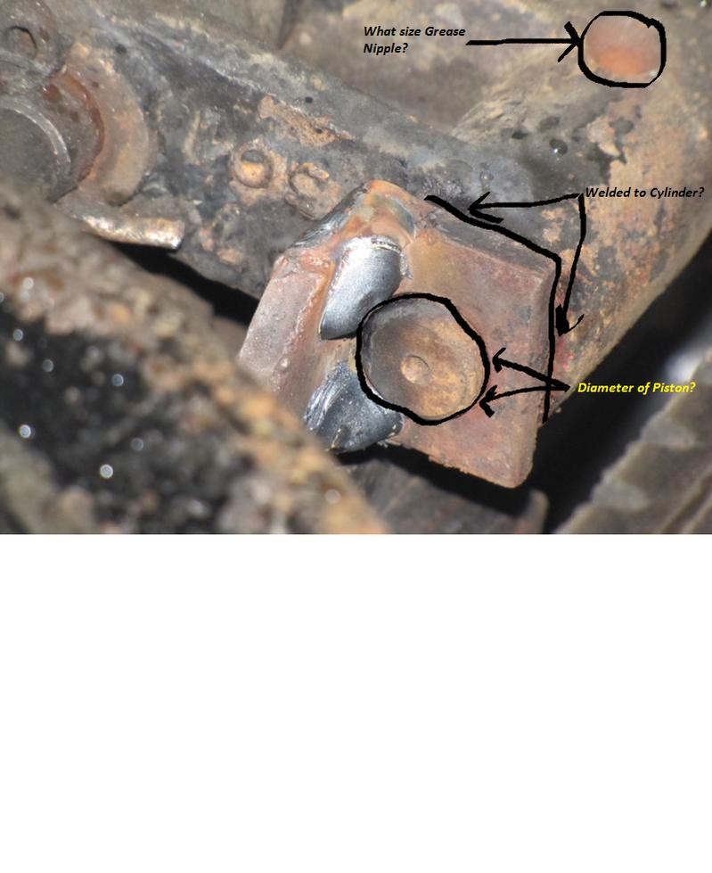

Hopefully, you have the answers. I am building the bracket that connects to the cylinder linkage and have a few questions.
1. Is the Bracket welded to the cylinder or just the support arm below?
2. Do you by chance know the diameter of the hole in the bracket for the piston to run through?
3.Any idea what size grease nipple screws into the cylinder?
Any info is greatly appreciated.. thanks

Put the snowcat all back together and took her for a couple runs around the yard. :w00t2: She turns L/R just fine now. Here is a picture of the bracket I welded up. I was a little concerned the belt would rub up against it, but after hard turns left and right and straight runs I did not see any rubbing. Anyone know what size grease nipple screws into the cylinder. I tried a couple from the variator, but they appeared to be too big. Thanks for everyones help. At this point I need to replace the rear tires, I believe they are or close to original as they say Sweden on the side of them. Grease her up and see if we can get onto some snow before it all melts. Another storm approaching from the north tonight.
Anyone know what size grease nipple screws into the cylinder. I tried a couple from the variator, but they appeared to be too big.:brows:
It looks like you will need to drill and tap the hole for the grease zerk. Use a #3 drill and a 1/4-28 bottoming tap. Don't drill too deep and nick the shaft. Be sure to blow all the drill and tap chips out before installing the zerk.
I had to do this exact same thing on one of my older variators that didn't have a zerk there.
