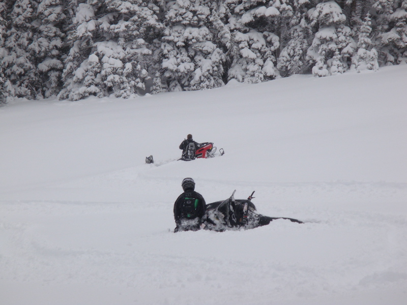

I guess it depends on your point of reference. In my opinion that's not deep snow and it's flat ground, so... not much of a test. Before I made the mistake of buying that used Polaris Ranger on tracks, I was curious enough to ask about them on the forum:
I started that thread about three weeks after this picture taken during an epic day of snowmobiling. Seriously deep, fresh snow and we spent a lot of that day getting unstuck. It was exhausting, but a whole lot of fun. These are very experienced riders on top-of-the-line Polaris RMKs. The one in the background was maybe a month old and has a 163" track. The sled in the foreground was a year older and the rider competed in the Jackson Hole Snowmobile Hill Climbs for a number of years. The point being if these guys were getting stuck... well, you get the idea.
omg this picture triggers my PTSD because it is EXACTLY what running a snowmobile on my property can be like. All of it of course worse when you get around some trees and you need to maneuver... can't just open the throttle full to float. Then I have a "fun" afternoon with a buddy and a shovel just pouring sweat while I dig like a bastard over and over again.
Now, AlryA's 6x6 sure has a LOT more track on it and less weight, or at least a much better ratio than the UTV track set ups I've seen. It seems like that's the point he's making - it isn't the same setup as a straight sled or UTV. More power, more track, less weight.
Bottom line, what I am seeing is that, esp for trailbreaking backwoods, at my size constraint there are some real options, but the best thing to find is a BIG ratio of track area to weight, and then sort by $$$ for whatever comfort and freshness etc.
