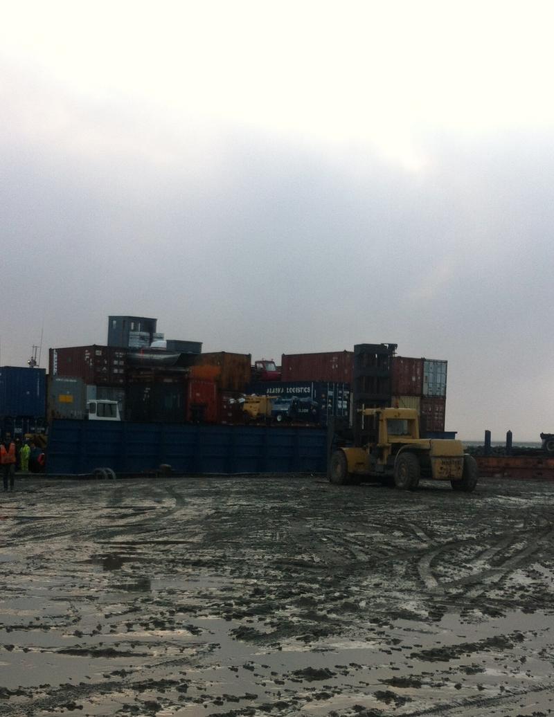

well Christmas time has arrived the boat's tied up and look at it sitting up on top.

well I just got back from the port area, it's off the boat but still 30 feet in the air. My buddy Bill saw me breaking my neck looking up at it in the sun at it so maybe next trip up to the laydown area he will pick it off for me that way I can see how I did on my purchase. they have one track rolled up in front of it all I can say is that is one monster track.
How do they get the stuff off out in the boonies like that?
I wouldn't think the fork lift would reach it all.
tom
they do use a forklift what they do is there is one on the boat and one on the dock. the one on the dock has a flat on the forks they pass the container to the one on the dock ,than the dock side drops it on the ground and picks the container and stores it he than lifts the flat for the next container.
It must be hard to keep boat trim unless they can load and unload at the same time.
I remember at the refinery some one pumped one side off a tanker and it listed bad and almost got away from them.
Glad to see it there Don!!! I bet your excited beyond imagination.... And I hope the machine is all you had hoped for too. Great to see it finally happen..
Best regards, Kirk
they do have to kind of spread the load out. what is real freaky is operating equipment on them when you slam on the brakes you need to be looking at the boat, because if you are looking at land it will look like you haven't stopped as the boat bounces against the lines. its a feeling you have to get used to.

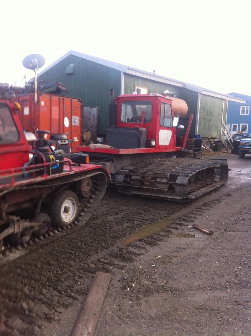

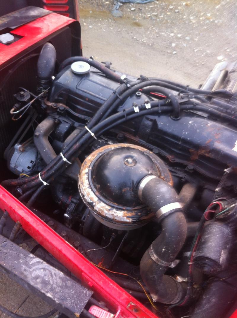

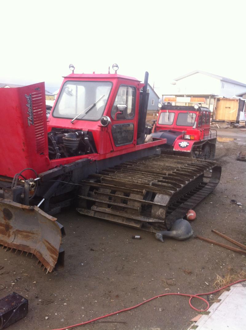

the rain stopped a bit last night and the sun almost came out.so I went out to take a few pics today this thing would make an awesome krusty crusher. I found a few little hydraulic leaks tightened fittings replaced a bunch of fuel hose still have some more hose to replace. and ofcourse all the guides I have found a set of 3700 guides from Dr Zaugg so they should arrive about the time it starts to get frigid.

Damn, that is a wide footprint on that thing. Should float pretty good on the soft stuff. Makes the snot trac look narrow!
you think they look big there, you should be looking at them all rolled up wondering how you are going to put them on by your self. once I got them positioned the rear driver did a good job of pushing the tracks forward over the tops of the road wheels to the front. I looped the front over and with 2 4 ton comealongs, I left the winches on top and strung the cables under the grousers past the splice a couple of grousers, and when I cranked up on it it held the ends of the tracks flat and pulled the joints together for the bolts to go through.
One of those track clamps and a cordless inpack and a 1/4 ton chain wratchet is what you need and two people.
I noticed you have room for sarge.
jim
there's room for both sarge and boss dog in it I think as boss grows that the room for him may grow cramped. sarge is a lap parasite and with him in the lap its a little hard to steer I may have to modify the steering levers for my Buda belly
not really in the snow trac there is room to get up and walk to the back and make a sandwich and go back up front, I have done this before The Thiokol every thing is at your fingertips and you are kind of like being in an easy chair. but you are right changing out them guides may impact my hourglass figure, with all the sand at the bottom I was thinking of a trip down the beach to try to sand blast some of the rust and crud off the track fastners today.
