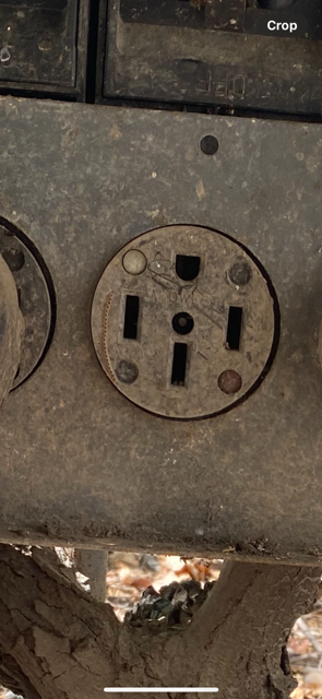

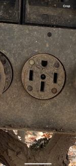

Older mobile home with incoming power source much like an RV has. The incoming power has 50 amp cable that plugs into the pedestal with other end hardwired to indoor breaker panel.

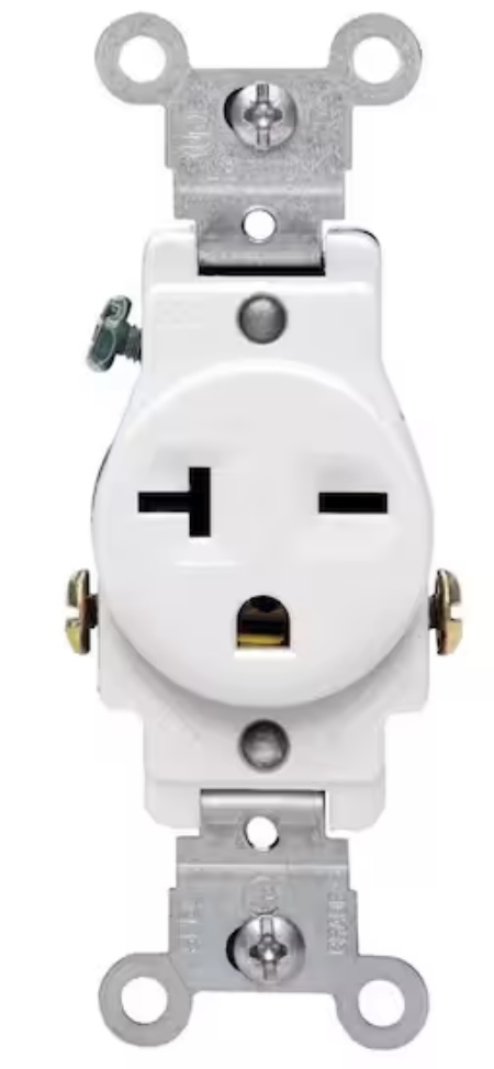

Also have a separate cable plugged into another 50 amp outlet running to central unit that went out (lying on the ground in the picture). I have someone adding a 220 outlet in the mobile home to allow me to install a 20 amp window unit.
He's running new 10/3 wire from the 50 amp outdoor panel that will plug into the outdoor outlet. The other end he's running 10/3 wire to 20 amp breaker, then run inside the trailer to an outlet below the window.
Is the acceptable, plugging in a 20 amp cable into a 50 amp outlet? I've had several different answers with some saying no you can't but no reasons why.
Below you can see the cable running into the trailer to the breaker panel. Will be plugging in 20 amp 10/3 cable to the center plug. All will be in conduit.
The old existing cable is lying on the ground. Also is a picture of the 220 outlet below the window.

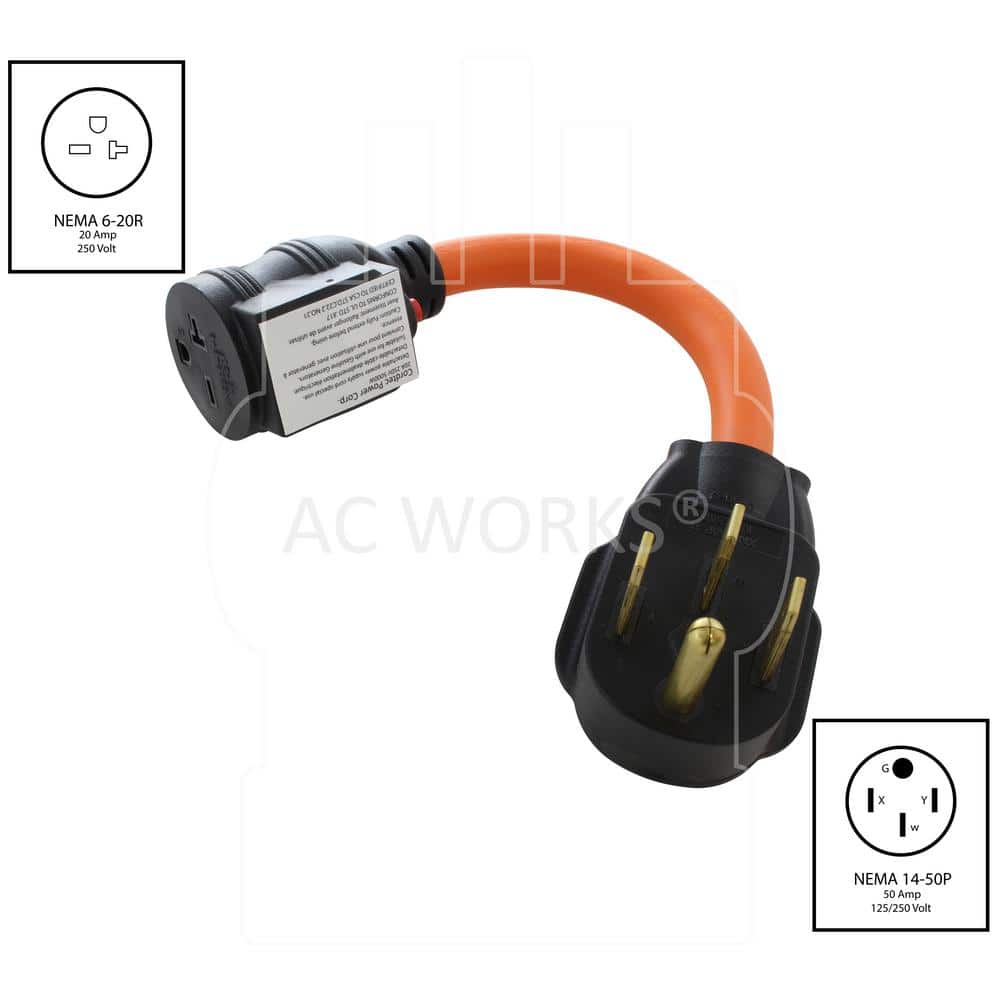

They make an adapter like one of the attached. 50 amp to 20 amp. The 10 gauge is already run in conduit from the disconnect to the panel waiting to be connected. Can I use the adapter then use the 10 gauge wire with the 20 amp male plug wired on like in the picture.

If I run wire such as 6/2 and plug directly into the 50 amp outlet all the way to the 20amp disconnect that the electrician installed would that be an issue? Will 20 amp breaker trip if I have an issue using 50 amp wire?

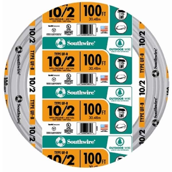

Could this be an option 50 amp reducer to 20 amp and the 10/2 UF wire as pictured below all the way to the disconnect. Looks like it can be in conduit and buried. The adapter has a 20amp built in breaker at the end. Would wire in the male outlet below to the 10/2 wire and plug into the 50amp to 20amp adapter.

If you are 100%certain you will never use that circuit for 120vac, and it will be a dedicated 240vac, then you need 3 conductors. Two hots. One ground. You need that ground for safety. I can't read the label on that coil of wire, but I am guessing it has two insulated conductors for the hots, and one bar for the ground.
But the outlet pictured is a 4 wire. I've not seen that configuration. If you go with just 3 for 240vac, you need to figure out which portions go to the hot leads of that receptacle.

Thanks, the adapter is 4 wires on one end the plugs into the 50 amp outlet, the other end is 3 wires that would go to the 10/2 wire.
The wire is
Southwire​
100 ft. 10/2 Gray Solid CU UF-B W/G Wire​
  • #10 AWG undgerground wire for lamp posts, pumps and other loads
  • UF outdoor direct burial wire is resistant to moisture and light
